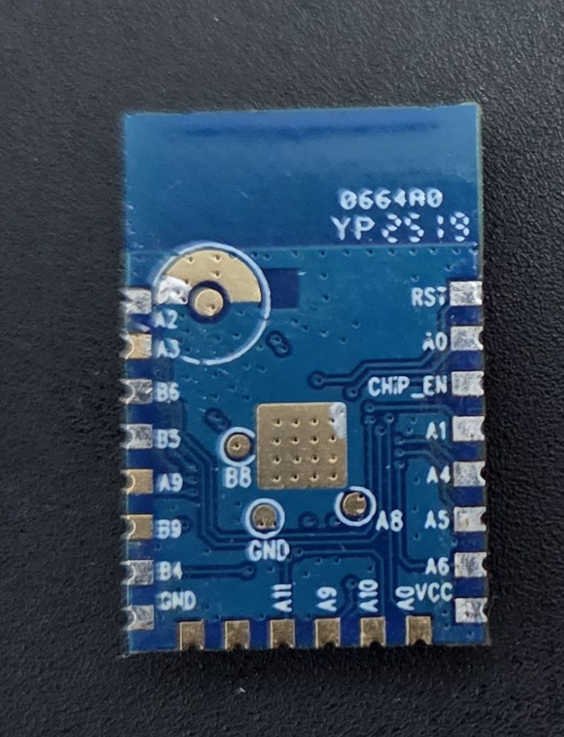

    Electronic module with labeled pins on a blue PCB, top view LN-CB3S electronic module with PCB antenna, CE marking, and QR code
    Any info on this module?
    I could not find any information by googling "LN-CB3S."
    It seems that this module has different pin labeling (and/or different pinouts) from CB3S module.
    I connected A2 and A3 pins to TX and RX (and also tried to RX and TX) of my USB-to-serial (and also CEN to GND), but I cannot get it to enter flash mode.
    This module is from a Tuya wall switch. Since I could not flash this module with any open-source firmware, I had to replace it with ESP-12F.
    Any info would be appreciated.

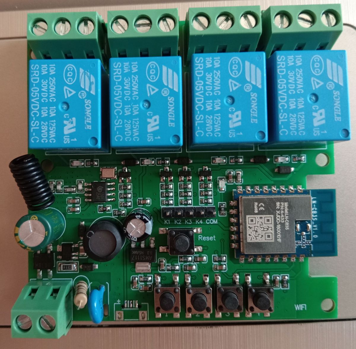

    Help: 168
    Rate: 455
    Judging from module and pin names - LN882H.
    Default RX/TX are for flashing (and app uart, if used), log should be at B9.
    Backup can be taken with BK7231GUIFlashTool, chip enters flashing mode with A9 pulled down on boot

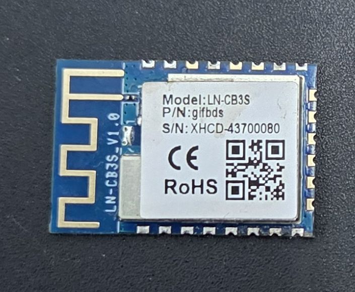

    Interesting, looks like LN882H CB3S version. Can you try to take a backup with our flasher?

    Pinout diagram of an electronic module showing GPIO, UART, and 3.3V power connections
    • CB3S_4layers.zip (262.84 KB) You must be logged in to download this attachment.
    • CB3S_2layers.zip (228.95 KB) You must be logged in to download this attachment.

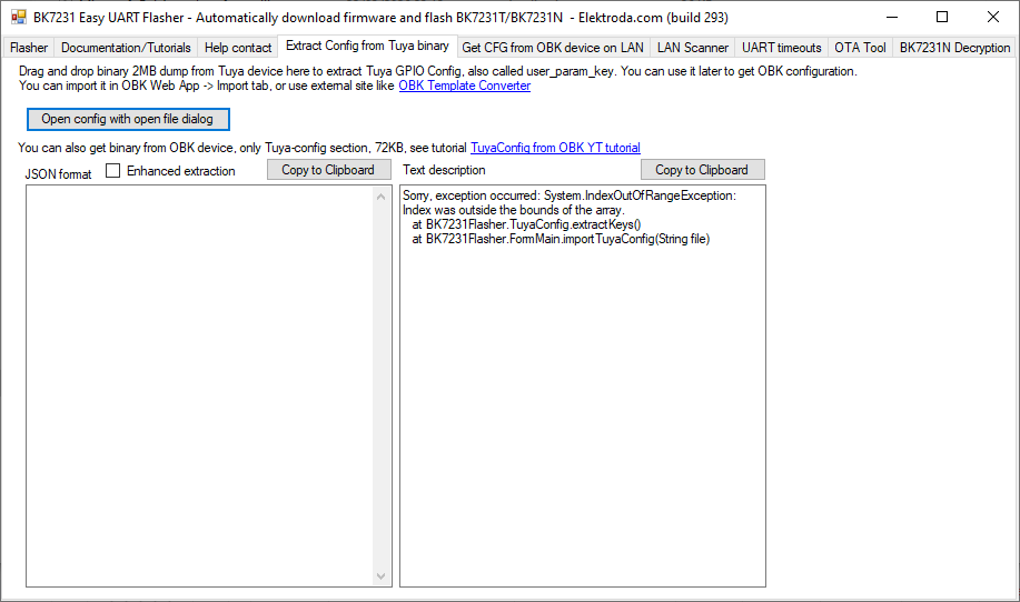

    thanks. Easy Flasher chokes on the KV extraction from that dump. Will fix.
    Screenshot of BK7231 Easy UART Flasher showing an error message and an empty JSON panel

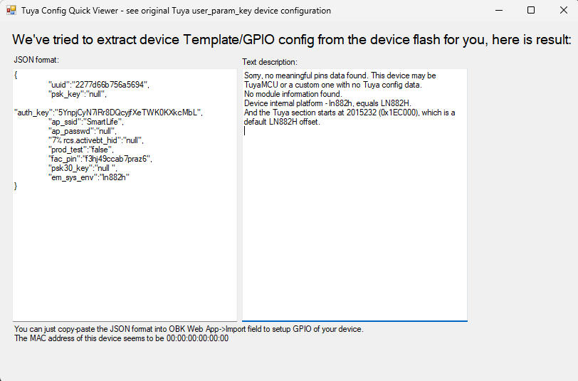

  • Tuya config dump identifies LN882H environment
    #12 21876010
    Posts: 5216
    Help: 448
    Rate: 917
  • Normal mode boot log confirms GPIOA_9 high
    #13 21877066
    Posts: 5216
    Help: 448
    Rate: 917
    boot log
    Added after 9 [hours] 31 [minutes]:
    @bl00dy, to confirm, your BSEED 2G touch light switch device has a WL2H-U (WL2H-U-2?) module, not LN-CB3S, the original focus of this thread?

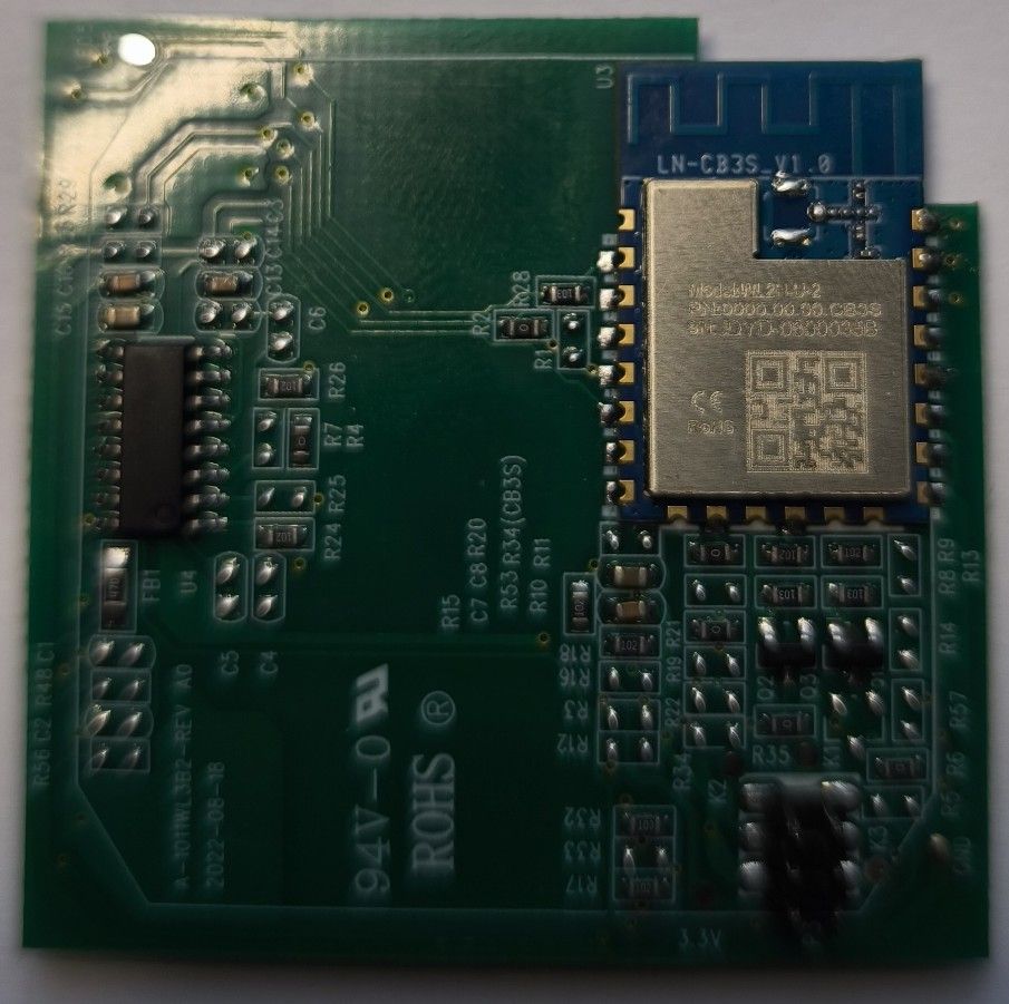

    Let me send photo of chip:
    As you can see, it's LN-CB3S_V1.0 with WL2H-U-2 on it.
    I installed OBK on it, and also installed ESPHome. Both work.
    Ed
    Close-up of green PCB with LN-CB3S_V1.0 module and shielded WL2H-U-2 chip

  • #19 21884532

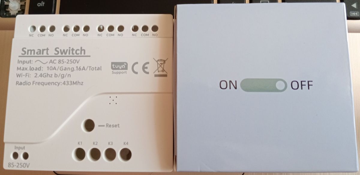

    magikow
    >>21877215 I have a similar circuit on my Smart Switch 4 channel - what settings to take in Flasher - what circuit to choose and do I short circuit A9 to ground when reading ?
  • #20 21884786
    bl00dy
    Posts: 38
    Yes. Just A9 to ground when reading or writing chip.

    Photo:
    Spoiler:
    LN-CB3S Module Pinout and Flashing Issues on Tuya Wall Switch – Any Documentation?
    I received a device with this module. ltchiptool couldn't read or flash it, and neither could BK7231Flasher. i connected it using the pinout from post #4. There's a log (above) on U1TXD/B9 if A9 isn't grounded; if it is, there's silence.
    Perhaps the module needs to be desoldered - i haven't tried it yet.
    UPD:
    i did it right after wrote it. Buttons 3 and 4 are connected to the RX/TX. There are also pull-up resistors and capacitors there. removed them, and everything flashed fine. im attaching a backup of the original firmware in case it's useful to anyone.
    Spoiler:
    readResult...-28-35.bin (2 MB)You must be logged in to download this attachment.

    xopkep
    Posts: 20
    >>21900293
    Spoiler:
    "vendor": "Tuya",
    "bDetailed": "0",
    "name": "4CH Smart Switch",
    "model": "4CH Smart Switch",
    "chip": "LN882H",
    "board": "LN-CB3S_V1.0",
    "flags": "1024",
    "keywords": [
    "4ch",
    "RF",
    "Switch"
    "pins": {
    "1": "Rel;4",
    "2": "Btn;4",
    "3": "Btn;3",
    "4": "Rel;3",
    "5": "Rel;1",
    "6": "Rel;2",
    "10": "WifiLED_n;0",
    "11": "RCRecv;0",
    "20": "Btn;2",
    "21": "Btn;1"
    "command": "",
    "image": "https://obrazki.elektroda.pl/7386383800_1778411028.jpg",
    "wiki": "https://www.elektroda.com/rtvforum/topic4162022.html#21900251"
    This is the resulting OBK configuration. There are no distinguishing marks for the name or model.
    However, there's another problem: can anyone tell me how to get the compiled firmware with the RC driver?
    i receive a message:
    Info:MAIN:Driver RC is not known in this build.
    Info:MAIN:Available drivers:
