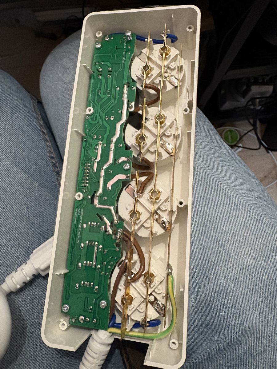

    Today I’m sharing a teardown and analysis of a Tuya-based DIN rail smart switch with power monitoring.
    This device offers: 5 relay outputs, energy monitoring, Tuya Smart Life compatibility

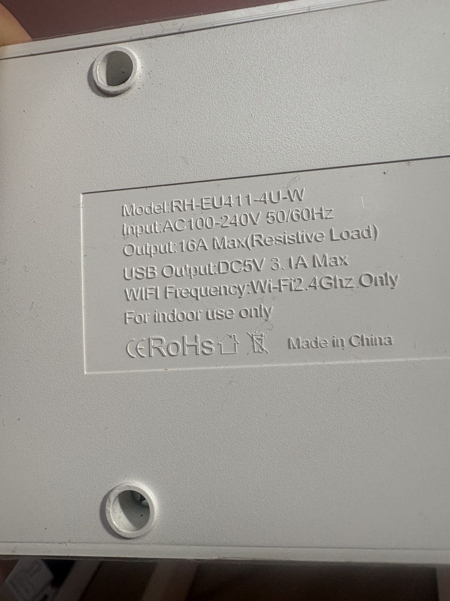

    📦 External overview
    White power strip with four Schuko sockets, four USB ports, and a power button on a wooden surface
    Embossed case label with model RH‑EU411‑4U‑W and specs for input power, USB output, and 2.4 GHz Wi‑Fi
    🔧 Opening the enclosure
    To open it, use a triangle screwdriver (sic) or a small flathead screwdriver.

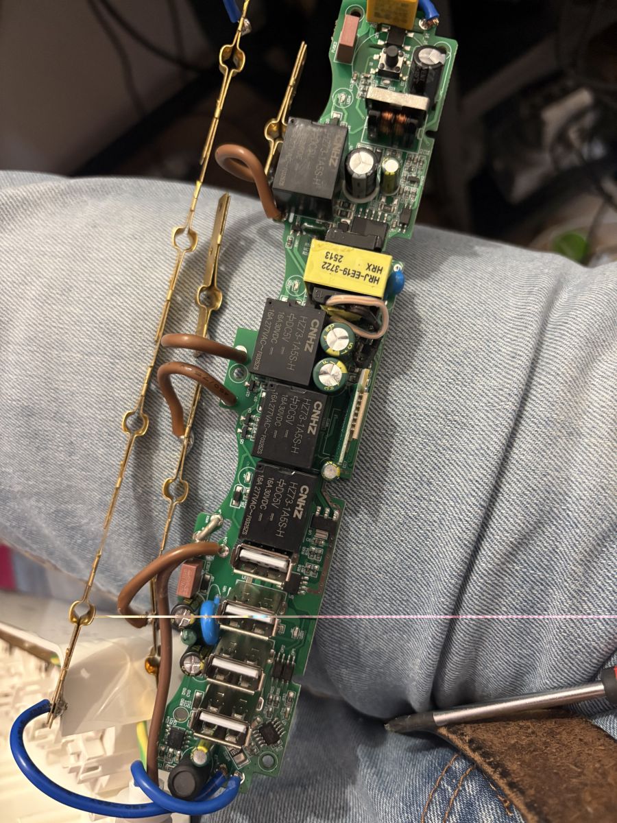

    Inside a power strip showing a green PCB and brass busbars along the socket modules in the housingPCB of a DIN-rail switch with relays, transformer, and wires, resting on denim-covered legs
    Inside we find the main board.

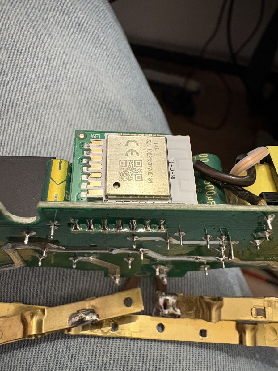

    A small carrier circuit:
    Close-up of a PCB with a Tuya T1-U-HL module under a metal shield showing a QR code

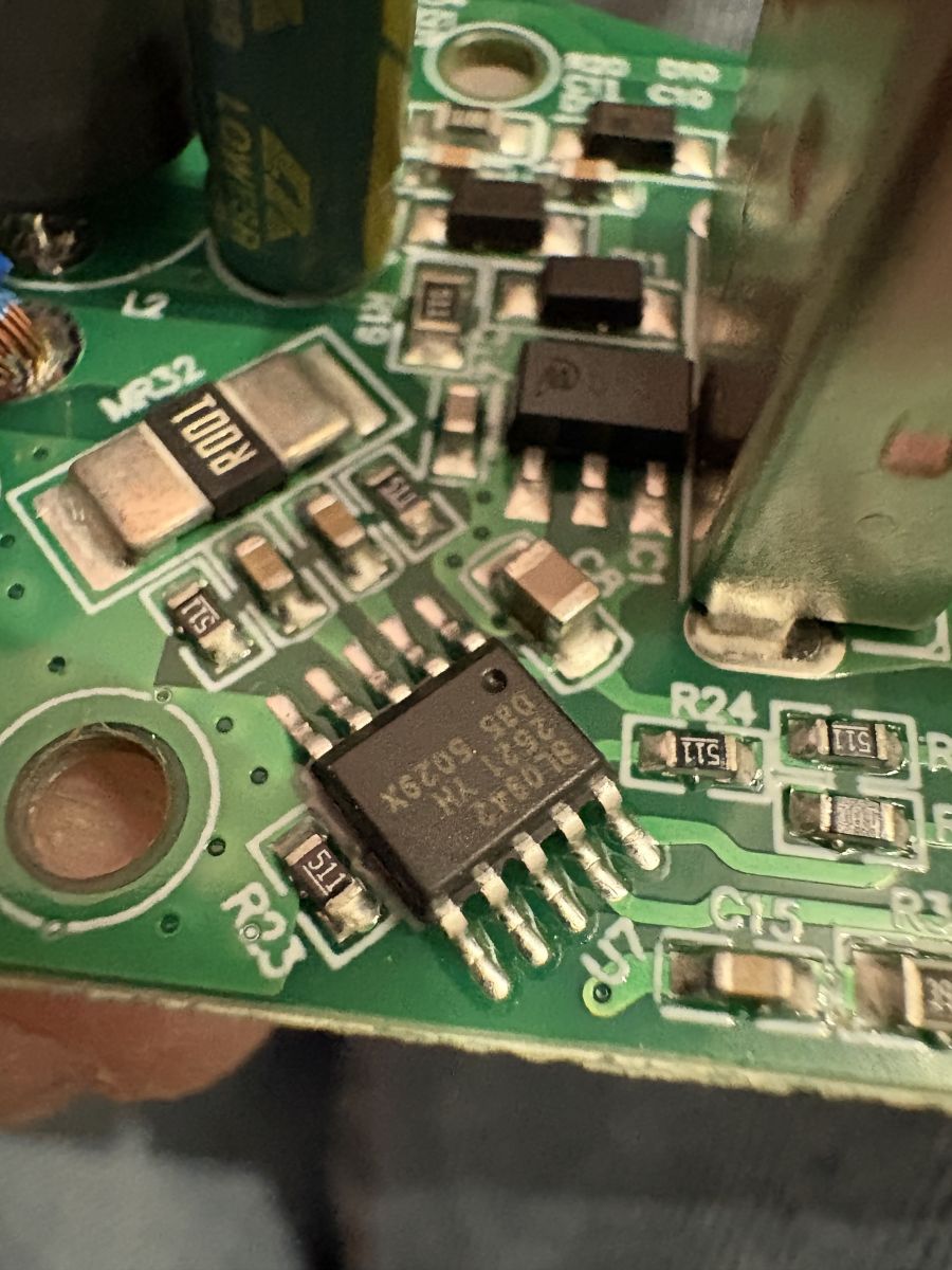

    And a BL0942 energy metering IC chip:
    Close-up of a PCB with a SOIC IC and surrounding SMD components
    The BL0942 is connected via UART to the T1-U-HL module for energy reporting.
    The device uses a T1-U-HL module. Datasheet
    This version integrates a BK7238.
    Unlike this version which uses a BK7231N.
