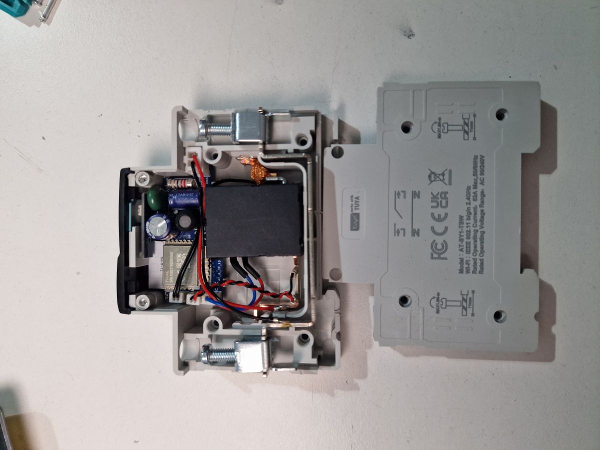

    Open device housing showing a transformer, circuit board, and wires, with the removed cover placed beside it

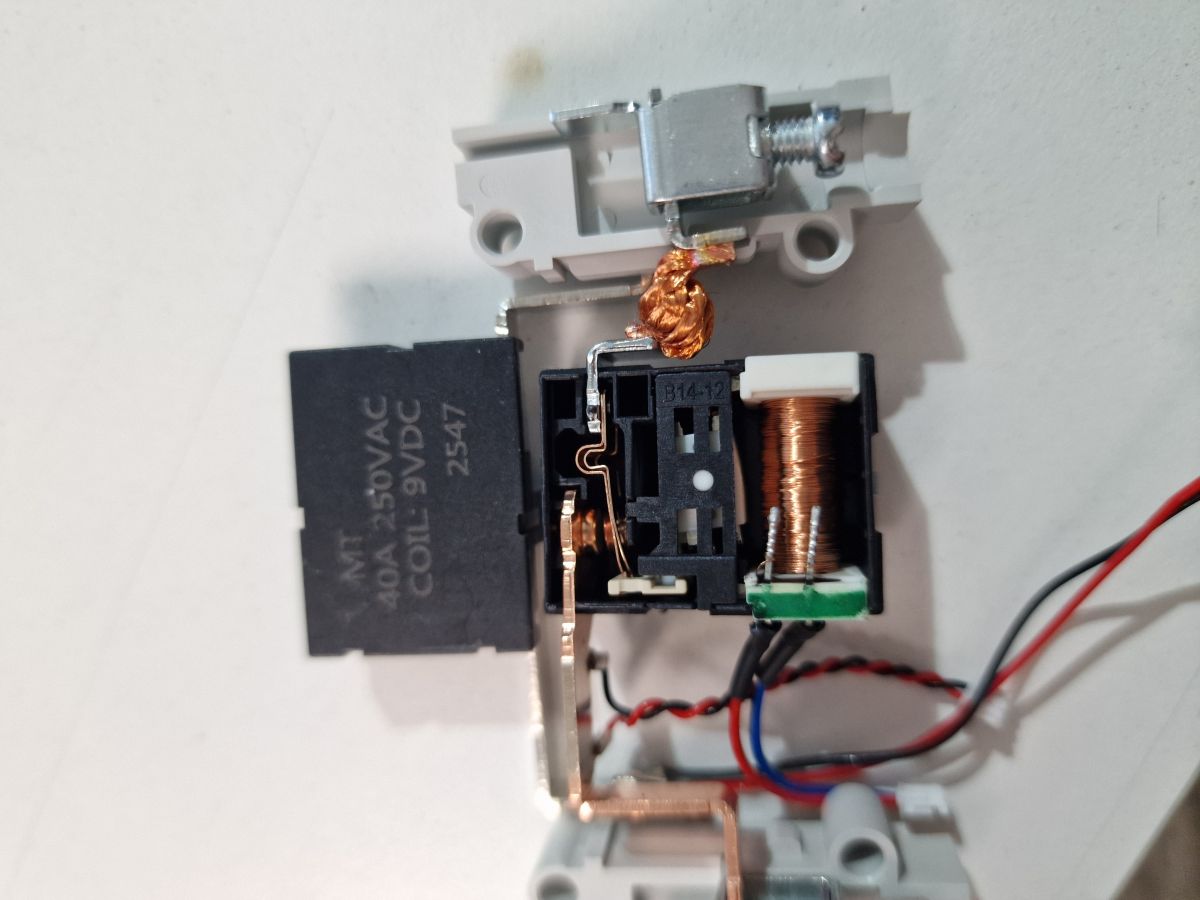

    Inside we can see main board with soldered chip, analog 100K thermistor, and interesting magnetic relay, that can be fixed in both states.
    Here is inside of the relay
    Disassembled electromechanical relay showing coil, contacts, and wires on a white surface.
    I have removed the chip from main board and flashed it with GUI tool. Seems like it can be flashed without detouching.
    Important thing is to enable Bridge driver so the relay do not overheat.
