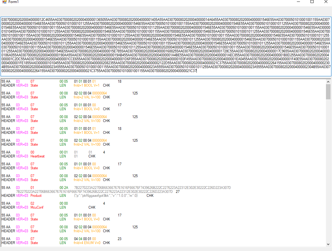

    I'll break out the uart and take some captures of the comms to see how they communicate later on.

    For a start, let's capture some TuyaMCU data. Do not flash OBK yet.
    All you need to do is:
    1. 3.3V LDO power supply (connect GND and 3.3V)
    If you don't want to use 3.3V, it is possible to connect 5V if you have located the 3.3V LDO on the board of device. Connect 5V to input of the LDO and you will get 3.3V output for the board. Direct connection of 5V to CB3S will destroy CB3S
    2. USB to UART converter in 3.3V levels mode
    3. connect RX of UART converter to RX pin of CB3S
    4. keep UART converter connected to PC
    5. start RealTerm, baud 9600 most likely
    6. power on device by that 5V or 3.3V (do not power from mains, because it is dangerous)
    7. You should see packets in realterm
    8. then do again but in capture mode:
    Teardown & Analysis: BK7231N Tuya Smart DIN-Rail Relay & Energy Meter from AliExpress
    9. You should create capture showing device usage, something like:
    55AA0307000501010001011255AA0307000802020004000000647D55AA0307000501010001001155AA0307000802020004000000647D55AA0307000501010001011255AA0307000802020004000000647D55AA03000001010455AA0307000501010001001155AA0307000802020004000000647D55AA0301002A7B2270223A22706B6636676761616F66676F7439626B222C2276223A22312E302E30222C226D223A307D1B55AA030200000455AA0307000501010001001155AA0307000802020004000000647D55AA0307000504040001001755AA0307000803020004000000001A55AA0307000501010001011255AA0307000802020004000000647D55AA03070008020200040000005A7355AA030700080202000400000050695(...)
    above sample is from dimmer
    10. Repeat the same for TX pin of CB3S (because you can separately capture what CB3S sends to TuyaMCU, and what TuyaMCU sends to CB3S)
    11. Then I will be able to use my TuyaMCU analyzer tool to determine dpIDs and config:
    NOTE: it is also possible to skip packets capture on UART and straight up check them in OBK, but it's not always a very reliable way
    Another option would be to find some docs for an ESP8266 version of this device and use them, maybe Tuya didn't change DPid while migrating to BK....
    NOTE2: The TuyaMCU is using the same TX/RX as a flashing interface. You might have problems with flashing with TuyaMCU connected due to the interference (TuyaMCU interferes with flashing). You can disconnect TuyaMCU for the time of flashing OpenBeken to the device.

    Monitoring the RX line:
    8000000000000000000055AA010006090500020800270000000000000000000000000000000000000000000000000000000000000000000000000000000000000000000000000000000000000000
    (press button)
    55AA0307000569010001017A00000000000000000000000000
    (press button)
    55AA0307000569010001007900000000000000000000000000000000000000000000000000000000
    Monitoring the TX line:
    800000000000000000000000000000
    Through all this though, the screen shows "0V", and "OFF" on it... my guess is that it doesn't actually work properly when the mains isn't connected.
    I'll have to do these captures on 240V power O_O
    Added after 13 [minutes]:
    Okay, I took readings when powered from the mains, and it all looks much more sensible.
    There was nothing on the load side, so the voltage should read ~247V, but ~0A... I saw the thing show a couple milli-Amps on the screen occasionally, maybe it's power used to power the device itself, so you might notice a very small Amp reading...?
    It's very important to determine if the device accumulates and reports kWh internally, or if it just reports discreet readings every few moments and expects external software to accumulate? I would expect it to internally maintain and report a kWh counter, otherwise it would be quite imprecise over a long time; short spikes or noise between samples may go un-noticed.
    RX line:
    (power on)
    55AA03000001000355AA0301002A7B2270223A2272396B67326731756868796963796362222C2276223A22312E302E31222C226D223A327D0155AA030200000455AA030300000555AA03000001010455AA0307000865020004000001139055AA0307000866020004000000AA2755AA030700086702000400000032B055AA030700086802000400000032B155AA030700056A010001007A55AA030700050B010001001B55AA030700050C010001001C55AA030700080D020004000000002455AA03070016130300124653452D46373233433535383132383838355955AA0307000509050001001D55AA0307000569010001007955AA030300000555AA030300000555AA0307000509050001001D55AA03000001010455AA03000001010455AA0307000510010001012155AA0307000E0600000A09BA0000000000000000EA55AA0307000E0700000A000000000000000000002855AA0307000E0800000A000000000000000000002955AA0307000E0600000A09B00000000000000000E055AA0307000E0600000A09BA0000000000000000EA55AA03000001010455AA0307000E0600000A09B00000000000000000E055AA0307000E0600000A09A60000000000000000D655AA0307000E0600000A09BA0000000000000000EA55AA03000001010455AA0307000E0600000A09B0000000000000000CEC55AA0307000E0600000A09B00000000000000000E055AA03000001010455AA0307000E0600000A09BA0000000000000000EA55AA0307000E0600000A09C40000000000000000F455AA0307000E0600000A09BA0000000000000000EA55AA03000001010455AA0307000E0600000A09B00000000000000000E055AA0307000E0600000A09BA0000000000000000EA
    (turn relay off)
    55AA03000001010455AA0307000510010001002055AA03000001010455AA03000001010455AA03000001010455AA03000001010455AA030000010104
    (turn relay on)
    55AA0307000510010001012155AA03000001010455AA0307000E0600000A09B00000000000000000E055AA0307000E0600000A09BA0000000000000000EA55AA0307000E0600000A09BA000000000000000EF855AA0307000E0600000A09BA0000000000000000EA55AA0307000E0600000A09B00000000000000000E055AA03000001010455AA03000001010455AA0307000E0600000A09BA0000000000000000EA55AA030700051001000100200000000000000000E8000000FE00F8000000070001070000000000000018BE005000000700FF00304000180080FB04F8F0040058138800000000000008102000FF000000FF000000FE01F80000F00000FF0000BAF00086F80000788D0000C00310FF00E0080000
    Somewhere there in the last block is the power-off sequence, but I didn't note the offset when I powered the device off... I guess it's after the last 55AA sequence. Not sure if legit comms, or just noise that happens while the unit is powering down.
    TX line:
    (power on)
    55AA00000000FF55AA000100000055AA000200000155AA00030001020555AA00000000FF55AA000800000755AA00030001030655AA00030001040755AA00000000FF55AA00000000FF
    (idling)
    55AA00000000FF55AA00000000FF55AA00000000FF55AA00000000FF55AA00000000FF55AA00000000FF
    (power off)
    0000000000080600FF0000E8FC000800EA010800880000000008F000088000087D000004CE00FC0000C00000BB00F0006000000104080018FC00F0180404001002BF0000F000000000
    (press button)
    (press button)
    TurkeyMan wrote:
    RX line:
    (power on)
    (turn relay off)
    (turn relay on)
    They even send a string:
    HEADER	VER=03	State		LEN	fnId=19 Str V=FSE-F723C558128885	CHK
    What is FSE-F723C558128885?
    fnId6 is not yet on the small list but:
    55 AA 03 07 00 0E 06 00 00 0A 09BA000000000000000E F8
    HEADER VER=03 State LEN fnId=6 Raw V=09 BA 00 00 00 00 00 00 00 0E CHK
    09BA looks like a big endian 2490, maybe this RAW packet is a custom version of voltage packet?
    TurkeyMan wrote:
    TX line:
    (power on)
    (idling)
    (power off)
    I could try to decrypt more and then add support to OpenBeken, but I would need, for instance, a sample with 60W bulb load and then a sample with 10W bulb load so I can compare the data

  • Need mains power to capture UART traffic
    #10 20324719
    TurkeyMan
    Posts: 59
    Rate: 9
    How else to capture UART readings?
    3.3V is available on the module, but powering the wifi module with 3.3V didn't also power the Tuya MCU circuit... so I can flash the wifi module, but I couldn't take any communication readings because the Tuya wasn't live.
    Another problem was with no mains connected; when powering the whole thing with 5V which included the Tuya and screen, the device just said "OFF" and there was basically no relevant communication.
    I couldn't capture anything useful without the power supply available. I mean, I'll try not to kill myself!

  • #12 20365102
    Posts: 14755
    Rate: 12881
    Would you be able to make a firmware backup?
    You can try this new tool:
    or hid_download_py...
    Just do "read" operation, select N platform.
    Here's an example of doing TuyaMCU device support:
    https://www.elektroda.com/rtvforum/topic3928897.html#20281707
    I will plug your data into my tool/simulator and check.
