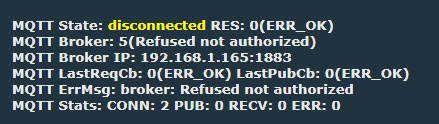

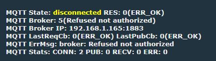

    I've tried to add more meaningful feedback about MQTT status in this build: https://github.com/divadiow/OpenBK7231T_App/tree/mqttfeedback
    eg, wrong HA password in 1.18.261:
    Screenshot of MQTT status messages showing “disconnected” and PUB/RECV counters.
    with PR build:
    Screenshot of MQTT logs showing disconnected state and “Refused not authorized” broker error.
    might not help, but worth a go?

    >>21842848 Thanks. I got it solved. I wasn't logging in, even though the username/pw were correct. I added a new login and things are good. You're great!
  • #4 21846285
    jackbridgeselek
    Created a new login.
