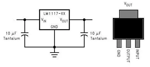

    staszekrpmechatronik wrote:
    It seems to me (although I could be wrong) that the brightness (or rather darkness) is due to the insufficient voltage that the esp32 gives, however, I do not get a different result by connecting 3.3v to the VIN, (I deliberately do not connect 5V to the VIN because as far as I know the esp32 does NOT operate on 5 volts but 3.3V) and I do not want to experiment without because I do not want to damage anything.
    The ESP32 runs on 3.3V and 5V will damage it, but what makes you think the VIN is the same as the VDD on your board? What model of board do you have?
    The vast majority of boards like yours are USB powered, with 5 V. There is an LDO 3.3 V AMS1117-3.3 on board, which provides 3.3 V with 5 V at the input. VIN is the pin designation of the input, if you feed 5 V to VIN, it will only pass through the LDO AMS1117-3.3 and when lowered you will get 3.3 V at the ESP.
    LM1117 regulator schematic with 10 µF capacitors and a package pinout labeled GND, OUTPUT, INPUT
    Pinout diagram of LM1117-ADJ LDO regulator labeled VIN, VOUT, and ADJ/GND
    Don't just confuse VIN with VDD, because if you gave 5 volts to VDD (directly) on your board, you would then damage the ESP, as you wrote.
    Do you have a multimeter? You could, as an exercise, check for yourself with a multimeter where VIN goes , and where VDD goes on your board. Locate the AMS1117-3.3 on it, you have the pins in the pictures from me.

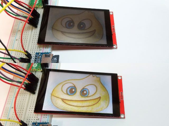

    After connecting the display as in the video by adding 3V3-3.3V and GND-GND as intuition says the display starts and moreover displays shapes and what it should however the picture is DRAMATICALLY dark
    Perhaps this display should be supplied with 5 volts. As you can see in the picture, the display has a 3.3 V regulator on the board.
    This page (to be translated) describes and illustrates the difference between the power supply methods.
    Link
    Two photos of a TFT display module on a breadboard with wires, showing a cartoon face with different brightness

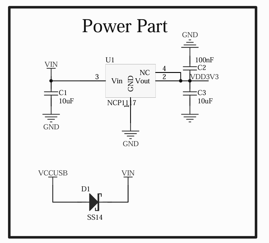

    #9 21850108
    inot
    Posts: 3567
    Help: 441
    Rate: 803
    Power schematic: NCP1117 regulator from VIN to VDD3V3 and SS14 diode between VCCUSB and VIN
    According to the diagram, the VIN is connected via a diode to the USB voltage. You can measure whether there is actually a voltage of this value on this pin.
    The example circuit Link also uses this solution.

    #10 21850126
    Posts: 48
    I have 5.11 volts between ground and VIN. I have no idea where the 0.11 volts is coming from. USB from the computer, so it should be stable. The multimeter has never fooled me. I'm connecting VIN to 5 volts of the display - hopefully it will work.
