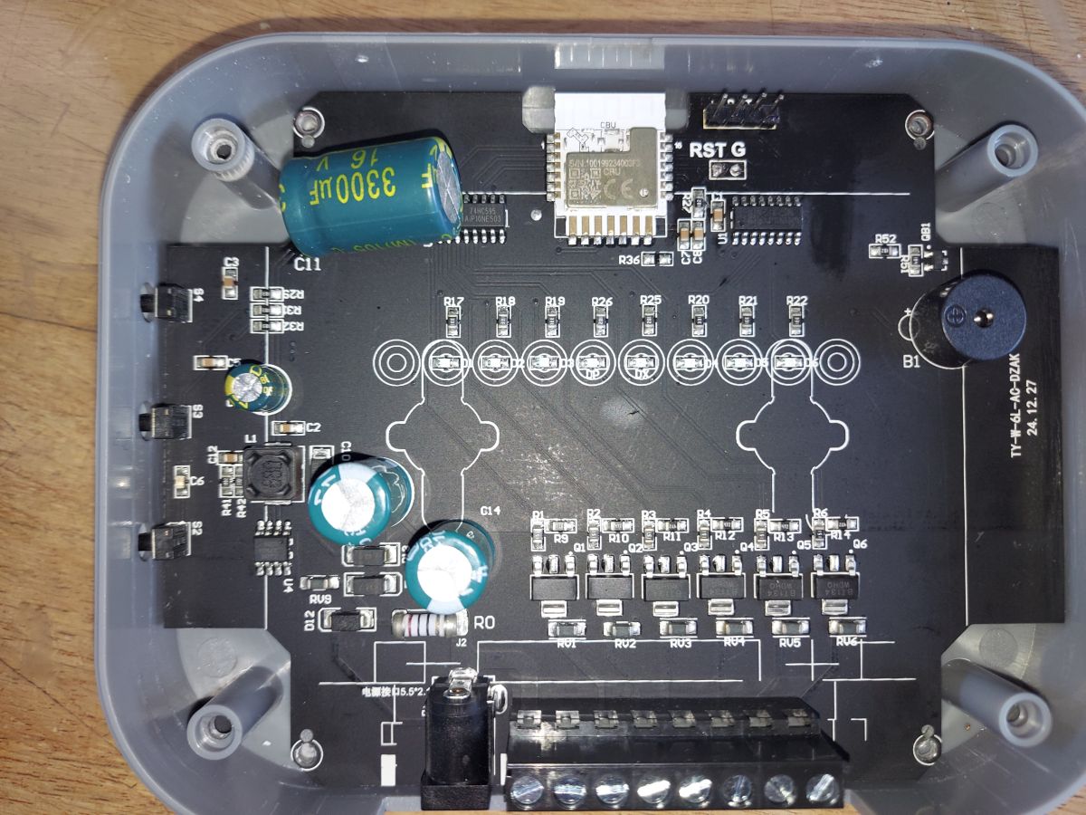

    The device uses a CBU module (BK7231N) and contains two separate 74HC595 shift registers.
    PCB inside a gray enclosure with capacitors, a radio module, a buzzer, and a screw terminal block

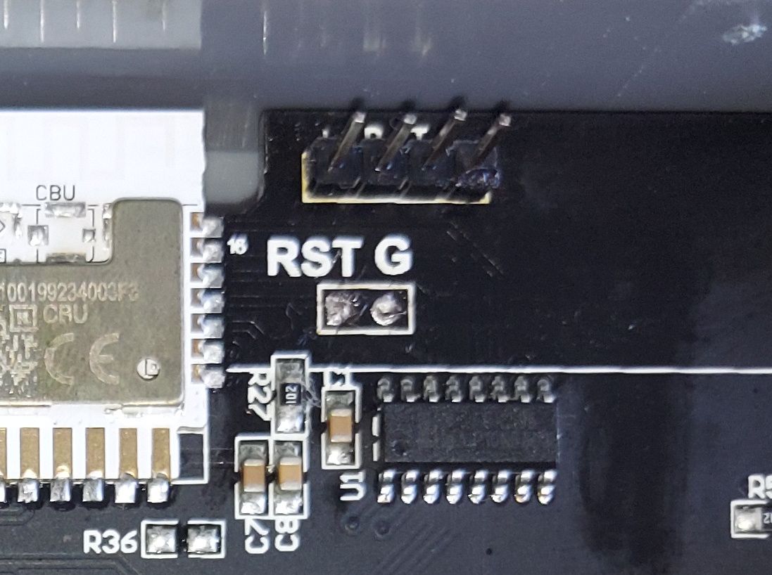

    The board is quite well designed for flashing. It even has a pin header footprint that directly exposes +3.3V, RX, TX and GND. This is quite rare on Tuya device and made flashing very straightforward.
    Close-up of a PCB showing “RST G”, a pin header, and SMD components
    There are two 74HC595 shift registers on the board:
        The right 74HC595 controls the Triacs that switch the 24V outputs to the valves.
        The left 74HC595 is used only for the status LEDs on the front panel.

    Because of the convenient pin header, flashing was very easy. I connected a USB-UART adapter and flashed OpenBeken without any need to cut traces or solder wires.
