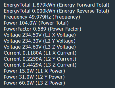

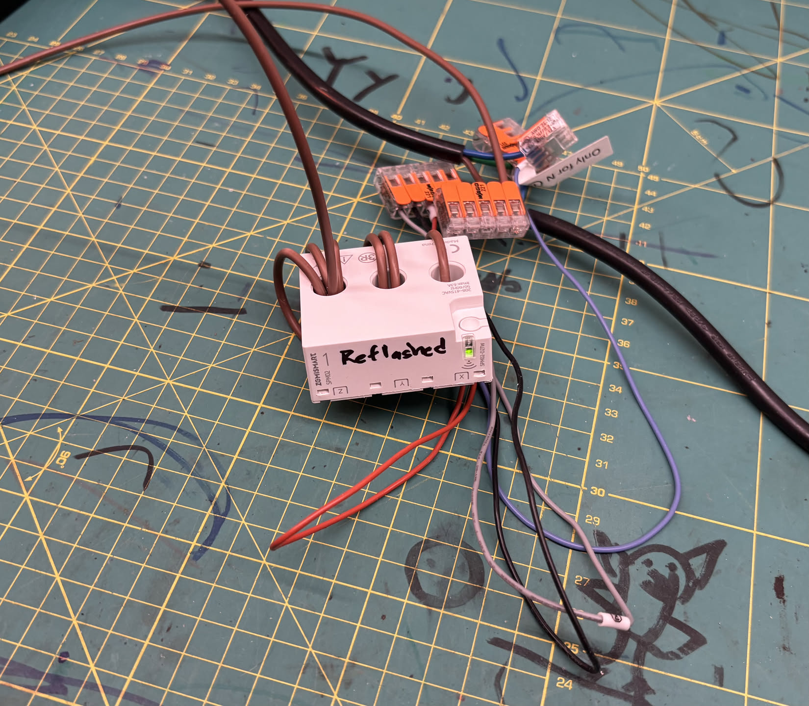

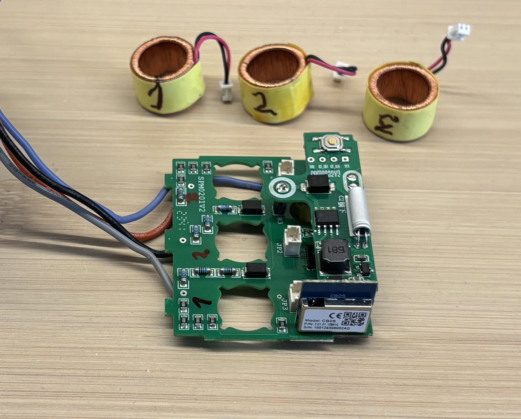

    OpenBeken Support for Tuya 3 Phase Powermeter (ZGMISMART-SPM02)
    thx to divadiow, John_SolderWick and Egzi for the infos!
    Autoexec.bat
    startDriver TuyaMCU
    startDriver httpButtons
    // emulate being connected to cloud
    tuyaMCU_defWiFiState 4
    setChannelLabel 1 "Energy Forward Total"
    setChannelType 1 EnergyTotal_kWh_div100
    setChannelLabel 2 "Energy Reverse Total"
    setChannelType 2 EnergyTotal_kWh_div100
    linkTuyaMCUOutputToChannel 23 val 2
    setChannelLabel 3 "Frequency"
    setChannelType 3 Frequency_div100
    linkTuyaMCUOutputToChannel 32 val 3
    setChannelLabel 4 "Current Unbalance"
    setChannelType 4 ReadOnly_div100
    linkTuyaMCUOutputToChannel 130 val 4
    setChannelLabel 5 "Power Total"
    setChannelType 5 Power
    linkTuyaMCUOutputToChannel 29 val 5
    setChannelLabel 6 "Power Factor"
    setChannelType 6 PowerFactor_div100
    linkTuyaMCUOutputToChannel 50 val 6
    setChannelLabel 7 "L1 Voltage"
    setChannelType 7 Voltage_div10
    linkTuyaMCUOutputToChannel 103 val 7
    setChannelLabel 8 "L2 Voltage"
    setChannelType 8 Voltage_div10
    linkTuyaMCUOutputToChannel 112 val 8
    setChannelLabel 9 "L3 Voltage"
    setChannelType 9 Voltage_div10
    linkTuyaMCUOutputToChannel 121 val 9
    setChannelLabel 10 "L1 Current"
    setChannelType 10 Current_div1000
    linkTuyaMCUOutputToChannel 104 val 10
    setChannelLabel 11 "L2 Current"
    setChannelType 11 Current_div1000
    linkTuyaMCUOutputToChannel 113 val 11
    setChannelLabel 12 "L3 Current"
    setChannelType 12 Current_div1000
    linkTuyaMCUOutputToChannel 122 val 12
    setChannelLabel 13 "L1 Power"
    setChannelType 13 Power
    linkTuyaMCUOutputToChannel 105 val 13
    setChannelLabel 14 "L2 Power"
    setChannelType 14 Power
    linkTuyaMCUOutputToChannel 114 val 14
    setChannelLabel 15 "L3 Power"
    setChannelType 15 Power
    linkTuyaMCUOutputToChannel 123 val 15
    setChannelLabel 16 "L1 Power Factor"
    setChannelType 16 PowerFactor_div100
    linkTuyaMCUOutputToChannel 108 val 16
    setChannelLabel 17 "L2 Power Factor"
    setChannelType 17 PowerFactor_div100
    linkTuyaMCUOutputToChannel 117 val 17
    setChannelLabel 18 "L3 Power Factor"
    setChannelType 18 PowerFactor_div100
    linkTuyaMCUOutputToChannel 126 val 18
    setChannelLabel 19 "L1 Energy Forward Total"
    setChannelType 19 EnergyTotal_kWh_div100
    linkTuyaMCUOutputToChannel 109 val 19
    setChannelLabel 20 "L2 Energy Forward Total"
    setChannelType 20 EnergyTotal_kWh_div100
    linkTuyaMCUOutputToChannel 118 val 20
    setChannelLabel 21 "L3 Energy Forward Total"
    setChannelType 21 EnergyTotal_kWh_div100
    linkTuyaMCUOutputToChannel 127 val 21
    setChannelLabel 22 "L1 Energy Reverse Total"
    setChannelType 22 EnergyTotal_kWh_div100
    linkTuyaMCUOutputToChannel 110 val 22
    setChannelLabel 23 "L2 Energy Reverse Total"
    setChannelType 23 EnergyTotal_kWh_div100
    linkTuyaMCUOutputToChannel 119 val 23
    setChannelLabel 24 "L3 Energy Reverse Total"
    setChannelType 24 EnergyTotal_kWh_div100
    linkTuyaMCUOutputToChannel 128 val 24
    setChannelLabel 25 "Data Report Duration"
    setChannelType 25 TextField
    linkTuyaMCUOutputToChannel 102 val 25
    setChannelLabel 26 "Device Locating"
    setChannelType 26 Toggle
    linkTuyaMCUOutputToChannel 101 val 26
    setButtonEnabled 1 1
    setButtonLabel 1 "Query State"
    setButtonCommand 1 tuyaMcu_sendQueryState
    setButtonEnabled 2 1
    setButtonLabel 2 "Refresh"
    setButtonCommand 2 "tuyaMcu_sendState 35 enum 0"
    setButtonEnabled 3 1
    setButtonLabel 3 "Clear Counters"
    setButtonCommand 3 "tuyaMcu_sendState 12 bool 1"

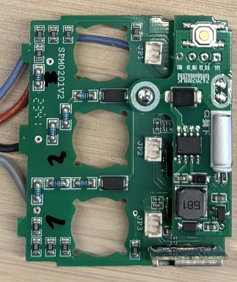

  • 1-phase test setup gives inconsistent meter readings
    #3 21905812
    John_SolderWick
    Posts: 6
    Thank you @vincenzoernst1, I didn't realize the other thread was for the v1 version, or did you update/split the threads when you realized they were not the same?
    I don't have 3-phase power here in my apartment. I created a similar 1 phase test-setup as the one you showed in the other thread, but I instead adding +1x the current per phase, like 1, 2, 3x I went for doubling it for each step. so 1, 2, 4x the power.
    [CB2S/BK7231N] ZGMISMART-SPM02 v2 - OpenBeken Tuya 3-Phase Powermeter
    With the autoexec.bat config from above these are my results. Not sure if the device support a 1-phase setup like this, or if it requires a 3-phase connection with phasors close to expected of such a system.

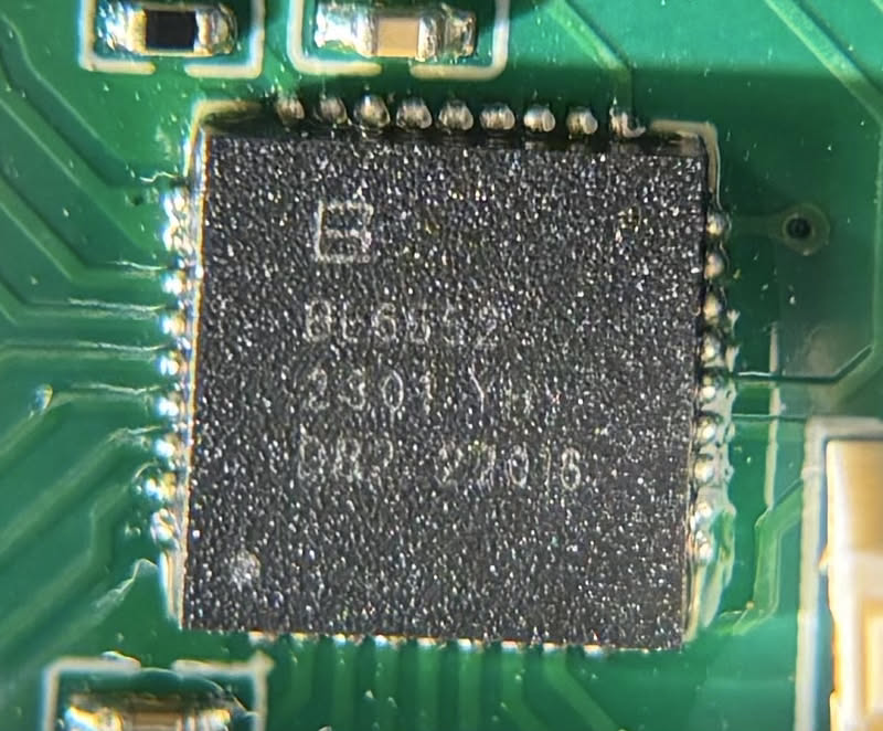

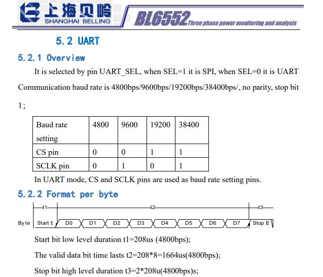

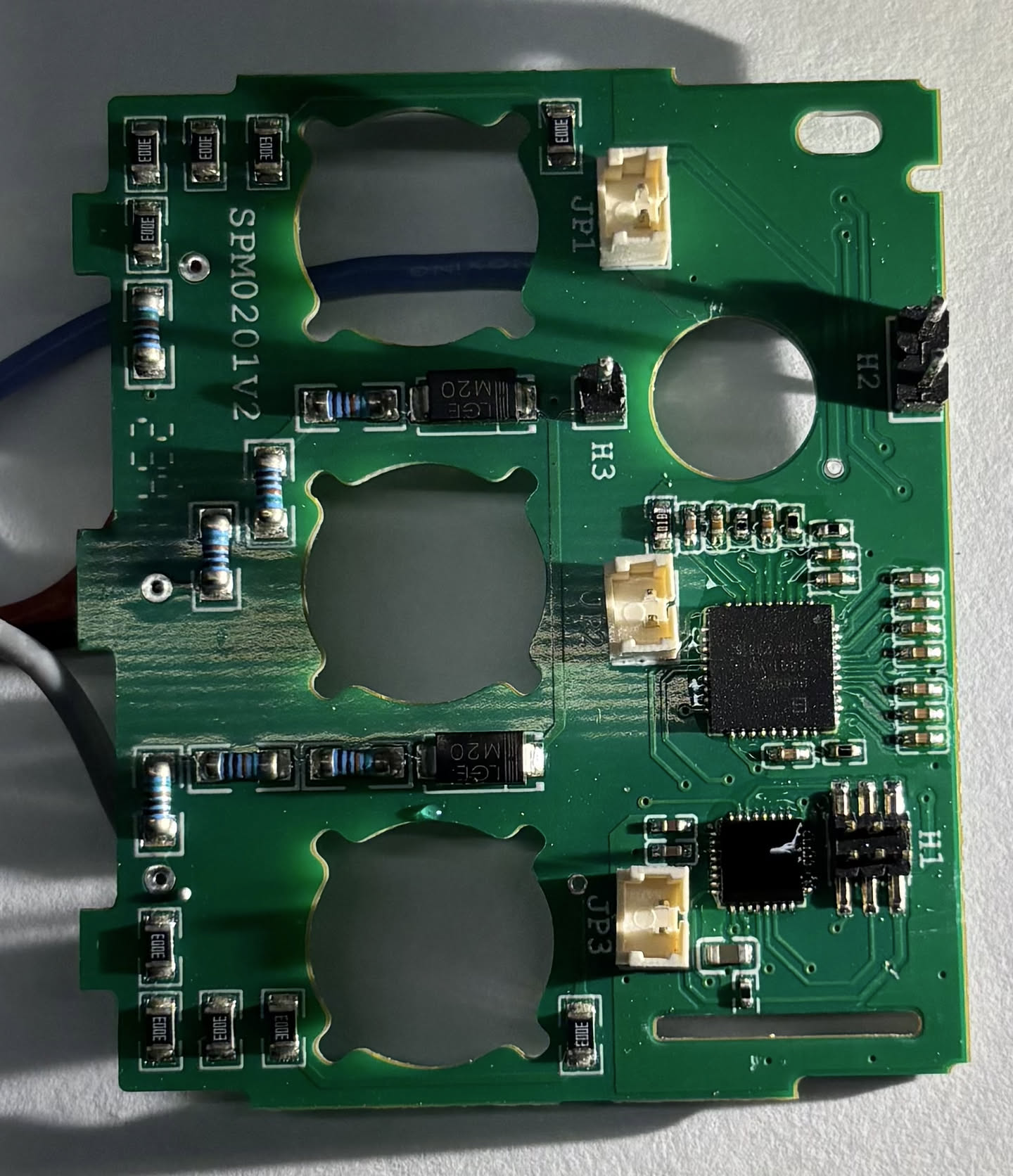

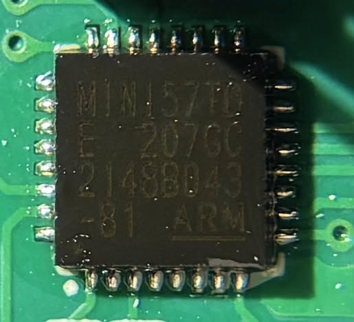

    @divadiow
    There's a second chip on it, I've already tried to see what it is, but it's covered by a second PCB and I were unable to read anything off it, at least with my bad eyes.
    I just got it all put together again after flashing. If we can get this one working I plan to flash my second unit as well, and could de-solder the extra PCB to check the IC when I have that one apart.
  • #4 21905901
    vincenzoernst1
    Posts: 100
    Rate: 7
    what load have u attached to it?
    imho it would be much easier to loop every phase the same. so every phase must show the same for now. the you see if is working right.
    you need to compare the id´ s from the json to the autoexec.bat if they match

    Tuya MCU updates expose additional powermeter dPIDs
    #7 21906169
    John_SolderWick
    Posts: 6
    I think I figured it out.
    Based on what was available in the Tuya developer portal device log dropdown, there's a lot less dPIDs for this device. But all the basic info is now available.
    Here's the mapping:
    1   Total forward energy
    6   Phase A
    7   Phase B
    8   Phase C
    9   Alarm
    12  ZERO ENERGY (no data in dev-portal logs)
    17  Alarm set1
    18  Alarm set2
    19  Product ID (Shown as SPM02_555D)
    23  Total Reverse Energy (no data in dev-portal logs)

  • BL6552 identified as the metering chip
    #9 21906433
    John_SolderWick
    Posts: 6
    @divadiow
    I took the second one apart and de-soldered the top PCB.
    There are two ICs, and they had some type of conformal coating on them. The coatings on the bigger IC had an uneven finish, so I had to scrape it off to be able to see the markings, but it was still really hard to read.
    With the top PCB removed:
    Best picture I managed to get with my phone of the bigger IC:
    The markings are:
    BL6552
    2301 YH
    D82 22016
    While searching for BL6552 I found this Polish forum thread that includes a picture where markings are clearer:
    https://forum.arturhome.pl/t/dwukierunkowy-3-fazowy-licznik-energii-spm02-d2tw/10961/47
    Just the D82 that I got wrong and thought it was 082.
    Apparently it's "a 7-channel three-phase power monitoring and analysis chip".
    https://www.alibaba.com/product-detail/BL6552...ginal-Energy-Metering-Data_1601214807755.html
    The other IC is a Novuton MINI57TDE that contains an ARM Cortex core, this must be the MCU.

    Interestingly enough, BL6552 is using UART communication. So it could work directly with OBK, once we provide a driver. TuyaMCU could be omitted.
    Screenshot of BL6552 documentation: section 5.2 UART with baud-rate table and per-byte frame diagram
    I am attaching BL6552 datasheet.
    • BL6552_V1.12_en.pdf (1.68 MB) You must be logged in to download this attachment.
