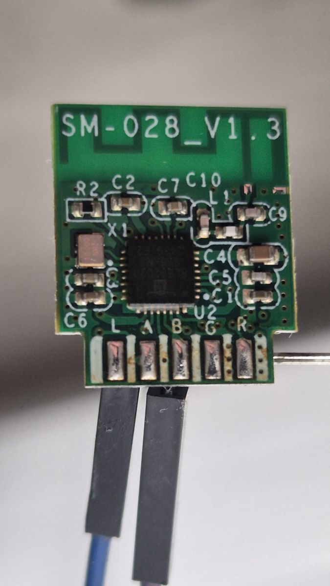

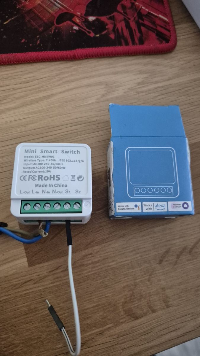

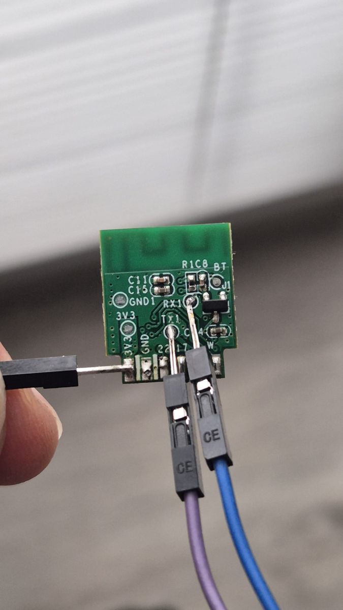

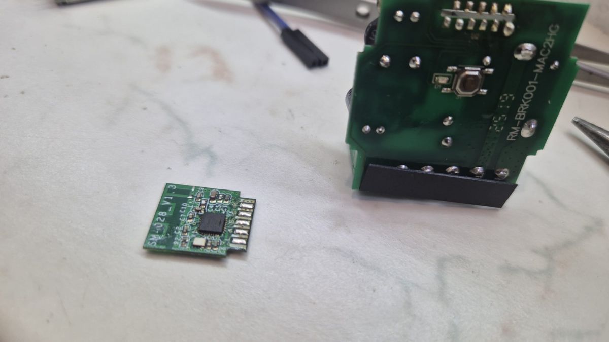

    Mini Smart Switch with wires connected, next to blue product box
    Electronic module with jumper wires connected to labeled pins Small green PCB with integrated circuit labeled SM-028_V1.3 Two electronic modules on a table, one lying flat, the other standing upright

    Another SM-028-V1.3 device, nice.
    By the way, don't solder wires like that, this method has a high risk of ripping off the pads. I usually try to trim the wires first.
    Do you have factory 2MB backup? Did you flash with our Easy Flasher?

    I know about imperfect solder method, but it is only temporary and I am very careful. I realize there is a big leverage :)
    Yes, I flashed with your tool. Works well.
    I had a problem after setting Wi-Fi SSID and SSID2 that device didn't connect to SSID 1 and did not switch to second one. So I tried to read serial monitor to get some feedback, but I didn't know the proper baud rate so I got only nonsense characters. And I had to reflash it.

    Imperfect soldering is okay as long as it works, it's just that I did the same in the past and I tore off pads that way, haha.
    totally. took me ages to work this out for some reason. now all my wires have short copper ends. much more flexible.

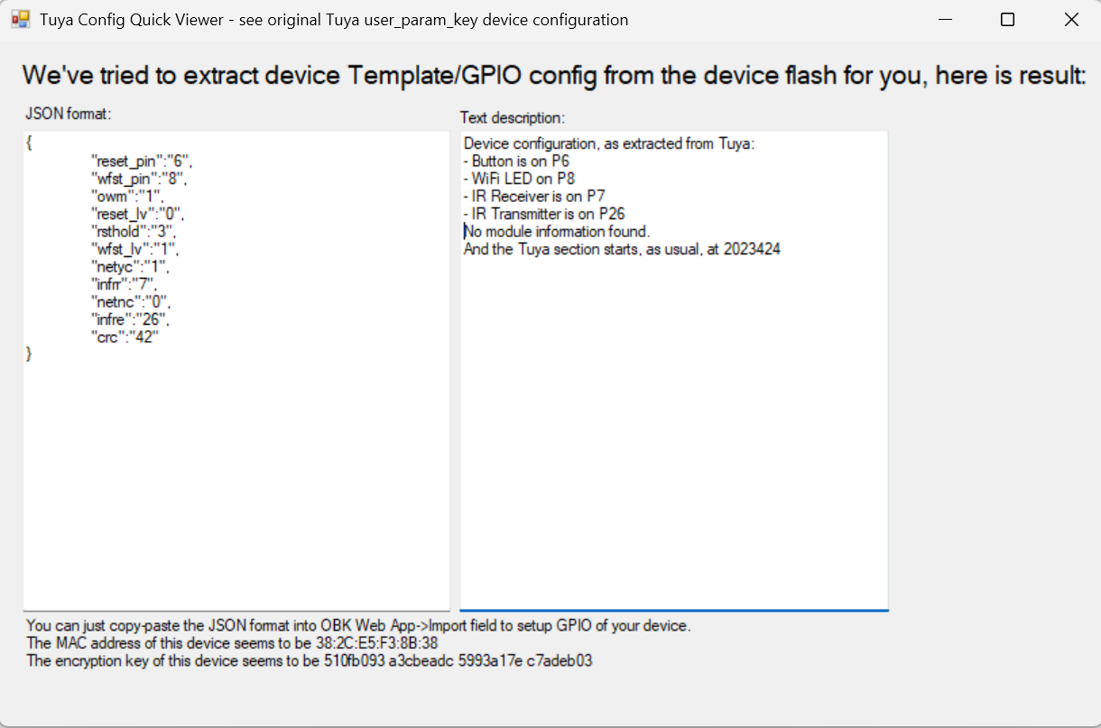

    magic81
    Posts: 7
    And how do you read pin configuration and internal logic? I flashed another chip (power meter) before, and there was config JSON and translation.

    >>21825854
    It was this:
    Screenshot showing buttons “Backup and flash new” and “Firmware backup”
    Screenshot of Tuya Config Quick Viewer showing GPIO configuration in JSON format
    So I just wondered why pin configuration was extracted on that chip, but not on BL602, that's all :)

    oh, I see. Easy Flasher only decrypts and extracts config info from Tuya KV. Your device is eWeLink.
