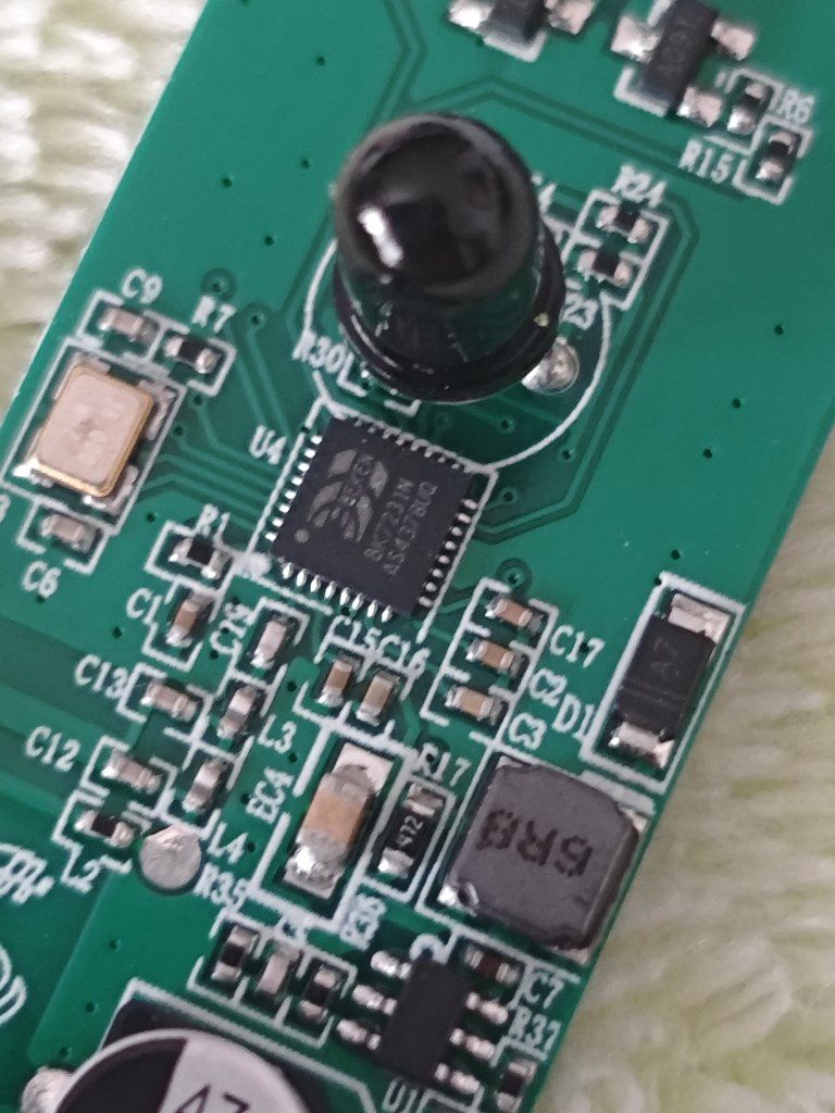

    The controller mainly consists of a BK7231N.
    Close-up of a PCB with a black sensor lens, an IC chip, and multiple SMD components

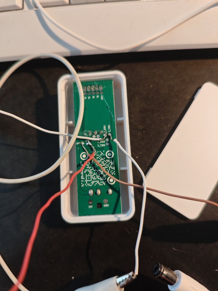

    At the bottom side of the pcb there are some named testpoints where the programmer can easily be connected.
    Green PCB in a white case with soldered wires on a black surface.
