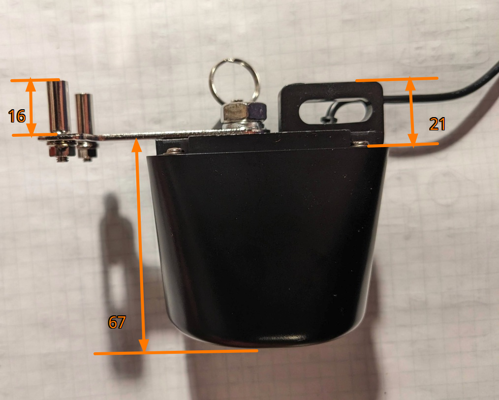

    Some photos with dimensions in mm (+/- 1 mm).
    Black square mechanism with a metal lever arm, overlaid with orange dimension lines and numbers
    Black mechanical part with bracket and cable, overlaid measurements 16, 21, and 67

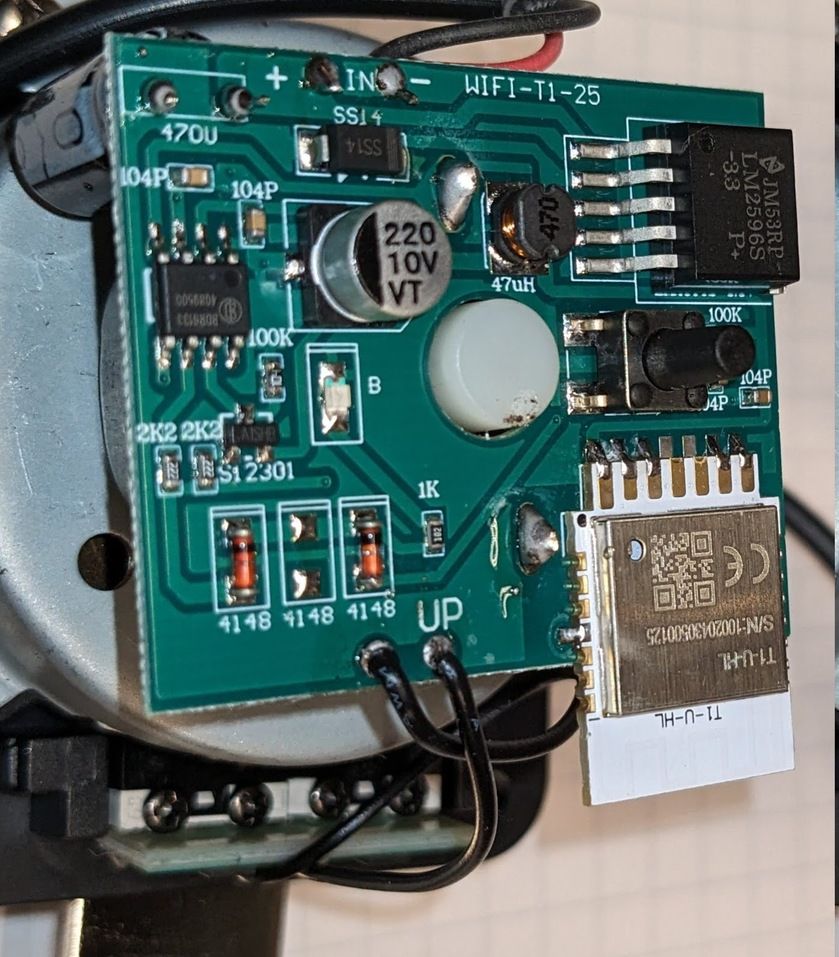

    The valve uses T1-U-HL module with Beken BK7238 MCU. I spent a little time looking for a nice SDK to program the BK7238, but found nothing. OpenBeken lists the chip as supported. I tried to build it unsuccessfully. I decided to use ESP8266 - I already have my own utility library for it. An ESP-12F would've fit nicer perhaps, but I didn't have one. I had a bunch of Wemos D1-s.
    Before the modifications:
    Close-up of a PCB with Wi‑Fi module, push button, 220 µF 10 V capacitor, and LM2596S regulator
    Close-up of an electric motor with two PCBs, wires, and electronic components mounted on top
    Besides 3V3, and GND three pins are used from the T1-U-HL:
    P24: Motor control via the BDR6133 motor driver chip.
    P09: Push button.
    P08: LED.

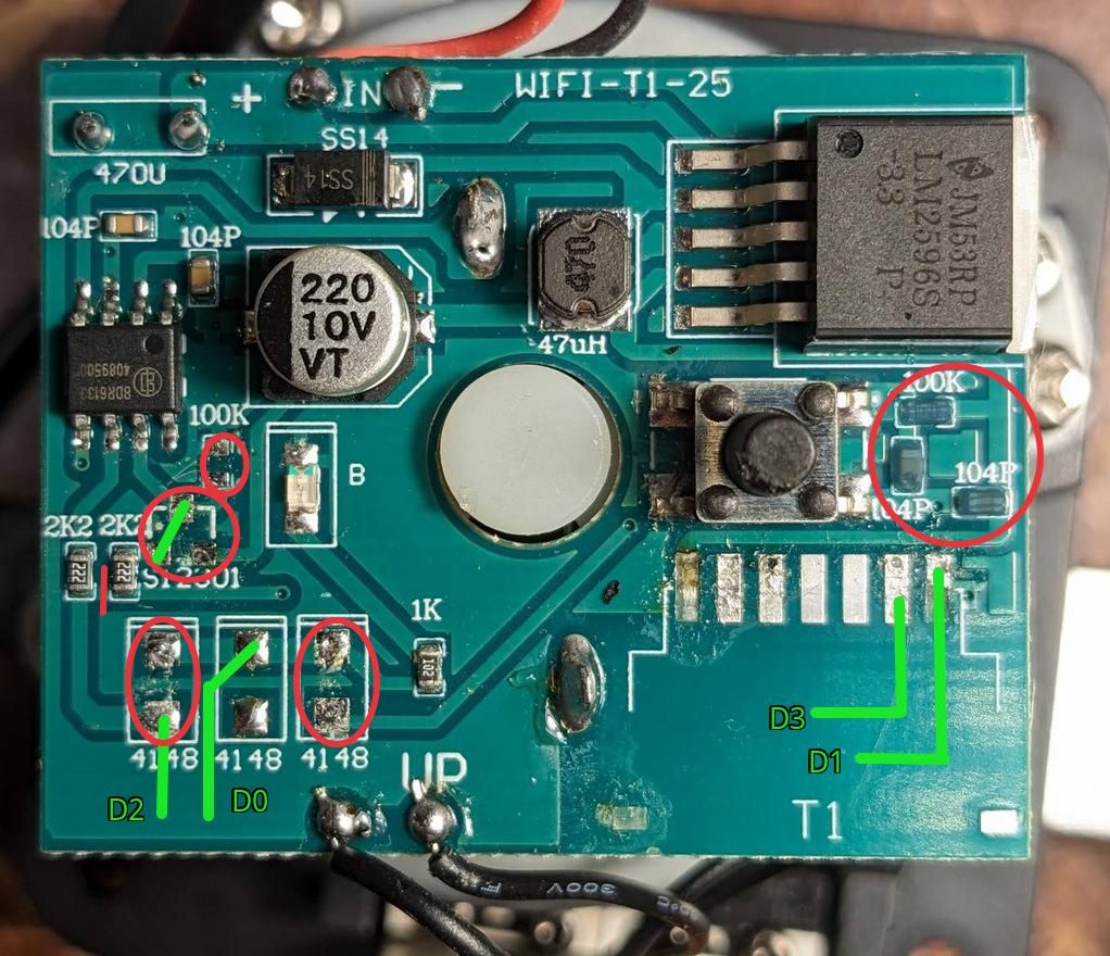

    The P24 controls the IB input, and the same signal is inverted via a transistor and fed to the IA input of the BDR6133. That means that the motor is always energized one way or another. It stops moving because of the limit switches and diodes that disconnect one of its terminals. Changes I made:
    (1) Individually control IA and IB. That way I can have them both LOW, and the motor would not be energized (both its terminal at 0V) and not move at all.

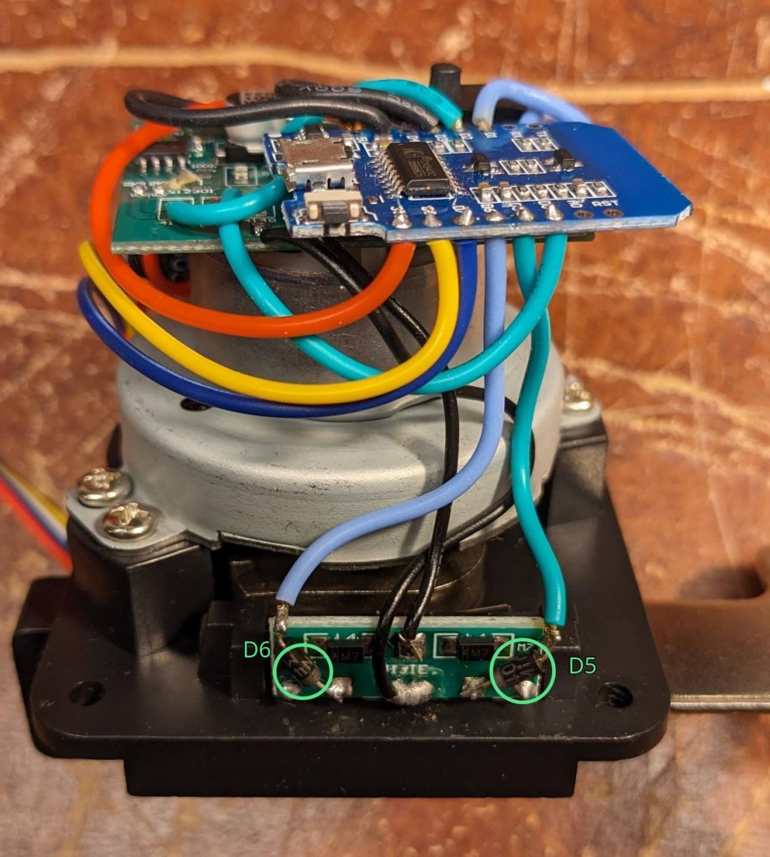

    (2) Read the state of the valve. Two microswitches are used, but only their NC contacts. I connected two inputs of the ESP8266 to the unused NO contacts via diodes to keep the motor's 12V away from the MCU. Before reading the inputs I ensure the motor is off (both IA and IB LOW). That way I read LOW from one of the switches depending if the valve is closed or open. Both read HIGH when the valve is mid-way. Reading the switches while the valve is moving proved ambiguous.
    Close-up of a PCB with components, red circles, and green labels D0–D3
    The above image tries to show the modifications. Although I haven't made all of them when I took the photo. And I forgot to take a photo when I did. Some of the changes can be seen on the following images.
    The red markings show removals. Green ones - new connections. From left:
    * Cut the trace connecting the two resistors for the IA/IB inputs. Now they can be controlled separately.
    * Removed the transistor and its resistor that inverts the IB signal for the IA input. Don't need them any more. Added a jumper to connect the 2K2 resistor to the IA input now that the transistor is gone.
    * Removed two diodes. The LED was lit from various sources, and the diodes isolated them.
    * Removed the pull up resistor and two capacitors - debounce circuit for the push button I guess.

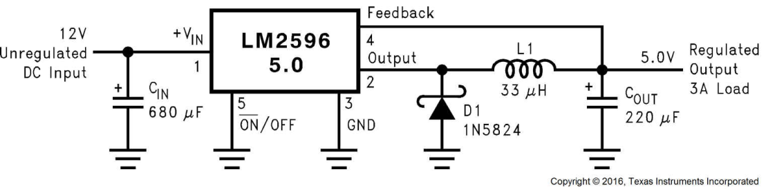

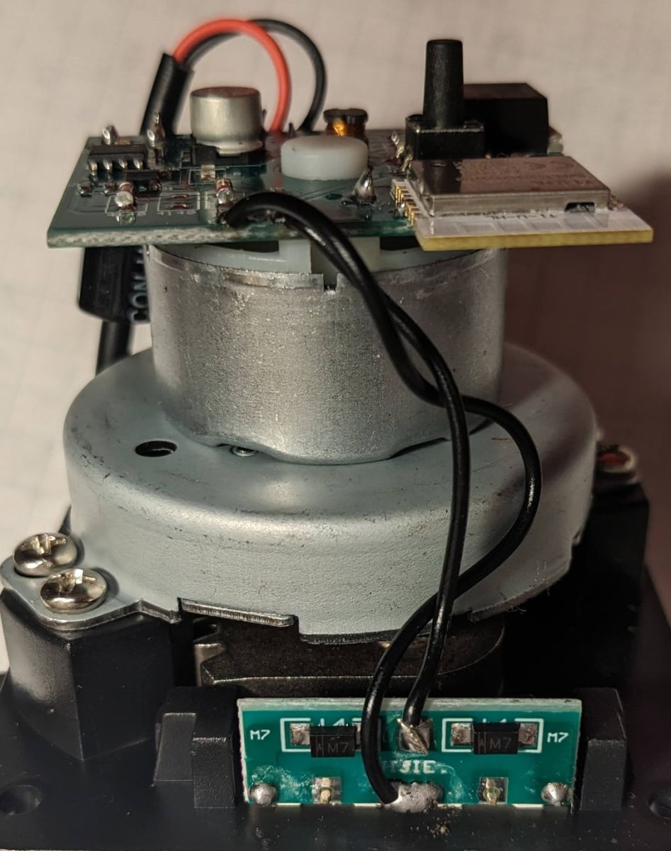

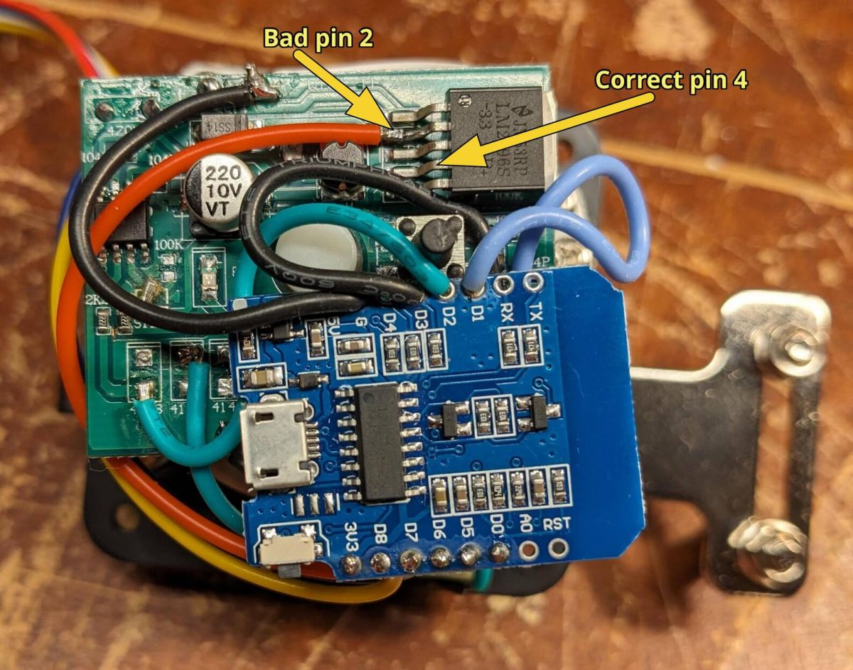

    The last item may not have been needed. Initially I sourced 3V3 from pin 2 (Output) of the on-board LM2596. I had continuous stability problems with the ESP8266. Until I took a look at the typical LM2596 application, which is being used.
    Schematic of LM2596 5.0 buck converter: 12 V input, 33 µH inductor, 5 V 3 A regulated output
    And while troubleshooting those issue, I got rid of the button's RC circuit.
    Photos with the modifications. But before I fixed my power issue.
    Close-up of PCB boards with wires; arrows label IC pins “Bad pin 2” and “Correct pin 4”.
    Close-up of PCB boards with multicolored wires mounted on a motor; D5 and D6 circled and labeled.

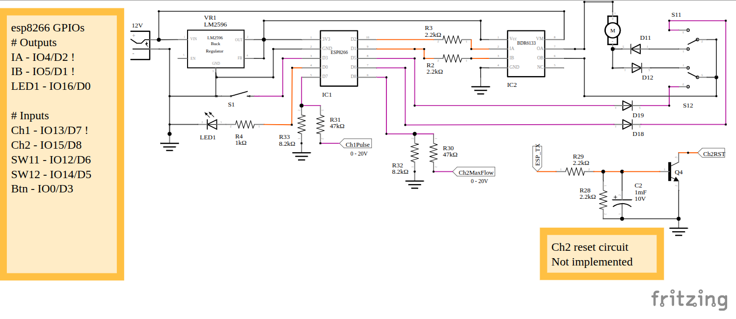

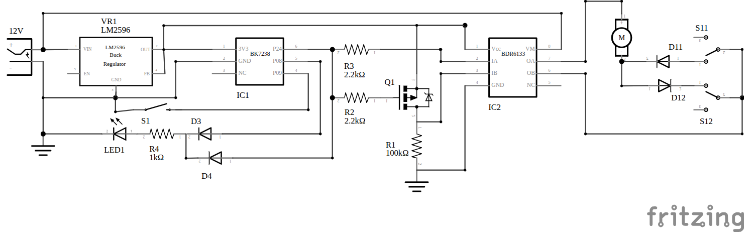

    Here are some circuit diagrams. They are missing supporting components around LM2596, and BDR6133. But should capture the changes I've made.
    Before:
    Circuit diagram with 12 V input, LM2596 buck regulator, and BDR6133 motor driver
    After:
    Circuit diagram with ESP8266, LM2596 buck regulator, and BDR6133 motor driver plus Ch1/Ch2 inputs.
