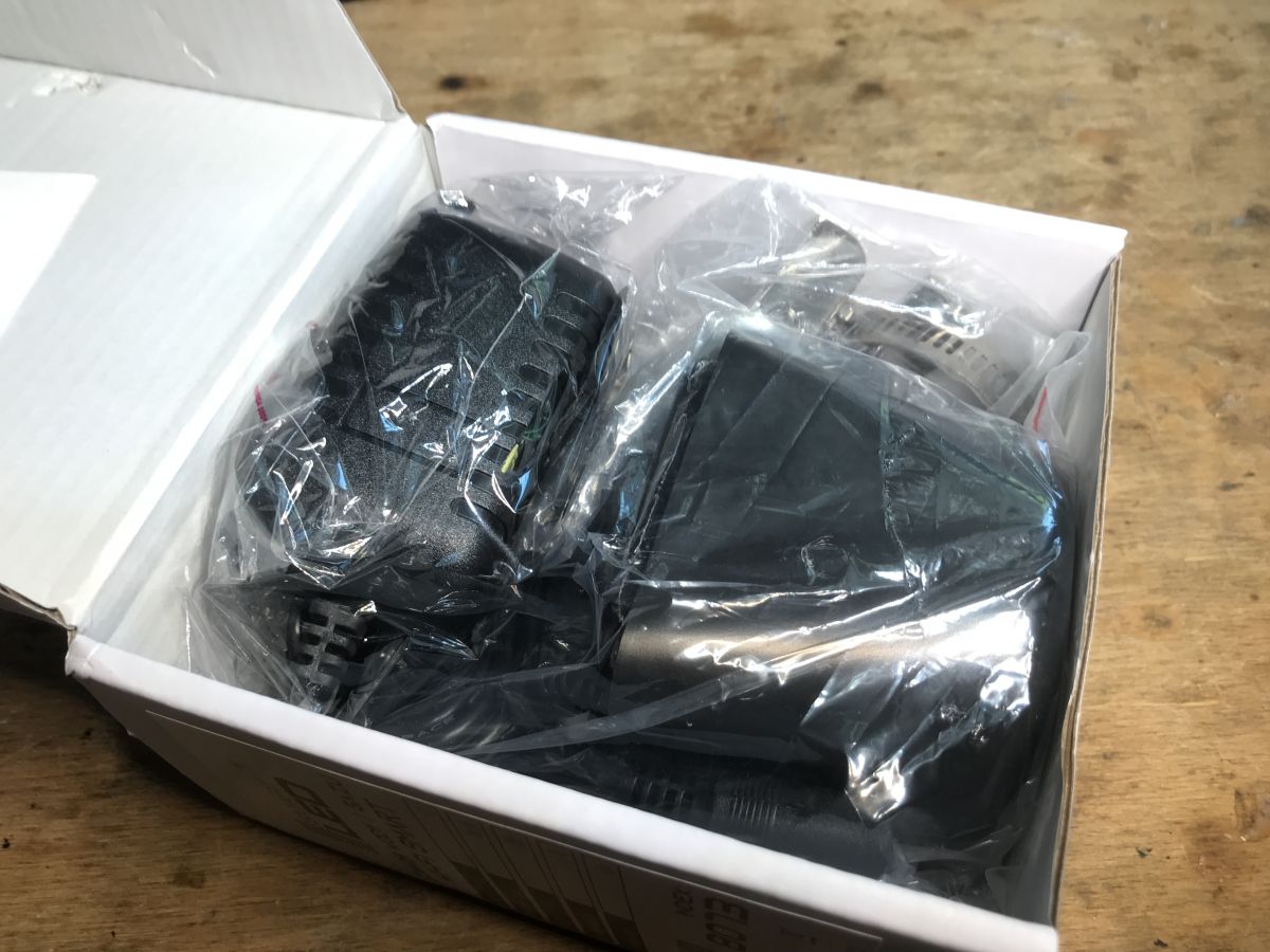

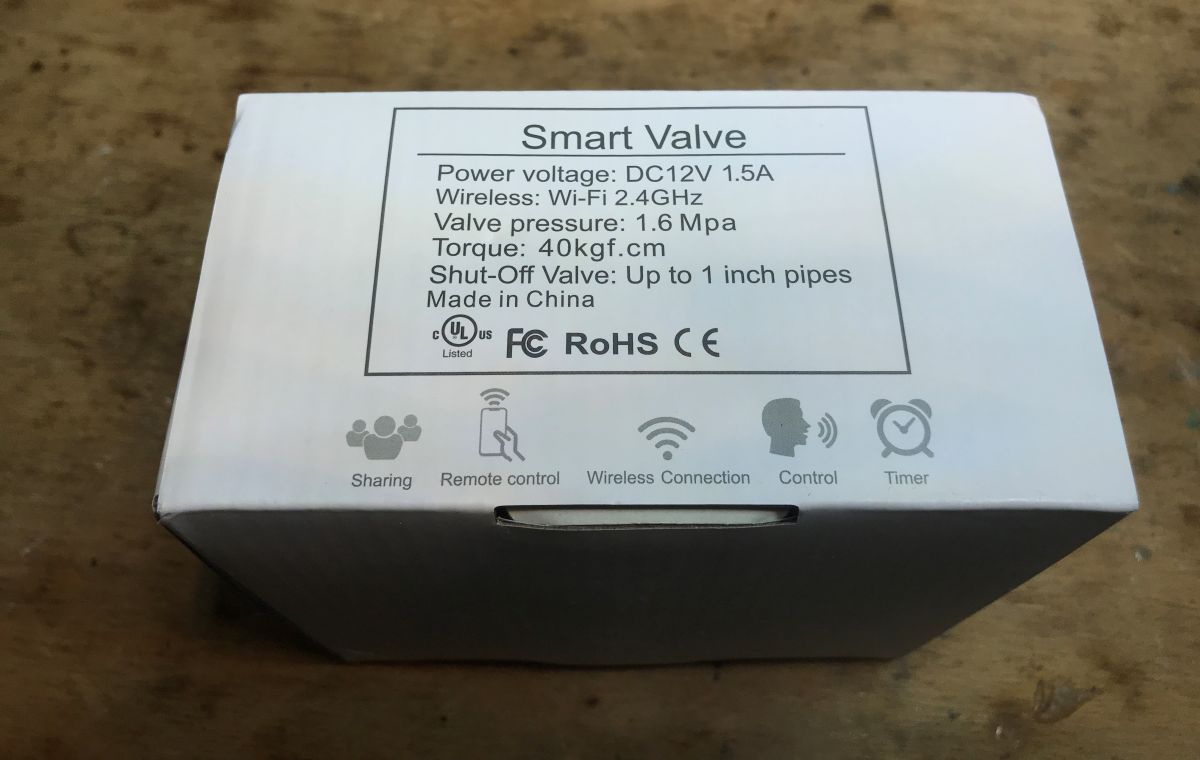

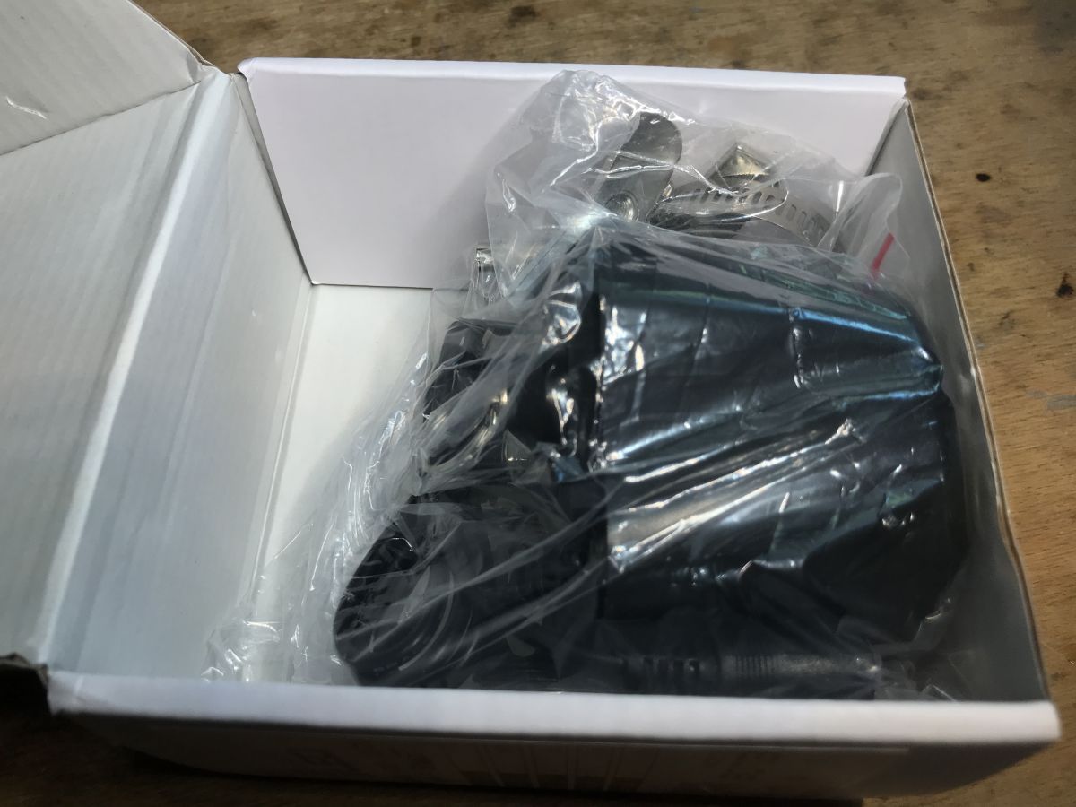

    After placing the order, we receive a box like this:
    Box of Jinvoo SM-AW713 smart WiFi valve. A white box labeled SmartLED 8073, showing a description of the WiFi water/gas valve functions. Close-up of Smart Valve box with technical specifications. .
    Kit contents:
    Jinvoo SM-AW713 set in packaging Contents of the box with the Jinvoo SM-AW713 smart valve WiFi controller. Box with Jinvoo SM-AW713 valve controller set and accessories. WiFi valve controller kit, packaged in transparent plastic and a cardboard box. .
    Even the power supply is included. This is rather a plus, although I would always find one at my place already for this purpose.

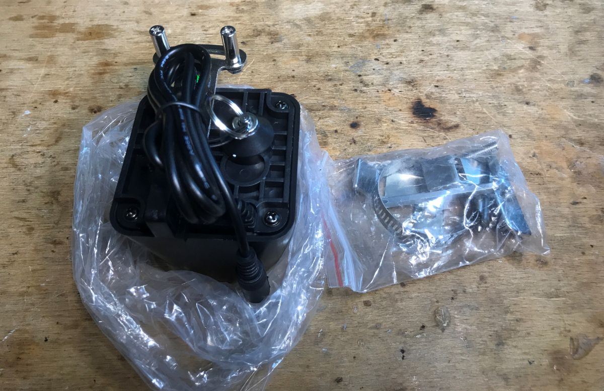

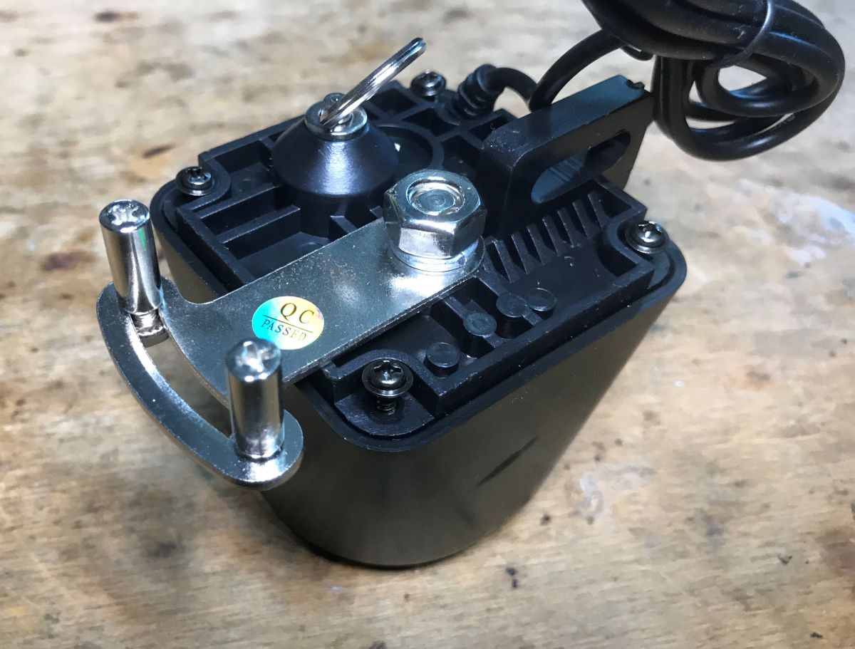

    Here is the main mechanism, the mounting parts are in the bag:
    Mounting components and the smart WiFi valve controller. .
    View of the valve overlay with a black housing and mounting mechanism on a wooden surface. .

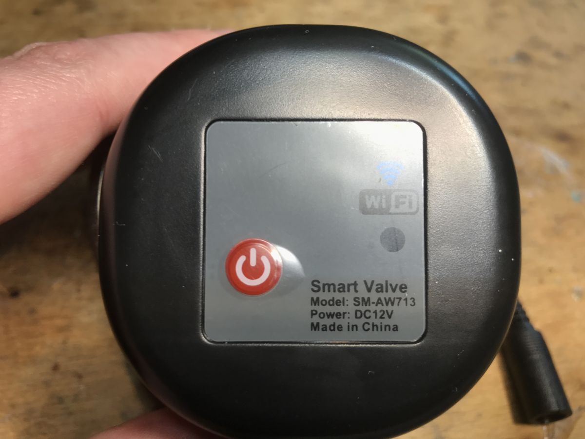

    The case reveals to us the actual model of the device - SM-AW713, this 8073 is just the importer's designation:
    Jinvoo SM-AW713 water/gas valve cover .

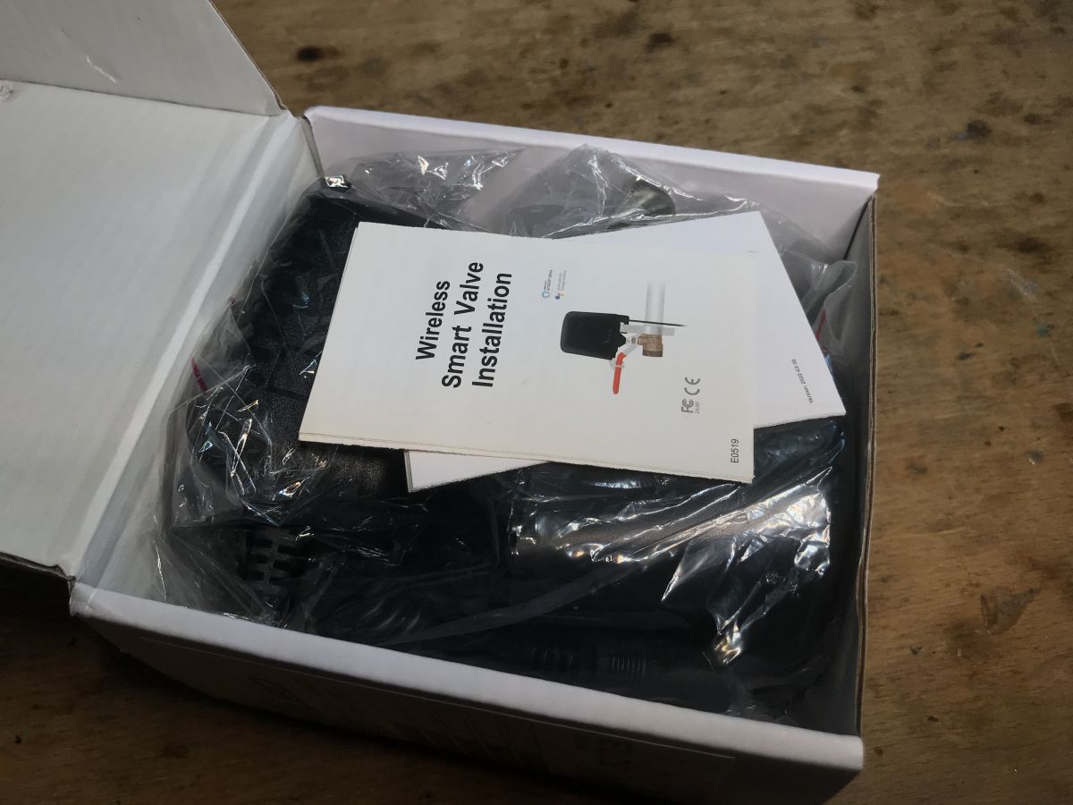

    Instructions (including a description of how to put the device into pairing mode with the Tuya app, but we don't really need that):
    WiFi smart valve installation manual Instruction leaflet of the Jinvoo SM-AW713 smart valve controller on a wooden table. .

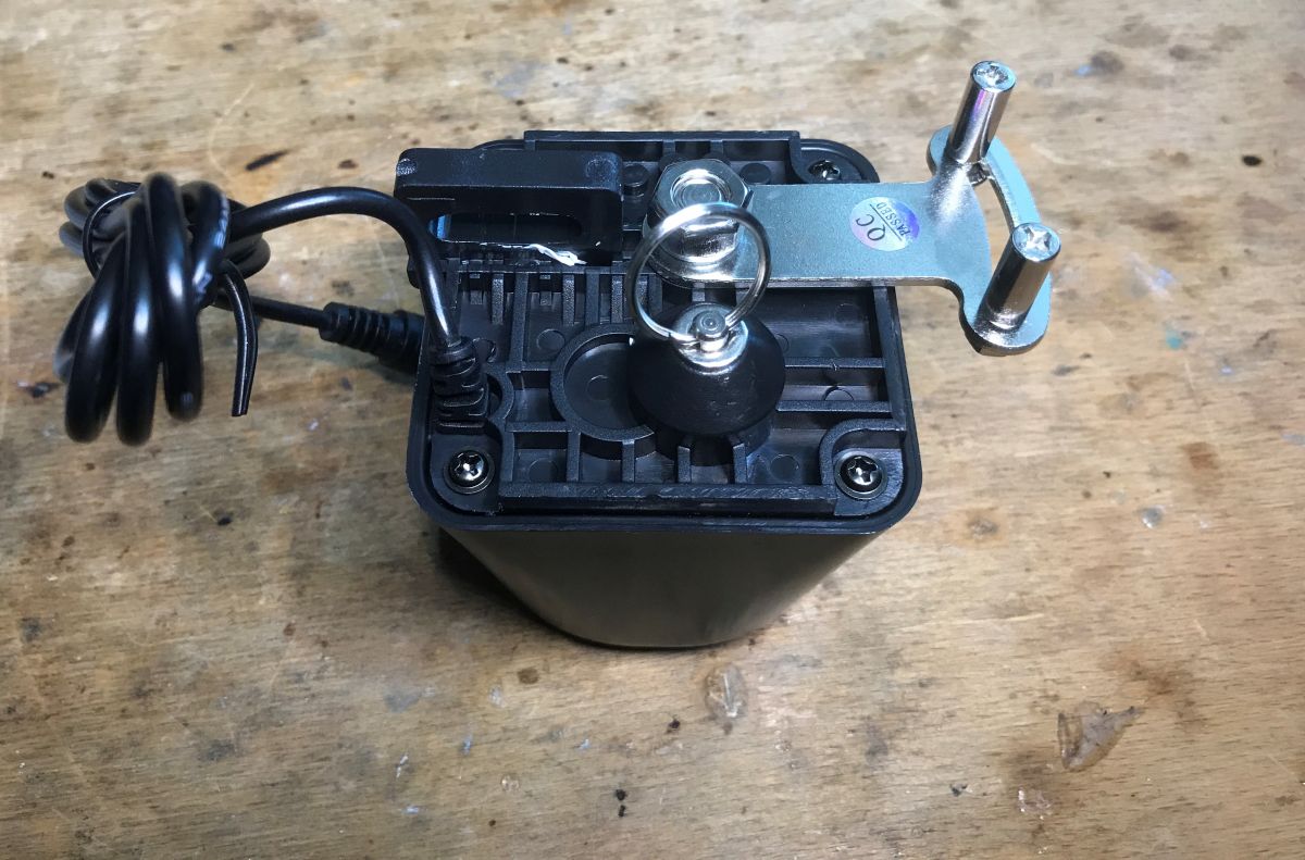

    Interior of Jinvoo SM-AW713 .
    Remove the four screws:
    Jinvoo SM-AW713 valve cover with mounting components. .

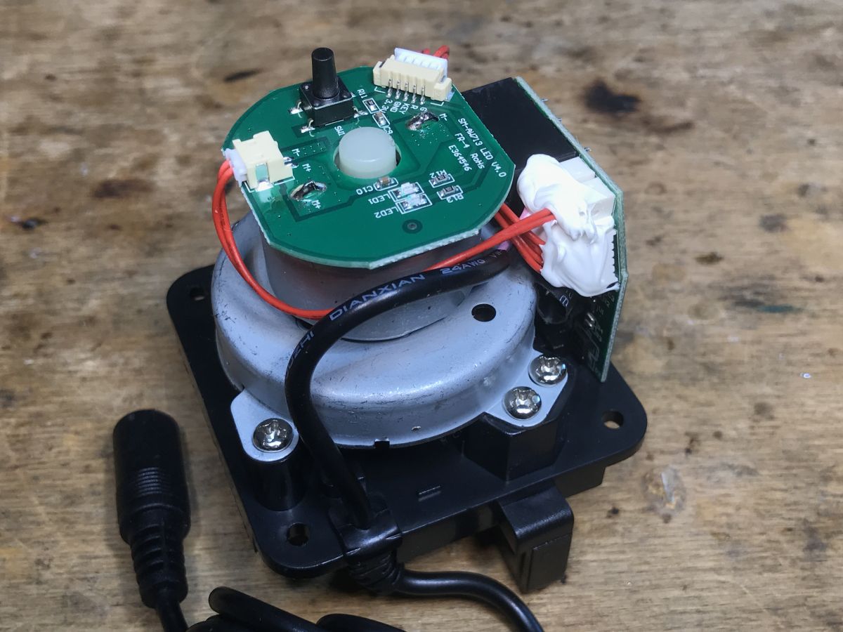

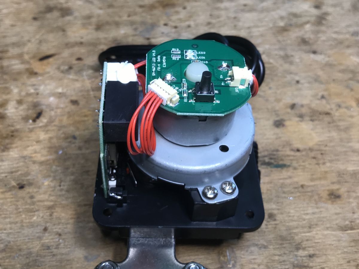

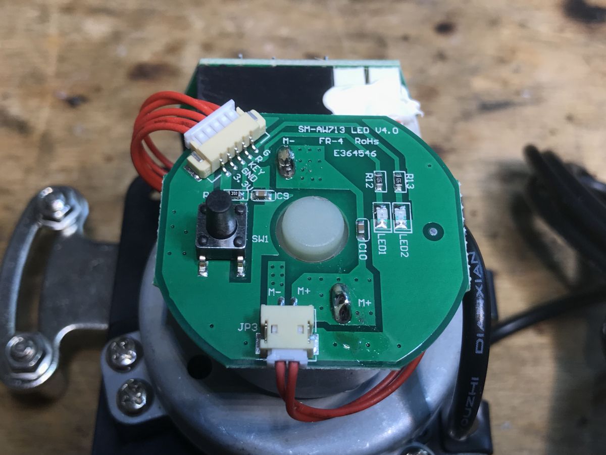

    Interior:
    Valve control module with visible PCB and wiring.

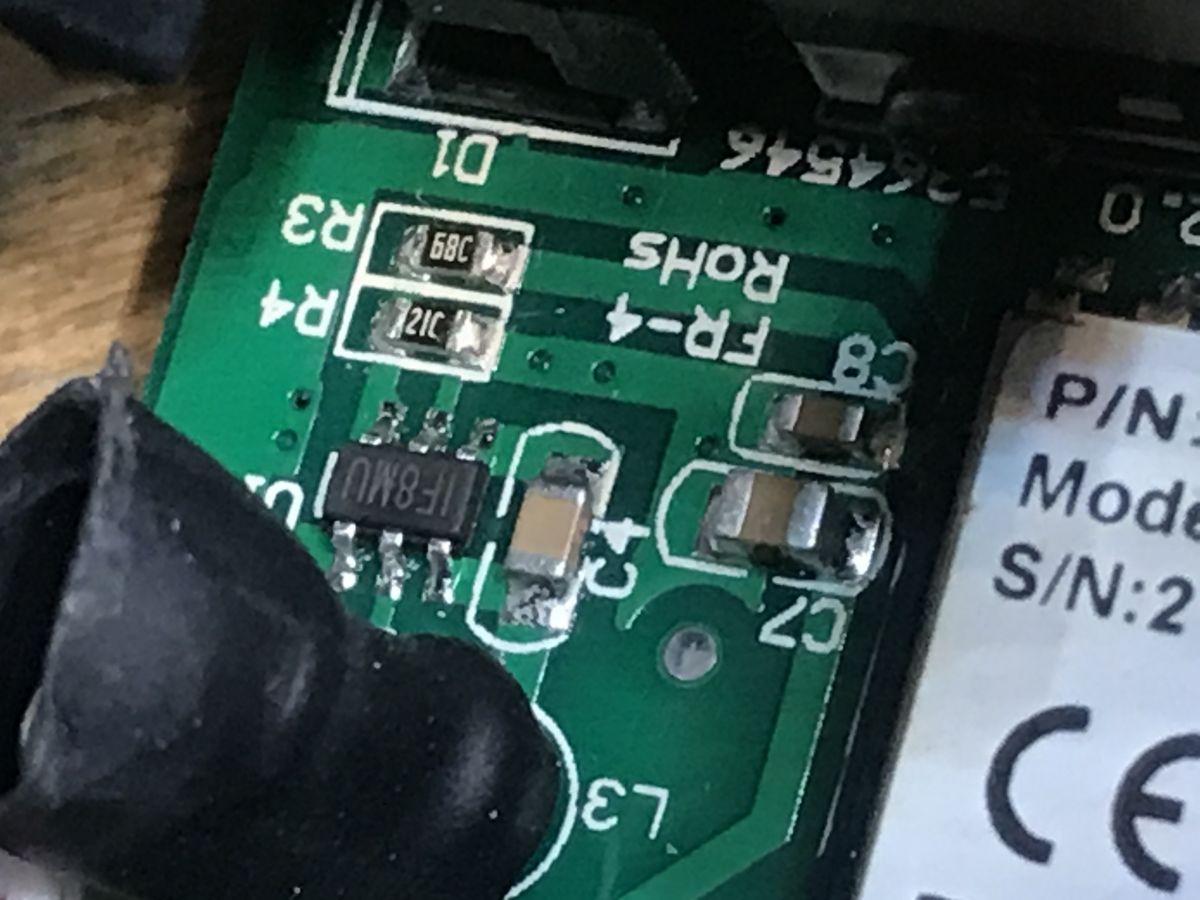

    PCB designation: SM-AW713 LED V4.0 FR-4 RoHs E364546
    Here we have two separate LEDs, one presumably for the pairing status, the other for the switching status, a pin from switching and a connector for the second board and for the motor (M+ and M-).
    Close-up of the internal components of the SM-AW713 smart valve controller showing the circuit board with buttons and wires. Interior of the Jinvoo SM-AW713 device showing PCB and wiring. .

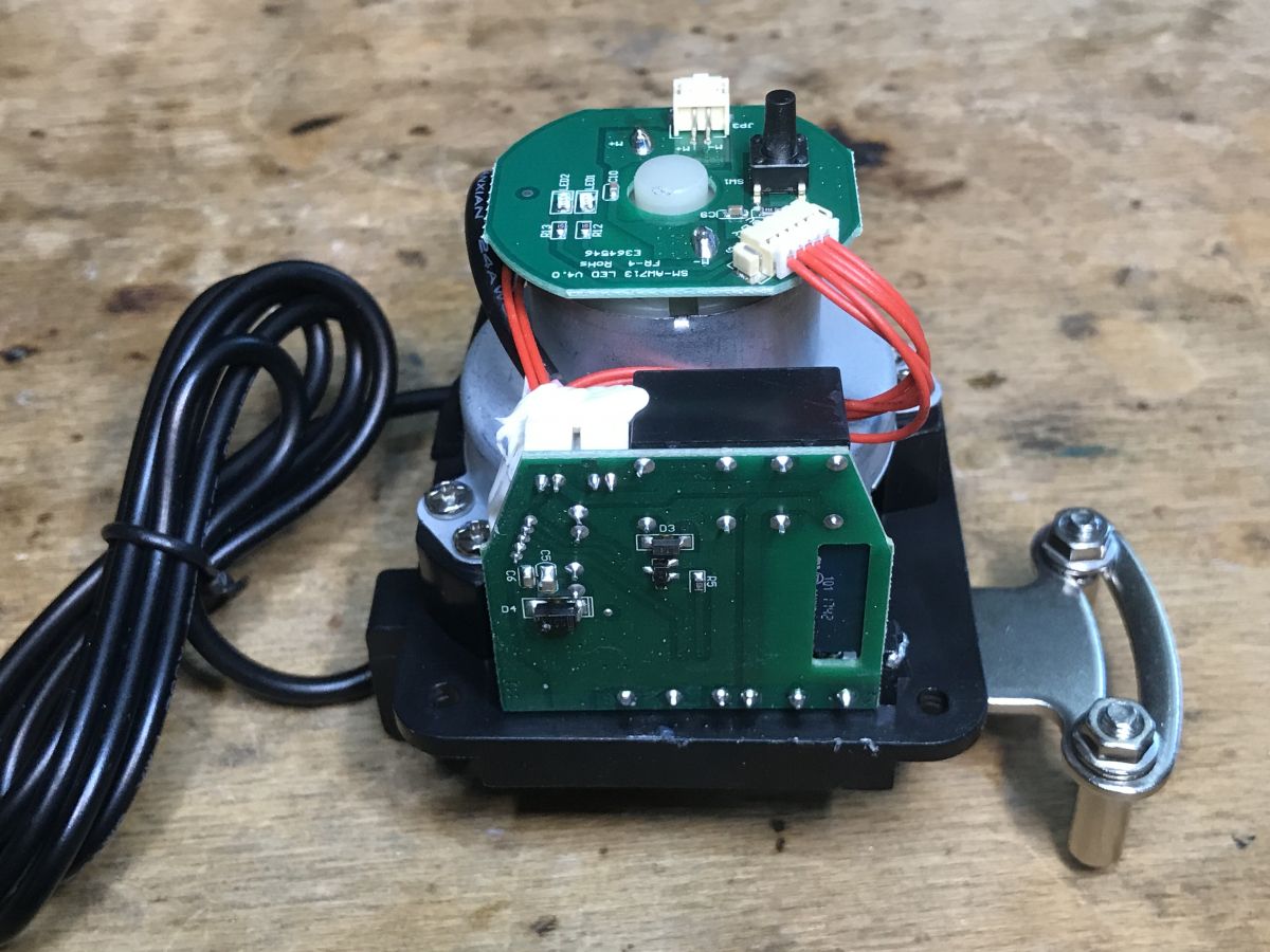

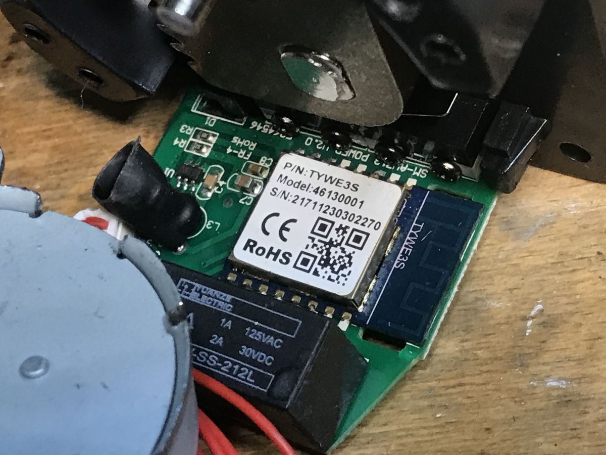

    There is a relay and a WiFi module on the second board:
    Interior of Jinvoo SM-AW713 valve controller with visible PCB and wires. View of the interior of the Jinvoo SM-AW713 smart valve overlay with visible ESP module and wiring. .
    It turns out that here is a module with ESP, so Tasmota can be uploaded:
    Close-up of PCB with TYWE3S WiFi module and relay. Interior view of WiFi module with ESP8266 in valve controller. .

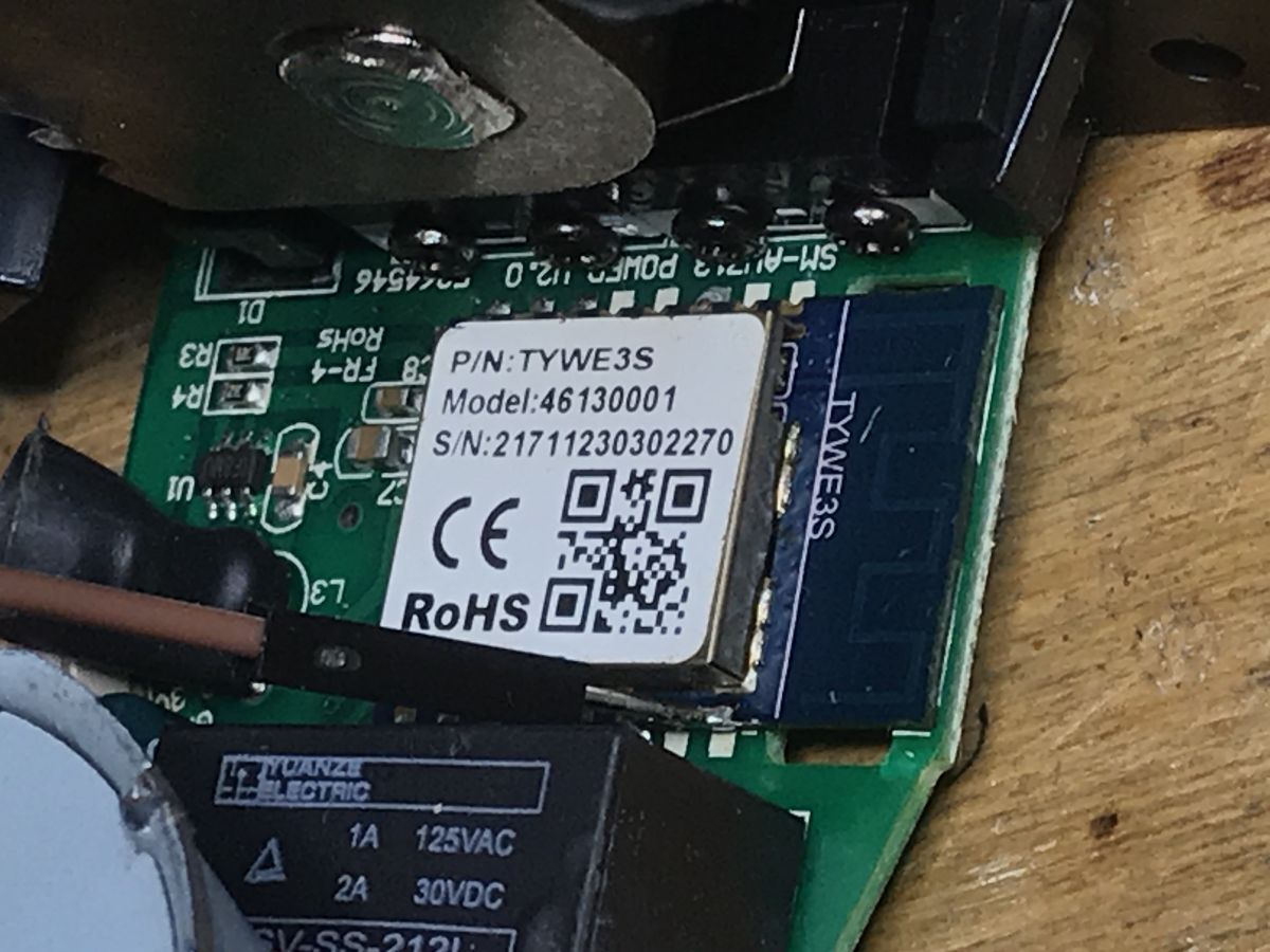

    Interior of the Jinvoo SM-AW713 smart valve controller with ESP8266 .
    and gain slightly better access to the WiFi module:
    Jinvoo SM-AW713 PCB with visible TYWE3S WiFi module. .

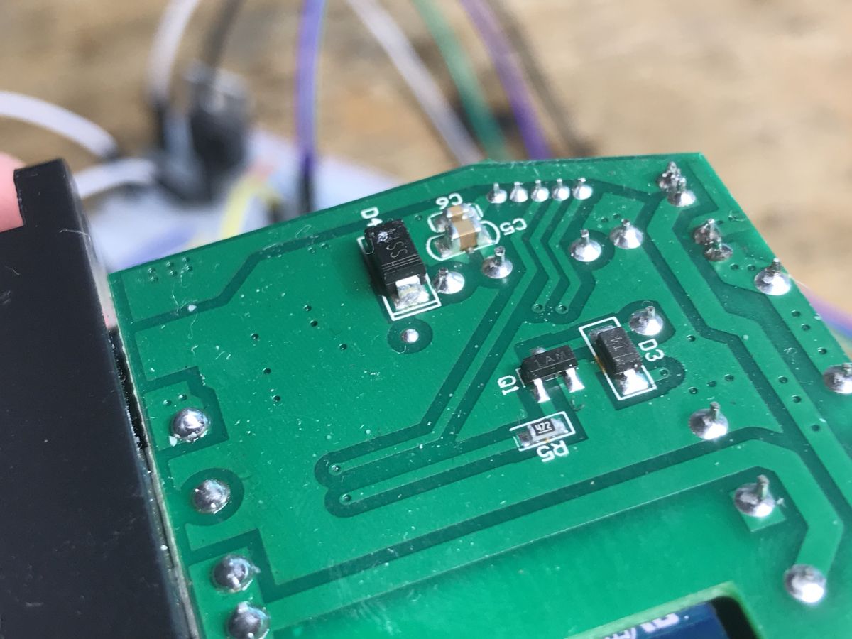

    By the way, here you can see the step-down converter generating 3.3V from the 12V input, this is the operating voltage of the WiFi module. Next to the IC you can also see its coil:
    Close-up of the Jinvoo SM-AW713 PCB with visible electronic components. .
    You can also see the transistor that controls the relay:
    Close-up of the PCB of the Jinvoo SM-AW713 controller with electronic components. .

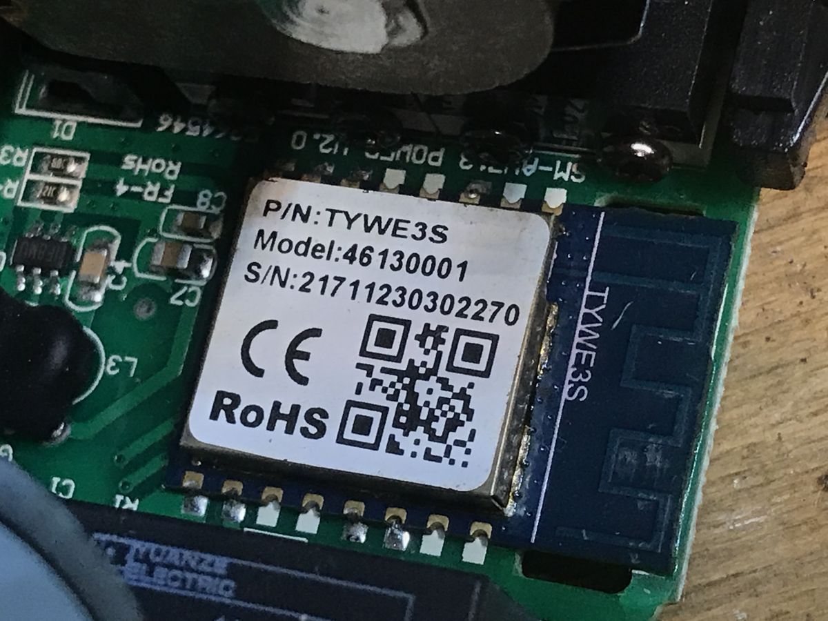

    The WiFi module itself:
    TYWE3S module on a PCB. Close-up of the TYWE3S WiFi module on a circuit board with model and serial number markings. .
    This is an ESP8266, so esptool.py will do. TYWE3S pinouts are available on the web, by the way, they are compatible with ESP12. You can read about uploading Tasmota here:

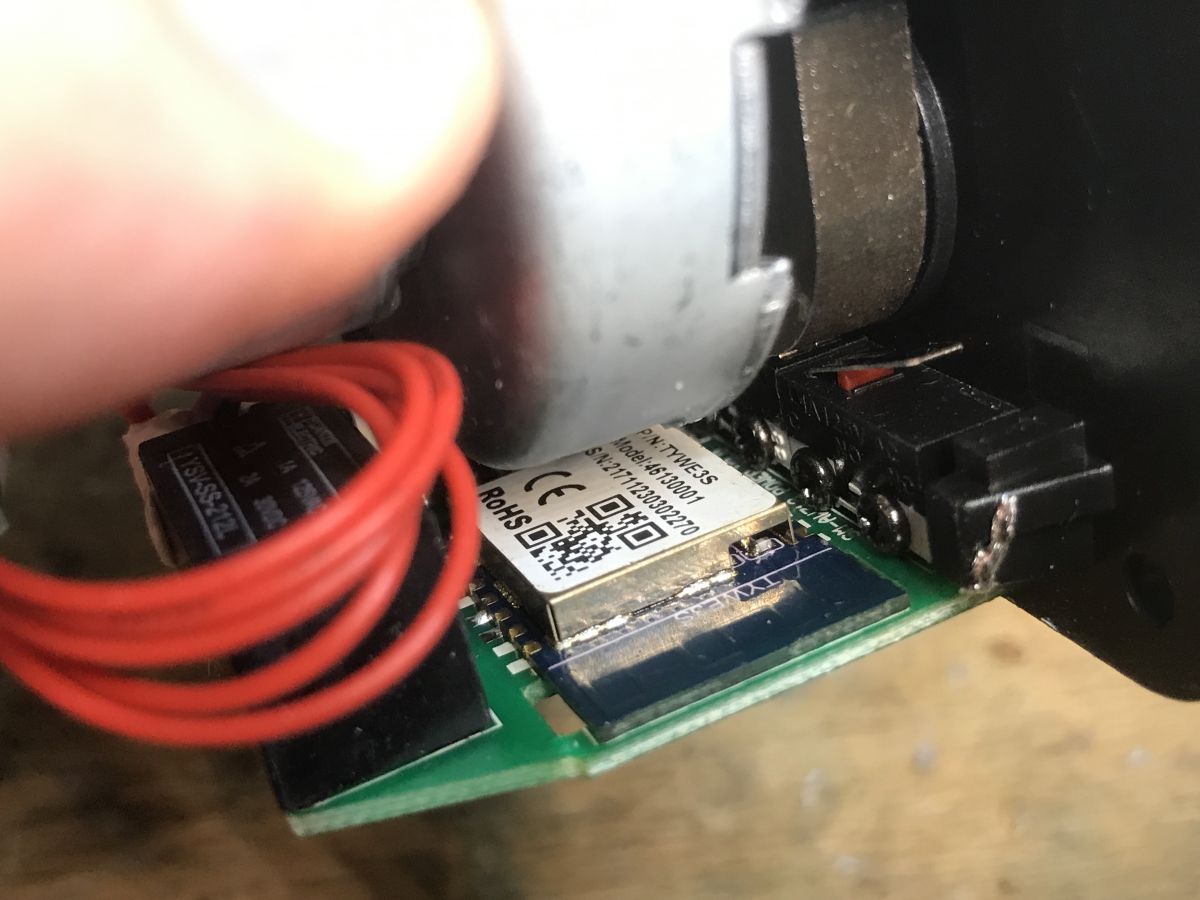

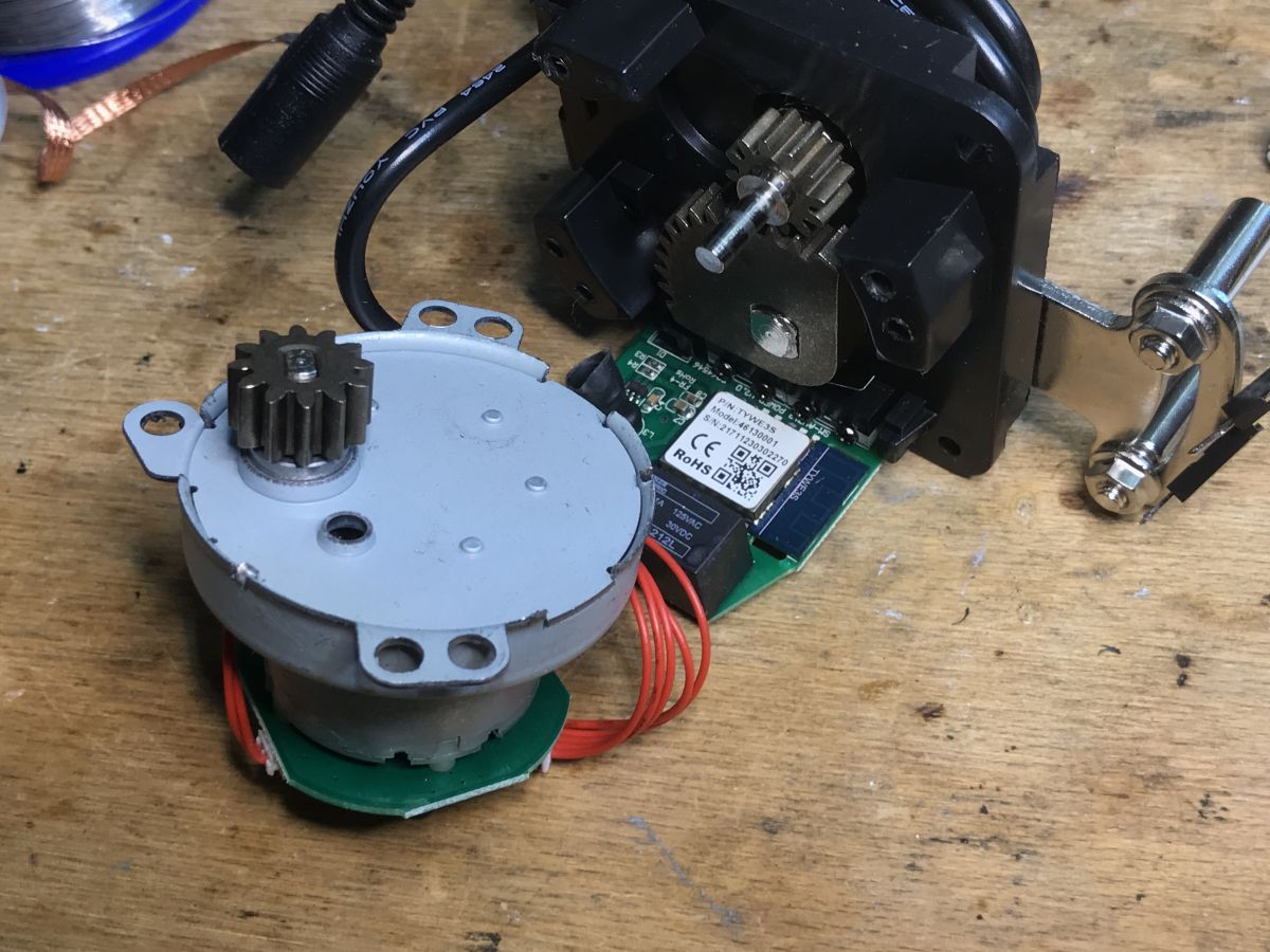

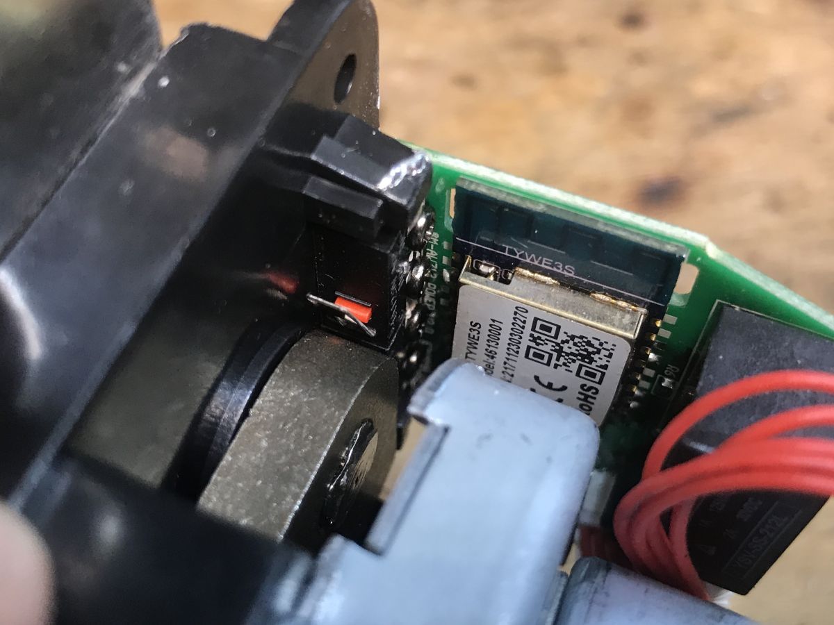

    The operation of this template is really very simple. Simply turning on the relay turns on the valve and vice versa
    How exactly does the motor control work? Are there 'limit' position stops, or is it more based on overload analysis?

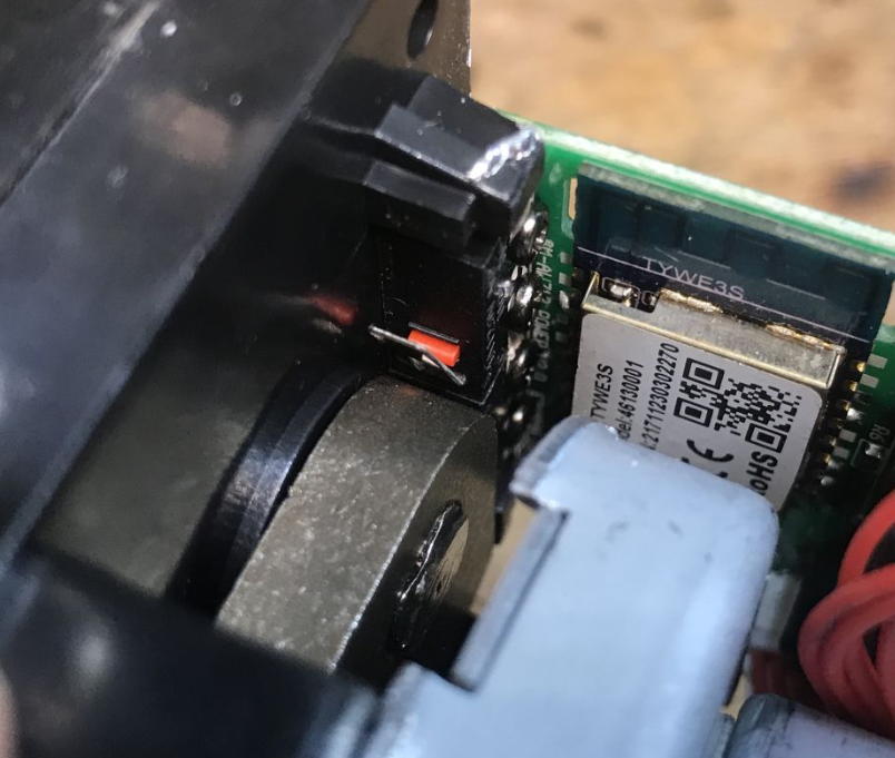

  • #6 20752538
    Posts: 14756
    Rate: 12883

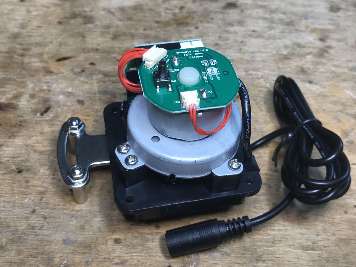

    @krzbor I didn't want to deconstruct it more for analysis but in this photo you can see one of the buttons testing the condition of the gearbox:
    Close-up of an electronic component with a visible control button and a board with a QR code. .
    @12robert12 very good tip!

  • Limit switch design may allow intermediate openings
    #7 20752562
    krzbor
    Posts: 1783
    Help: 42
    Rate: 1072
    @krzbor I didn't want to disassemble this more for analysis but in this photo you can see one of the buttons that tests the condition of the gearbox
    So as I am guessing this is a "limit switch" based solution. How does the relay work? Does it work by interchanging the "+" and "-" fed to the motor? I understand that the limiters are not controlled by a microprocessor? I'm interested in controlling the motor itself, as I'm considering the possibility of using it for intermediate openings (not just open-close).
    However, if the system is based on the limiters, it's easy to burn out the motor when things get jammed.

    #17 20754222
    krzbor
    Posts: 1783
    Help: 42
    Rate: 1072
    Let me repeat my question:
    krzbor wrote:
    That is, as I am guessing it is a "tie-rod" based solution. How does the relay work? Does it work by interchanging the "+" and "-" fed to the motor? I understand that the limiters are not controlled by a microprocessor? I'm interested in controlling the motor itself, as I'm considering the possibility of using it for intermediate openings (not just open-close).
    Perhaps someone knows the answer?
  • WiFi module controls one GPIO on the valve

    I haven't removed the PCB any further so unfortunately I don't know if there's an MCU in there yet, but I do know that the WiFi module definitely controls one GPIO and there's no endcaps connected to each other. What happens next I have not analysed. The same thing is repeated in many similar products. Type "valve" in our list:
  • WiFi module appears to drive a single relay GPIO
    #19 20754932
    krzbor
    Posts: 1783
    Help: 42
    Rate: 1072
    I haven't removed the PCB further so unfortunately I don't know if there's an MCU still in there, but I do know that the WiFi module definitely controls one GPIO and there's no endcaps connected to each other.
    I understand that only one GPIO controls a relay, and that relay controls the servo circuit? Maybe I'll say why I'm asking this - I'm wondering if the circuit can be reworked to control any opening angle, not just on/off.

    The most important thing here is the mechanical solution - motor with gearbox with mountings and everything in a tasteful housing.
    It's a bit of a shame to get rid of the electronics - there's an EPS8266 in there and it's easy to program in an Arduino, for example. This processor can be used without WiFi or add Ethernet on SPI. I think I'm guessing how it's controlled - the relay has 2 pairs of contacts and probably depending on position gives "+" "-" or "-" "+" - i.e. it changes the direction of rotation of the motor. The limiters if NC allow current to flow both ways. In parallel to the limiters you just need to add diodes - then when it reaches the end it will stop, but in the other direction it will spin.
    To add control for any position you need to cut any motor power line and route it through an additional relay. Then you have directional control on the original relay and the additional relay allows you to interrupt rotation at any time.
    All nice if this ESP has free and available pins. I would need an RS485 bus to integrate it into my system :-) .
    In order to make a cool control to any position, a potentiometer - like in servos - would have to be added to the axis driving the valve....
    To make a nice control to any position you would have to add a potentiometer to the axis driving the valve - like in servos...
    There are quite a few free pins - see photos - they are not even soldered. Adding a potentiometer is nice, but mechanically not that easy at all let alone trouble-free. If you don't expect frequent changes, the simplest method is to close the valve (i.e. wait until it is sure to close) and then time the opening. This should work out quite well and, incidentally, removes the problem of some inertia of the valve handle in relation to the actuator arm.
    The regulation can also be approached differently - if the valve is to regulate the flow of the heating medium, we can control the valve on the basis of the return temperature on a more/less basis - we do not need to know its position. Of course, a suitable algorithm is required.

    You could try putting on an encoder wheel (like from an old mouse) not necessarily densely toothed and detect with a single photoelement without directional control. This should make the mechanics easier, you don't need to be as much on axis as with a potentiometer.
