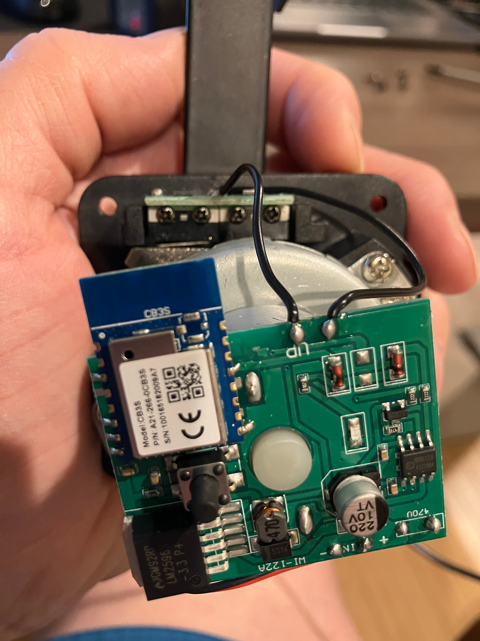

    Amazon ordered:
    https://www.amazon.com/gp/product/B09R9QBCTC/..._yo_dt_b_asin_title_o02_s00?ie=UTF8&psc=1
    Description:
    WiFi Valve Controller with Bluetooth Smart Water Gas Valve Automatic Remote Control Voice Control Smart Life & Tuya For Alexa Google Assistant
    Manufacturer: Tokatuker
    Programmed via UART

    I have the same device. Can this device be tuya-cloudcuttered?
  • #4 21485332
    cijoml
    Posts: 81
    Well I flashed mine via usb converter. Here is a firmware backup of my device
    • readResult_BK7231N_QIO_ventil_2025-18-3-16-33-11.bin (2 MB) You must be logged in to download this attachment.

  • #7 21500467
    vasilehijs
    >>21485687 Did you solder TX, RX to chip? I have not used to do this to my tuya devices as I have used cloudcutter, but I have the same version as you 1.3.5.
  • #8 21502672
    cijoml
    Posts: 81
    Yes, I soldered wires directly onto the chip. It was easy since the solder pads are not tiny.
