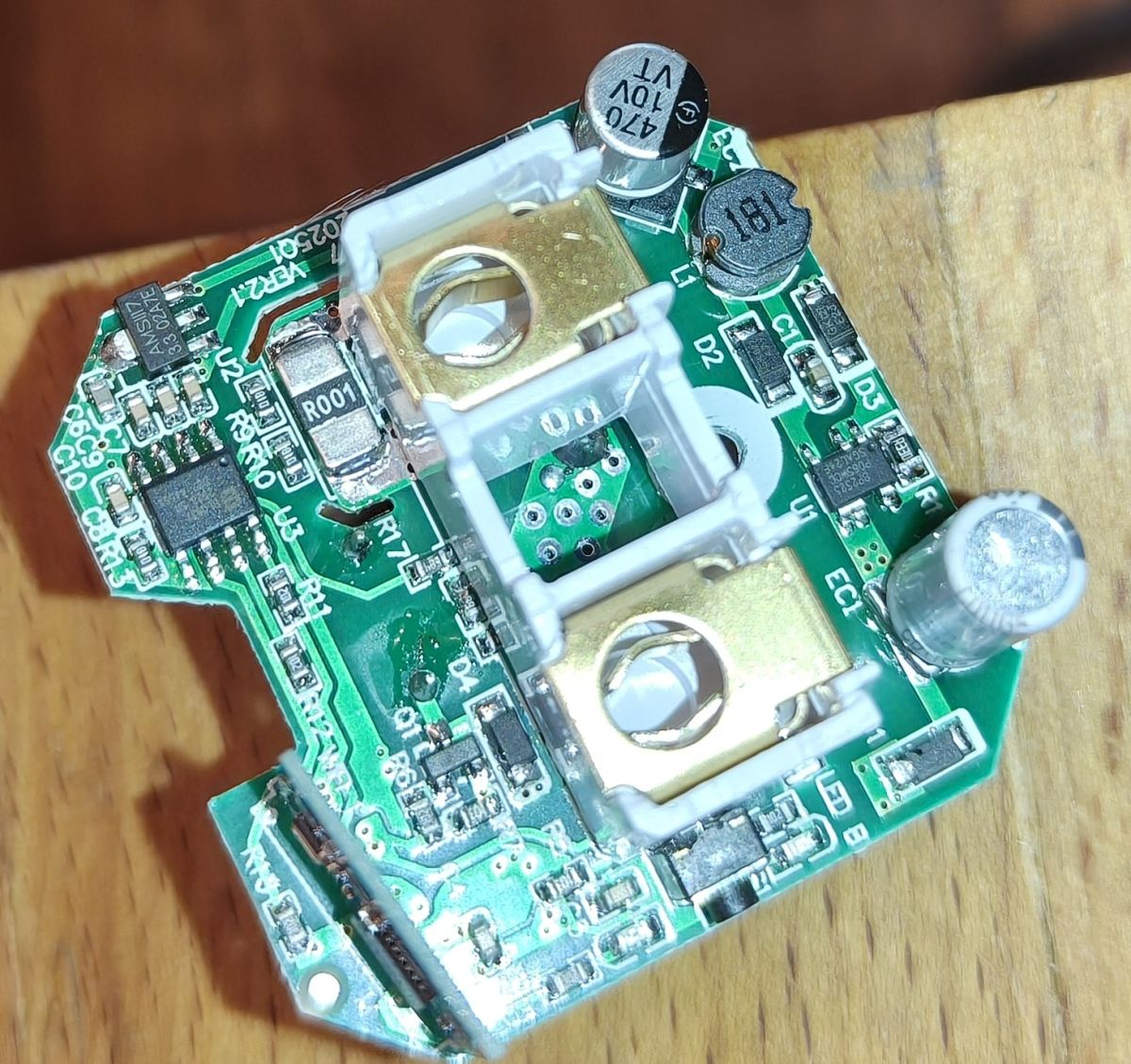

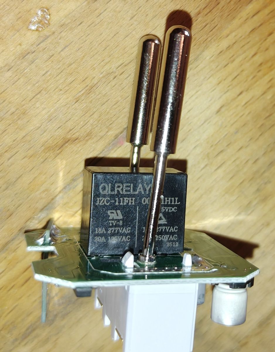

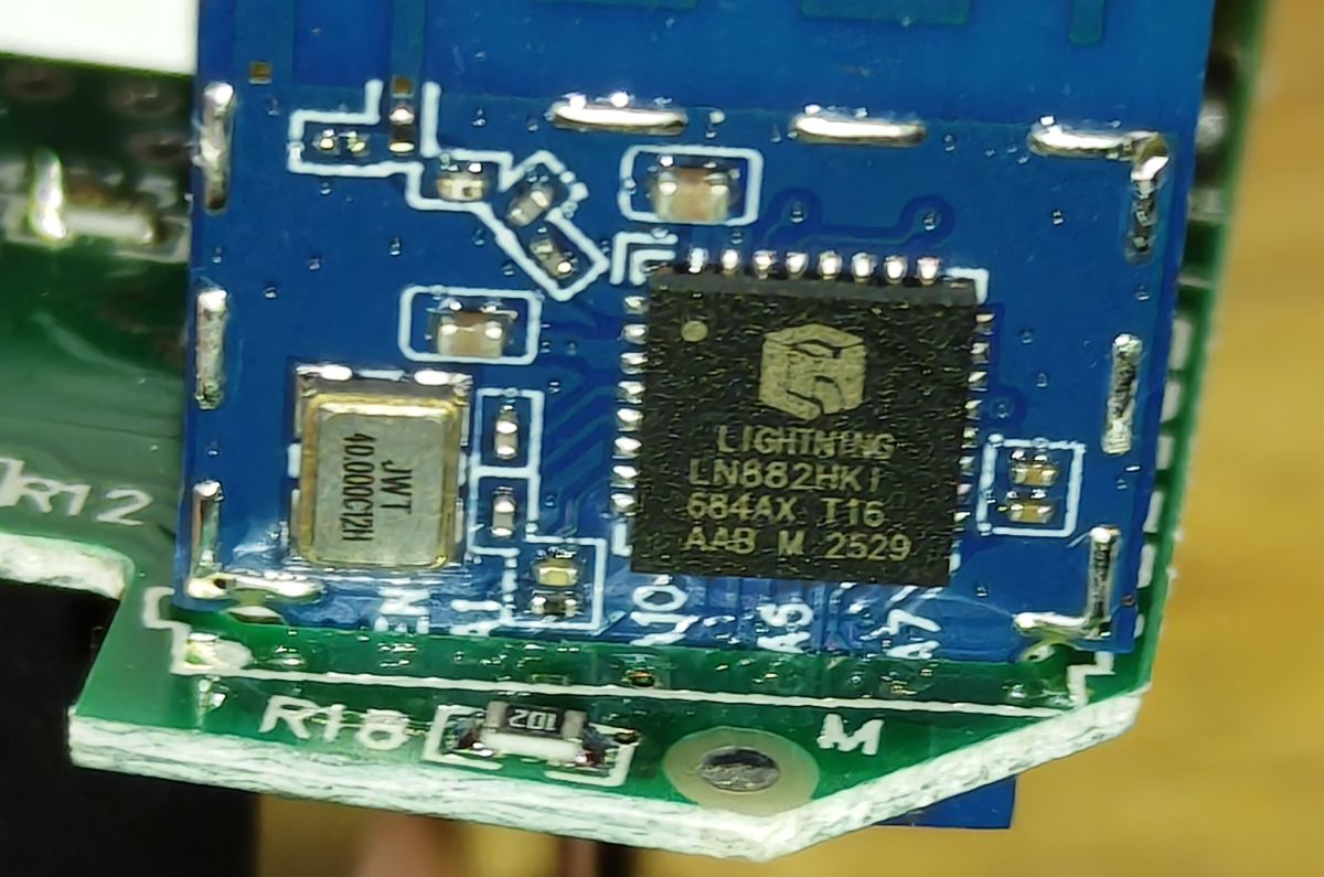

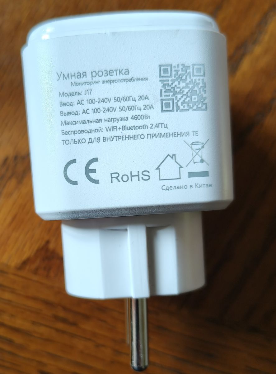

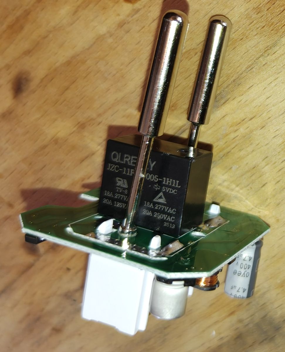

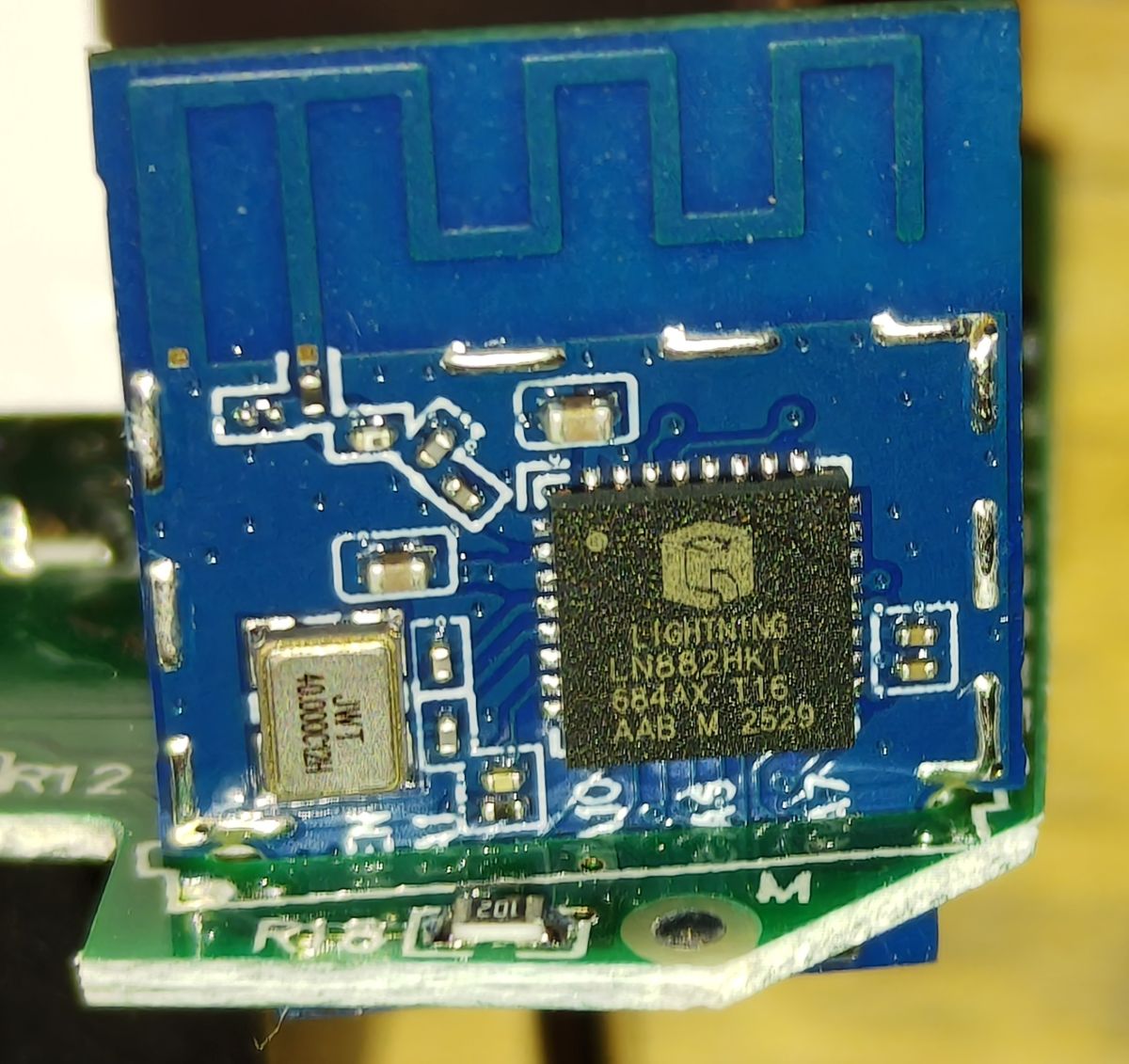

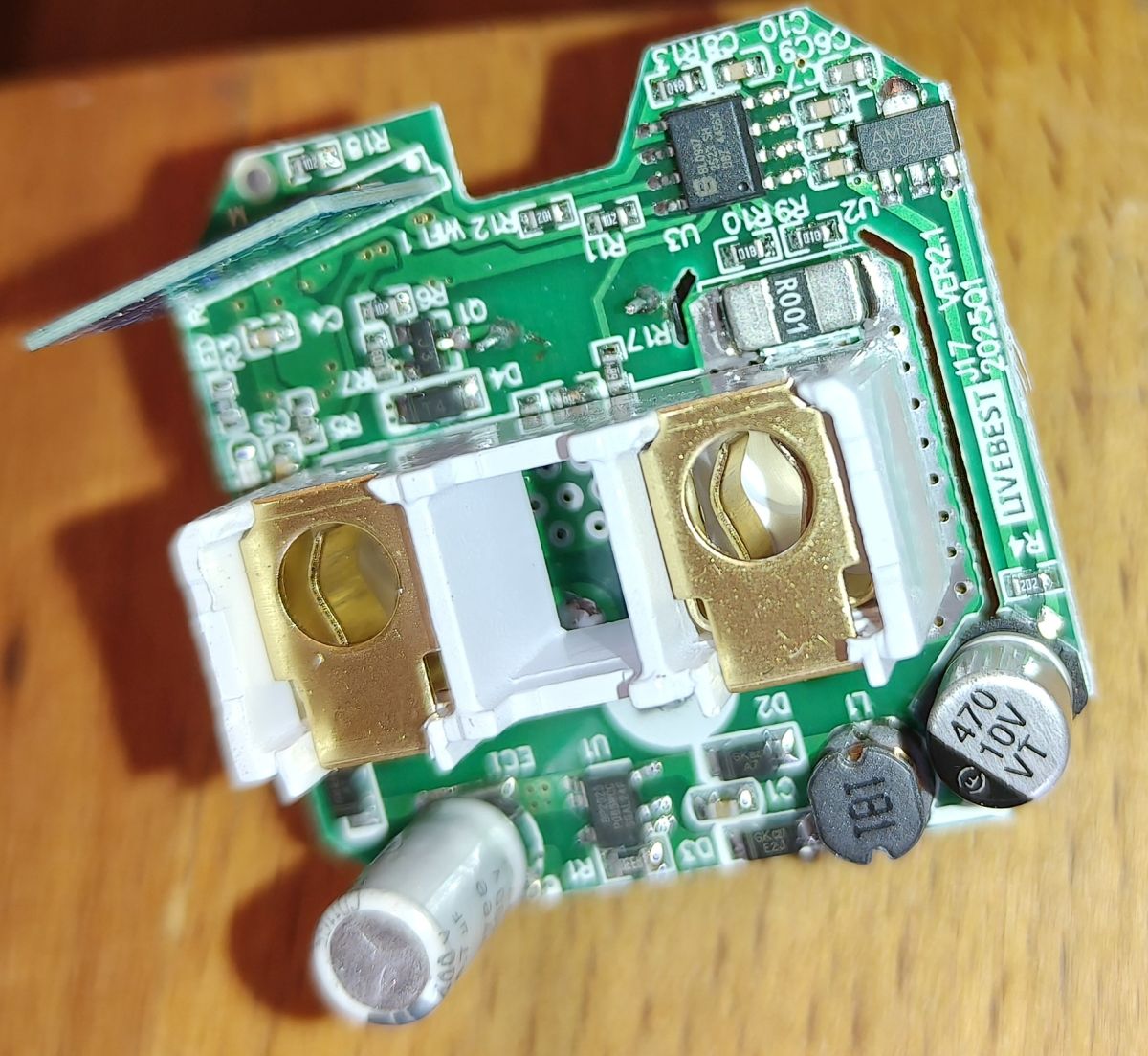

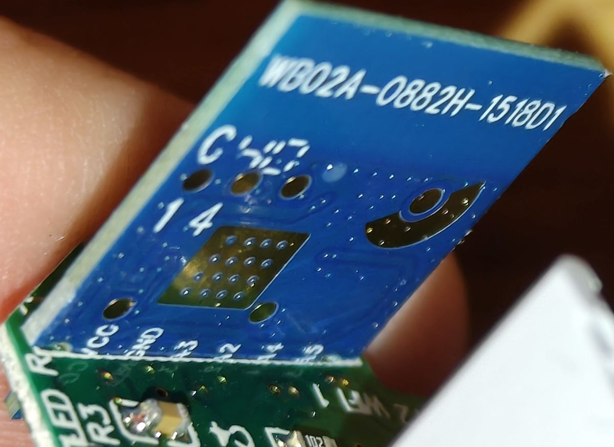

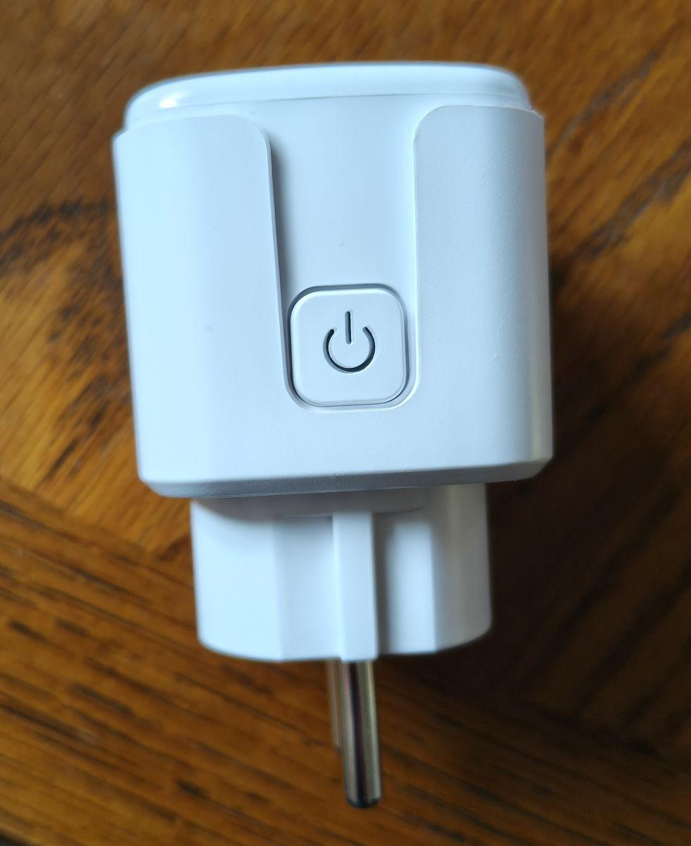

    Hi!
    I bought the smart plug and couldn't find a pin config for it, so figured it out by myself.
    Photos:
    Spoiler:
    Tuya LIVEBEST J17 20A EU LN882H pinout, boot pin and BL0937 config Tuya LIVEBEST J17 20A EU LN882H pinout, boot pin and BL0937 config Tuya LIVEBEST J17 20A EU LN882H pinout, boot pin and BL0937 config Tuya LIVEBEST J17 20A EU LN882H pinout, boot pin and BL0937 config Tuya LIVEBEST J17 20A EU LN882H pinout, boot pin and BL0937 config Tuya LIVEBEST J17 20A EU LN882H pinout, boot pin and BL0937 config Tuya LIVEBEST J17 20A EU LN882H pinout, boot pin and BL0937 config Tuya LIVEBEST J17 20A EU LN882H pinout, boot pin and BL0937 config Tuya LIVEBEST J17 20A EU LN882H pinout, boot pin and BL0937 config
    A3 - RX
    A2 - TX
    Boot pin is the test point near the VCC pin.

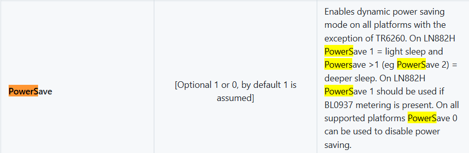

    The startDriver command was intended to fix the problem in which BL0937 driver didn't start at boot. But now I see that after importing config there is an incomplete boot. So it needs to restart the plug one more time. After that the BL0937 driver begins to boot automatically without that command.
    Don't remember what for I needed to disable power saving. Something didn't work, I guess.
    Some slashes in the startup command are missed now in my post, as I see. HTML/JS issue, I guess. It's supposed to be like that: "command": "startDriver BL0937rnPowerSave 0". It's how WebApp generates/extracts plug's config on the corresponding page. And when I import it to the plug, only the first command appears on the StartupCommand page.
    So better will be like that for now: "command": "backlog startDriver BL0937; PowerSave 0".
