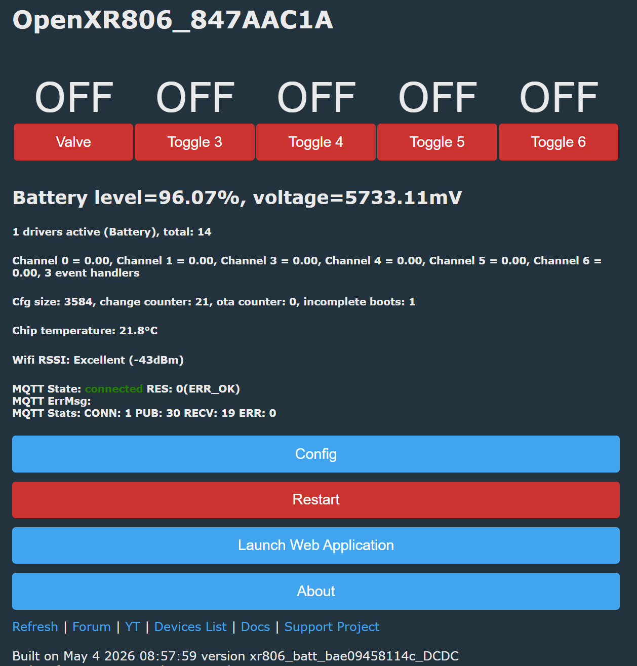

  • Working OpenXR806 pin setup for watering valves
    #72 21923656
    mkrum001
    Posts: 41
    OK, I can confirm that everything is working. Now both watering valves that I have are flashed and working good. Below are the settings that I'm using. They were created with AI help and probably can be improved. The only think I can't manage is to hide the 4 toggles - two for open/close pulses and red/green LED status.
    pin setup:
    Code: Bash
    Code: Bash
    OpenXR806 dashboard with OFF toggles and battery, Wi‑Fi, and MQTT status details
  • Hide internal channels with SetChannelVisible and SetChannelPrivate
    #73 21923672
    Posts: 5220
    Help: 449
    Rate: 918
    very good.
    You should be able to hide/not publish certain channels with more commands.
    eg
    https://github.com/openshwprojects/OpenBK7231T_App/blob/main/docs/commands-extended.md
    Hopefully you'll not have any issues OTAing to the general release of the DCDC variant which was merged a few days ago

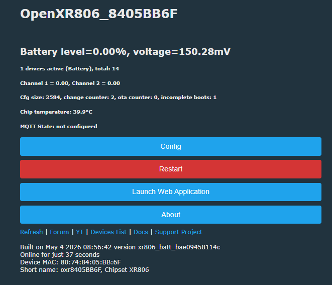

  • Battery driver missing from OpenXR806 build
    #74 21923714
    mkrum001
    Posts: 41
    You mean the 1.18.293? If yes - it didn't work.
    P.S. Ahh I was able to get it from the Actions...
    OpenBK7231T_App_1.18.293_OpenXR806_DCDC
