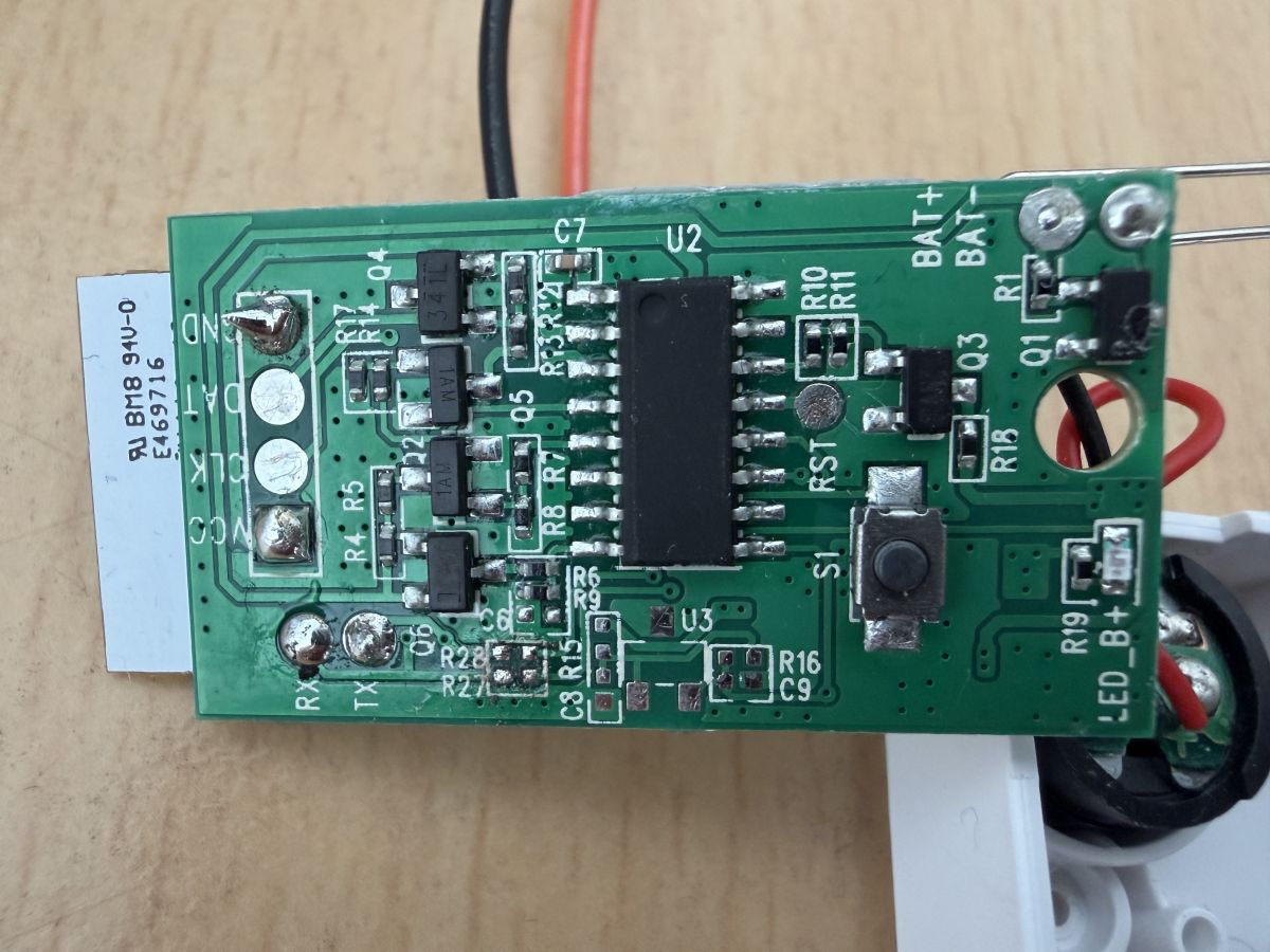

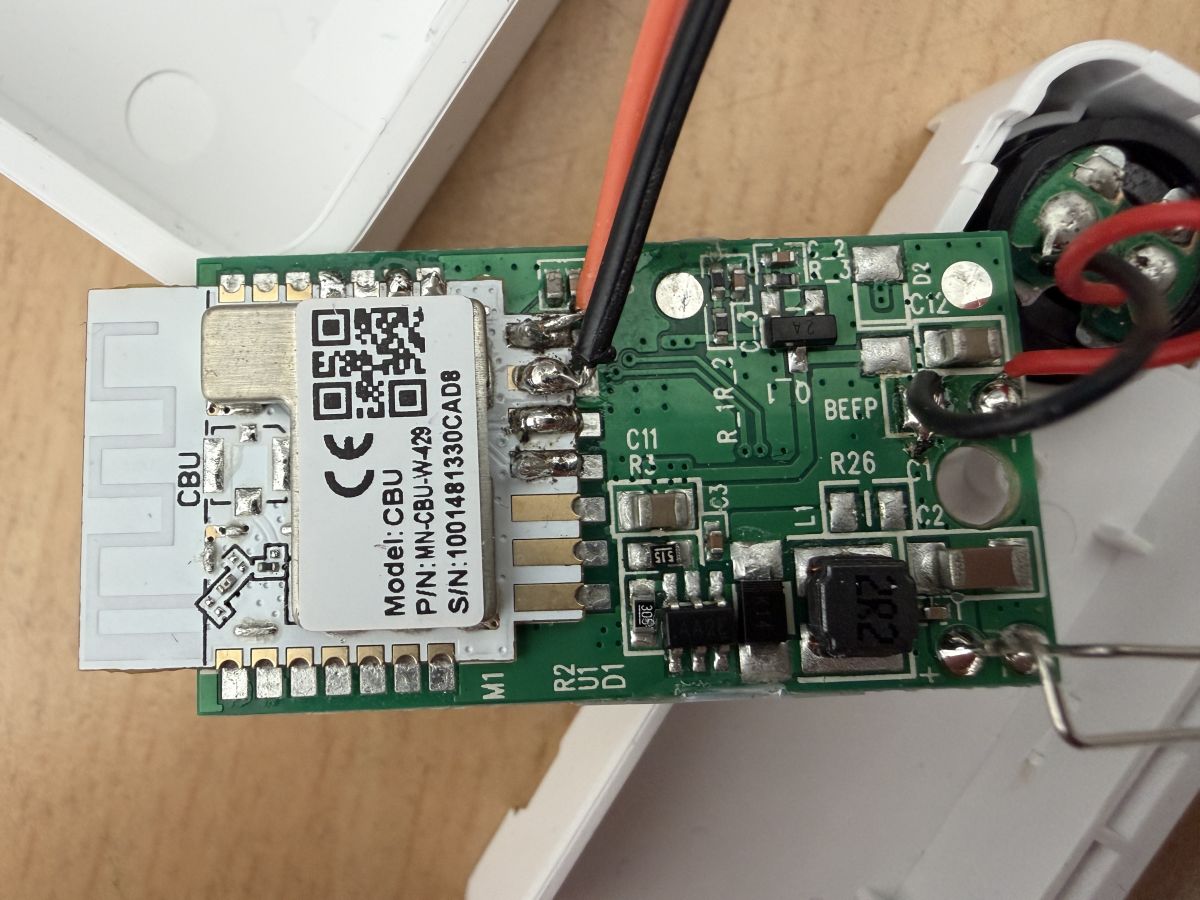

    Can you show photos of the inside? Do you have a copy of the 2MB batch file (before pairing, otherwise it might contain the SSID and password)? Firstly, you need to determine whether this device supports TuyaMCU.

    Pictures attached. I would have the backup as Tuya Original. Does that help? Upload it right away. Or reset again and upload a backup to Openbeken flash?
    Ambiano SWW04U CBU BK7231N OpenBeken: which GPIOs set contact/deepsleep? Ambiano SWW04U CBU BK7231N OpenBeken: which GPIOs set contact/deepsleep? Ambiano SWW04U CBU BK7231N OpenBeken: which GPIOs set contact/deepsleep?

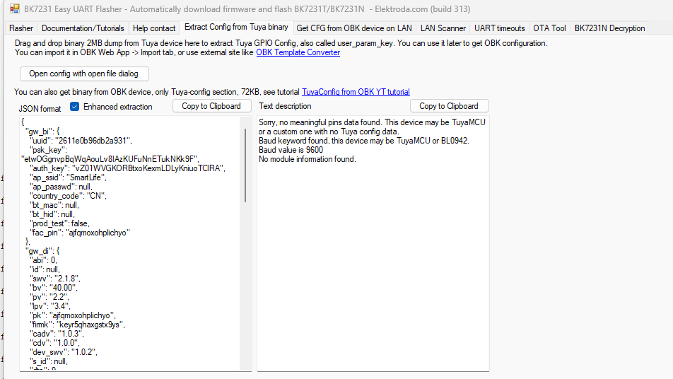

    Extract Config from Tuya binary:

      "record_head": "",
      "baud_cfg": {
        "baud": 9600
  • #5 21894259
    Posts: 14743
    Rate: 12839
    I would recommend doing a TuyaMCU communication intercept with a USB to UART converter. This will help clear up doubts about the protocol later.
    https://github.com/openshwprojects/TuyaMCUAnalyzer
    English tutorial: https://www.elektroda.com/rtvforum/topic4038151.html

    Question: do the two resistors on TX1 and RX1 have to be removed beforehand?
  • UART resistors only need removal if flashing is blocked
    #7 21897286
    Posts: 14743
    Rate: 12839
    The resistors on RX/TX are removed when we want to cut off the interfering TuyaMCU flashing on the UART line. The TuyaMCU uses the same UART to communicate with the WiFi module as we use to flash the WiFi module. For this reason, it is common to remove these resistors temporarily for flashing or to solder out the MCU itself.
    If, in your case, flashing works without removing them, then you do not need to do this.

  • The extracted Tuya configuration shows a 2 MB original backup, baud 9600, software version 2.1.8, and protocol version fields 2.2 and 3.4. [#21893336]
  • Flashing the CBU required removing R27 and R28 on this board, but that hardware change was tied to firmware upload, not UART sniffing. [#21891113]

What can I learn from a backup of the original Tuya firmware before pairing, and how does it help identify device configuration?
A pre-pairing backup can reveal the device's stored Tuya configuration and UART parameters without exposing your own Wi-Fi credentials. In this case, the extracted config showed baud 9600, software version 2.1.8, bv 40.00, pv 2.2, lpv 3.4, and several gateway fields. Those values help confirm that the original firmware expects serial communication and give you a baseline before replacing it with OpenBeken. [#21893336]

What are the safest soldering and hardware handling practices when removing resistors like R27 and R28 from a BK7231N device for flashing?
Remove only the parts that isolate the shared UART, document their original positions, and verify continuity after reinstalling them. In this case, the user removed R27 and R28 to flash the CBU, but later troubleshooting showed that bad reconnection can leave UART communication incomplete. The safest rule from the thread is functional: remove resistors for flashing only, and keep the line intact for monitoring. [#21891113]

How do photos of the PCB and module help identify the contact sensor pin, UART lines, and possible deep-sleep wiring on a CBU BK7231N board?
Photos help by showing the module type, the UART path, and the exact resistors and traces involved in flashing or sniffing. In this thread, the PCB photos led directly to follow-up questions about TuyaMCU support and to the identification of the RX1/TX1 resistor area later used for removal and monitoring. Visual inspection narrows the search space, but the posts still required UART evidence before any contact or deep-sleep pin could be trusted. [#21893303]
