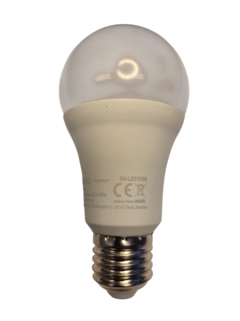

    Submitting pinout for a Deltaco lamp
    DELTACO RGB lamp E27 SH-LE27RGB BK7231T WB2L - is this PWM pinout OK?
    AI: Have you tested this pinout on the SH-LE27RGB, or is this still unverified?
    Tested OK
    AI: Can you share a photo of the WB2L board and say which PWM pins control R, G, B, CW/WW (or brightness)?
    No

    Nice, a simple PWM-based lamp. I haven't seen old WB2L in some time. How's the heating? We recently had an interesting PR with dynamic overheating protection working by reducing LED brightness when WiFi module temperature grows too high.
  • #4 21893608
    simontoyra
    >>21892971 I ran into some overheating problems when running 100% brightness. Reduced the brightness to 50% and now it seems to work fine
  • #5 21894242
    Posts: 5220
    Help: 449
    Rate: 918
    did you set
    powersave 1
    command, this could help with heat
  • #6 21894264
    simontoyra
    >>21894242 Chip temp down by 5 °C, tx
