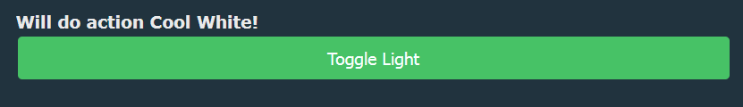

    [BK7231N CB2L] Antela - smart bulb E27 RGB BAW534 9W
    Still I am getting the error:
    Info:CMD:CMD_StartScript: started /autoexec.bat at the beginning
    Info:CMD:[WebApp Cmd 'backlog resetSVM; startScript /autoexec.bat' Result] OK
    Error:CMD:cmd setButtonEnabled 0 1 NOT found (args )
    Error:CMD:cmd setButtonLabel 0 "Warm NOT found (args White")
    Error:CMD:cmd setButtonCommand 0 "backlog NOT found (args led_temperature 500; Dimmer 100; led_enableAll 1")
  • Start httpButtons before autoexec.bat
    #16 20577007
    Posts: 14755
    Rate: 12880
    Let me check on that device:
    Let me save that:
    And reboot:
    Hmm:
    You might be getting errors because autoexec.bat may get run first before httpButtons is started. Please start httpButtons first before using them.
    You might be also getting errors because of encoding/UTF problems on some browsers. Please try to retype the script by hand into the field. We've had such a problem report once, but we are unable to reproduce it.
    Also post your complete autoexec.bat, I will double check later.
  • Manual retyping fixed browser paste issue
    #17 20577903
    jkwim
    Posts: 186
    Rate: 25
    After I typed the contents manually on a notepad and then cut and pasted in to browser it worked (I am still puzzled as to why when I copied your script on to a notepad and then cut and pasted again in browser it did not work. Notepad++ does not do different UTF encoding at different times, it should all be same).
    Here are the status messages:
    Thanks for your quick help!
