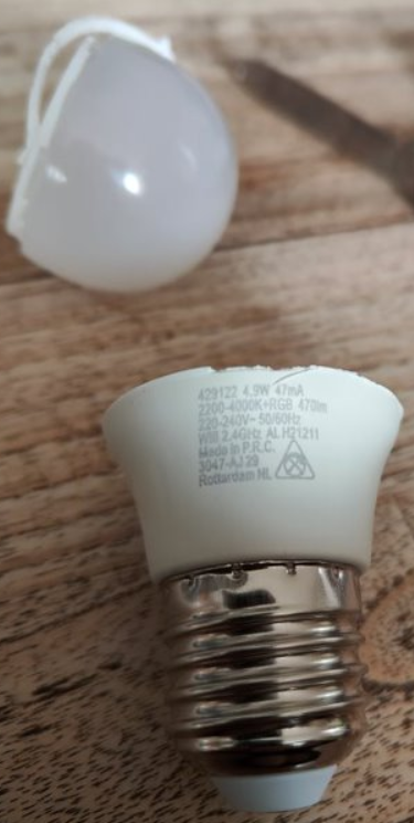

    Hi,
    I was working on a new breakdown of 10 Calex E27 light bulbs I got on ibood.com. I successfully dismantled one of the bulbs and found a BK7231T inside. Already flashed it with cloudcutter and now I am stuck. Discovering Pin-to-Channel Connections for PWM on Calex E27 LED Bulbs with BK7231T Chip Discovering Pin-to-Channel Connections for PWM on Calex E27 LED Bulbs with BK7231T Chip Discovering Pin-to-Channel Connections for PWM on Calex E27 LED Bulbs with BK7231T Chip Discovering Pin-to-Channel Connections for PWM on Calex E27 LED Bulbs with BK7231T Chip Discovering Pin-to-Channel Connections for PWM on Calex E27 LED Bulbs with BK7231T Chip Discovering Pin-to-Channel Connections for PWM on Calex E27 LED Bulbs with BK7231T Chip Discovering Pin-to-Channel Connections for PWM on Calex E27 LED Bulbs with BK7231T Chip Discovering Pin-to-Channel Connections for PWM on Calex E27 LED Bulbs with BK7231T Chip Discovering Pin-to-Channel Connections for PWM on Calex E27 LED Bulbs with BK7231T Chip Discovering Pin-to-Channel Connections for PWM on Calex E27 LED Bulbs with BK7231T Chip
    I cannot find the correct PWM settings for the pins. Any tips on how I can determine with Pin goes to which channel...

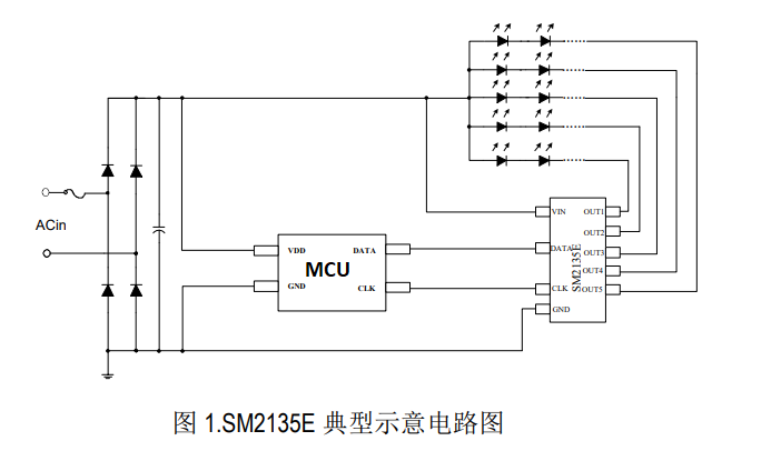

  • Suspect SM2135-type driver, check IC markings
    #2 20565883
    Posts: 14750
    Rate: 12863
    Hello, if it's really a PWM-based bulb (no SM2135, etc), then you can even set GPIO roles to RELAY and just toggle relays to see if it works.
    You can also set PWM roles and enable "Show raw PWMs" in flags.
    But wait...
    Only 3 useable GPIO and RGBCW bulb?
    That must be SM2135 or similar.
    It must be either SM2135, or BP5758, or BP1658C, etc...
    Please investigate the board and check the IC markings.

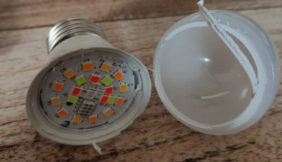

    I'll do some further investigation. On the LED plate itself is no IC, so it must be somewhere on the PCB.
    I will need to scrape off a lot of glue to find any IC. But at least I know what I am looking for now.
    Once found will share and create a proper tear down :)

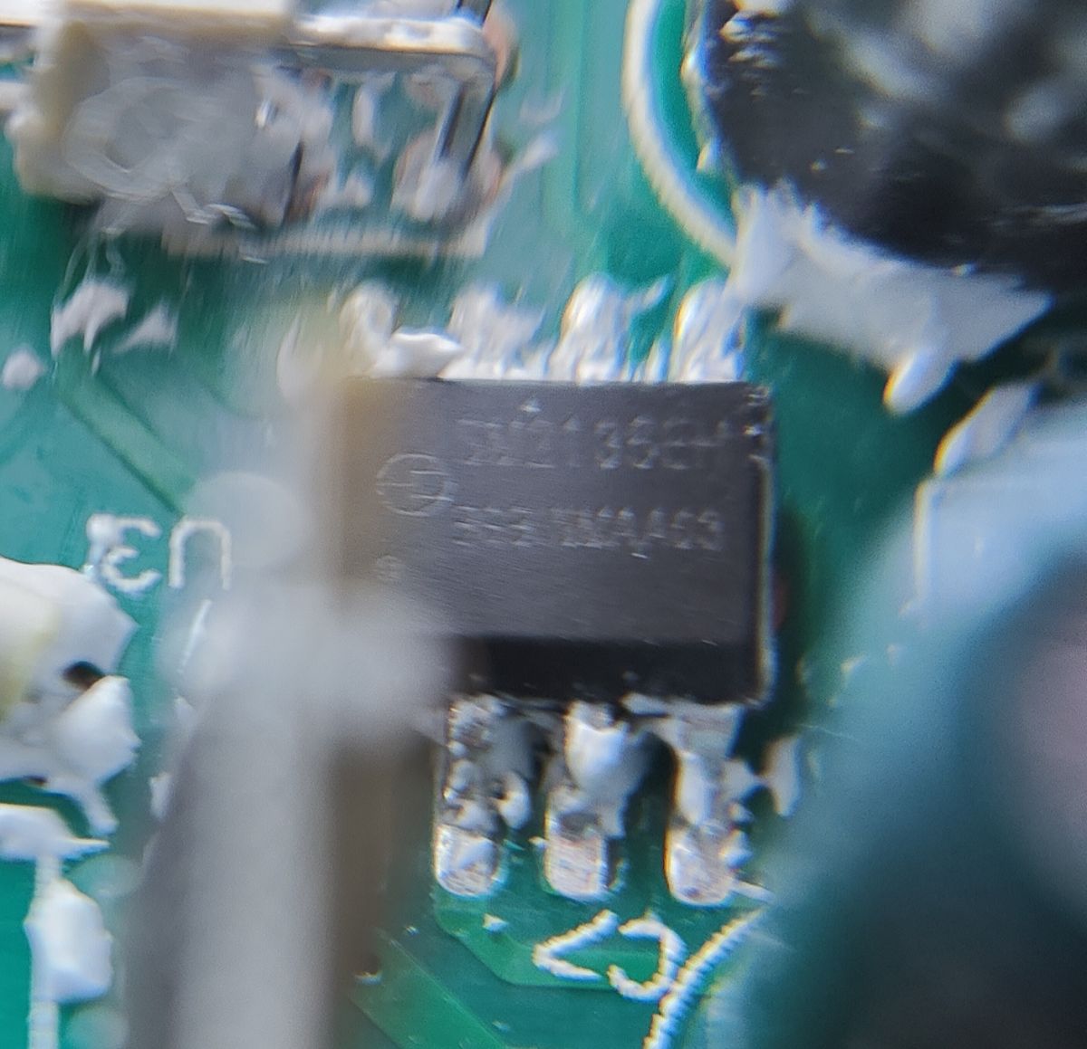

  • #5 20566615
    nielspiersma
    Posts: 60
    Rate: 20

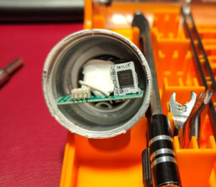

    Well found it. covered under a lot of putty as sm2135. Now I'll trace the pons back to the skylc5 and see if I can get it to work.. [img-0] Discovering Pin-to-Channel Connections for PWM on Calex E27 LED Bulbs with BK7231T Chip
  • #6 20566663
    Posts: 14750
    Rate: 12863
    Good job, it should be very easy to get it running now. Even while guessing, there aren't many possible combinations with SKYLC5 module which has few available GPIOs.

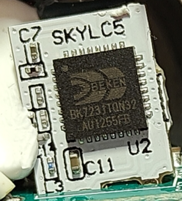

    #7 20566704
    nielspiersma
    Posts: 60
    Rate: 20
    I agree; there are not many combos, but I am unsure of the mapping of the P-numbers.
    When looking at the pin out of the TYLC5 (likely a very close clone) https://developer.tuya.com/en/docs/iot/wifilc5module?id=K9605t3bpxf75
    I figured
    CLK -> GPIO14 = P6
    DAT -> GPIO12 = P7
    No luck tried flipping P6/P7 still no joy. Now trying all combos..
    But with 5 PWM's that is still a lot of combo's (625)...
    Ant a chance we can figure it out easier?
    Niels
    Added after 25 [minutes]:
    Okay,
    I pulled out the magnifier, and based on https://jilles.com/img/tuya/SKYLC5-1.PNG I concluded that GPIO4 (right bottom finger) goes to the bottom pin on the right on the square beken chip. The only matching PWM is, based on https://obrazki.elektroda.pl/6366133600_1673944535.png , P25 PWM3.
    When following GPIO12 and GPIO14 they connect to P23 and P24 (PWM1 and PWM2). As those are the only ones used I configured PWM1 for CLK and PWM2 for DAT, nothing happened (also not after reboot). I flipped the configure, so PWM1 for DAT and PWM2 for CLK, no joy...
    I need to think this over, unless someone has a clue they want to share.
    Niels
    Added after 1 [hours] 31 [minutes]:
    Nailed it!
    I had to use PWM4 / P24 for SM2135DAT and PWM5 / P26 for SM2135CLK.
    Need to play with the color map but it works.
    Will now flash the remaining 8 bulbs!
    Niels

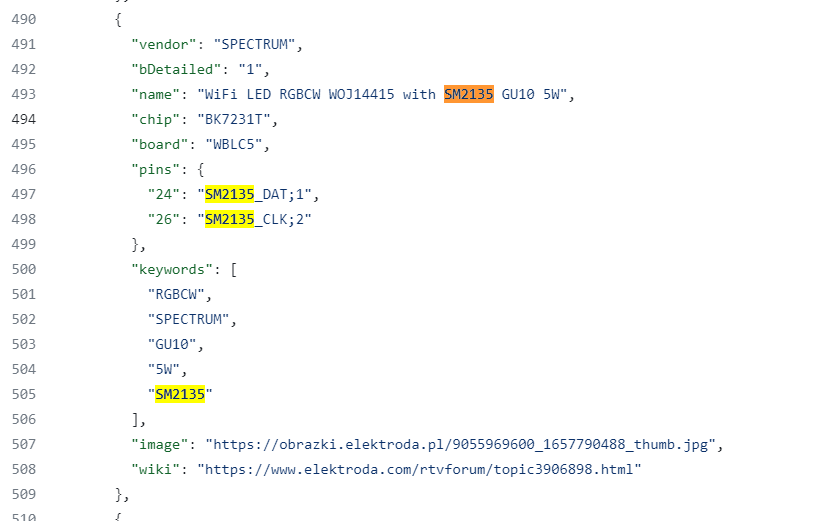

    That's quite a common choice of GPIO for SM2135:
