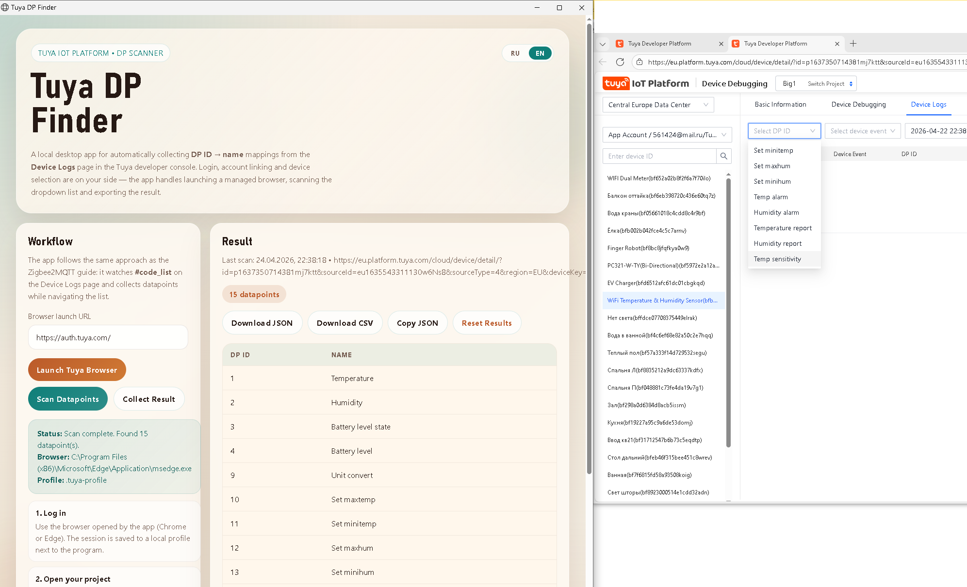

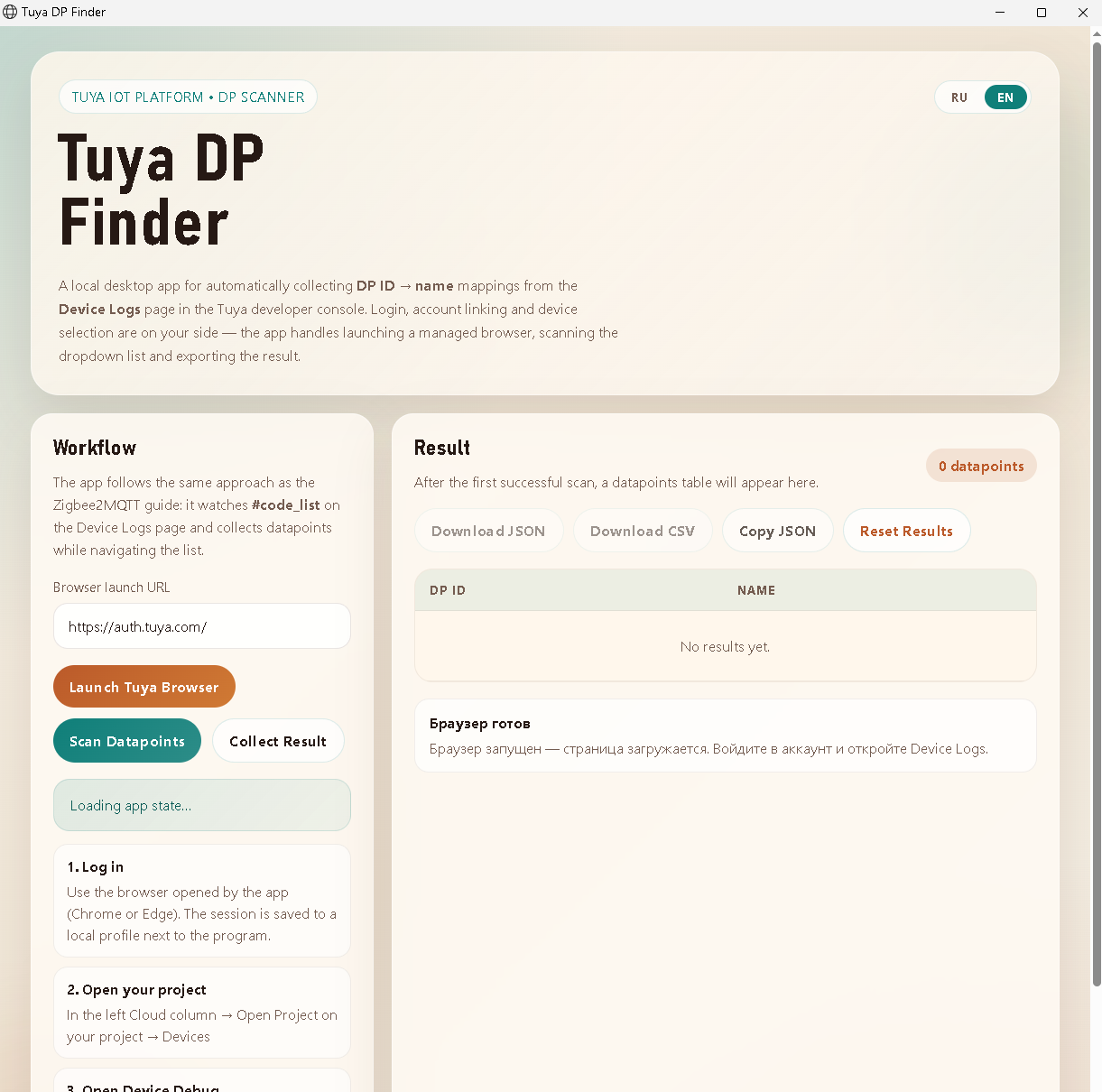

    I made an application that will make it easier to scan DP ID for TuyaMCU.
    Don't forget to select your data center location to see the devices.
    The app is written in GO.
    It starts a web server and opens the app window.
    Made based on the instructions:
    https://www.zigbee2mqtt.io/advanced/support-n...tuya_data_points.html#_8-find-your-data-point
    I made an GUI application for easier to scan TuyaMCU DP ID Scanner I made an GUI application for easier to scan TuyaMCU DP ID Scanner

    Unfortunately, we only receive ID data when the original device is connected to the Tuya server (simply adding it to the account is enough).
    I can make it so that anyone using the app can download this data with the click of a button.
    And then they can be compared by Device ID (like "bfb47cf3b55afbeeacuw8u")
    For full automation, you'll need to gain a much deeper understanding of Tuya's website parsing. For one or two devices at a time, it's easier to just click the buttons manually.
