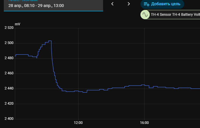

    I can't figure out how to find the correct battery pins. I'm currently using 5 - BAT_Relay, 10 - BAT_ADC. With this setup, I don't see 0% when starting. But I still think the pins are incorrect, as I get a large deviation in the readings when the temperature changes! After calibrating at 25C, I see 2.5V, but at 15C, I see 2.43V. Is this normal?

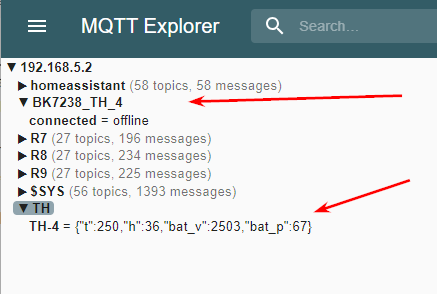

    I think I got what I wanted. But I can't figure out why it works.
    Screenshot of MQTT Explorer showing topic list and a JSON message for “TH-4”

    Please help. I can't configure BAT_ADC and BAT_Relay. Everything I've tried gives incorrect readings. Temperature also significantly affects the readings. Can someone tell me the correct pins for BAT_ADC and BAT_Relay from a photo?

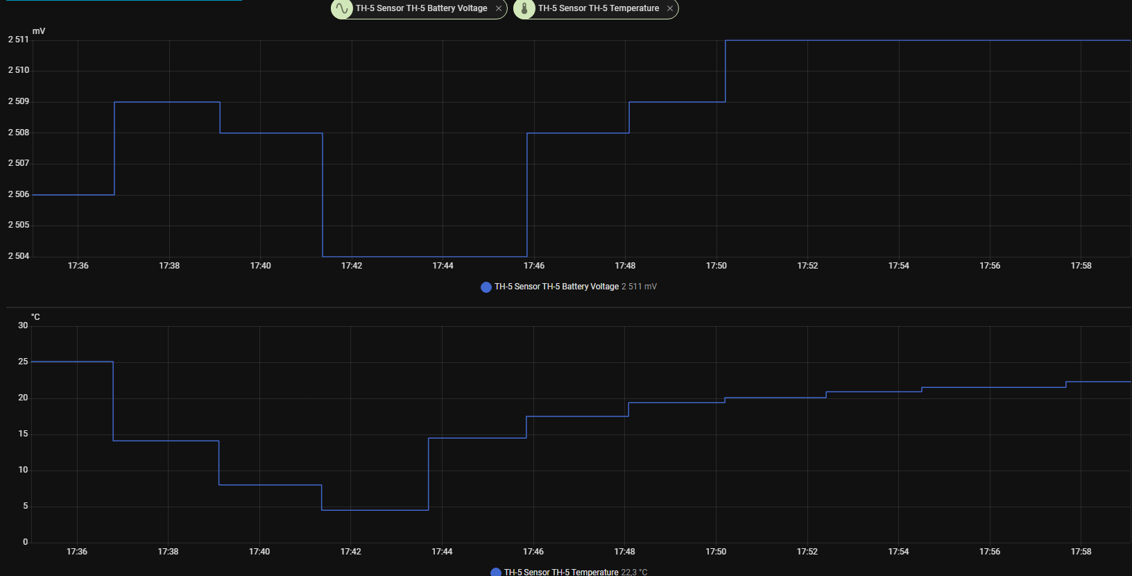

    divadiow wrote:
    P24 = BAT_ADC
    P26 = BAT_RELAY
    Looks like these are the correct pins! I stuck it in the fridge, and there's practically no deviation in the readings! As I understand it, 2.85 (Battery_Setup 2100 2700 2.85) isn't quite standard? But the main thing is that it works! I tried this option before, but the readings were ~3.00 mV. To get adequate readings, you need to reboot!
    Thank you so much!
