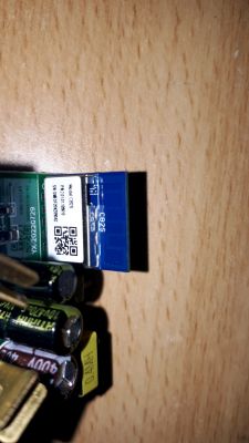

    This uses a Tuya WB2S module with a BK7231T chip.
    Arlec Grid Connect PC191HA Plug-In Socket with Energy Meter Teardown
    The device itself is fully ultrasonically welded in its plastic case, so not easy to dismantle without damage, however a generous tap with a small set of pliers while working around the seam with a thin, wide spudger was enough to break it free. Once disassembled there are no screws inside and the mains terminals pull through the enclosure. This also means reassembly will need to be strong enough to maintain mains isolation, so don't skimp on the super glue :)
    Inside I was relieved to see dual relays for switching active and neutral, though as with most of these devices, there is is a non-isolated power supply for the wifi module, so all IO are live, beware while debugging or flashing.

    As the TX/RX pins are used for the LED and Button, Dumping/Flashing also requires removing the module (or at least desoldering the TX/RX pins).
    There is one button, a red 'wifi' status LED, a blue relay indicator, a single relay control for both active and neutral relays, and a BL0937 energy meter.
    P6 (PWM0) is the Relay
    P7 (PWM1) is the BL0937CF pin
    P8 (PWM2) is the BL0937CF1 pin
    P24 (PWM4) is the BL0939SEL pin
    P26 (PWM5) is the LED
    P11 (TXD1) is the Button
    P10 (RXD1) is the Wifi LED

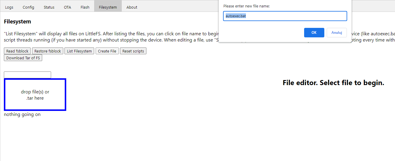

    I was able to install firmware to one of these devices today using the cloud cutter method, everything seems to work fine. Thanks for the detailed teardown.
    I am new to this firmware, is there an option or command to get the button press's to publish to MQTT?
    When I press the button the relay toggles which is great but I would like the button press's to publish to MQTT so I can pick up these events and trigger automations in Home Assistant.
    I can see the button press's in the logs of the device but not on the MQTT server.

    Hello, it's very easy to do this in OpenBeken! We have already a topic about that here:
    [OpenBeken] Push button actions multi press and hold down etc
    The sample code for autoexec.bat (from LittleFS from Web Application Tab) is here:
    https://www.elektroda.com/rtvforum/topic3946427.html#20367050
    But to make it easier for you, I will give you an example here:
    // 23 is GPIO number
    addEventHandler OnDblClick 20 publish myBtnEvent click2
    addEventHandler OnClick 20 publish myBtnEvent click
    addEventHandler On3Click 20 publish myBtnEvent click3
    addEventHandler On4Click 20 publish myBtnEvent click4
    addEventHandler OnHoldStart 20 publish myBtnEvent holdStart
    addEventHandler OnHold 20 publish myBtnEvent holdRepeat
    addEventHandler OnPress 20 publish myBtnEvent press
    addEventHandler OnRelease 20 publish myBtnEvent release
    Remember to reboot after setting that.
    But if you just want to play around, use the console and set event there, in that case event handler will be forgotten with reboot.
    Please also consult our commands list here:
    You can also use events to start a script with a button event and do things in the script.
    Remember, if you want to have button without "automatic" interactions, use Btn_ScriptOnly role instead of Btn.

    Thanks for your quick reply, I was able to add the event handler rules and now I get MQTT messages, I will read though the links you posted when I get home and try work out the best way to get those events into home assistant.
    Thanks again.

  • New PC191 units use CB2S BK7231N and OpenBeken
    #24 20568869
    tonyb62
    Posts: 37
    Appears these devices have been updated.
    I recently bought a new 4 pack of these sockets from Bunnings and quickly found that flashing these devices with cloudcutter didn't work.
    Note the fine print
    Opening the device shows a CB2S
    Arlec Grid Connect PC191HA Plug-In Socket with Energy Meter Teardown Arlec Grid Connect PC191HA Plug-In Socket with Energy Meter Teardown Arlec Grid Connect PC191HA Plug-In Socket with Energy Meter Teardown
    Again note the fine print
    Was able to connect to the CB2S without removing from the board and program using the Openbeken apt (BK7231N) and functional with the follow config
    Going to try cloudcutter again now that i know what is inside.
