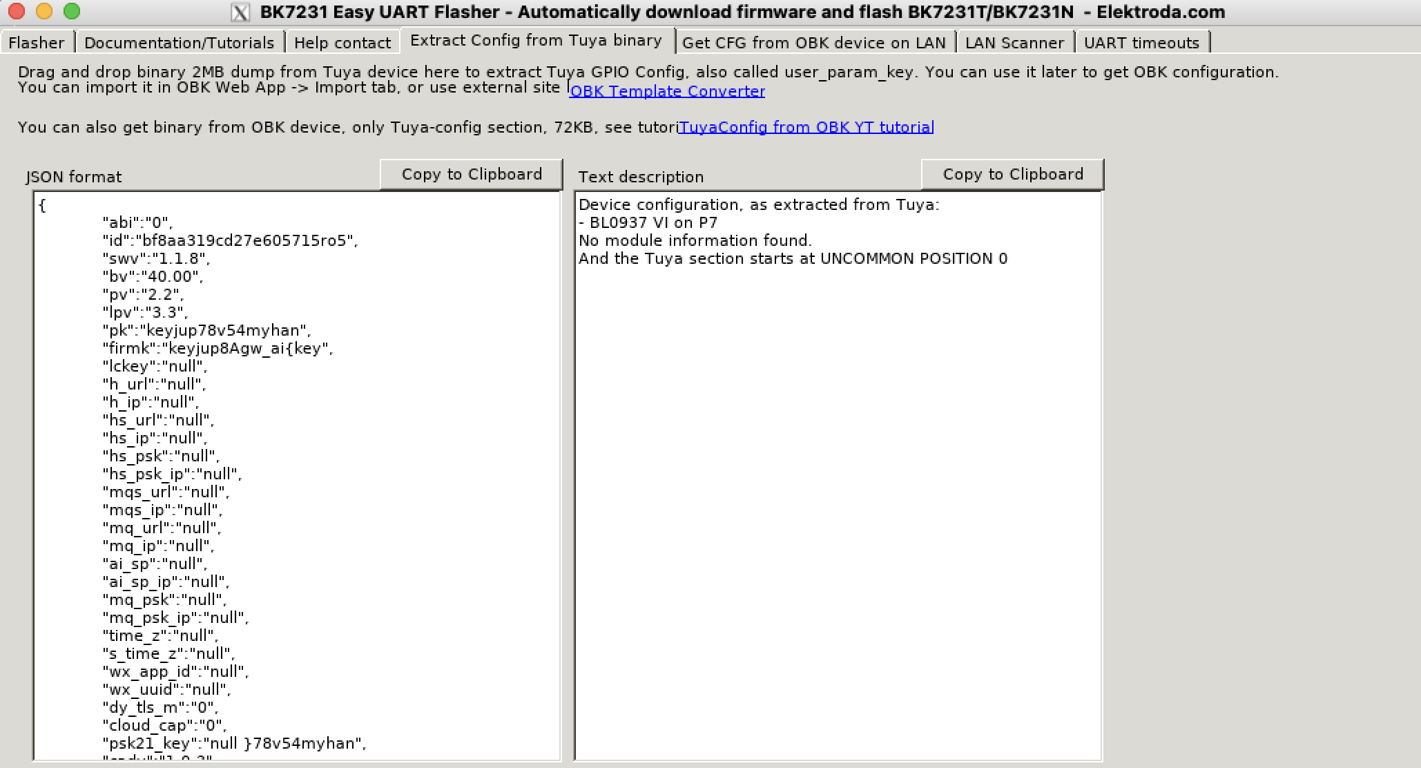

  • No Tuya pins data; trace GPIOs or reroute LED manually
    #24 20845557
    Posts: 14750
    Rate: 12866
    I checked your config and sadly there is no Tuya pins data to extract this time. That device may have a bit more custom firmware.
    So, we are left to either guessing or checking physically with a multimeter where the traces go.
    If you have a LED that is connected between VDD and GND (with a resistor) and not controllable by any GPIO, you can also consider routing it manually to one of the unused GPIOs of WiFI module with a small wire. Just make sure to include the resistor in the circuit and respect LED polarity. LED conducts only in one direction.

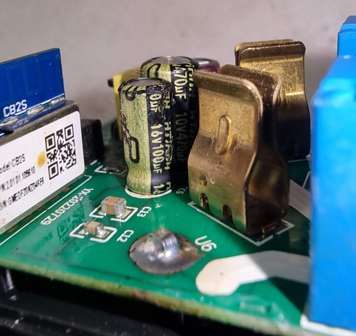

    After about 6 months my PC191HA became unable to reliably control the relays.
    Looking inside I could see the 470uF 10V electrolytic had a crowned top. It's the center of the three in the photo.
    After replacing that the unit is working normally again.
    Swollen 470uF 10V electrolytic capacitor on a circuit board.
  • #29 20971415
    Posts: 14750
    Rate: 12866
    Did you have PowerSave enabled for those 6 months?
  • #30 20972690
    andrewmarkcongdon
    Posts: 22
    No. This is the first I've heard of it.

  • One failed PC191HA had a crowned 470 uF 10 V electrolytic capacitor after about 6 months, and relay control recovered after replacement. [#20971254]

How do I flash an Arlec Grid Connect PC191HA Series 2 smart plug with Cloudcutter and OpenBeken?
Flash it by matching the PC191HA firmware and chip family before loading OpenBeken.
  1. Put the plug into Tuya AP slow-blink mode.
  2. In Cloudcutter, choose the detected firmware family, such as BK7231N v1.1.8.
  3. Flash the matching OpenBeken BK7231N or BK7231T image.
One user programmed CB2S directly with the OpenBeken BK7231N app without removing the module. Cloudcutter also worked later when the v1.1.8 BK7231N profile was selected. [#20569088]
What pin configuration works for the Arlec Grid Connect PC191HA Series 2 with a CB2S BK7231N module and BL0937 energy metering?
Use P6, P7, and P8 for BL0937 metering, P10 for the button, P24 for the relay, and P26 for WiFiLED. The working OpenBeken map is P6 BL0937SEL, P7 BL0937CF1, P8 BL0937CF, P10 Btn, P24 Rel, and P26 WifiLED. Set flags to 1024 for the shared template. "BL0937 is an energy-metering IC interface that reports voltage, current, and power pulses, using CF, CF1, and SEL lines to separate measurement channels." [#20569008]
