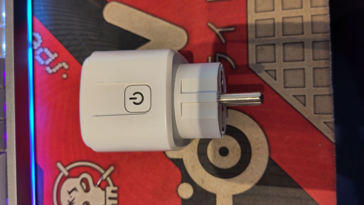

    I recently purchased a TNCE Tuya Wifi Smart Socket (Model: TCOGCZ20).

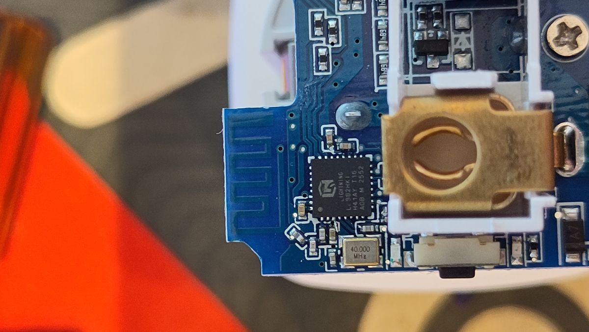

    I have successfully flashed it with OpenBeken and figured out the correct pin mapping for power monitoring, which was a bit tricky due to the LN882H pin grouping.
    Hardware Details
    Device: TNCE Tuya Wifi Smart Socket EU Plug 16/20A
    Model: TCOGCZ20
    Main Chip: LN882H

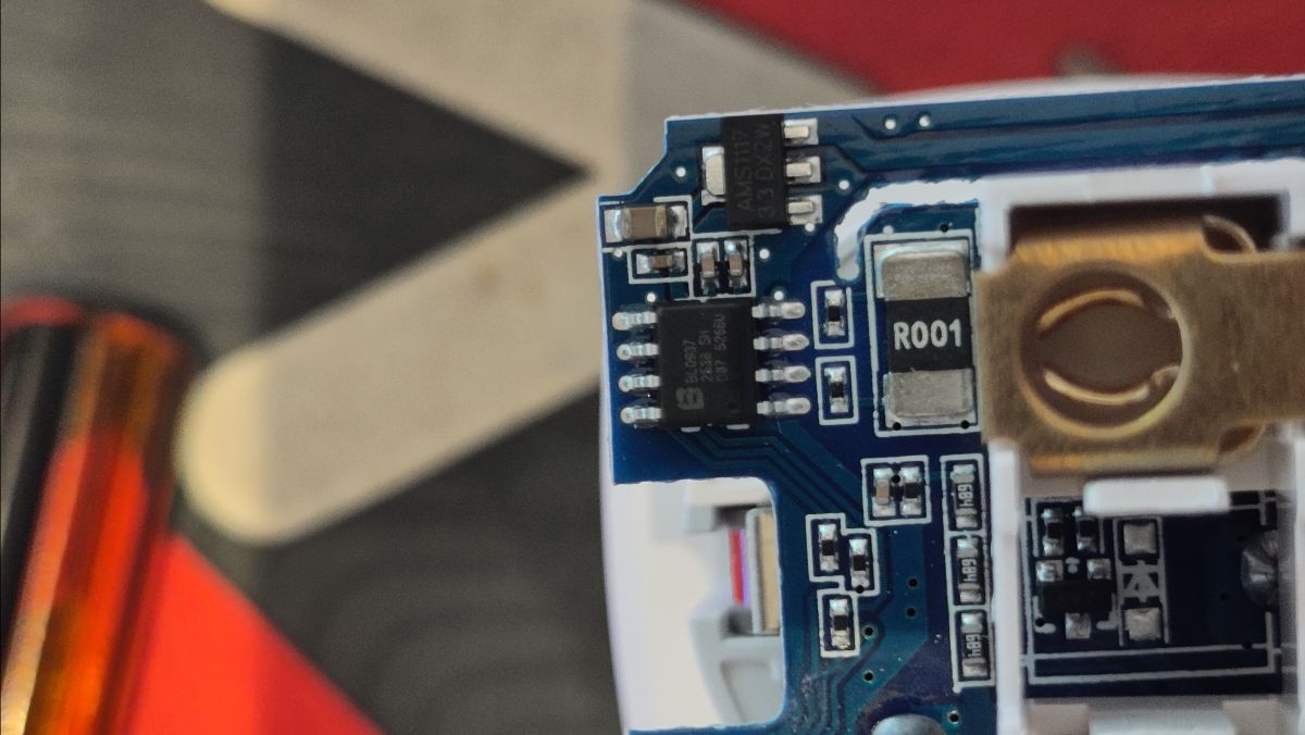

    Power Monitoring Chip: BL0937

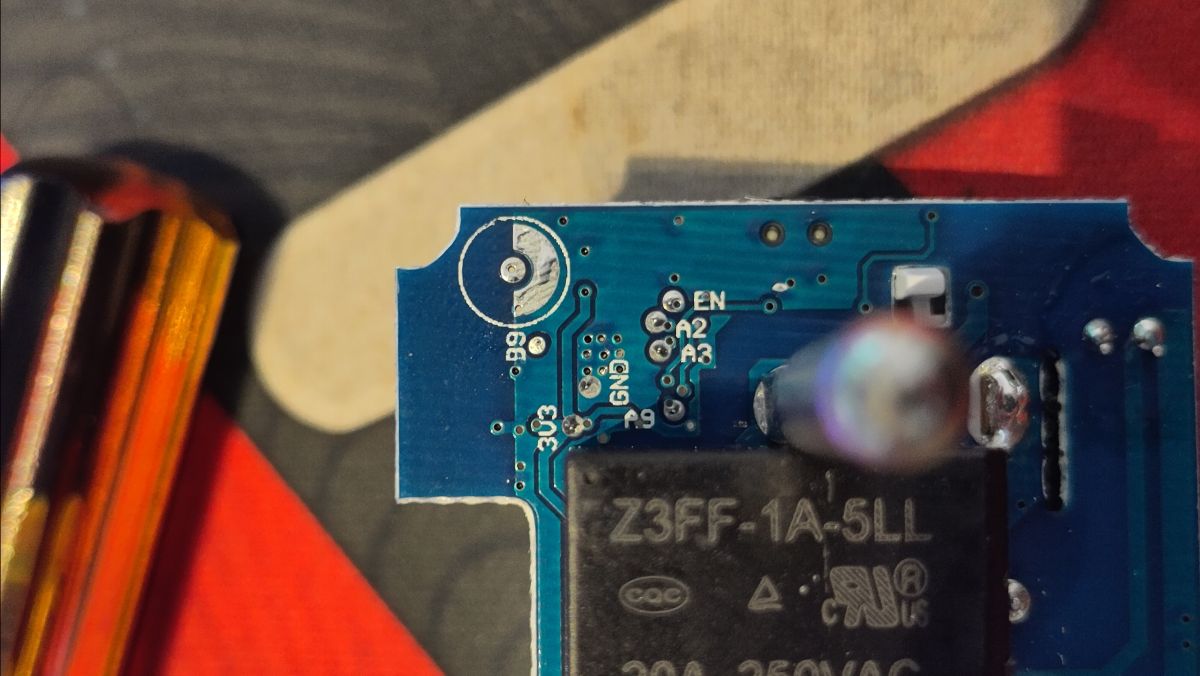

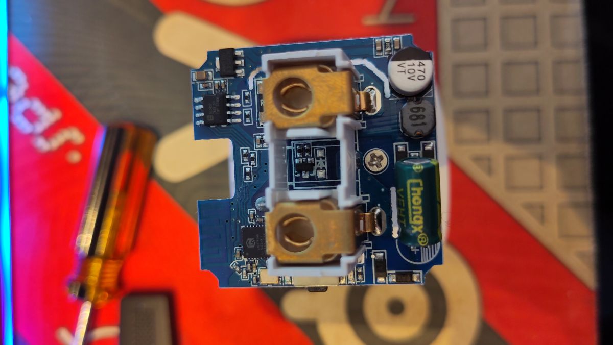

    Flashing Procedure
    The device has accessible pads on the bottom of the PCB. I used the BK7231 GUI Flash Tool (which supports LN882H).
    Wiring Map for Flashing:
    3V3 => 3V3
    TX0 (A2) => RX (of your USB-TTL adapter)
    RX0 (A3) => TX (of your USB-TTL adapter)
    GND => GND
    A9 => GND (Bridge to GND during boot to enter flash mode)

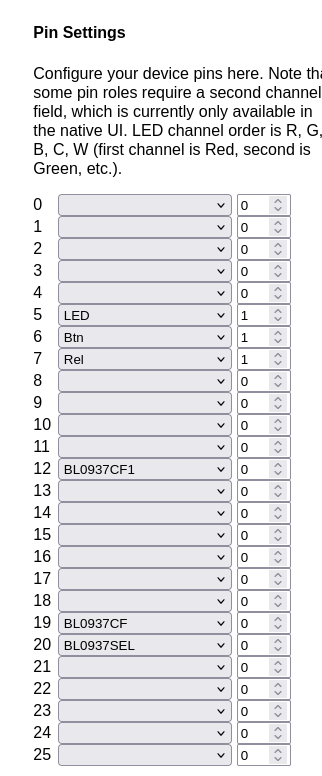

    Working Pin Configuration
    P5: LED (Channel 1)
    P6: Btn (Channel 1)
    P7: Rel (Channel 1)
    P11 (B3): BL0937CF
    P12 (B4): BL0937SEL
    P20 (A12): BL0937CF1
    Configuration Template
  • #2 21903306
    dmitrykit
    I have same board, but not showing voltage with this config.
  • #3 21903674
    EnYo15
    >>21903306
    Yeah, you are right, there was a typo in the config.
    Just to double-check, these are my pin settings:
    Screenshot of “Pin Settings” showing pins 0–25 with selected roles: LED, Btn, Rel, and BL0937 entries.
  • #4 21904145
    dmitrykit
    Thanks, now working, maybe someone have calibration setting for BL0937?
  • #5 21904424
    EnYo15
    >>21904145
    Unfortunately, no.
    You can go to Launch Web Application => Tools => Power Metering and use the guide to calibrate your plug.
    I have a power monitoring plug with a display and used a hair dryer as a load to calibrate the plug.
