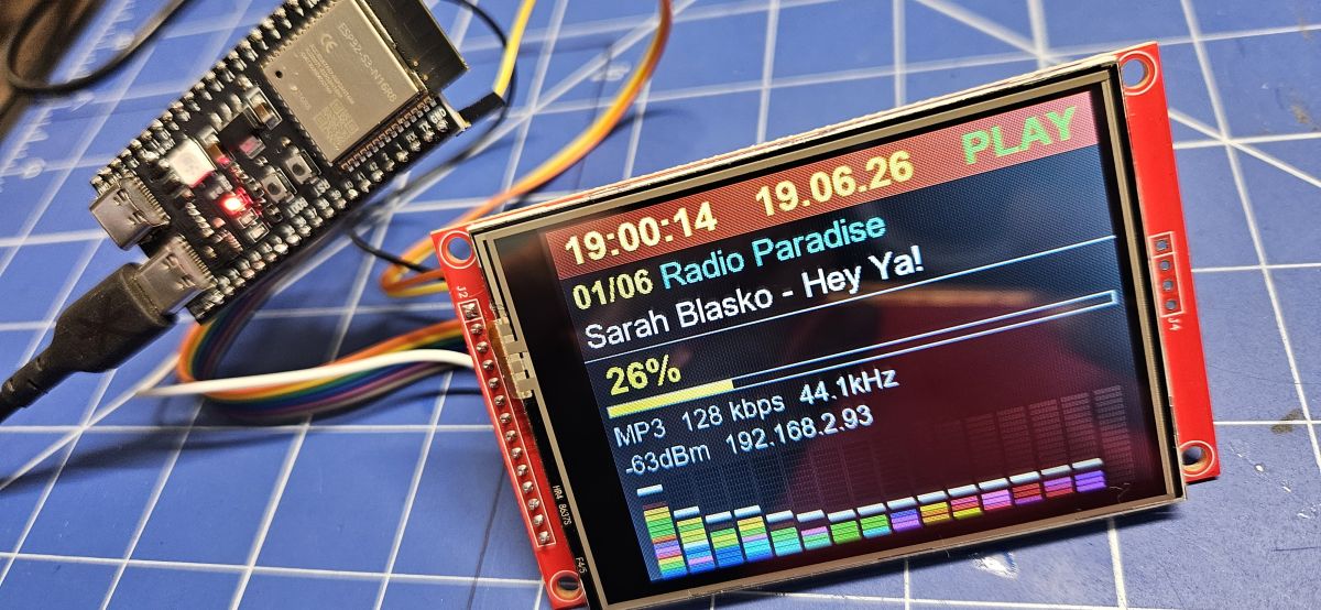

    jaostaszewski
    Seba_smd wrote:
    If you have a moment, could you check whether it works on the ILI9341 — 3.2" screen (320×240)
    I just quickly booted up the ESP and the display. Everything’s working as it should. It looks brilliant. With my eyesight getting weaker, the 3.2" screen does the job nicely. Overall, the colours are well chosen and the equaliser is impressive.
    Many thanks for the lightning-fast response :)
    ESP module connected to a color TFT display showing radio playback details and a multicolor equalizer bar

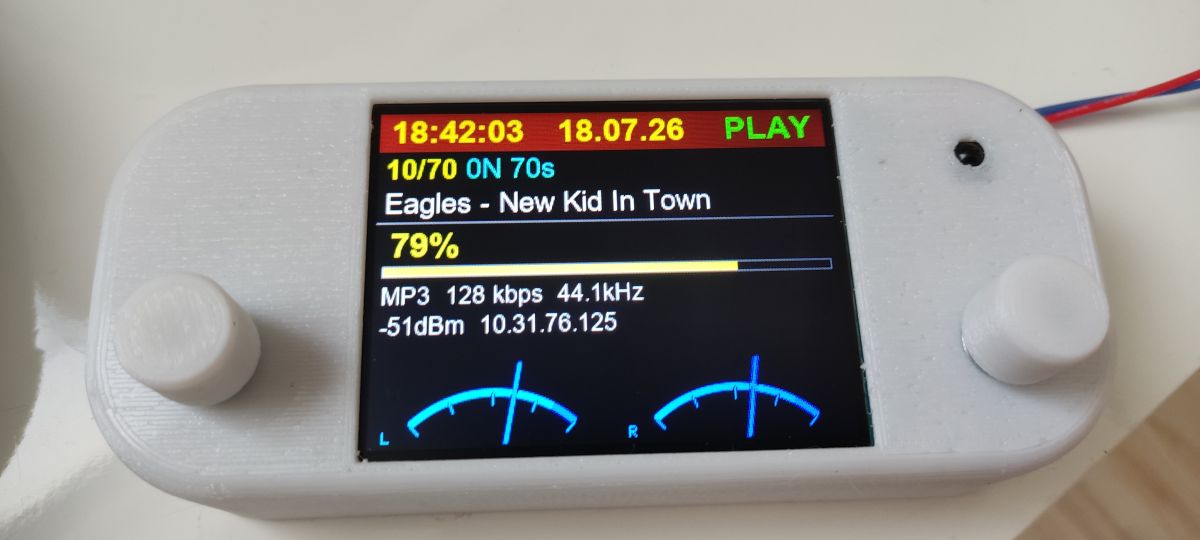

  • No current plan for ILI9488 480x320 support
    #42 21937222
    Seba_smd
    Posts: 323
    Help: 8
    Rate: 115

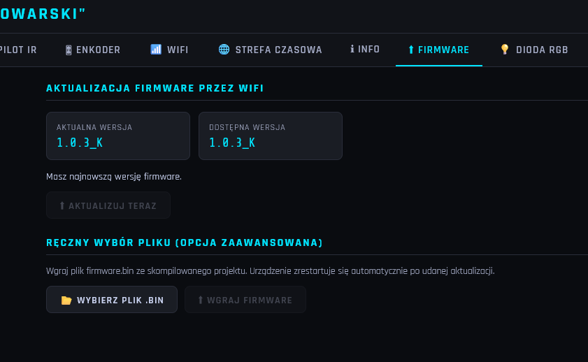

    mono12345 wrote:
    Thank you for all your hard work. It works brilliantly – right from the moment I switched it on. I have a question – are there any plans to add 480x320 displays for the ILI9488 (3.5", 4")?
    At the moment I don’t have the time, and I’ve already added quite a lot of what others wanted. A nice option is:
    Screenshot of “Firmware” tab with Wi‑Fi update section and manual .bin file upload
    Such displays are available at the moment. Anyway, I can’t remember how much memory the ESP32 uses – I’m already using quite a lot of it anyway.
    Screenshot of “Piwowarski” web panel with SH1106 1.3 I2C OLED and I2C pin settings.
    I’ve had a quick look. There’d be a problem here – I’d have to create everything from scratch: a different resolution and probably separate *.bin files to upload. And, as always, other issues to sort out. But maybe one day, when I’ve got plenty of time.

    piotrtbg1 wrote:
    Is it possible to update without a new build? I should add that I’m on version 1.0.0
    Only from version 1.0.3_J onwards. You can update via Wi-Fi and won’t lose your settings.

    Perhaps I’ll ask about updating via a .bin file. The thing is, I used esptool.exe to make a copy of the ESP’s contents with firmware 1.0.2, but I couldn’t flash it using your programme. I get a ‘Not Enough Space’ message, whereas the same .bin file can be flashed without any problems using esptool. What am I doing wrong?
  • Wi-Fi upload requires app image from 0x10000

    >>21939742
    I suspect you made a copy starting from address 0x0. Such a copy contains the entire contents of the ESP flash memory, meaning that, in addition to the firmware (application), it also includes the bootloader and the partition.
    Such a file is not suitable for uploading via Wi-Fi.
    Only the programme itself can be uploaded via Wi-Fi. (Unless, of course, someone has a different method :) )
    Try making a copy from address 0x10000 to 0x800000 and uploading it. I’m assuming that 8MB of flash memory has been allocated for the programme.
  • Wi-Fi firmware update preserves settings and station list
    #48 21939818
    miroskop
    Posts: 482
    Help: 65
    Rate: 66
    Yes, I copied the data from 0x0 to 0x1000000 and it’s probably just as you say, but I’m not going to fiddle about with it any more. I updated to version 1.0.3_K and it’s ‘working a treat’. Literally and figuratively.
    I’ve just updated the firmware from ‘K’ to ‘M’ via Wi-Fi. Everything went smoothly and I didn’t lose any settings. It’s great that I no longer have to reconfigure the remote or re-import the station list.

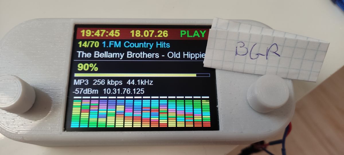

    I’ve updated the firmware to “O” and there’s one thing that doesn’t quite add up: to get the analogue indicators to be orange, I have to change the colour inversion in the settings, but then the rest of the screen looks like it’s from Windows 3.11. With the normal settings (black background, red bar, green ‘PLAY’), the indicators are blue.
  • #51 21940791
    Seba_smd
    Posts: 323
    Help: 8
    Rate: 115
    >>21940762
    Paste a photo??
    The simplest Internet radio on the ESP32-S3? No installation required – just upload it and it works!
  • #52 21940809
    miroskop
    Posts: 482
    Help: 65
    Rate: 66
    I’m posting just one photo, even though I took two: one in RGB and one in BGR, but they’re identical. I’ll just add that I prefer the colours of the bar and text on my panel :)
  • #53 21940835
    Seba_smd
    Posts: 323
    Help: 8
    Rate: 115
    >>21940809
    These colours do not match those for which the display was designed. You need to change the ‘Colour Adjustment’ setting.
    Although the blue ones look good too.
    It’s a nice little case.
  • Color changes have no effect on the display

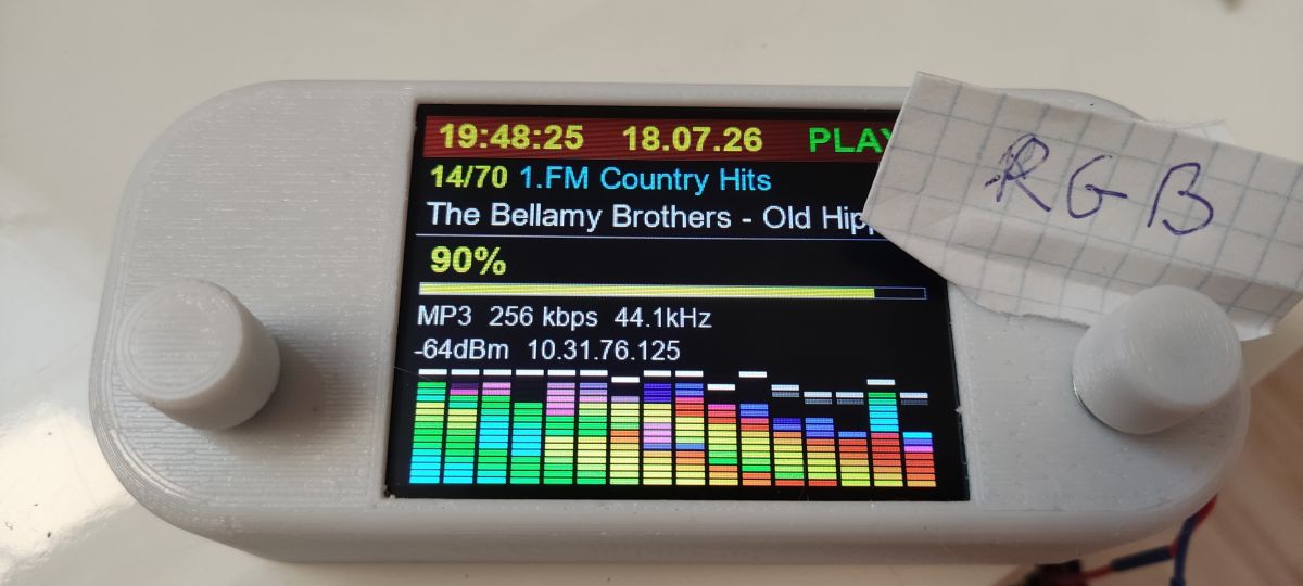

    As I said, changing the colours doesn’t make any difference – there’s no difference at all. Note that in the video you posted at the start, when you changed the colours to the correct ones, you had a red bar (at around the 10-minute mark), but now you have a blue one, so something’s not quite right here. Besides, in the photo of jaostaszewski’s display (20 posts above), the colours are the same as mine.
    I’m attaching photos with two settings; I’ve added colour bars as it’s more colourful ;)
  • Suggesting RGB save-and-apply test for display colors

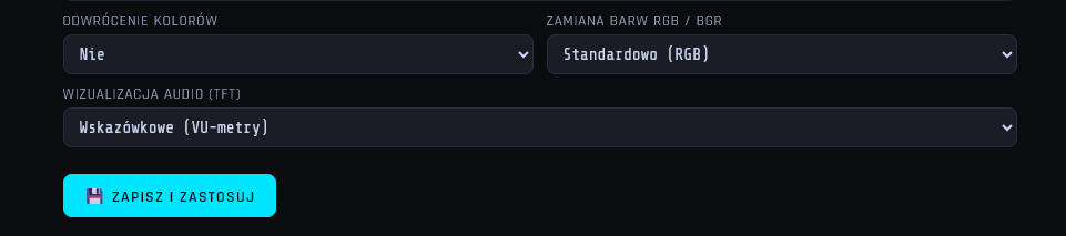

    Here’s another way. When you go to the page, refresh it, switch to ‘RGB’ and click ‘SAVE AND APPLY’
    And when you go to the page and refresh it, do you see “RGB”??
    And try the other way round. In “Change colours”, can you see what you saved???
    I’ve asked others and they haven’t had any problems.
  • Save and apply changes for display settings

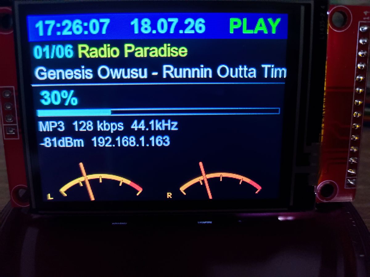

    To version "K" via USB, then via Wi-Fi. Display: 3.2" ILI9341.
    I downgraded the firmware to version 1.0.2 as that’s the version of the .bin file I have, but it didn’t change anything; the only effect is ‘Colour inversion’, whilst switching from RGB to BGR doesn’t work. The only thing I’ve noticed is that, after refreshing, the programme selects the ST7789 driver from the list rather than the ILI9341. Of course, I’ve checked: I get no image on the ST7789.
  • Wi-fi update to v1.0.3_P requested
    #59 21941357
    Seba_smd
    Posts: 323
    Help: 8
    Rate: 115
    Unfortunately, I don’t have a display of that type to test it on.
    I’ve made a minor tweak, but I’m not sure if it’ll make any difference.
    Could you try ‘UPDATE NOW’ via Wi-Fi to v1.0.3_P and see if anything has changed?
  • IR remote enabled causes full display restart
    #60 21941373
    miroskop
    Posts: 482
    Help: 65
    Rate: 66
    Yes, it’s changed. The colour switching is now working – I’ve got orange indicators for BGR and blue ones for RGB. It would be best if you could change the colour of the indicators themselves, but that’s just a minor detail. By the way, I’ve noticed one more thing (don’t get annoyed, mind you): as long as the IR remote is inactive (disabled in the settings), any changes to the display are applied almost instantly – the image just flickers and that’s it; for example, the colours are swapped. Once the remote is switched on, every change to the display triggers a full restart, taking you through the welcome screen and logging you back onto the internet. It’s a bit of a faff, really, as normally you only set the display once and that’s that, but since I’m testing this radio, I might as well go all out.
