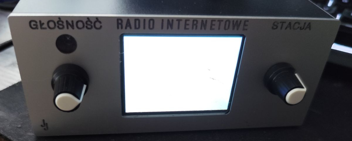

    My Samsung TV remote turns on the radio. :(
    In some versions, the background is white when switched off, and in others it’s black.
    In version "o", it’s white.
    In version ‘o’, it’s white.
    Because it’s the same IR code. Change the button; programme a different one.
    Which display are you referring to? A photo, perhaps. “The background is white when switched off, and black in some versions.” I’m not entirely sure what you mean – different display connections?? Where is the display backlight connected? etc...
    Does the slider dim and brighten it?

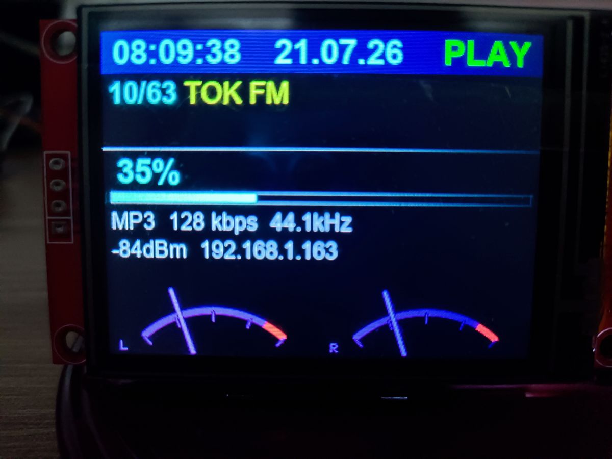

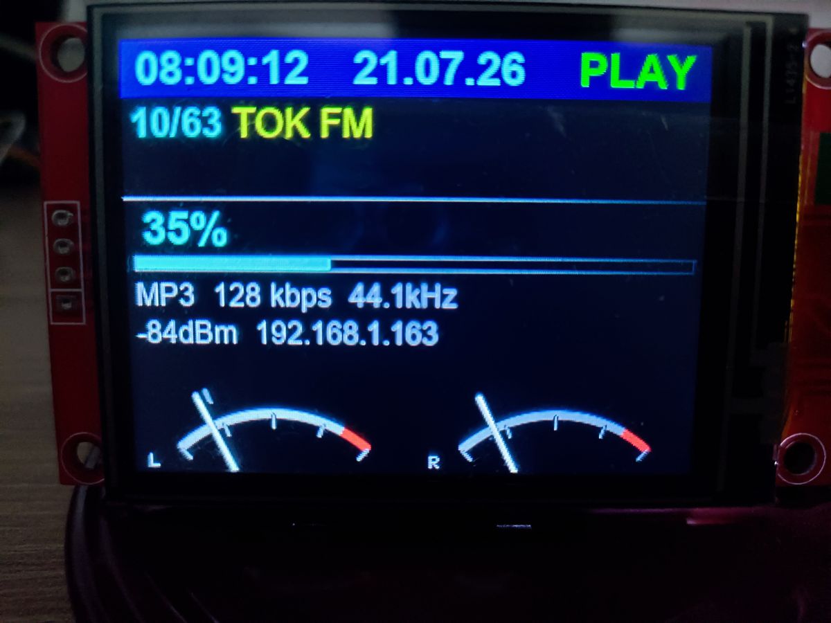

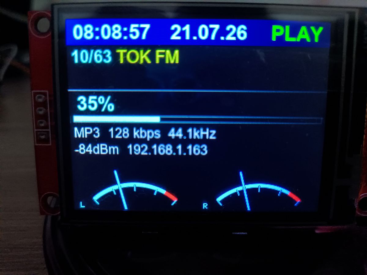

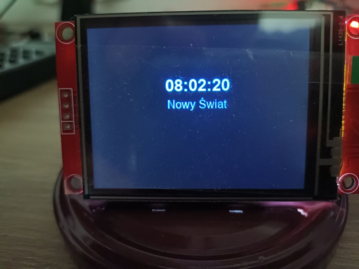

  • Remote control wakes unprogrammed keys and backlight stays on
    #66 21941942
    kombo
    Posts: 61
    Rate: 40

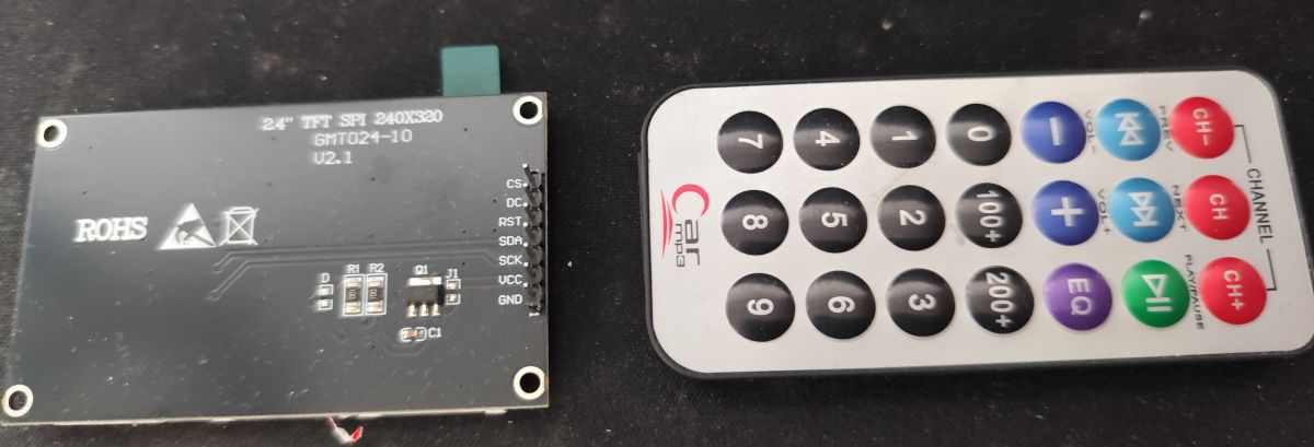

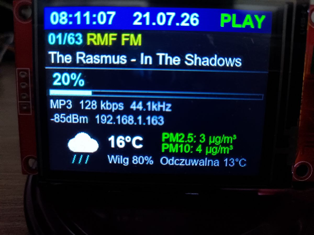

    >>21941620 The remote control wakes the radio using keys that haven’t even been programmed.
    The display has a backlight that is permanently connected internally.
    The image showing the display’s state after sleep mode, which I mentioned earlier, is either white or black depending on the firmware.
    The simplest Internet radio on the ESP32-S3? No installation required – just upload it and it works!
    Back of a 2.4 TFT SPI display module with labeled pins, next to a small remote control
  • Permanent backlight prevents LCD power-off in sleep mode
    #67 21941960
    Seba_smd
    Posts: 317
    Help: 8
    Rate: 95
    There are no pins labelled:
    LED
    BL
    BACKLIGHT
    This means that the backlight is permanently connected to the power supply by the module manufacturer. The processor cannot switch it off.
    This explains your problem.
    After going into sleep mode:
    the LCD circuitry may be switched off,
    but the LEDs remain lit.
    As a result, you see:
    a black screen,
    a white screen,
    sometimes a grey screen,
    depending on the state of the LCD controller, rather than the backlight.
    Is there anything that can be done about this? I’ll have to think about it.

    As a last resort, you could use the power status pin and cut off the power to the LCD via a MOSFET.

    I did a quick test: every remote control I have at home turns the radio on, but not every button on the remote works.
    The remote for the TV box, the one for the Yamaha receiver, and the Samsung TV remote (which has already been replaced).
    With firmware ‘S’, the screen is dark.
    I’ll fit a MOSFET, though, as suggested by the chap above.

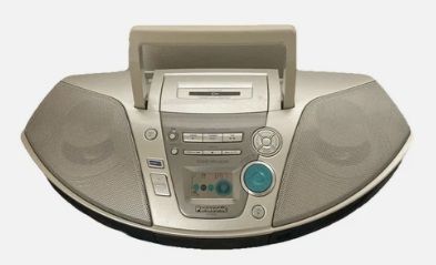

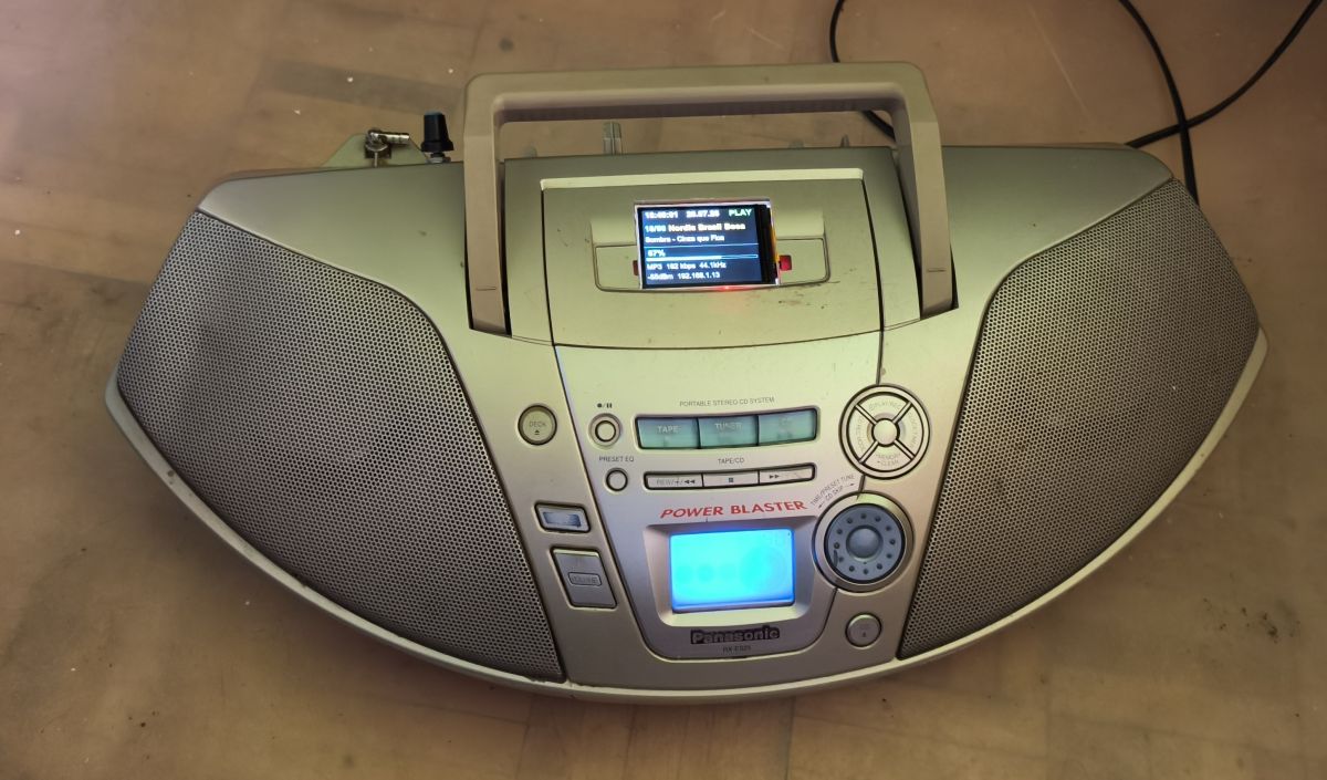

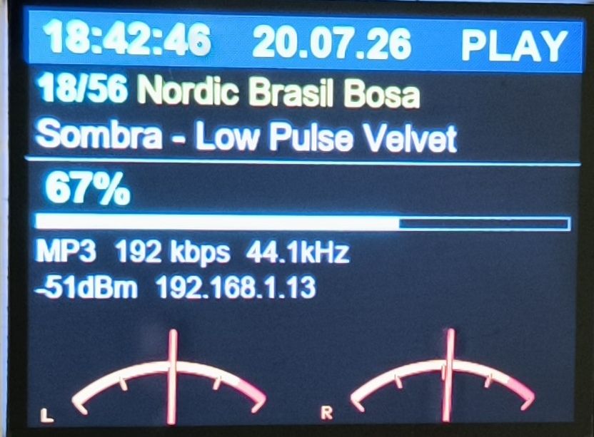

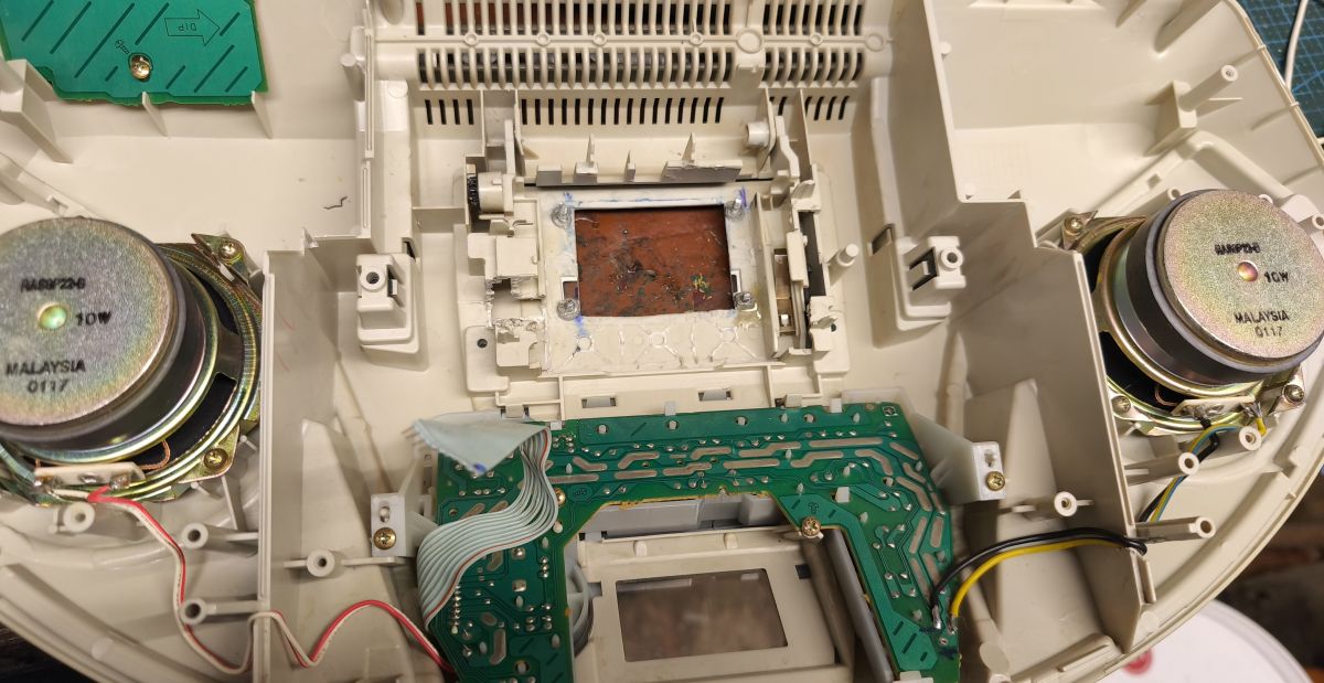

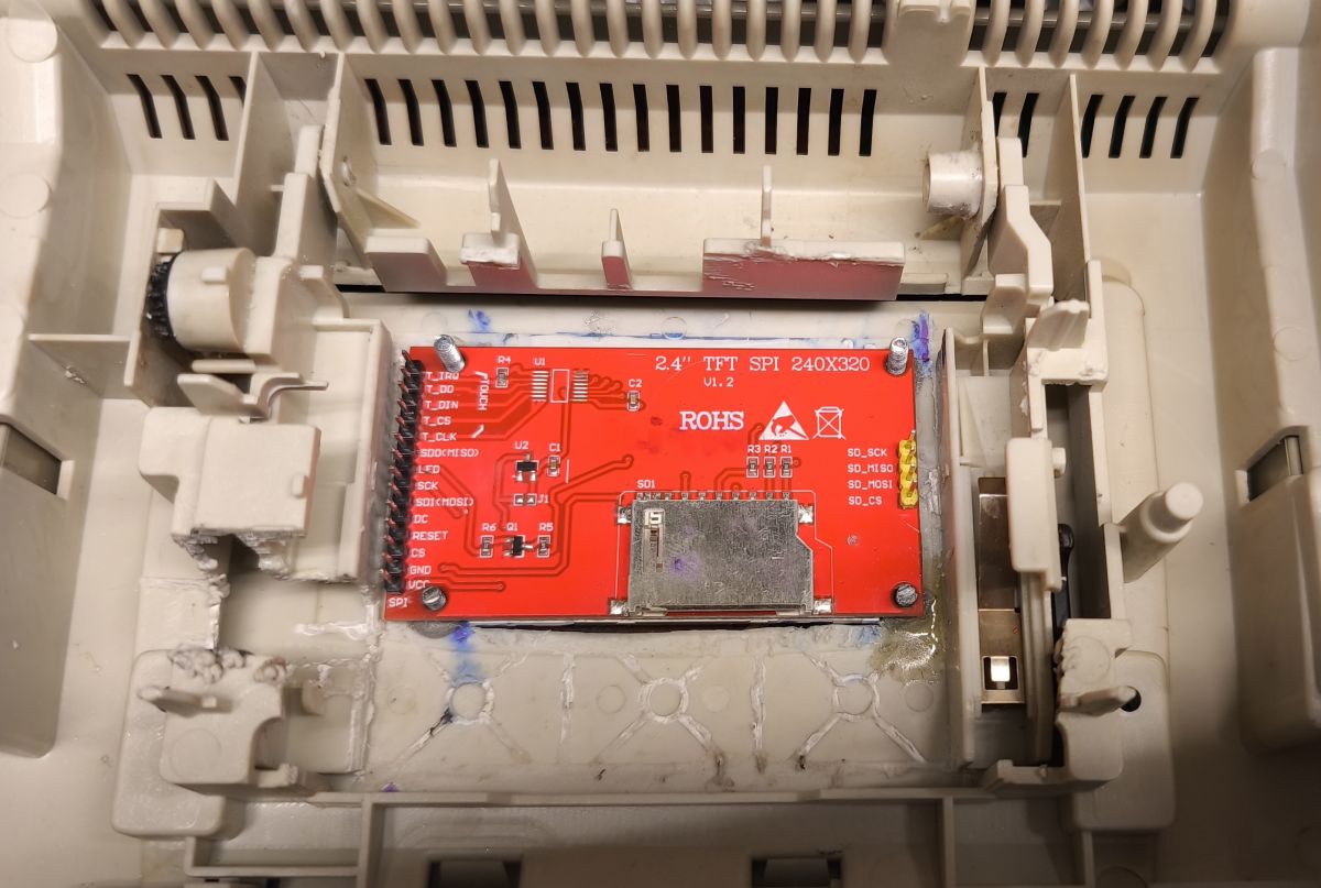

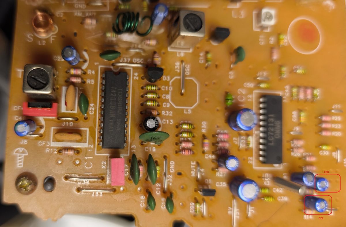

  • ESP32-S3 radio retrofit into Panasonic RX-ES25
    #70 21942246
    wojo1971
    Posts: 41
    Rate: 101
    >>21941962

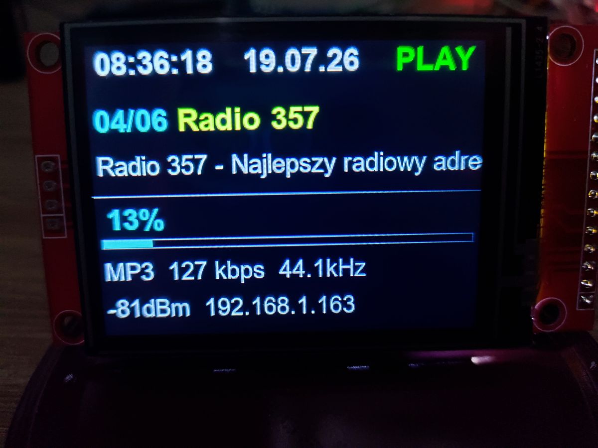

    Inspired by the author’s innovative approach to implementing a key component of an internet radio, based on the ESP32-S3, PCM5102 and ILI9341 LCD, I put together a ‘spider-style’ circuit as a test – it worked first time!
    The only thing that isn’t 100% compatible in my setup is the behaviour of my 240x320 ILI9341 display, which works, but when you select the ST7789 (when the ILI9341 is selected, it’s rotated by 90°)...
    ...I couldn’t leave that ‘spider’ layout permanently; playing around with the radio and searching for interesting streams is great fun, but it’s worth listening to it on something other than just headphones :)

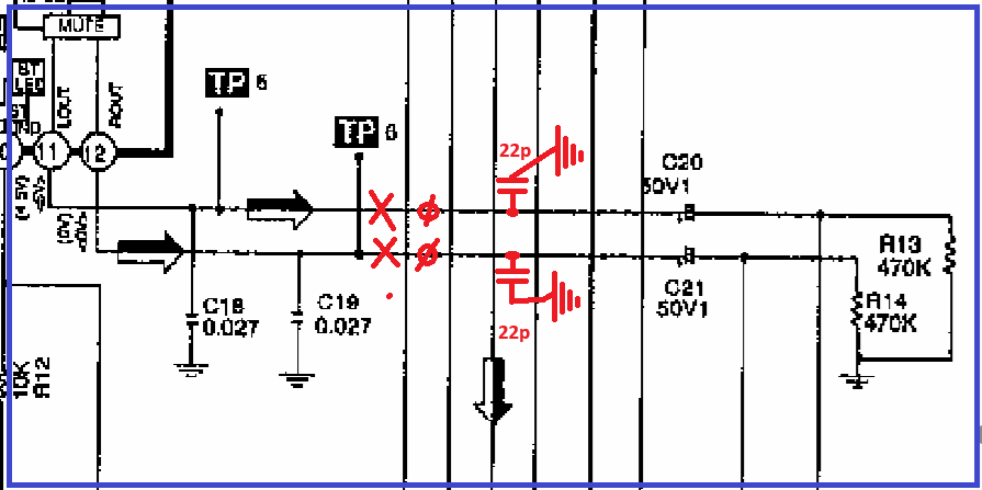

    I had an old Panasonic RX-ES25; everything was broken apart from the speakers and the amplifier – a great starting point for combining with the following components: ESP32-S3, PCM5102 and ILI9341 LCD + a rotary encoder for changing stations.
    After two days of basic mechanical and electrical modifications, the kit is finally up and running.
    Well done, Author!
    Below are a few illustrative photos, intended to encourage you to try your own adaptations (this is by no means a manual, particularly regarding the construction of the 5V DC power supply)
    Before the photos, here are the technical details:
    - ESP32-S3, PCM5102, ILI9341 LCD (assembled on a universal PCB) and 1 encoder for changing stations;
    - the power supply is an Alcatel 5V/550mA charger;
    - the audio signal from the PCM5102 is connected in place of the analogue signal from the FM tuner (p.11 and p.12, TA2008AN); there’s no need to fiddle with anything – simply switch to ‘tuner’ mode;

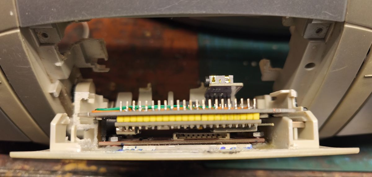

    Close-up of a PCB with ICs, capacitors, and resistors; two parts in the lower-right corner outlined in red
    The whole unit (apart from the 5V power supply and the station-selection encoder) has been fitted in the space left by the removed cassette mechanism. It’s been assembled and it works...
    Inside an audio device with two speakers and a green PCB mounted in a plastic housing
    Red 2.4-inch TFT SPI display controller board mounted inside a white device housing
    Electronics board mounted in the cassette deck opening inside an audio device
    Panasonic boombox with a small LCD screen fitted in the top recess and visible wires hanging down

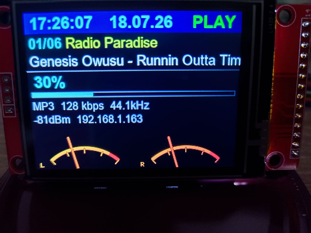

    To allow volume control from a single location, the digital section has been set to 67% via software.
    LCD screen showing audio player UI: time, date, “PLAY”, track info, 67% volume, and L/R meters
    The equipment was set up today – a digital version of the Panasonic – and there will be a cosmetic tweak –> a border around the LCD... in short, a good audio companion for the workshop :) ...
    ...ultimately, I plan to build a separate wooden tower version with a blue OLED (but that’s for 2026/2027).
  • Remote wake issue and display compatibility notes

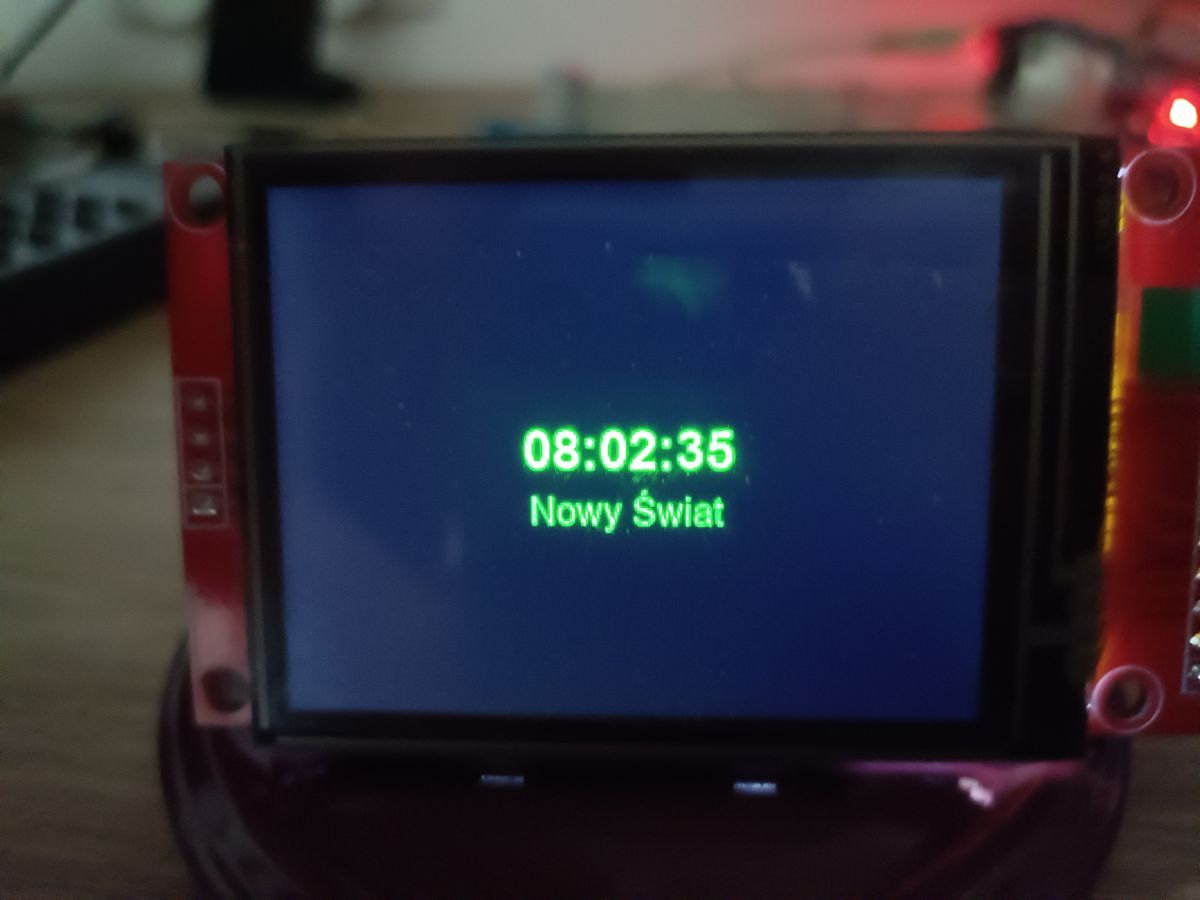

    Added after 1 [minute]:
    wojo1971 wrote:
    >>21941962
    The only thing that isn’t 100% compatible for me is the behaviour of my 240x320 ILI9341 display, which works, but when you select ST7789 (when the ILI9341 is selected, it is rotated by 90°)...
    Exactly – these are two different displays with different control schemes.
    The aim was to create a simple and fast version of an internet radio without having to install unnecessary software. Unfortunately, as always, there are quite a few problems to sort out, which is why no one has done it this way before. But that’s all about to change.
    It’s great, though, to refurbish an old radio , which wasn’t working or had been left unused – it’s a brilliant way to put it to good use again.
    I’ve already converted a few receivers for friends.
    Added after 10 [minutes]:
    kombo wrote:
    >>21941620 The remote control wakes the radio up using buttons that haven’t even been programmed.
    Can you update via Wi-Fi and check whether the display is working correctly?
    You need to press the programmed button on the remote control twice to wake the radio.
    !! Unfortunately, due to a lack of time, I am unable to test all the radio’s functions. !!
    The simplest Internet radio on the ESP32-S3? No installation required – just upload it and it works! The simplest Internet radio on the ESP32-S3? No installation required – just upload it and it works! The simplest Internet radio on the ESP32-S3? No installation required – just upload it and it works! The simplest Internet radio on the ESP32-S3? No installation required – just upload it and it works! The simplest Internet radio on the ESP32-S3? No installation required – just upload it and it works! The simplest Internet radio on the ESP32-S3? No installation required – just upload it and it works! The simplest Internet radio on the ESP32-S3? No installation required – just upload it and it works! The simplest Internet radio on the ESP32-S3? No installation required – just upload it and it works! The simplest Internet radio on the ESP32-S3? No installation required – just upload it and it works!

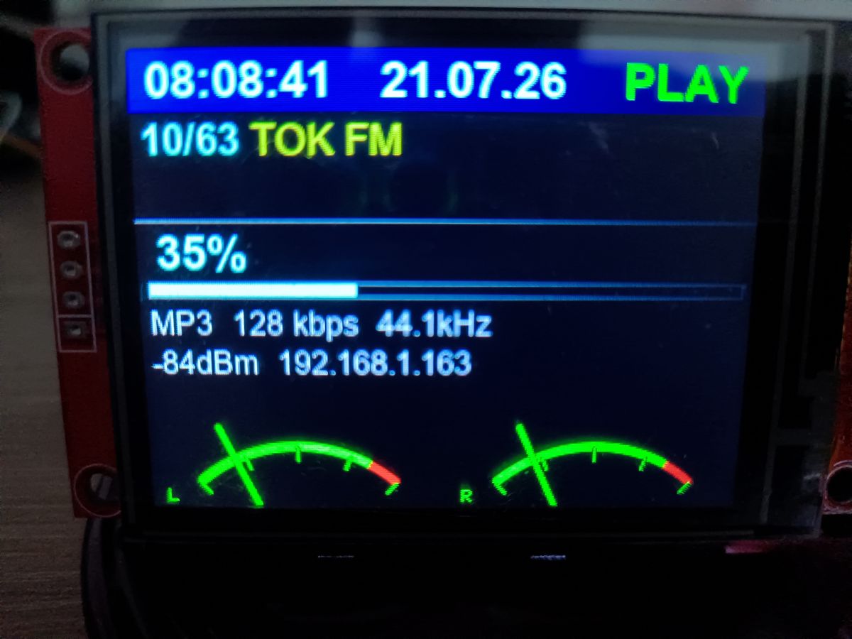

    Screensaver:

    I had a quick look at the new software (_T) and my jaw dropped. The remote works just as you described, but what you’ve quietly done with the VU meter – that’s brilliant. I’ve got no further requests or comments. THANK YOU!
  • #73 21943182
    kombo
    Posts: 61
    Rate: 40
    The latest firmware update has resolved the issue with the screen going blank and the device waking up due to random IR codes.
    The radio is working perfectly.
    Thank you.
