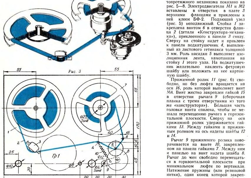

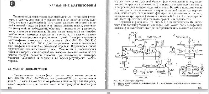

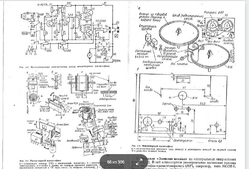

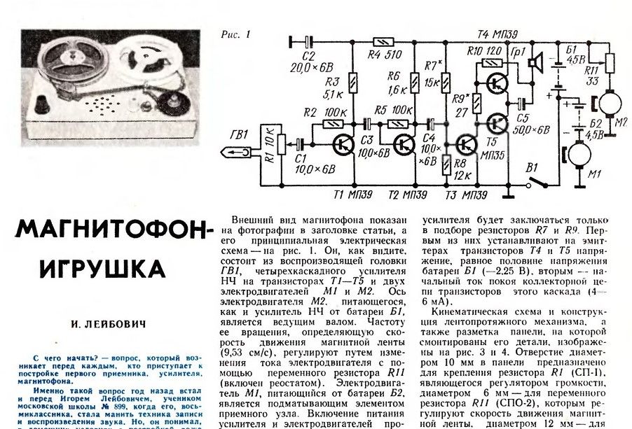

    As a beginner, I once built a simpler design, described in the magazine ‘Radio’ No. 8, 1974.
    Is it possible to build a high-quality reel-to-reel tape recorder yourself? A beginner’s experience.
    Its mechanical part consisted of two electric motors from toys. One of these drove the spool winding mechanism, whilst the other served as the tape feed shaft and flywheel. I mounted the entire mechanical assembly on a plywood panel, although the article recommended using a plastic sheet, which I couldn’t find in the countryside. I took the rubber ring, which presses the tape against the shaft, from an old record player, as recommended by the author. It had a larger diameter and was thinner than a typical one, but it worked perfectly.
    However, I used a different circuit diagram. As far as I recall, it was based on three transistors and included a correction circuit. When recording onto magnetic tape, low frequencies are attenuated, whilst high frequencies are amplified. The magnetic head itself also reads the signal unevenly — at high frequencies, the signal fades because the wavelength becomes comparable to the spacing between the gaps in the head’s core. Therefore, the amplifier must be supplemented with a correction circuit, usually consisting of an additional resistor and two capacitors.
    In my case, the circuit lacked a power amplifier, and the mechanism lacked a casing. I connected it to a radio, fitting the mechanism in place of the record player. I remember the moment when it all started playing! Of course, it wasn’t a tape recorder in the full sense of the word, but rather a player. I got the reels of recordings from a neighbour. The tape speed was approximately 9.52 cm/s. It could be adjusted using a potentiometer, but I soon grew tired of this and added a stabiliser based on a classic feedback circuit.

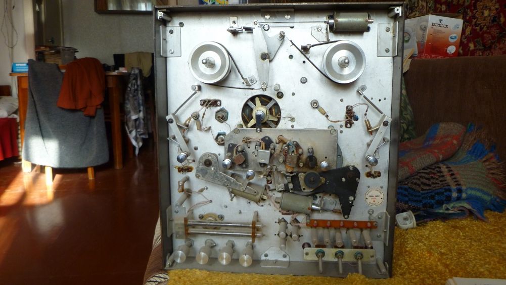

    It was the late 1970s. This success gave me a boost, and I decided to build a more complex, high-end piece of equipment. The problem lay in constructing the mechanical part. I had the entire tape-transport mechanism from a mass-produced monophonic valve tape recorder. However, it had certain drawbacks — the tape speed was 4.76 and 9.52 cm/s, whilst Hi-Fi equipment requires at least 19.05 cm/s, and professional equipment achieves speeds twice as high. This problem could be solved by changing the diameter of the rollers on the motor; however, the mechanism only allowed the use of reels with a diameter of up to 15 cm, which was definitely insufficient at a speed of 19.05. There was also no room for a recording head. Naturally, I wanted separate tracks for recording and playback.

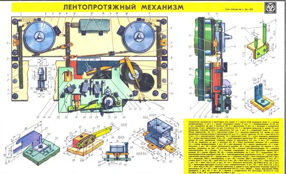

    The only solution, therefore, was to build my own tape-transport mechanism using components from this tape recorder. The most important components were the shaft with the flywheel, the motor and the roller pressing the tape against the shaft, as I was unable to make these myself under the circumstances — nor was there any point in doing so. For the reel-to-reel drive, I wanted to use separate motors, which I ‘borrowed’ from old turntables. This solution is fully in line with the concept of Hi-Fi tape recorders and greatly simplifies the mechanics. In cheap tape recorders designed for winding onto reels, clutches connected by a belt or rubber rollers to a single motor are used, which causes an uneven load and affects the tape’s feed speed.
    I had originally planned to mount the whole assembly on a support plate made of thick aluminium alloy. Today, however, I believe that this would not be a good solution due to the transmission of vibrations. It is better to construct the winding and belt-feed mechanisms on separate plates, connected by a metal angle bracket via rubber inserts. I came across this solution in an amateur design described in the aforementioned magazine ‘Radio’. However, as can be seen, it also has a serious drawback — the torque from the motor shaft to the flywheel is transmitted via a rubber roller. I understand that the author intended this to simplify speed adjustment; however, if the roller is left stationary for a prolonged period whilst in contact with the motor shaft and the flywheel, it becomes deformed, causing vibrations and an uneven belt feed. I am familiar with this phenomenon from cheap record players. In this case, I would prefer to use a rubber belt and choose a different method of speed adjustment, such as an electronic one. However, at that time it was much more complicated than it is today.

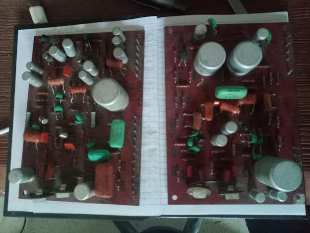

    I didn’t build the electronics myself, as I was unable to produce printed circuit boards of sufficient quality at home. I bought a set of three boards, mass-produced for similar designs. They have survived to this day, which suggests that I didn’t manage to complete this project. But let’s take it one step at a time. One of these boards contained the playback circuit (amplifier), the second the recording circuit, and the third the voltage regulator and the erase and bias current oscillator (I’ve lost that board).
    I also bought some high-quality heads (I used one of them as an acoustic filter coil in a QRP direct-conversion transceiver ).
    Conclusion: despite the complexity of the subject, it is possible to build an analogue reel-to-reel tape recorder yourself, and its quality and ease of use can be superior to those of the era when they were at their peak. I don’t know how it was in Poland, but in the Soviet Union, building such mechanisms was not exactly legal, as it required lathe work that was only available in state-run factories. These factories, in turn, had to fulfil party quotas. However, many DIY enthusiasts somehow managed to come to an arrangement with the lathe operators, and at specialist exhibitions one could come across high-quality designs.
    Such as, for example, this amateur-built tape recorder by I. Zamotkin from Saratov.
