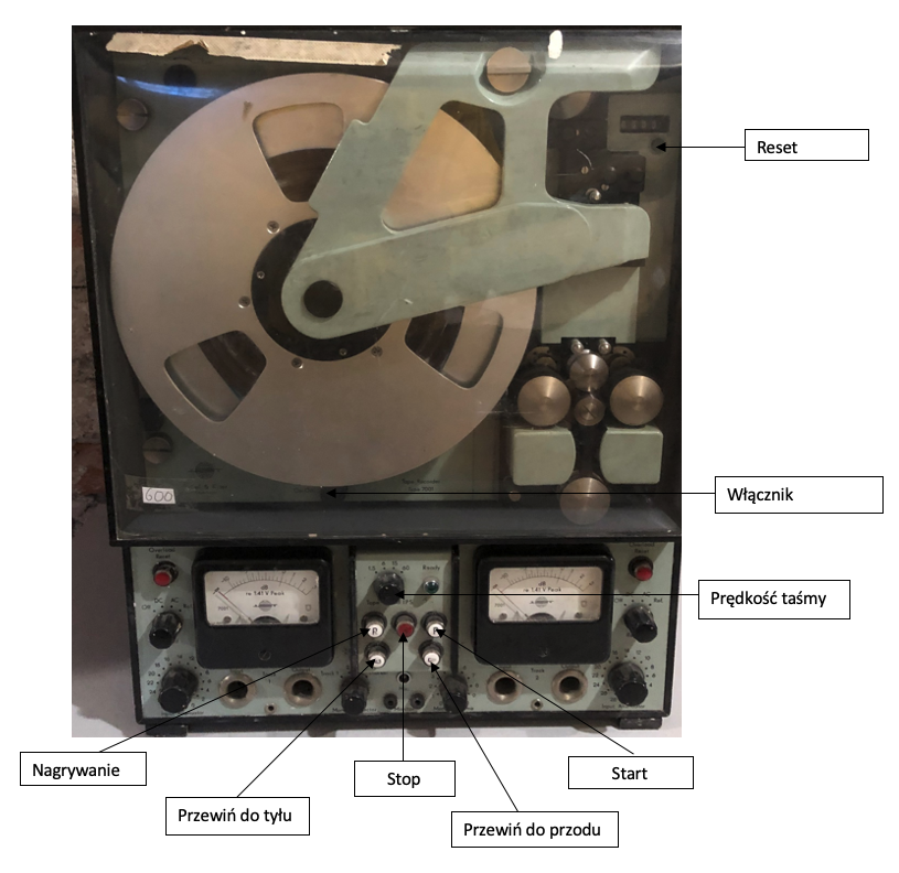

  • Three-motor design simplifies reel-to-reel mechanics
    #36 21924079
    Krzysztof Kamienski
    Posts: 21893
    Help: 2032
    Rate: 5157
    @andreyatakum As I’ve had quite a few tape recorders pass through my hands – starting with the East German Tonko – a rather nifty ‘tape deck attachment’ – as the name suggests – which was essentially a fully-fledged tape deck, albeit without a power amplifier or speaker, through a Soviet-era device similar to a Bruel & Kjaer measurement (reel-to-reel), a couple of Ampex units and ending with a Technics 1500 – and if I may suggest something to you, when you’re planning to build a reel-to-reel from scratch, stick to just three motors, as this will simplify the mechanics to a minimum. ,
    Reel-to-reel tape recorder with a large reel and labeled arrows pointing to control buttons
  • #37 21924082
    andreyatakum
    Posts: 804
    Rate: 1132
    Krzysztof Kamienski wrote:
    Just three engines, as that will keep the mechanics to a minimum. ,
    Exactly! That’s the route I chose a while back. Unfortunately, I didn’t finish the project – moving house, university, family.

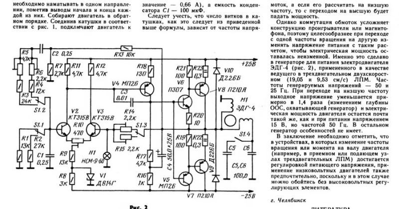

  • Stepper motors from printers for tape transport?
    #56 21928870
    CHOPIN66
    Posts: 650
    Rate: 245
    This is how I’d see it –
    I’d copy the separate write and read circuits, as well as the bias current generator, from the ZRK M7020, for example, I’d copy the BIAS control from the Koncert – initially using switchable BIAS, as in cassette recorders, via isostats or relays, and eventually introducing automatic correction
    He didn’t go for classic mechanics as in the heyday of reel-to-reel tape recorders, but did it this way – the drives for the reels and pressure rollers were implemented directly using stepper motors / BLDC motors controlled by an ATmega. Here’s an interesting concept for stabilising the tape speed: we have a disc with a circumference of 4.75 cm fitted with a small permanent magnet. When the magnet passes through the Hall effect sensor, it generates a pulse.
    And so: 1 pulse = 4.75 cm/s
    A pulse half as long = 9.5 cm/s
    A pulse a quarter as long = 19 cm/s
    A pulse an eighth as long = 38 cm/s
    The figure 4.75 cm/s is not chosen at random – using simple maths – by multiplying by 2, 4, 8 and 16, we can obtain 9.5, 19.5 and 38 cm/s (small studio version) and 76 cm/s (studio version)
    The microcontroller reads the pulses from the Hall sensor and compares their durations – and controls the motors via the drivers accordingly so that the specified speed is achieved. This greatly simplifies the mechanics, as braking can also be implemented using an ATmega. In that case, we are limited to three motors, two solenoids for lifting the bridge, and a few integrated circuits
    I wonder whether stepper motors from printers would be suitable?

  • Sinusoidal stepper drive for smooth tape feed
    #60 21928967
    andreyatakum
    Posts: 804
    Rate: 1132
    398216 Usunięty wrote:
    The tape feed MUST be smooth, without any ‘jerks’ or jolts.
    Yes. You’re absolutely right, and that’s exactly what I was going to write in my reply to my colleague. But powering the stepper motor from a sinusoidal oscillator will solve this problem. It could be the same oscillator I used to drive the turntable platters.
    Screenshot of Russian text and an electronic circuit diagram with transistors and a motor coil
    Not exactly the same one, but one operating on the same principles – using a Wien bridge amplifier. For example, high-power integrated circuits. You just need to recalculate the frequency depending on the characteristics of the stepper motor being used.
    An Arduino controlling the power amplifier via PWM (pulse width modulation) could also work, but I’d avoid that. I like to build analogue receivers with digital interfaces (synthesisers, F and S-modulation meters), including on Arduino, and I’ve had to struggle with interference from these interfaces. So I wouldn’t recommend using digitally controlled tape-winding motors.
    However, when it comes to the flywheel drive (especially with quartz stabilisation) and controlling the entire system, there’s no other option here. You just need to use shielding and ferrite cores.
