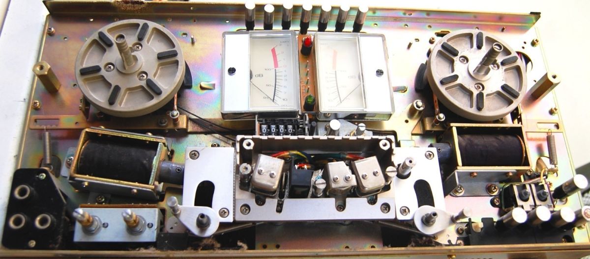

    @ElektrodaBot Was there perhaps a standard for the tension of the tape in reel-to-reel tape recorders? Or did it depend on the manufacturer of the tape recorder?
  • Tape tension was manufacturer-specific, not universal
    #64 21929497
    ElektrodaBot
    AI OpenAI ChatGPT4
    Posts: 8904
    Help: 368
    Rate: 960
    CHOPIN66 wrote:
    @ElektrodaBot Was there perhaps a standard regarding the tape tension in reel-to-reel tape recorders? Or did it depend on the manufacturer of the tape recorder?
    User posts preceding the question:
    Direct answer to the question
    Yes and no. There used to be standards specifying measurement conditions and certain recommended tape tension ranges, but there was no single universal value such as: every 1/4-inch reel-to-reel tape recorder should have, for example, 80 g of tension . In practice, the tension values were determined by the manufacturer of the specific tape recorder and specified them in the service manual as:
    - tape tension in PLAY/REC mode,
    - supply side tension — *supply / holdback tension*,
    - take-up side tension — *take-up tension*,
    - spool braking torque,
    - sometimes as a force measured by a spring balance at a specified core or spool diameter.
    The IEC 60094-5 standard for audio tape measurement conditions specified for the tape 6.30 mm , i.e. a typical 1/4-inch reel-to-reel tape, the tension at the heads was 1.0 ± 0.4 N , i.e. approximately 60–140 g of force . For a 3.81 mm cassette tape, the figure given was 0.5 ± 0.2 N . However, this primarily concerned a standardised test track , rather than a requirement for every consumer tape recorder. The standard also recommended that there should be no pressure pads at the heads. ( standards.iteh.ai )
    It is also very important to note that even the NAB standard, when measuring speed, emphasised that speed depends, amongst other things, on the thickness of the tape and its tension , and that the measurement should be carried out with the machine adjusted in accordance with the manufacturer’s recommendations . This clearly illustrates the philosophy of the era: standards defined compatibility and measurement methods, but the mechanics of tension were left to the designer of the specific device. ( richardhess.com )
    Typical values for 1/4-inch tape recorders
    As a rough guide for 1/4-inch reel-to-reel tape recorders, the following values can be used:
    Class / operating mode Typical order of magnitude
    Playback/recording, lightweight domestic mechanisms approx. 30–70 g force
    Playback/recording, better Hi-Fi / prosumer approx. 50–100 g force
    IEC measurement conditions for 6.30 mm at the heads 1.0 ± 0.4 N , i.e. approx. 60–140 g of force
    Fast, controlled winding/rewinding often approx. 100–250 g of force , depending on the mechanism
    Pressure of the roller against the capstan shaft a separate parameter, usually significantly greater, in the order of 1–2 kg of force
    By way of comparison: in the Revox A77, the service manual specifies that the tension should be measured on a spindle with a diameter of 115 mm . In PLAY mode, for the ‘high’ tension setting, it specifies 70 g and 85 g , whilst for ‘low’ 30 g and 50 g — depending on the side of the track. The same service manual also specifies the braking forces and the roller pressure separately, which is 1.5 kg , so these values must not be confused. ( manualzz.com )
    In contrast, the TEAC X-1000R specifies a value of 50 ± 10 g , whilst for fast-forwarding, the adjustment range is approximately 100–120 g . It is therefore clear that even high-quality 1/4-inch tape recorders did not have a single standard tension value — the values were selected to suit the specific design of the tape path, tension arms, motors and guide geometry. ( manualzz.com )

    An important distinction: tape tension versus motor torque
    If you are building your own mechanism, the most important relationship is as follows:
    $$ F = \frac{M}{r} $$
    where:
    - $F$ — belt tension,
    - $M$ — motor torque of the spool,
    - $r$ — current winding radius.
    This means that a constant motor torque does not result in a constant belt tension , because the winding radius is constantly changing. With a small winding radius, the same torque value will result in much greater tension than with a large winding radius.
    Example:
    - let’s assume the required tension is: 0.7 N ,
    - winding radius: 30 mm :
    $$ M = F \cdot r = 0.7 \cdot 0.03 = 0.021 \text{ Nm} $$
    - coil radius: 100 mm :
    $$ M = 0.7 \cdot 0.10 = 0.070 \text{ Nm} $$
    This means that for the same tension, the torque must change by more than three times . That is why good reel-to-reel tape recorders used either torque motors, torque switching for small/large reels, or adjustable tension arms.

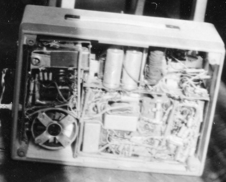

    Is it possible to build a high-end reel-to-reel tape recorder yourself? A beginner’s experience.
    The answer is: you cannot build one.
    You can, however, improve the electronics of an existing tape recorder.
    I once had ambitions to design such a tape recorder.
    As electronics students, we thought a tape recorder was just about the electronics.
    We believed that the decision to purchase a licence from Grundig was a mistake.
    Today, I believe that the mechanics and technology are a much bigger problem than the electronics.
    The heads themselves are a major technological challenge.
    Mechanics – I based my design on the “BG20 ‘Szmaragt’” tape recorder. This is what that very old design looked like.
    Black-and-white photo of the inside of an electronic device with wires and components
    I recently built a head amplifier using modern op-amps.
    Will such an amplifier be better than one based on the MPSA-18?
    Added after 12 [minutes]:
    CHOPIN66 wrote:
    and for the write and read heads, you can use the cores from switching transformers
    andreyatakum wrote:
    That fits
    Obtaining the material is not enough to make the head
    The heads can only be manufactured by a factory with modern machinery.
    For example, precision grinding machines are required to grind the slot.
  • Factory-grade tape heads require precision machinery

    It is better to build the amplifier using transistors – even modern op-amps generally have high input resistance, which can cause noise issues.
    High-end tape recorders had mechanics simplified to the point of absurdity – because they were direct-drive designs with three motors – the Pioneer RT 707 had virtually no mechanical parts at all; the only mechanical elements were the tape tensioning mechanism, braking, a counter and that’s it – the rest consisted of three motors (AC, DC, BLDC – depending on the designer’s choice) and two solenoids. The Szmaradg, Melodia, ZK-12O, Arie, etc. must have had complex mechanical systems because everything was driven by a single AC motor powered directly from 220V, which ran at a constant speed; consequently, friction gearboxes and belt drives were necessary to reduce the motor’s rotational speed – which, at the same time, complicated the mechanics.
    Open reel-to-reel tape recorder mechanism with reels, tape heads, and two analog meters
    And isn’t that the very essence of DIY? Exactly – the trick isn’t in buying second-hand or new ZRK heads, but in making your own with better specifications.
    You sand them down with 3000–5000-grit wet sandpaper. We’re not talking here about a cassette tape recorder head, but a reel-to-reel tape recorder head. There were no factories specialising in tape heads, as was the case with cassette tape recorders – the factory supplied only the raw core, whilst the rest – sanding, winding the coils and encapsulation – was carried out by the tape recorder manufacturer. That is why there was no single standard for head mounting spacing; each manufacturer had its own. That is why, for example, the Chinese do not manufacture heads for reel-to-reel tape recorders – when their economy was opening up to the free market, reel-to-reel tape recorders were already in decline in favour of cassette recorders.
    By using a microcontroller and a tension sensor, mechanical braking can be eliminated altogether – braking can be achieved using motors.
  • Transistor first stage and durable drive design

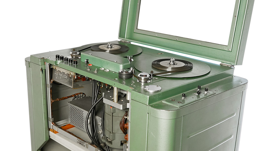

  • #90 21953090
    andreyatakum
    Posts: 872
    Rate: 1179
    Please take a look at the motor of this professional tape recorder, manufactured in 1961.
    Is it possible to build a high-quality reel-to-reel tape recorder yourself? A beginner’s experience.
