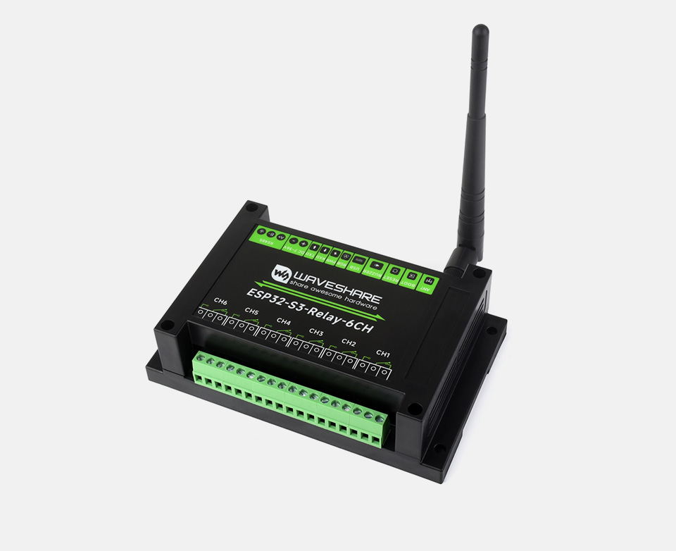

    Waveshare ESP32-S3-Relay-6CH board
    Hello I got Waveshare ESP32-S3-Relay-6CH board which is officially not supported by Tasmota. It is based ESP32-S3 chip, has 6 relays, RS485, buzzer and RGB led.
    The device has full PICO HAT support with GPIOs working and I tried SPI boards connect without problem.
    I flashed Tasmota to the chip and assigned GPIOs from WS website and device is fully supported by Tasmota.

    Here is template for this device:

    Thanks for sharing. Did you also manage to get RGB LED running on Tasmota? WS2812 controllable via GPIO38
  • #3 21927562
    cijoml
    Posts: 81
    Hello, yes RGB led also work and is already mentioned within tasmota template. However RED and GREEN channels are swapped so you must recompile tasmota to swap buffers.
  • #4 21937931
    cijoml
    Posts: 81
    Update to narrow down RGB channels you can use SetOption37 24 to rearrange WS2812 color mapping.
