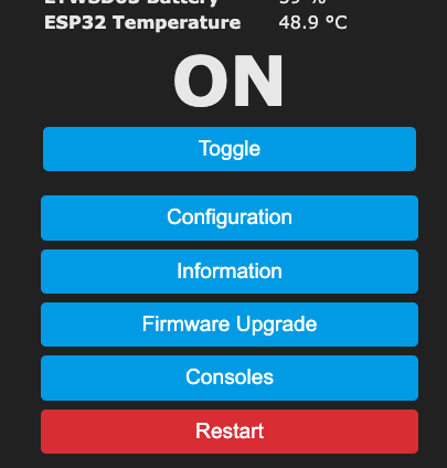

    As per topic. I'm trying to make a relay module on an ESP32 with TASMOTA software uploaded.
    I've tried various configurations but the relay doesn't respond to the state change signal. I hear a click when I connect the signal pin (brown cable), but when I click the switch from the web interface nothing happens.
    I have the signal pin connected to GPIO 26
    In the module connected to In1
    Red Vcc -> VIN
    Black Gnd -> Gnd
    In the Template tab in the TASMOTA settings GPIO26 is set to Relay. I also tried the settings Relay_and Relay_b as well as Relay_bi but it doesn't change anything.
    Anybody knows how to make this work and what the number means with the GPIO setting?

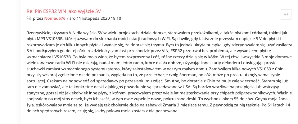

    According to what is written on the ESP32 forum, if the board is supplied with 5V then that voltage should also be present on the VIN pin, which is the one I have connected the relay to. The status change signal reaches the board because the blue LED flashes when the MQTT transmission is active, but the relay does not respond - I do not hear a click. It only clicks when I connect the pin.
    https://esp32.com/viewtopic.php?t=11904

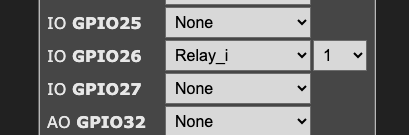

    Okay if I set the used pin 26 (D26) to Relay_i then on VIN and IN1 I have the following voltages:
    1.6V - if the virtual switch in the interface is in OFF state
    4.9V - if the virtual switch in the interface is in ON state
    The relay when the IN1 pin is connected clicks (closes) but there is no response when I try to turn it off.
