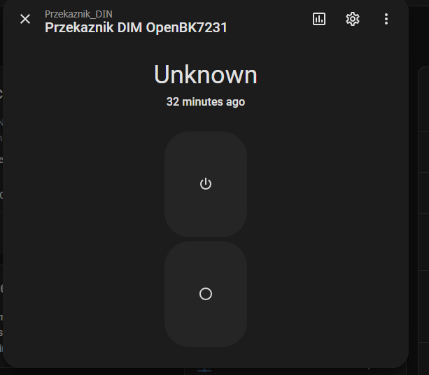

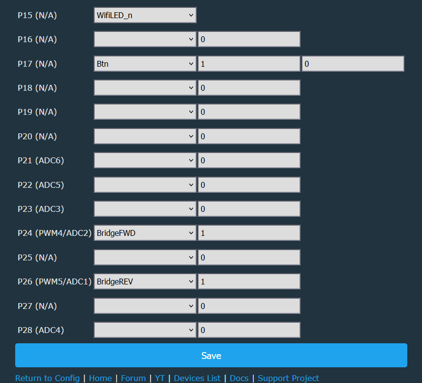

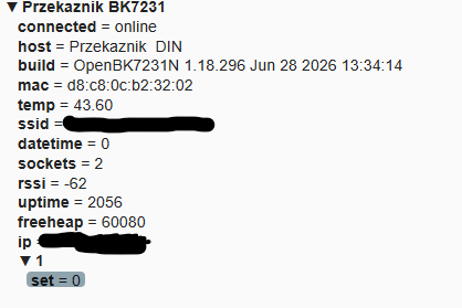

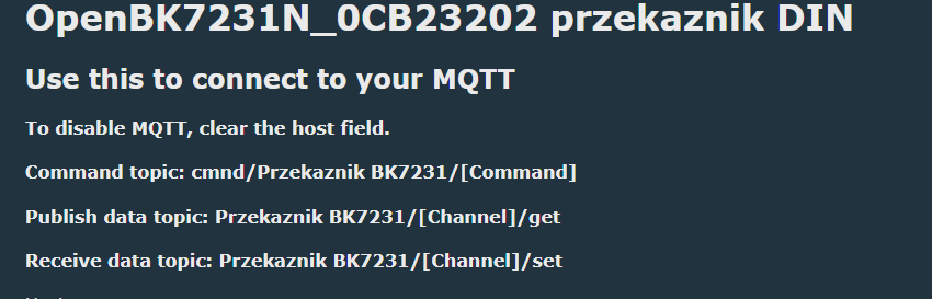

  • Bridge mode lacks MQTT status and creates two buttons
    #1 21931845
    kostrzew12
    On the BK7231N Wi-Fi relay, I’ve configured pins 24 and 26 to switch the coil on and off. They’re set to Bridge mode, as the Rel mode causes the circuit behind these pins to overheat. Unfortunately, there is no /get endpoint published in MQTT for this configuration, so I cannot read the status in Home Assistant. The Bridge function also generates two buttons, but I would prefer to have just one. I am using the latest firmware.
