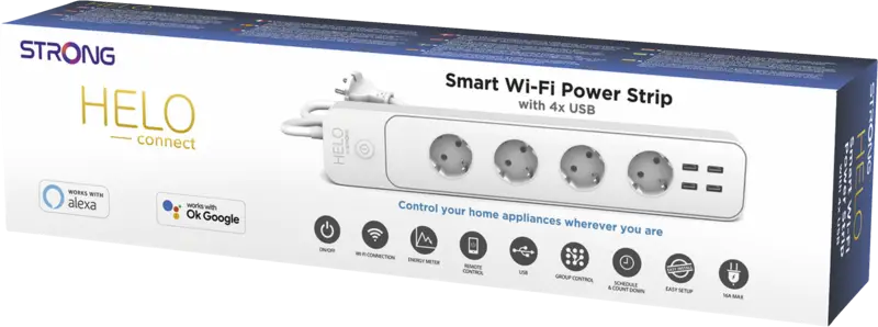

    Strong HELO Connect smart power strip with 4 sockets and 4 USB ports
  • #5 21784788
    bumperboy
    Thank you again for your help and for creating the template.
