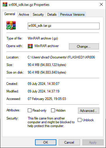

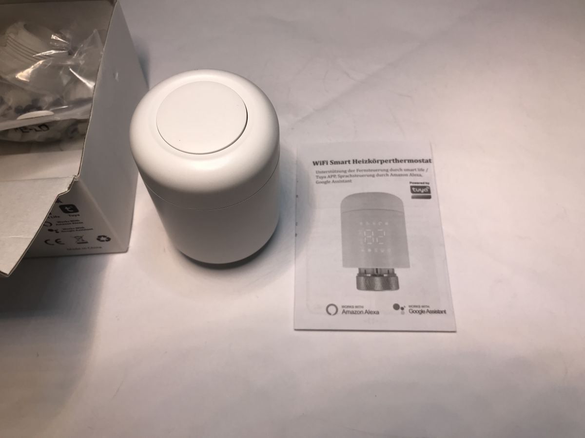

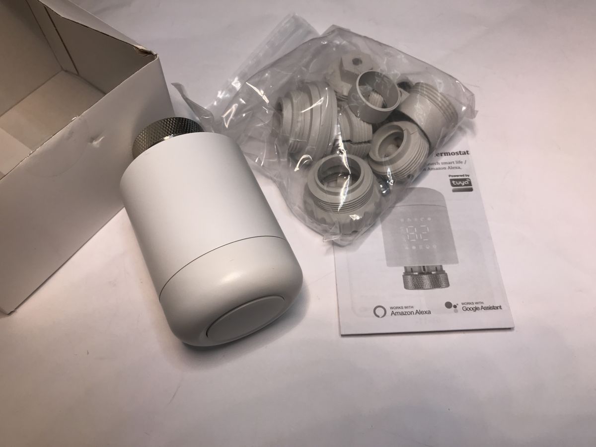

    Anybody was able to make it work with the XR806?
    Just came across a TRV heater device, which is using the Tuya WXU chip. My research is pointing to XR806.

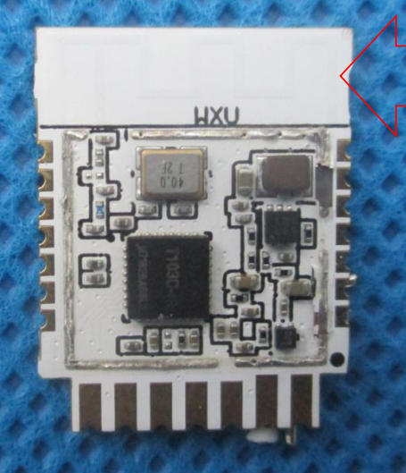

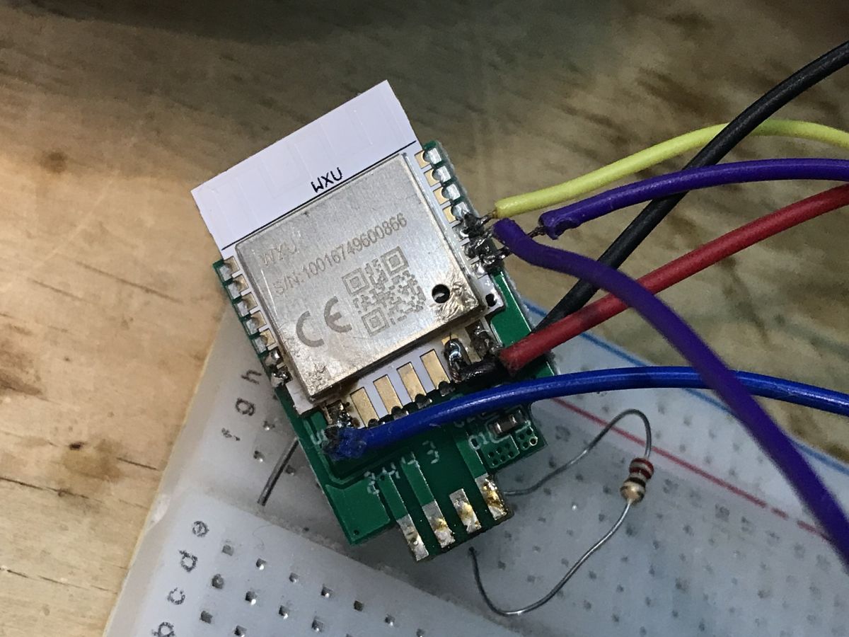

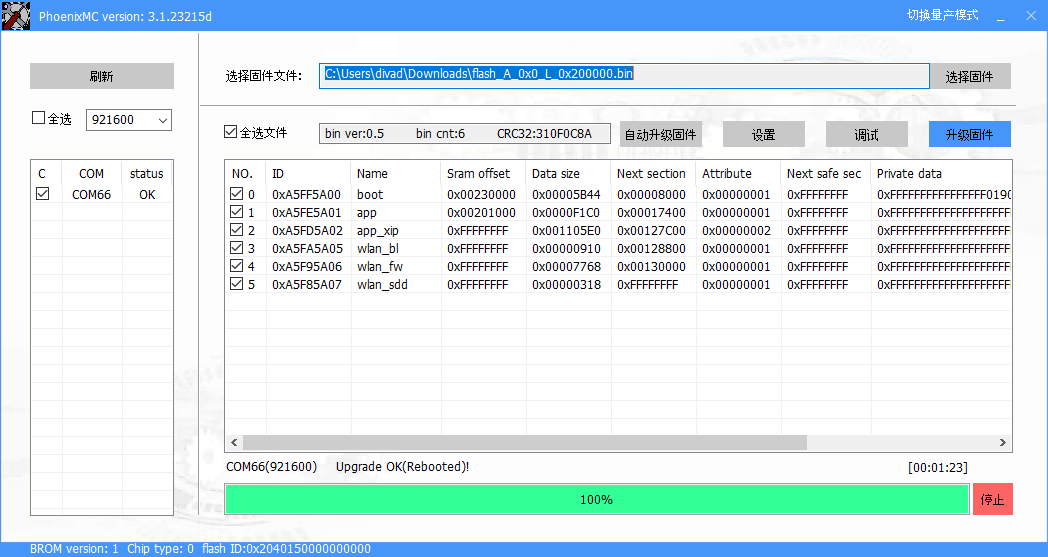

    The normal XR806 definitely doesn't have wifi, but this T103C-HL on the WXU module clearly states it does. Maybe some Tuya-specific variation. It already has different SRAM to normal XR806
    Tuya WXU XR806 from TRV Heater Device flashing, SDK, firmware change research
    Here's the boot log from a WXU from a posting on Discord:
    You could always try dumping existing firmware and trying OpenXR809 I guess

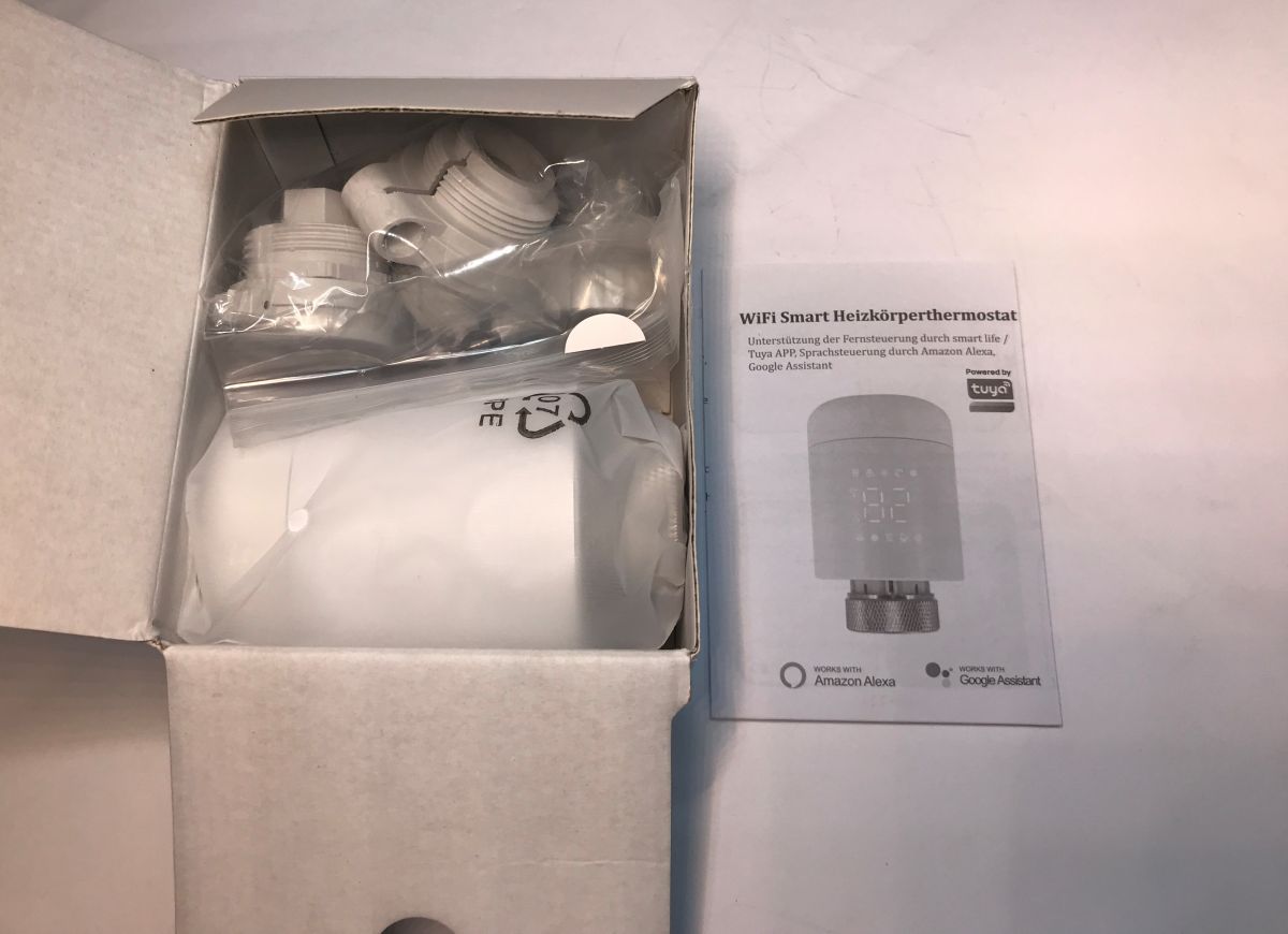

    I may have such device from @MrGenius , but I didn't do teardown yet.

    I found some hits when searching for the XR806, mentioning this: Allwinnertech XR806 Wi-Fi+BLE5.0
    The documentation i found for that, is listing the same amount of SRAM, Flash and existing Wifi + BLE!? At least on the paper, the same specs as WXU.

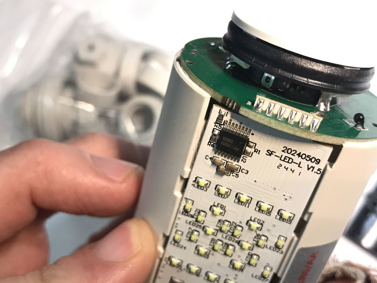

    @MrGenius I remember you saying that you know how to open this device, can you share info?

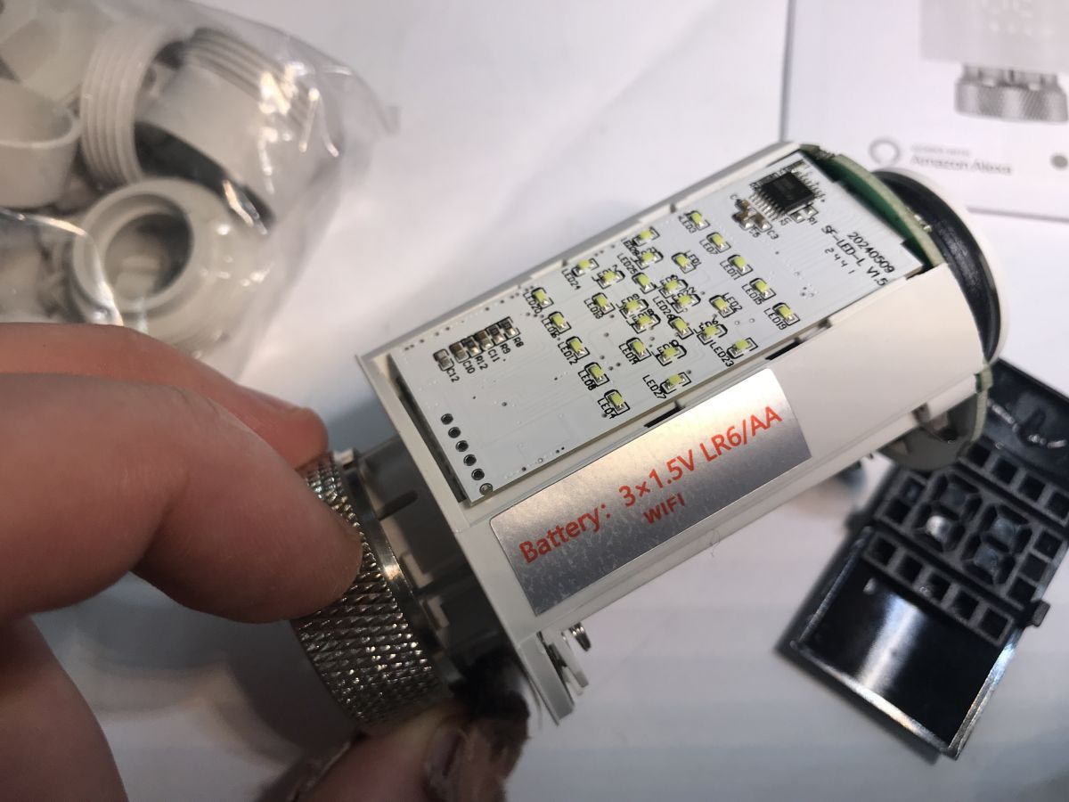

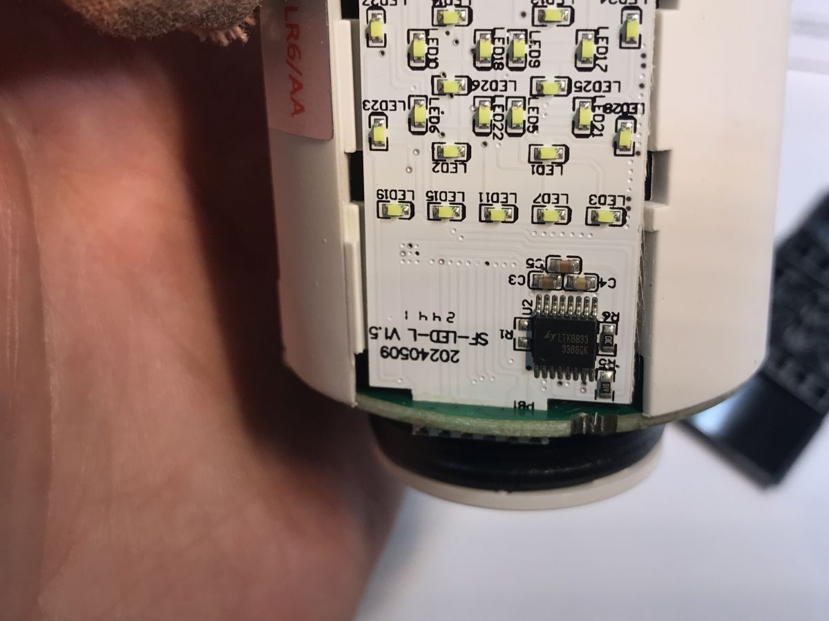

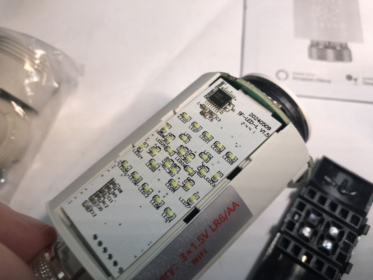

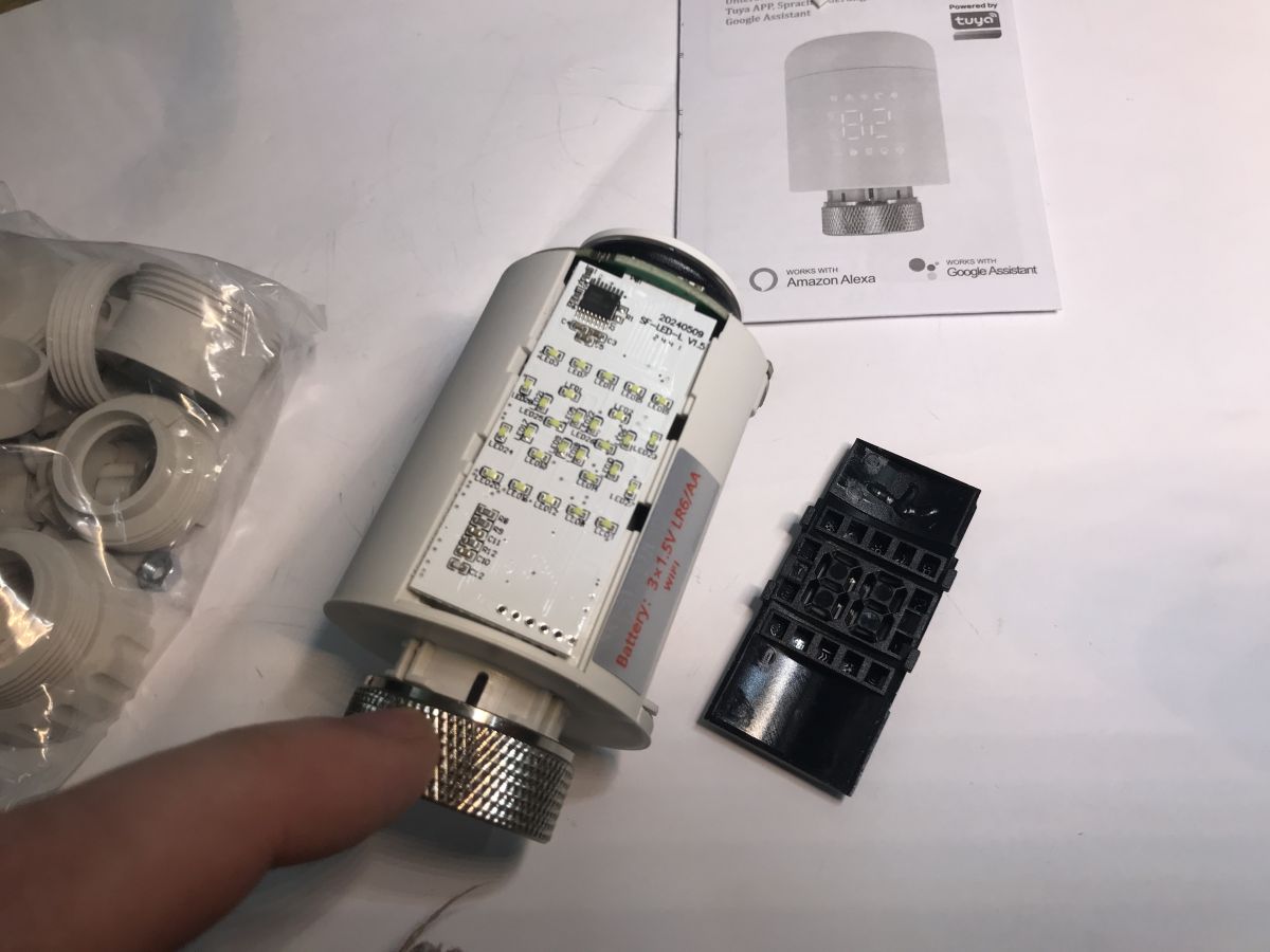

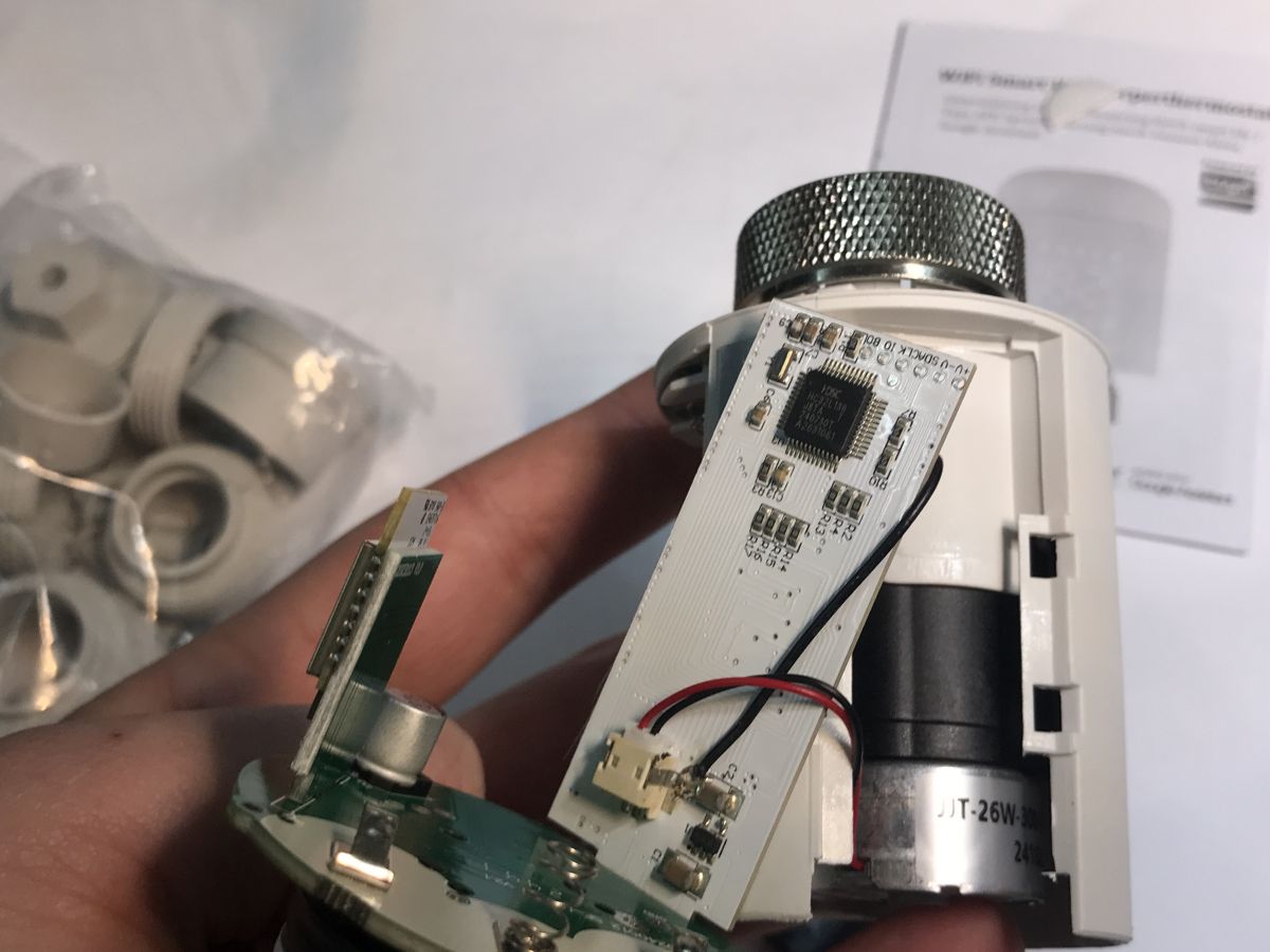

  • #6 21429214
    MrGenius
    Posts: 9
    It was actually very easy to open:
    - You pull off the plastic turning wheel with some careful force. Just pull it off.
    - then you can pull off the whole round cover, which is covering the batteries.
    - Next, you clip out with a small a screwdriver the display
    - then you can open the 3 small screws on top to pull out the board.
    If i get home, i might be able to get you more pictures. But I am sure you will manage that ;)

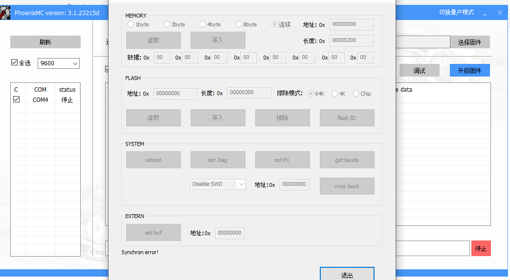

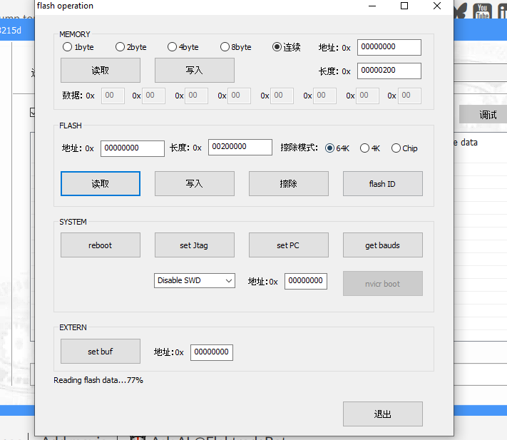

  • #7 21429243
    Posts: 14580
    Help: 654
    Rate: 12604
    Bootlog:
    main_task_start : 62

    I've desoldered module, but I am getting synchron error so far.

  • #10 21429276
    Posts: 5026
    Help: 438
    Rate: 891
    went crazy once with sync error on XR3 until I realised I should have been using RX0/TX0 not TX1/RX1
  • #11 21429278
    Posts: 14580
    Help: 654
    Rate: 12604
    I think I am using TX0/RX0, but maybe you can spot the error?
  • #12 21429281
    Posts: 5026
    Help: 438
    Rate: 891
    seems OK I think
    PB02/PB03 grounded✅✅
    UART0-RX/TX ✅✅
    hang on. Maybe on XR3 it was RX->RX and TX->TX
    Added after 3 [minutes]:
    My first port of call, however, was to capture the UART boot log output. This was achieved by attaching USB-TTL RX to the RXD0 (not TXD0, as expected) of the module. This is the black dupont soldered in this pic. It joins the white where it's connected to USB-TTL RX pin.
    was for log anyway https://www.elektroda.com/rtvforum/topic4063735.html

    wait a sec, one has to reset while doing "synchron waiting"?
  • #14 21429306
    Posts: 5026
    Help: 438
    Rate: 891
    I've not had to do that on XR3. just power up with all connected
  • #15 21429307
    Posts: 14580
    Help: 654
    Rate: 12604
    Anything more I need to read?
    • wxu20250207-1911.zip (3.15 MB) You must be logged in to download this attachment.
  • #16 21429312
    Posts: 5026
    Help: 438
    Rate: 891
    not that I am aware of...
  • #17 21429323
    Posts: 14580
    Help: 654
    Rate: 12604
    So now, if you flash this binary to your XR809, will you get it to boot?
  • #18 21429324
    Posts: 5026
    Help: 438
    Rate: 891
    already on it :)
    TuyaMCU at 115200 too.

    flashed OK but no signs of life. PSU not showing any draw and nothing out on RX0 or RX1 :(
    will do again to be sure
  • #21 21429361
    Posts: 14580
    Help: 654
    Rate: 12604
    and if you flash OBK, then it boots and outputs debug log?
  • #22 21429369
    Posts: 5026
    Help: 438
    Rate: 891
    humble apologies. I'm getting mixed up with the Winner Micro W806 - ignore.
    indeed it does. normal boot log on RXD0
    Added after 5 [minutes]:

    https://github.com/divadiow/xr806_sdk
    Added after 42 [seconds]:
    though I think I'm in the process of getting the latest, if it's even different
    Added after 15 [minutes]:
    are you considering another port? :D
