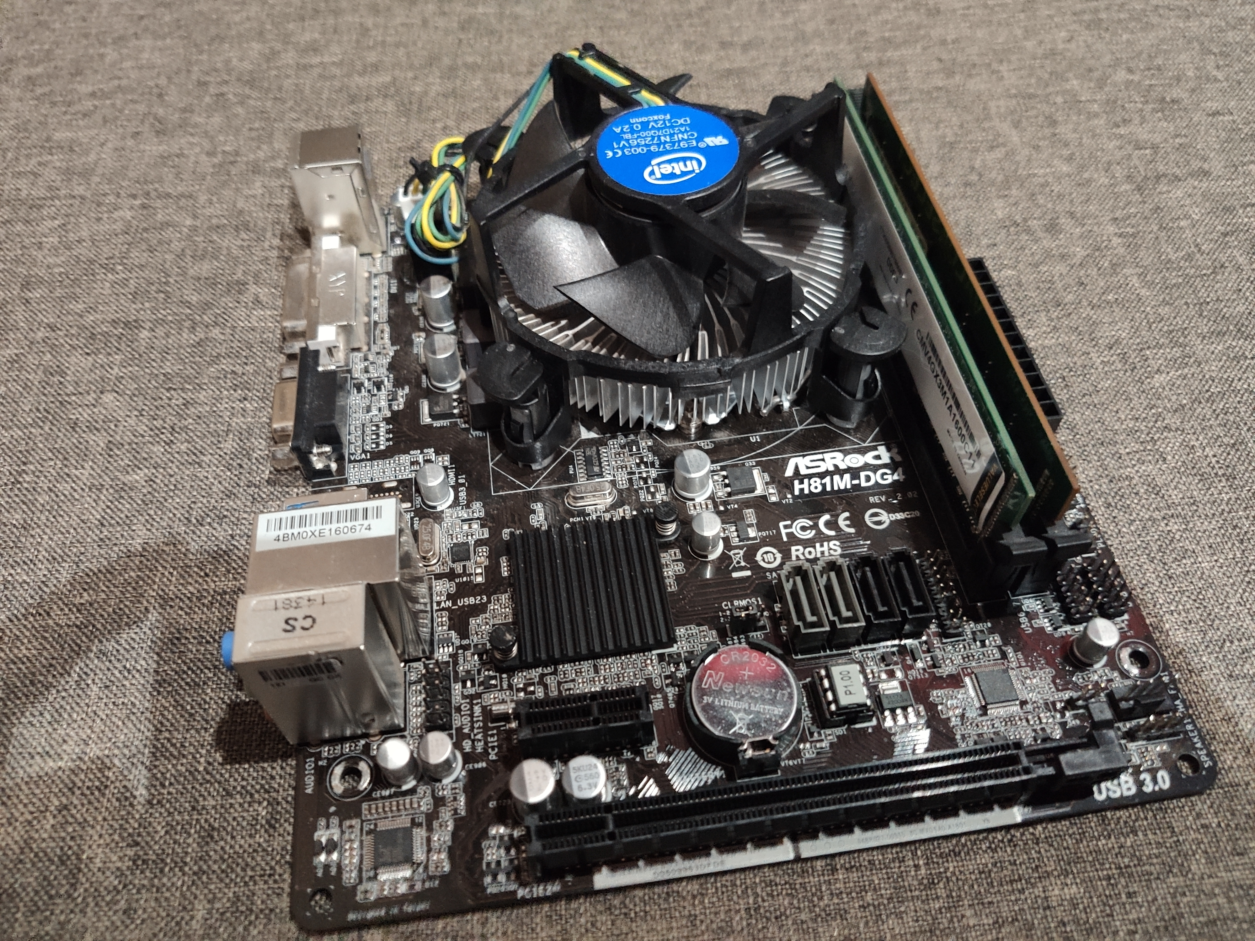

One day I was faced with the fact that I had to change my desktop computer to a laptop. The laptop is chosen, but the dilemma of what to do with the data that is on the HDD drives and there is over 4TB of them.
The idea of a fast NAS server, but their price knocked me off my feet.
I started searching the internet and found two interesting ready-made x86-based NAS systems - Bingo!
These systems were FreeNas and Xigmanas (formerly nass4free).
However, xigmanas won by default in that you can connect NTFS drives and use them over the network. Unfortunately, FreeNas does not allow this, it is a system designed rather for much more powerful machines.
The system is there, I have disks, I had to find a processor and a motherboard would fall out.
After browsing through the OLX, I found the AsRock H81M-DG4 motherboard + 8gb RAM + Intel Celeron G1840 processor for PLN 120.
It looked like this:
Okay, but this cooling is going to be a bit loud so after browsing Facebook I found a SilentiumPC cooling for half the market price. I didn't think twice and my motherboard looked like this:
From there, only the disc is heard! :D
The power supply for me is just anything, because it is only IBOX 400W, but for now it has to be enough, I will probably replace it with SilentiumPC.
The whole thing looked like this:

Łukasz_W 20 Feb 2020 22:11
Then replace this Seagate / these Seagates (?) With something else, because all this fun may end in the imminent loss of those four terabytes. [Read more]
dvo 20 Feb 2020 22:22
I wonder what power consumption your set has. I would be more inclined to buy a second-hand nas or build something for thinclient. If the budget limits. [Read more]
krzbor 20 Feb 2020 22:56
I approached the problem of my own NAS differently - it is supposed to be a good, reliable computer, of course, with 2 disks in mirroring, with a passively cooled processor (I chose the ATOM motherboard)... [Read more]
noyo 20 Feb 2020 23:12
I went in Intel Atom DN2800MT + 2x WD red 1TB, I installed debian on it, everything is after sftp, I don't need any more. Works for 4-5 years. No errors on the disks. I also added an emergency power... [Read more]
snake3d 20 Feb 2020 23:22
The disk is not equal to the disk, the batch is not identical, the materials of manufacture may be with a defect, anyone can fall. It's worth having a replication / backup. I've had mostly Seagate... [Read more]
Bojleros 20 Feb 2020 23:29
I have Asrock on J2900 with 16GB of RAM and I'm pissed off because sftp doesn't reach 33MB / s ... sshd is choking on cpu. Equipment sufficient, but sometimes annoying. [Read more]
