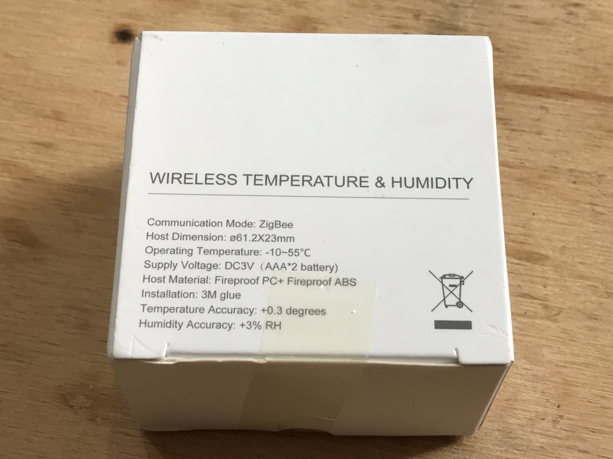

Package contents

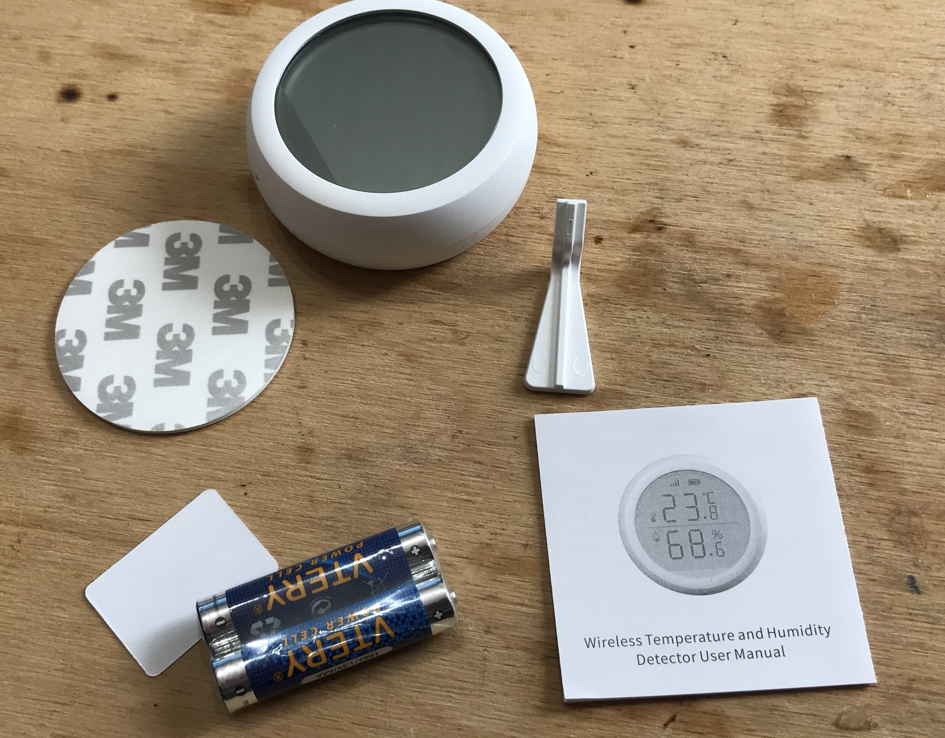

Let's check what we have received.
Surprisingly, the batteries are included - this is a very big positive, especially for those less technical users who are not prepared and do not have a spare.
We also have a stand, a tape to stick on the wall and instructions.
