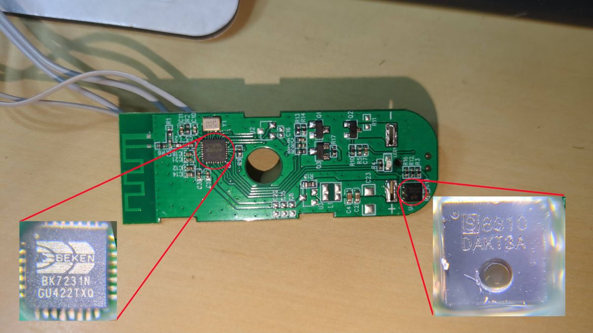

    Chips
    Image of a PCB with highlighted BK7231N and SHT30 chips.

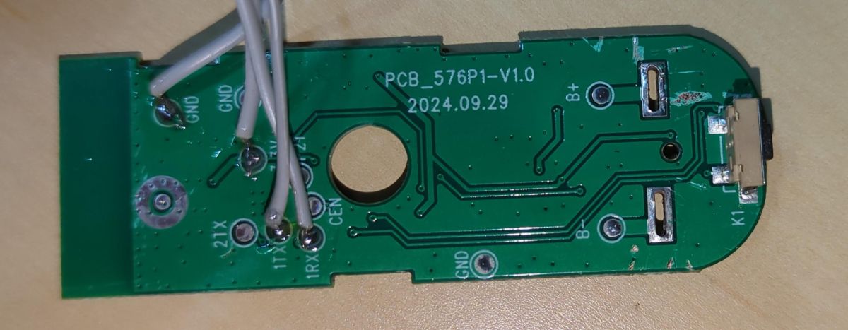

    PCB side A
    View of the backside of PCB 576P1-V1.0 with wires attached.
    PCB Side B
    PCB with electronic components and circuitry.

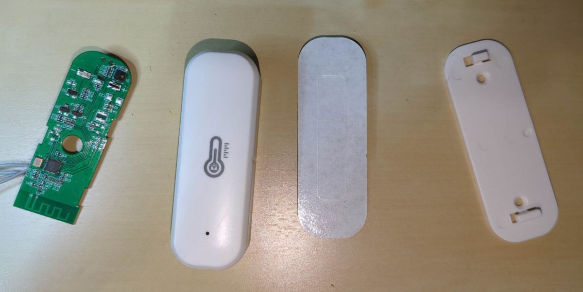

    Case
    Temperature and humidity sensor disassembled into parts.

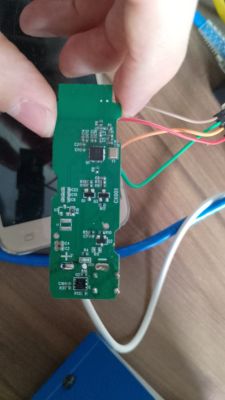

    #11 21806631
    isbrun
    Hi!
    I follow this steps to update the firmware(Link) and follow your instructions here.
    But I get some points:
    - The button seems not to work
    - The device send data each 10 seconds
    - And the temperature and humidity is fixed on 124°C and 100%
    - I only get voltage and battery information
    How can I fixed that, specially temp/hum, transmission time and the button?
    Here is the device's photo
    Green PCB with electronic components held by a hand
