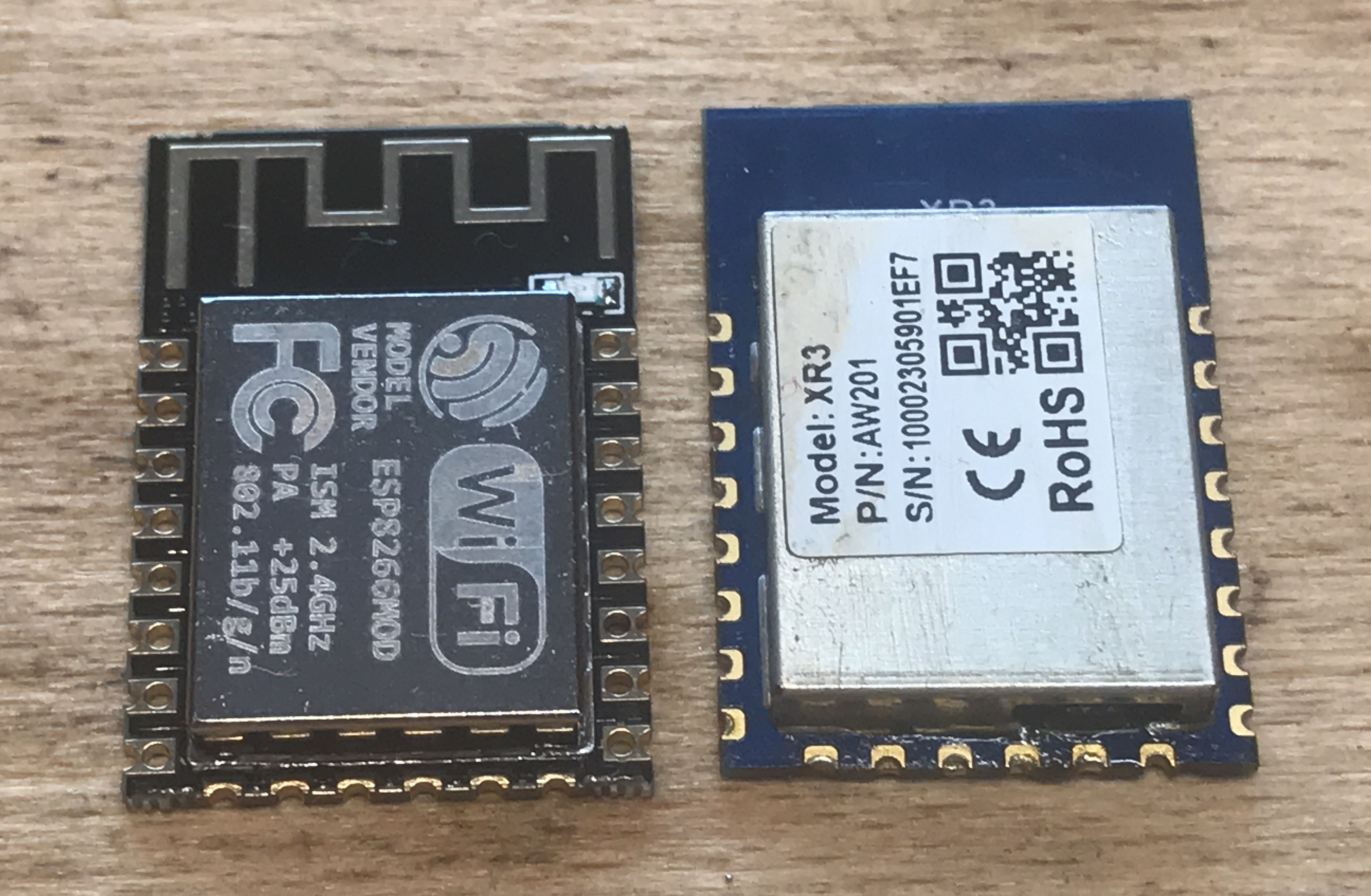

Comparison of both modules
We will take this opportunity and compare both modules visually. Haven't seen the XR3 from below yet. Both have signed pads. At first glance, the conclusions are compatible.
