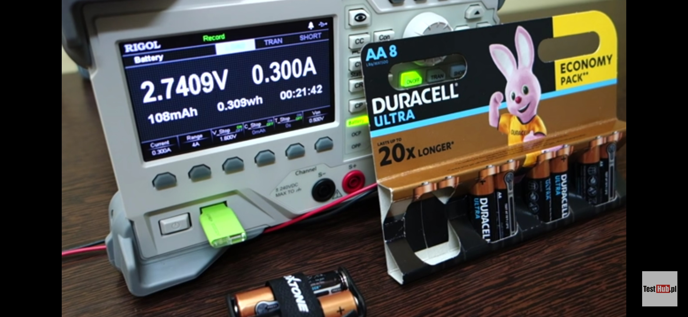

One of the most interesting technical bloggers undertook to examine over 50 models of various AA batteries, i.e. the most popular "finger". Mostly popular batteries, available both in media stores, but also in stores such as Biedronka or Lidl. Alkaline batteries, but there is also a reference in the film to tantalizingly cheap zinc batteries and much more expensive lithium batteries. The discharge test was performed on an advanced device, the discharge parameters were supposed to be identical for each set. The test results are at least interesting...

Do you know any better test? In my opinion, this test is absolutely ok - it is the basis for determining the parameters you are interested in, such as self-discharge time or capacitance measurement at... [Read more]
TechEkspert 29 Nov 2021 19:55
Interesting test, the results will be good for flashlight/toy applications etc. the conclusion is that typical alkaline AA is ~2Ah, while the lithium is ~3Ah and the starting voltage is 1.6V. [Read more]

Maybe so as not to mislead the customer that he is dealing with a rechargeable battery and so that he does not accidentally try to charge such a cell. This test is, in my opinion, too much current. However,... [Read more]

Depends on what's prime. They are nice and available. But as someone already mentioned, try to change the load and the result will be different. Even change the voltage at the end of the test and the... [Read more]
