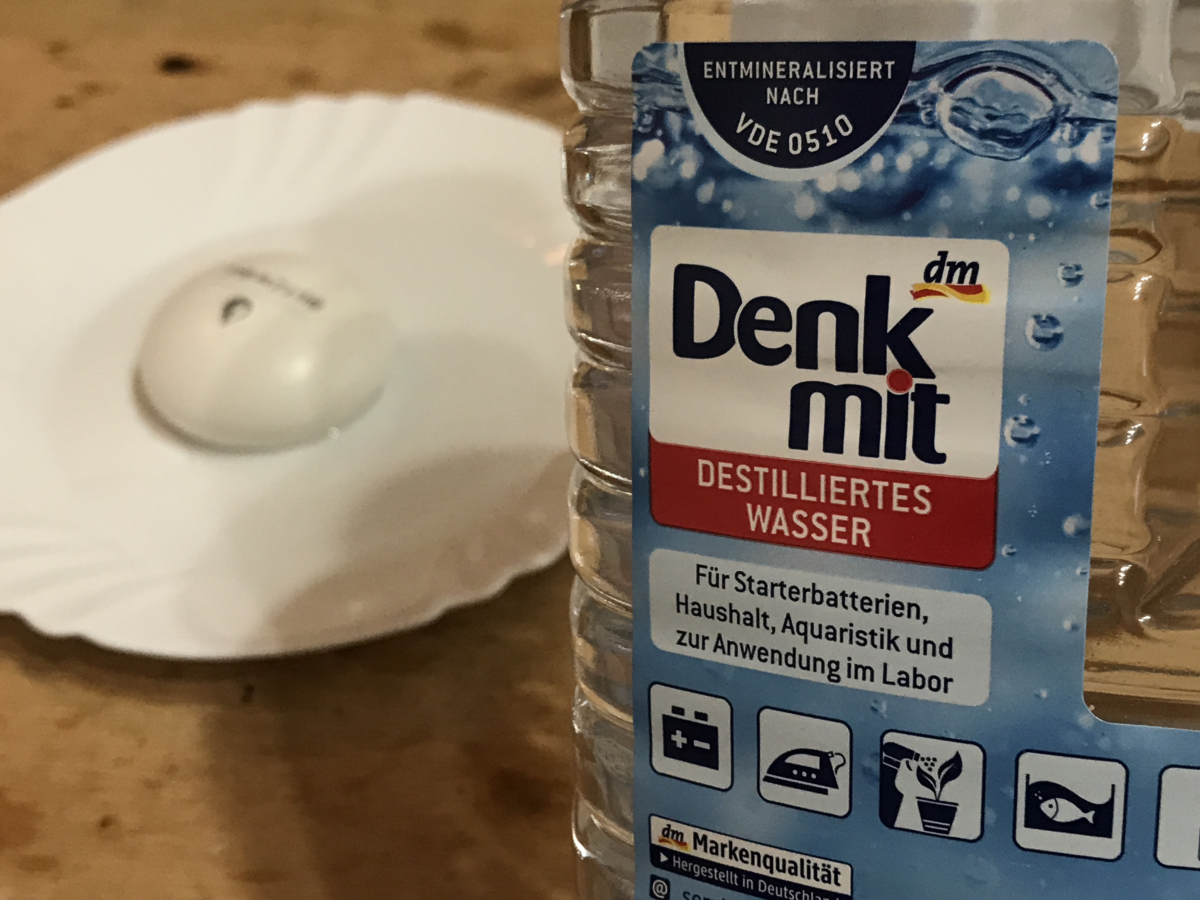

Check if sensor detects water Tap water:
Distilled water:
In both cases it detects moisture, although there must be enough water to touch at least two sensors. As for the quality of this distilled water what I have I am not sure, but the ground is that the sensor works.
