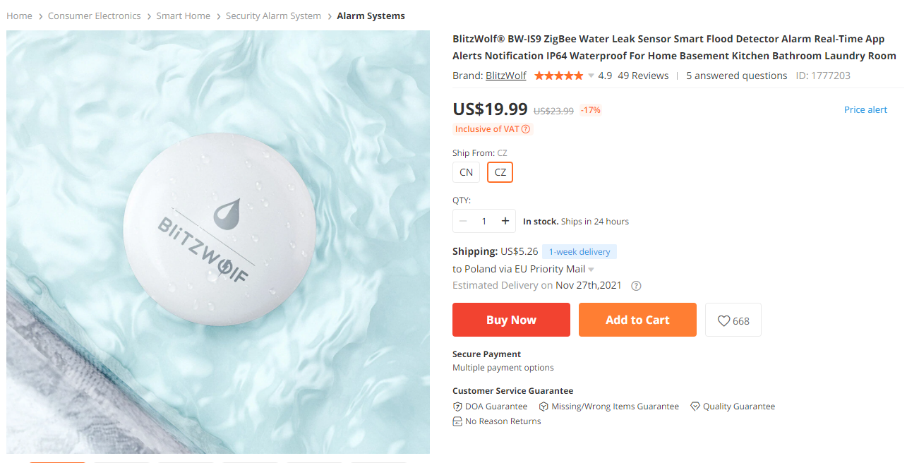

    I found the product online under "BlitzWolf® BW-IS9 ZigBee Water Leak Sensor Smart Flood Detector Alarm Real-Time App Alerts Notification IP64 Waterproof For Home Basement Kitchen Bathroom Laundry Room". I paid about $25 for it, which is about $100. This is quite a lot, but products on ZigBee as a rule are more expensive than those on WiFi.
    BlitzWolf BW-IS9 flood, water leak sensor on Zigbee
    I specially chose a store where shipping is from the Czech Republic. Then the package reaches me in a few days.
    The seller at the outset warns that you need to have a Zigbee BlitzWolf gateway. This is not true, I intend to use this product with Home Assistant and the ZigBee environment there:
    Zigbee 3.0 Gataway is required to work with BW-IS9 Zigbee Water Leak Sensor

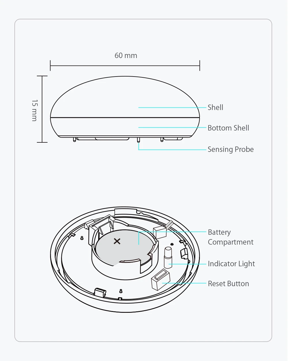

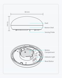

    Promotional graphics. On the bottom of the product you can see three "feet" which detect the liquid:
    BlitzWolf BW-IS9 flood, water leak sensor on Zigbee BlitzWolf BW-IS9 flood, water leak sensor on Zigbee BlitzWolf BW-IS9 flood, water leak sensor on Zigbee BlitzWolf BW-IS9 flood, water leak sensor on Zigbee BlitzWolf BW-IS9 flood, water leak sensor on Zigbee BlitzWolf BW-IS9 flood, water leak sensor on Zigbee Product parameters:
    Model BW-.IS9
    Size
    BW-. 60 * 15mm
    Communication protocol ZigBee
    Range 100m (outdoors)
    Operating voltage 2.1-3.3V
    Battery model CR2450
    Battery life Up to 1 year
    Low battery voltage alert from 2.3V
    Operating current in sleep mode ≤10uA;in alarm mode ≤ 8mA
    Detection method the fluid must conduct electricity
    Work environment -.10℃~50℃;≤ 95% RH
    Constrola App BlitzWolf/Smart Life/Tuya APP
    Waterproof level IP64

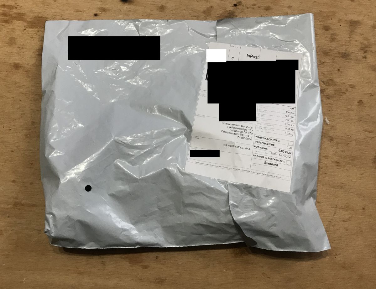

    The contents of the set I placed the order on 2021-11-16. The courier brought the package on the 22nd. Slightly slower than usual, but overall there was a weekend on the way. Sent from Sulejówek.

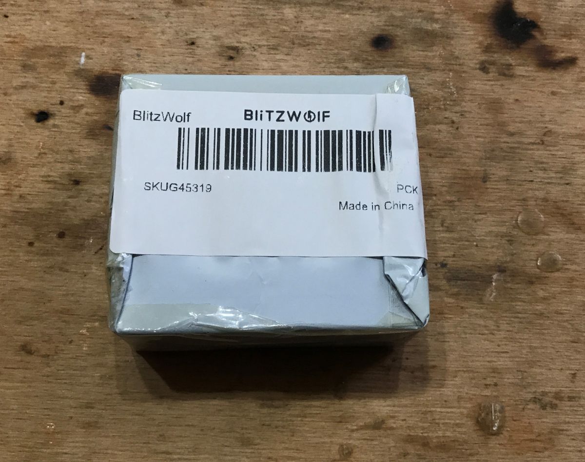

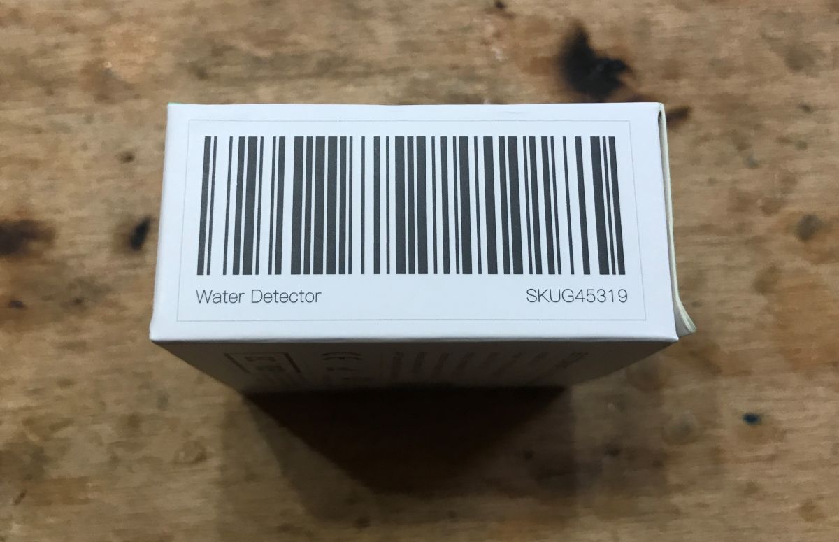

    A large plastic bag and inside a small box.

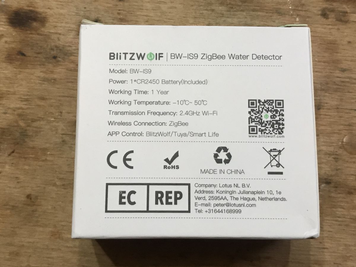

    Product SKU code: SKUG45319

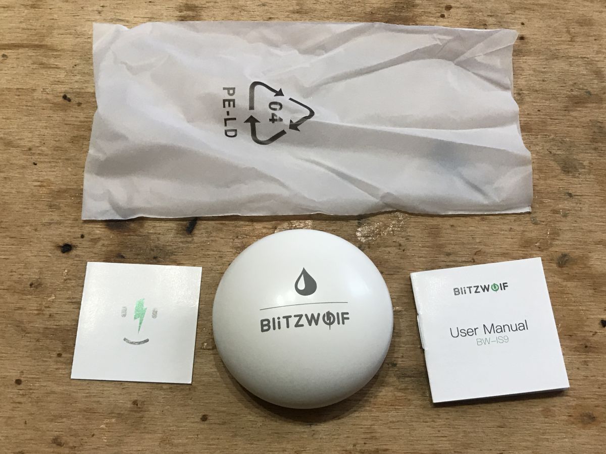

    Set contents:

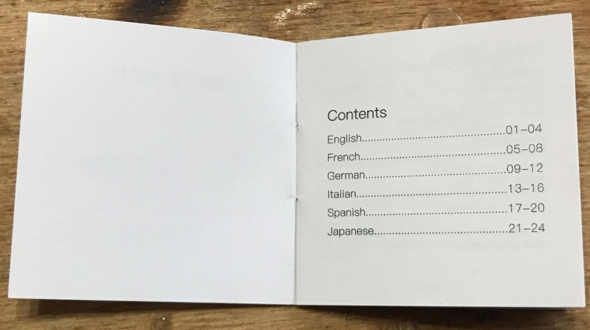

    Instructions:

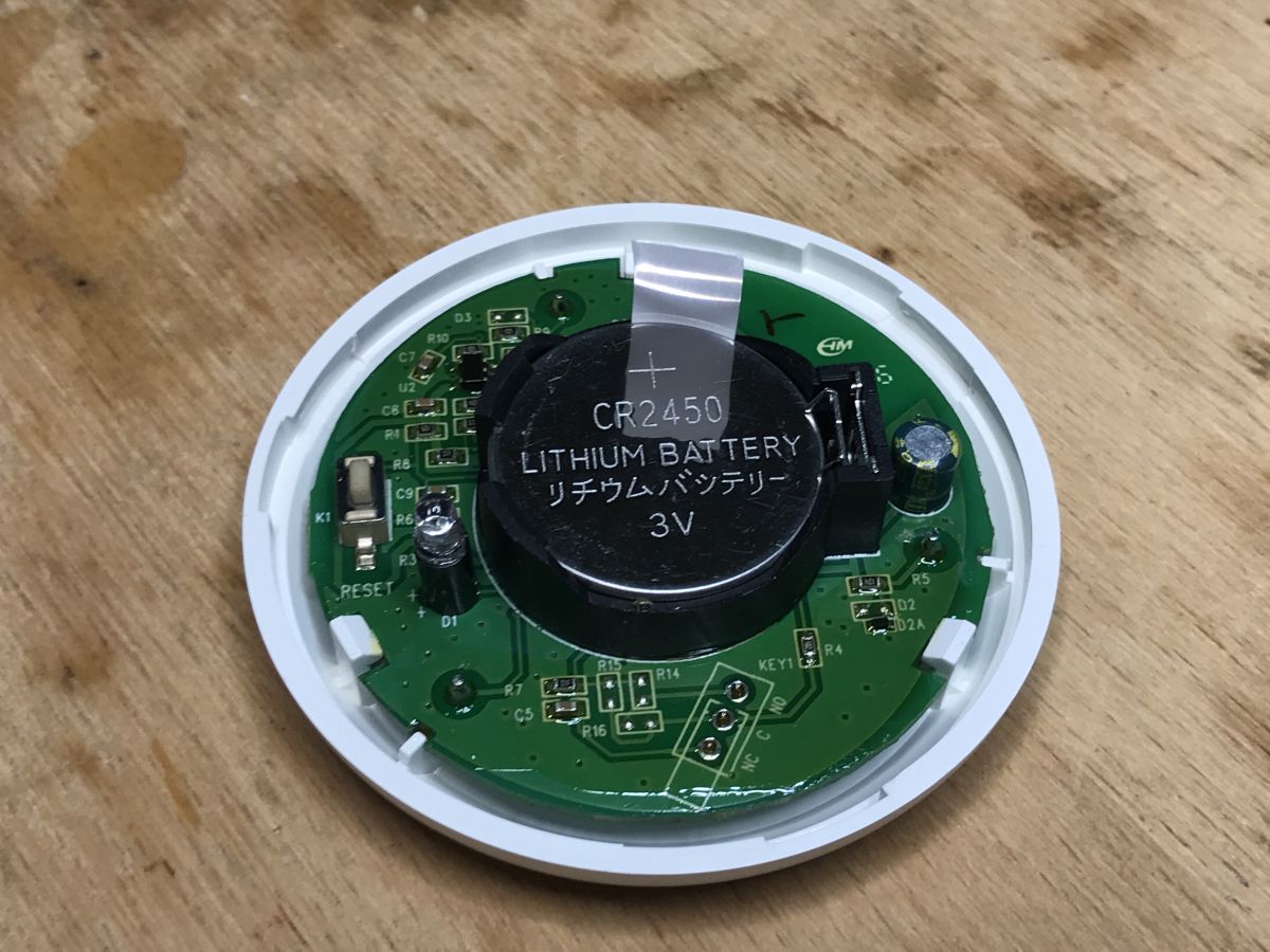

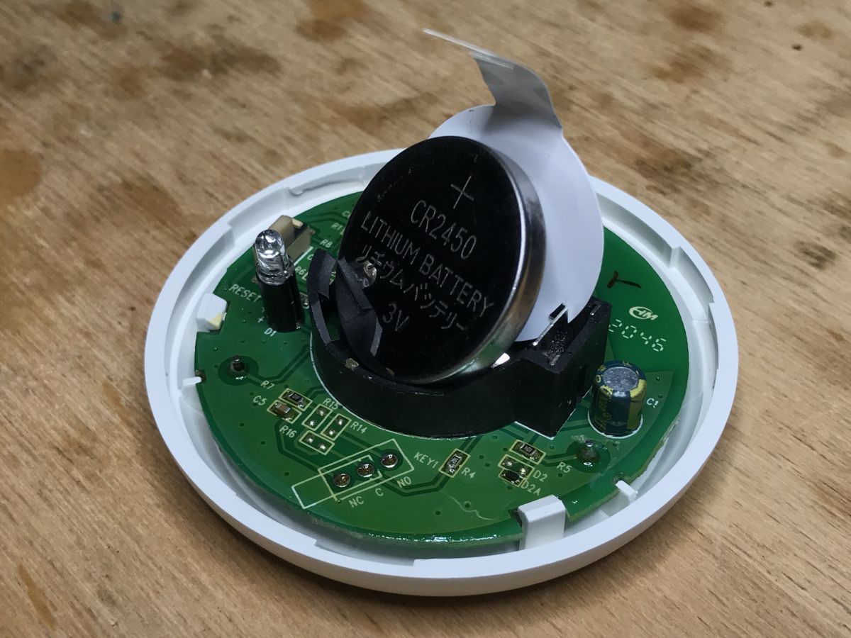

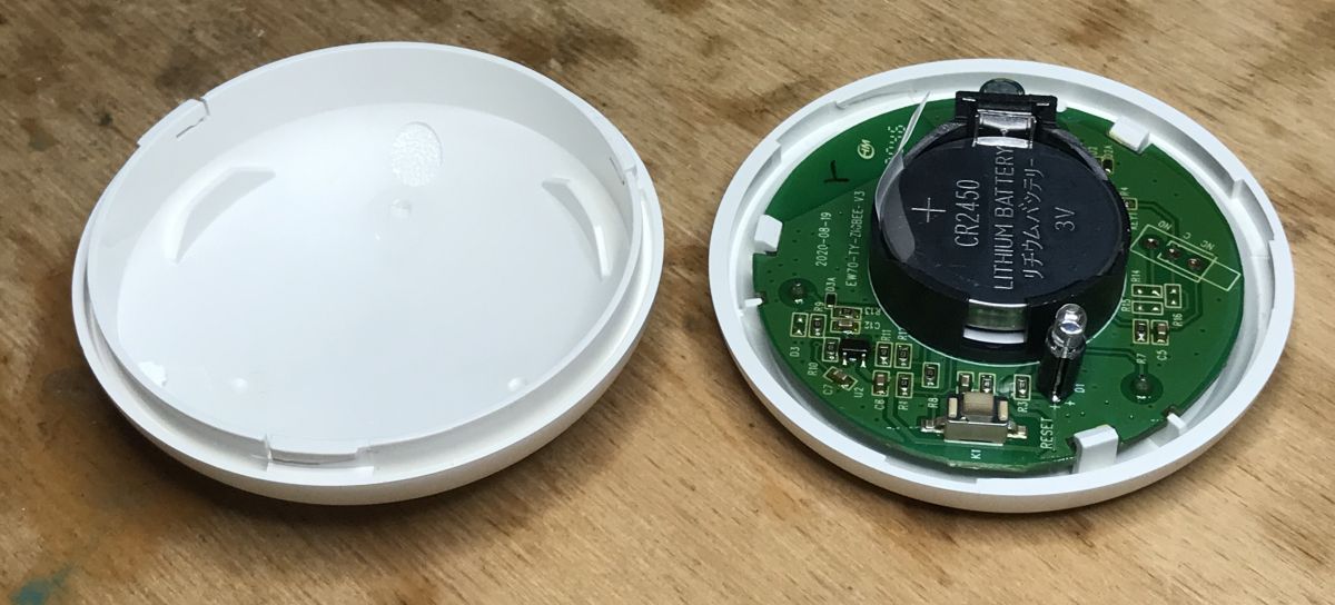

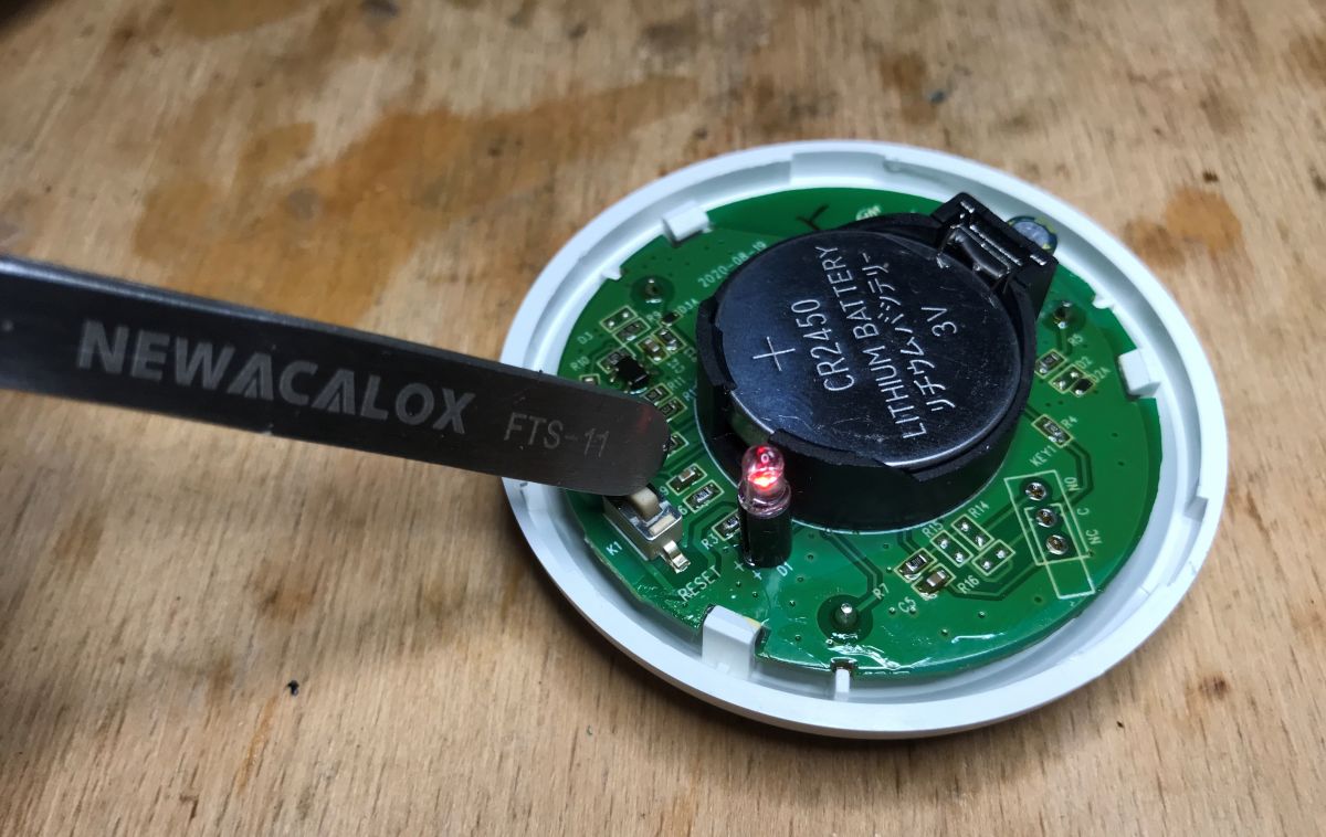

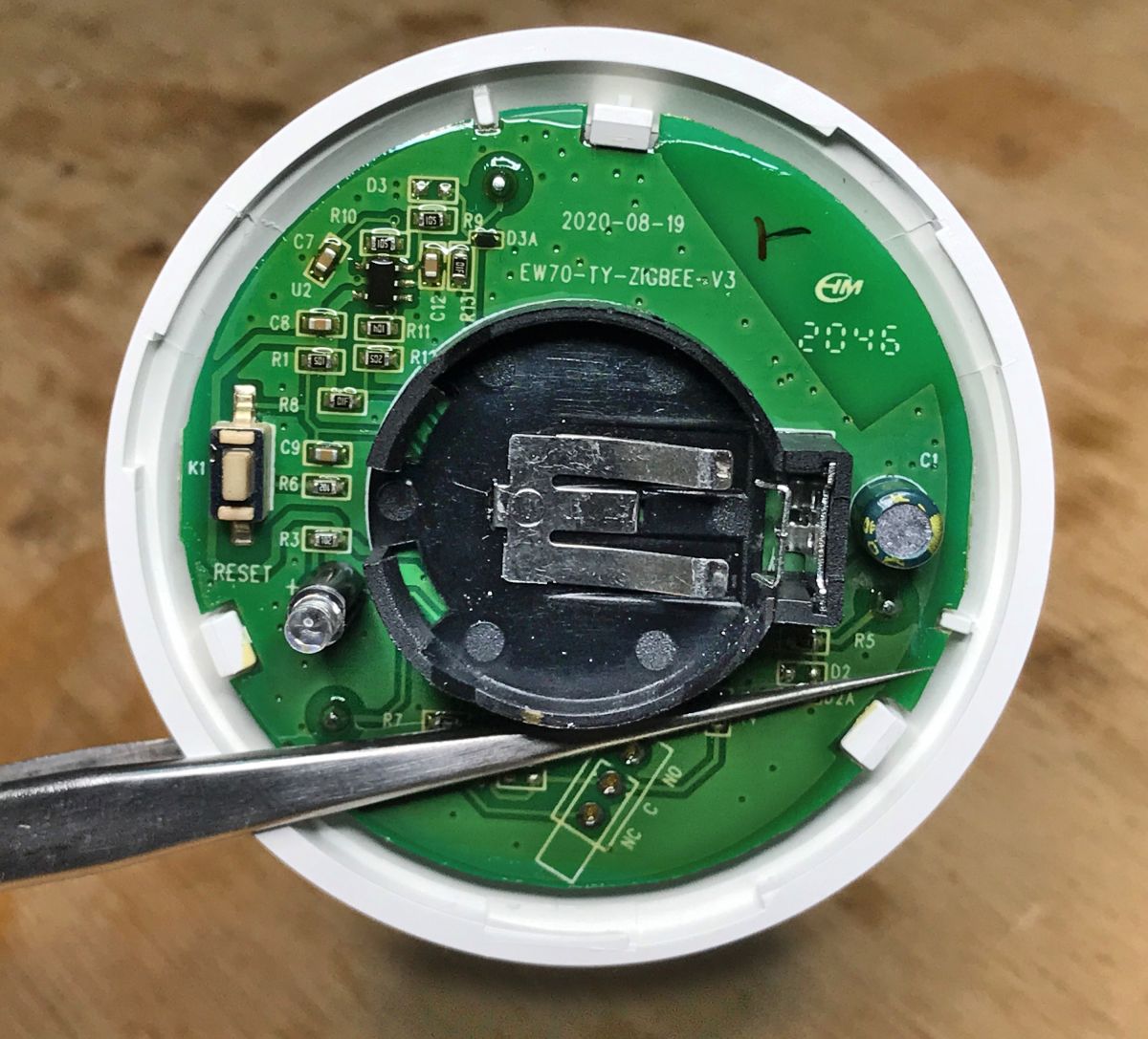

    Then we remove the casing from the device (rotary motion, slightly twist the top of the casing), unlock the CR2450 battery (remove the strip isolating it so that it does not discharge in storage) and press the button longer:

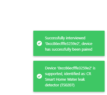

    Home Assistant detects the new device:

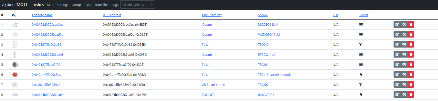

    Device appears in the list (here No. 7):

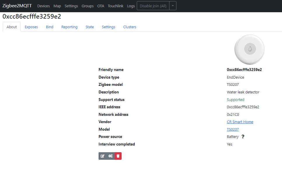

    The Home Assistant says it is model TS0207 and its manufacturer is CR Smart Home:

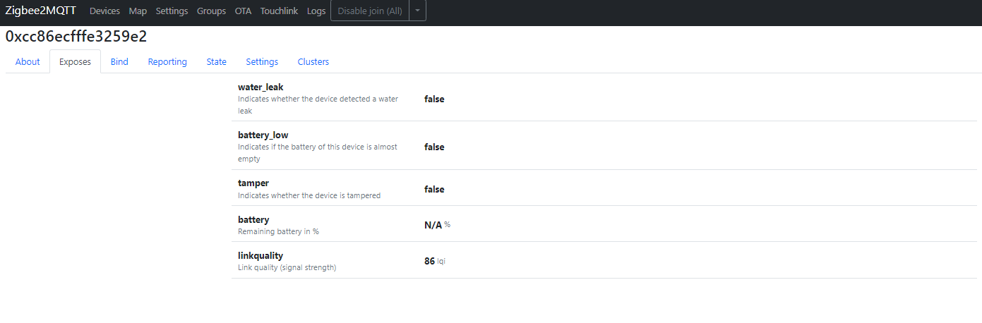

    Variables provided; as you can see, % of battery life is not available, but a true/false variable is available to tell if the battery is low.
    Interesting is the "tamper" variable - in theory this is supposed to tell if someone has messed with the sensor, but I have not been able to trigger changing it to "true". The HA documentation only says " tamper: on means tampering detected, off means no tampering (clear) ".

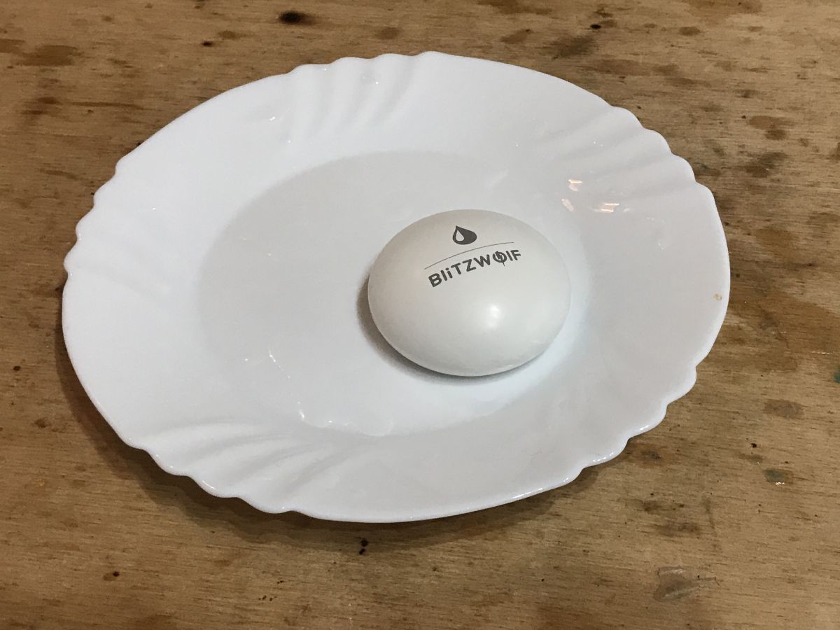

    Check if sensor detects water Tap water:

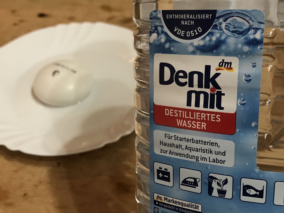

    Distilled water:
    In both cases it detects moisture, although there must be enough water to touch at least two sensors. As for the quality of this distilled water what I have I am not sure, but the ground is that the sensor works.

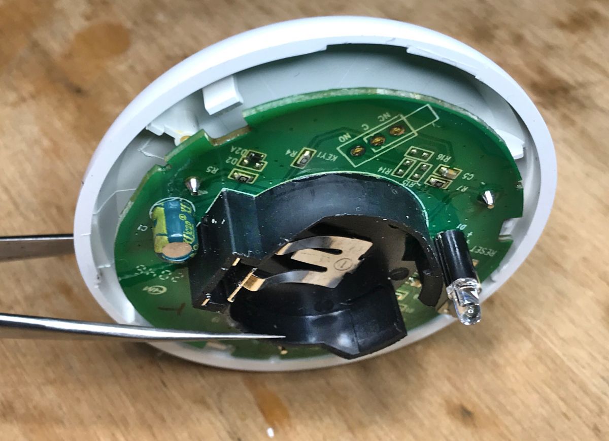

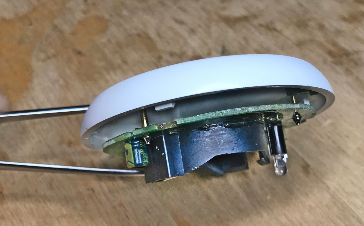

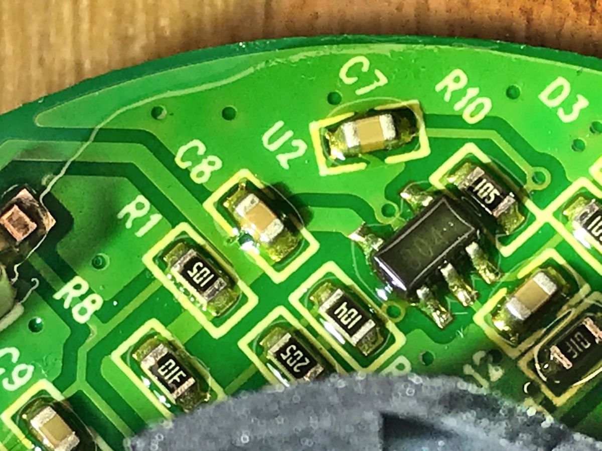

    Interior of BW-IS9 Basically, we can already see the interior at the pairing,
    BlitzWolf BW-IS9 flood, water leak sensor on Zigbee NOTE - the board is flooded with some kind of varnish that is intended to make it more resistant to moisture. This is visible in the photo below:
    Unfamiliar circuit, perhaps an amplifier associated with the water sensor. At first I thought it was a step up converter generating a constant 3.3V for the ZigBee module from a CR battery, but that would be redundant as the battery gives about 3V and the ZigBee module can operate on voltages from 2.2V. The code on the component is 804, I couldn't find its note.
    The board sticks to the base only on the three sensor legs, which are slipped into the plastic:

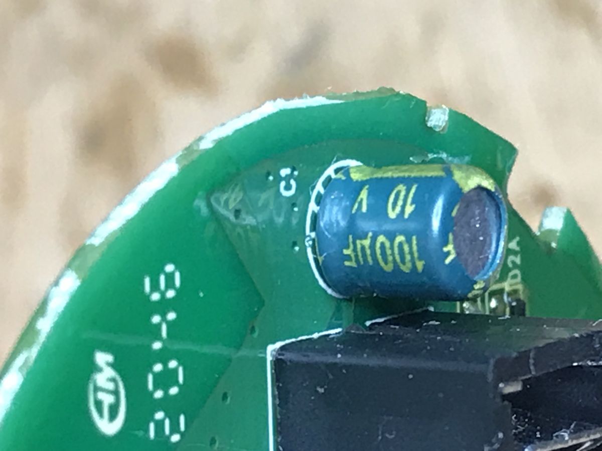

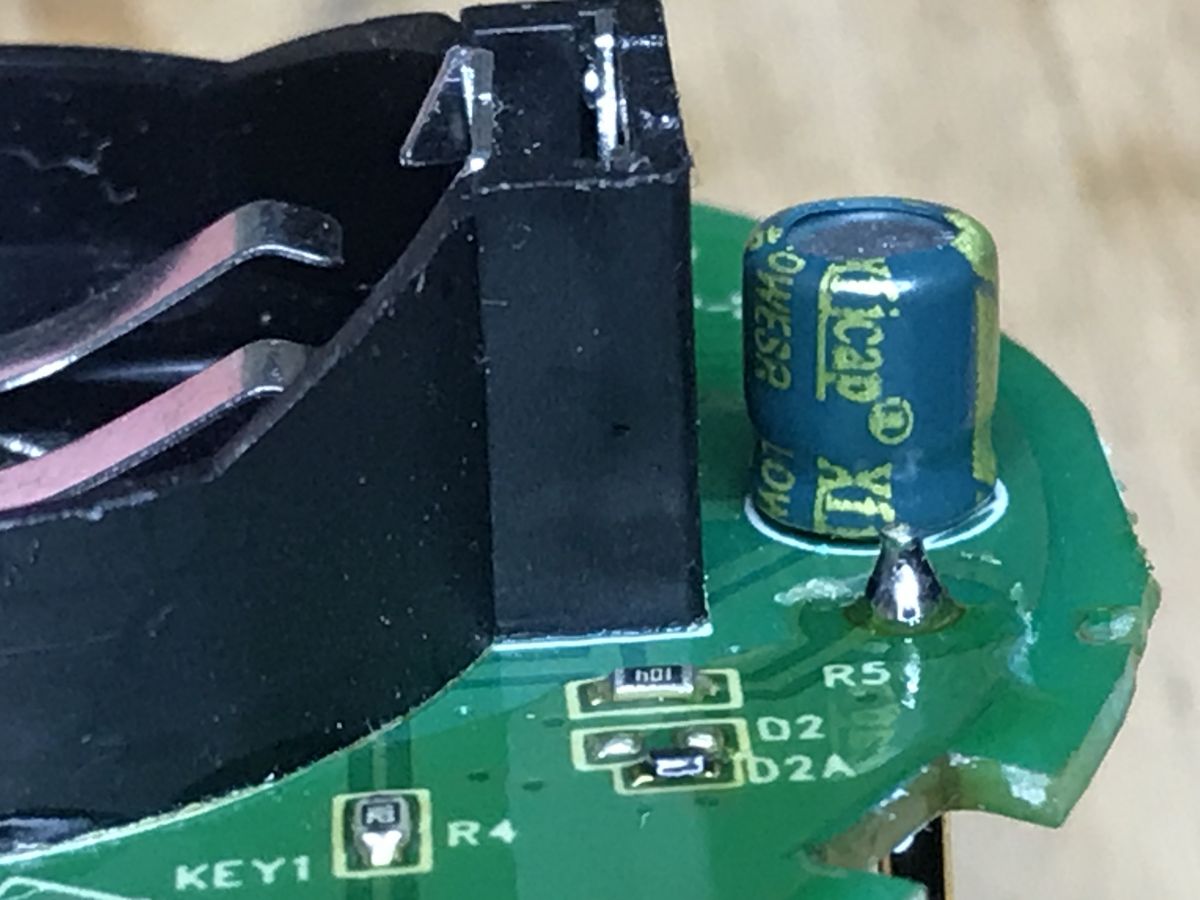

    Capacitor:

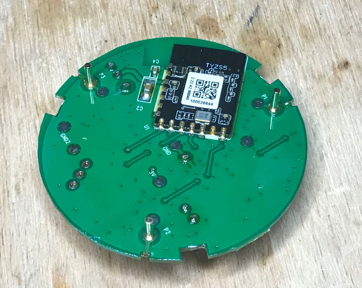

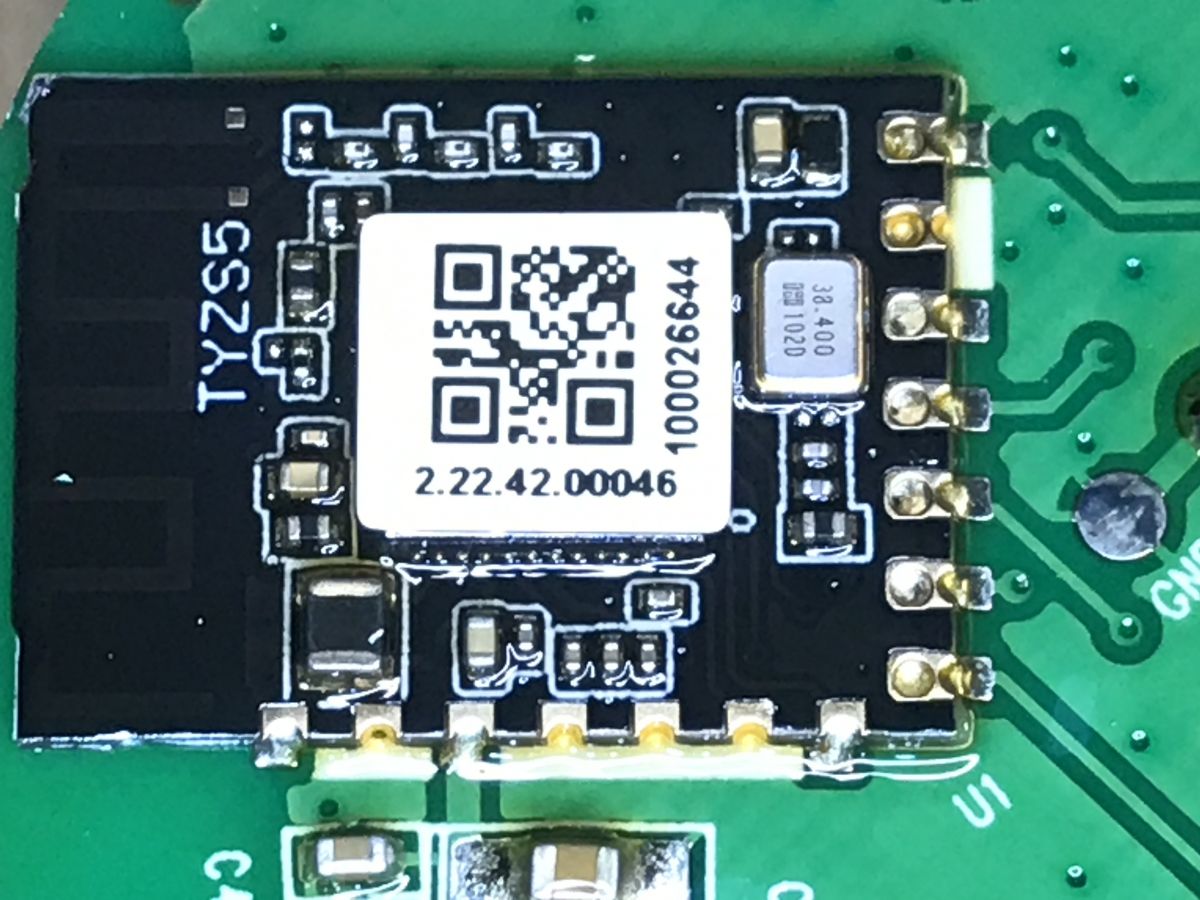

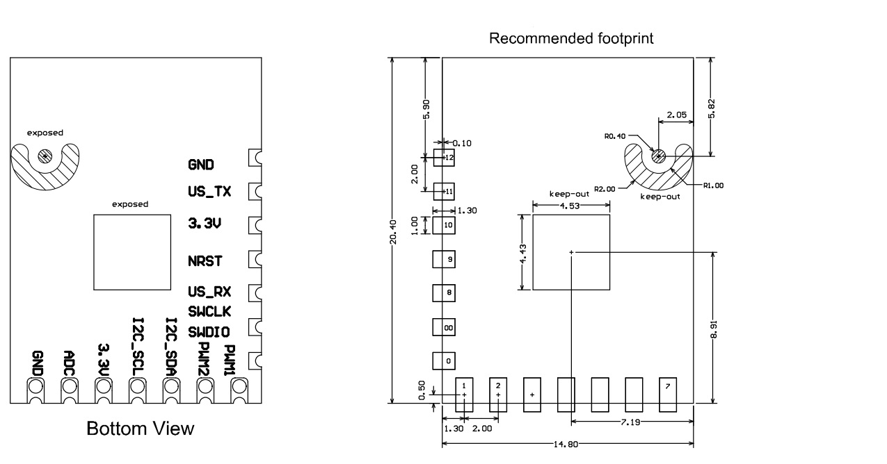

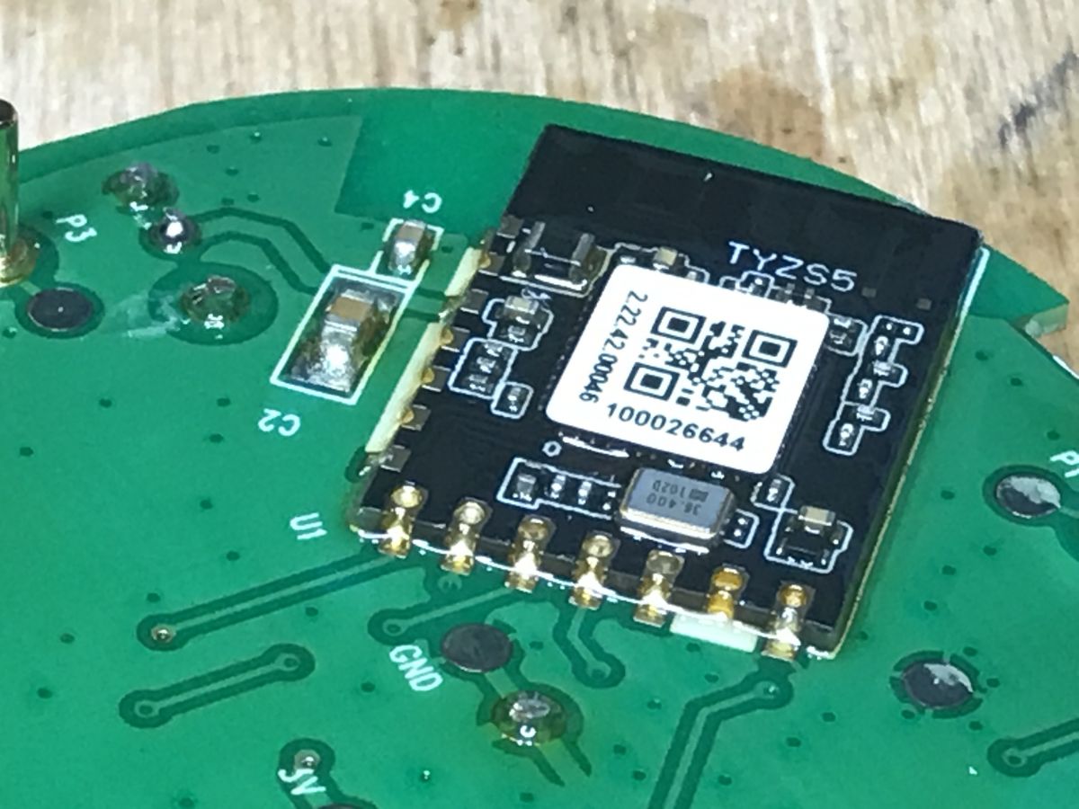

    On the bottom we have a ZigBee module:

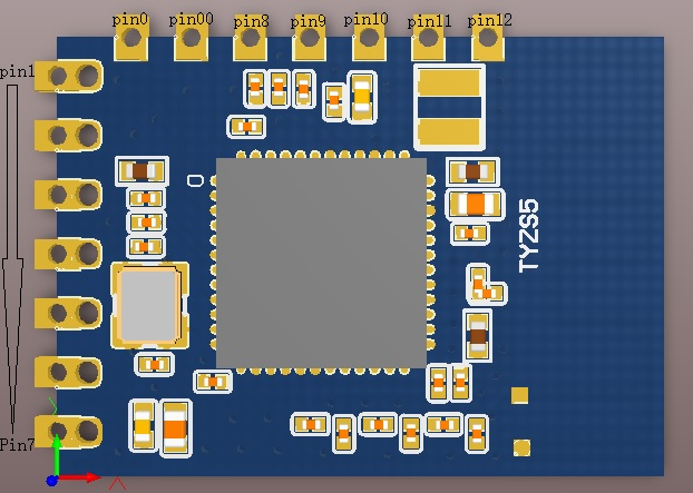

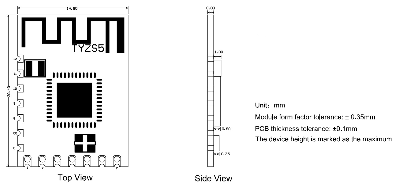

    The TYZS5 module, along with the 38 quartz resonator.4MHz, or EFR32MG13P732F512GM48.

    This sensor is realized on the basis of the ZigBee TYZS5 module and at this point is fully supported by Home Assistant. I have no objections to its sensitivity and response time to flooding, although the fact is that the liquid has to short circuit at least two of its pins for the event to be detected.

    There is only a step-up inverter (converting about 1.5V to 3.3V) and a ZigBee module
    There is a 3V battery, not a 1.5V battery. TYZS5 works from 2.2V, so it does not need an inverter.
  • 3V battery avoids voltage boost circuit
    #5 19738124
    Posts: 14756
    Rate: 12883
    krzbor wrote:
    There is a 3V battery, not 1.5V. TYZS5 works from 2.2V, so it does not need an inverter.
    You are indeed correct. I am already making a correction. I've seen too many of those with a 1.5V battery and got worked up.
    dktr wrote:
    But only in appearance. Inside quite different, a different cr123 cell (why wasn't one used here?)
    Basically, colleague @krzbor explained, a 3V cell was used here to avoid the requirement to raise the voltage.
