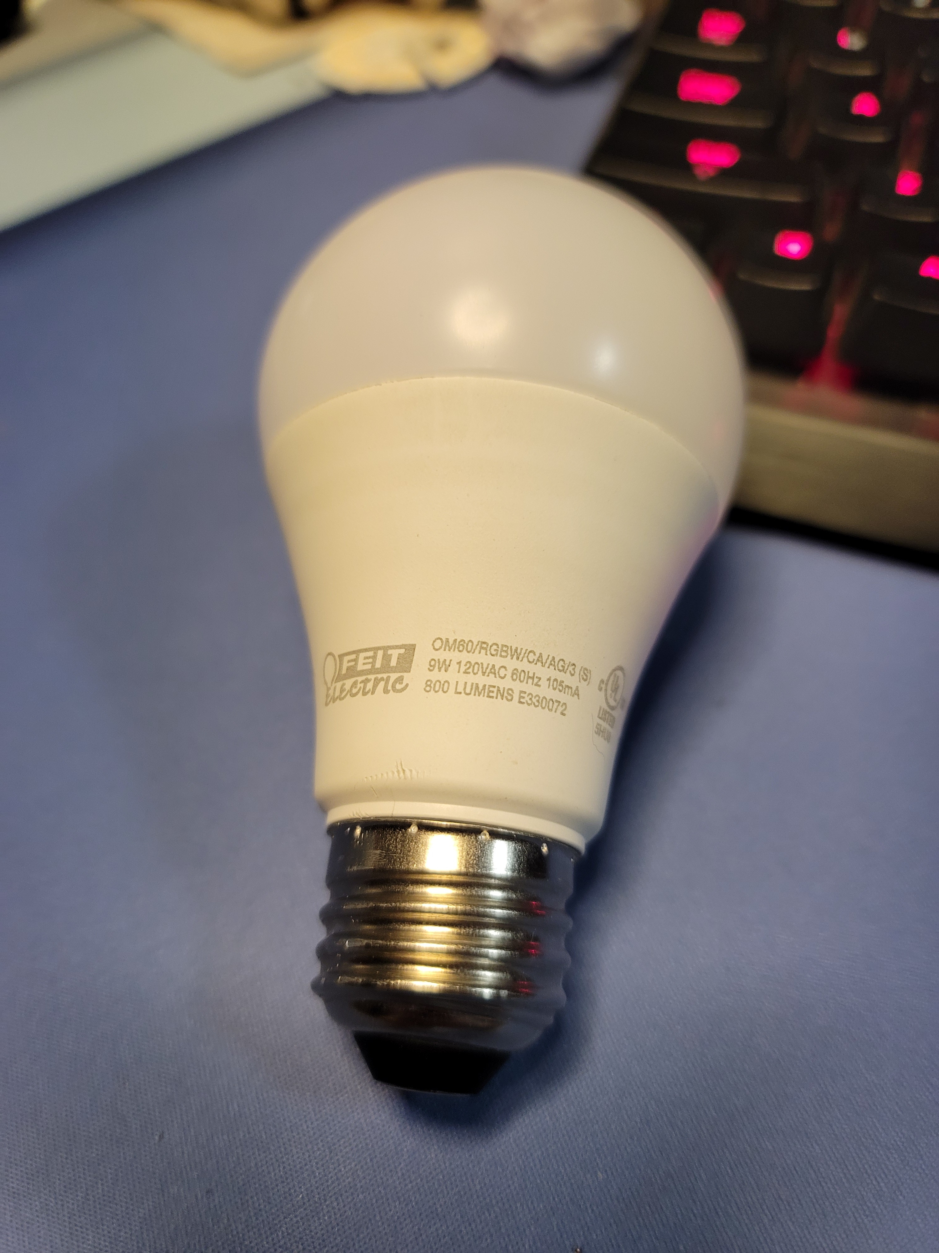

Teardown of the Feit OM60/RGB/CA/AG/3 bulb. This can be found in the US on Amazon and in retailers such as Costco.
Features a BK7231N chip directly on the main board, no external module board found here. It also has a BP5758 i2c driver, but according to the docs, it is not strictly i2c.
More info on the BP5758:
• From Tuya here: https://developer.tuya.com/en/docs/iot-device-dev/driver_i2c_bp5858d?id=Kb7bciwq50zfc
• Datasheet here: https://github.com/arendst/Tasmota/blob/devel...asmota/tasmota_xlgt_light/xlgt_08_bp5758d.ino
• and Example Code from someone getting this into ESPHome: https://github.com/dbuezas/esphome-bp5758
I was able to flash this successfully with OpenBeken/OpenBK, but I'm unable to control the light or colors at this time. Unsure where to start with the config, but I'm thinking support for the BP5758 will need added before it will work.

The BP5758D LED Driver is now supported as of 1.12.14 of the OpenBK firmware. https://github.com/openshwprojects/OpenBK7231T_App/ [Read more]

It looks like another model exist that uses the BP1658 is now being sold as well. https://obrazki.elektroda.pl/7276760500_1670727896_thumb.jpg https://obrazki.elektroda.pl/6692404300_1670727895_thumb.jpg... [Read more]
p.kaczmarek2 11 Dec 2022 12:19
@william1 hey, would you be able to provide information which LED model is that, how the package looks like and where it was bought? Thanks Or is it the same (from the outside), indistinguishable ,... [Read more]
William1 11 Dec 2022 16:37
Everything is the exact same as the previous one besides the new driver chip. It is the same model, FCC ID, and packaging. I saw them on sale at Walmart for the 3 pack for $8.99 and decided to give them... [Read more]
