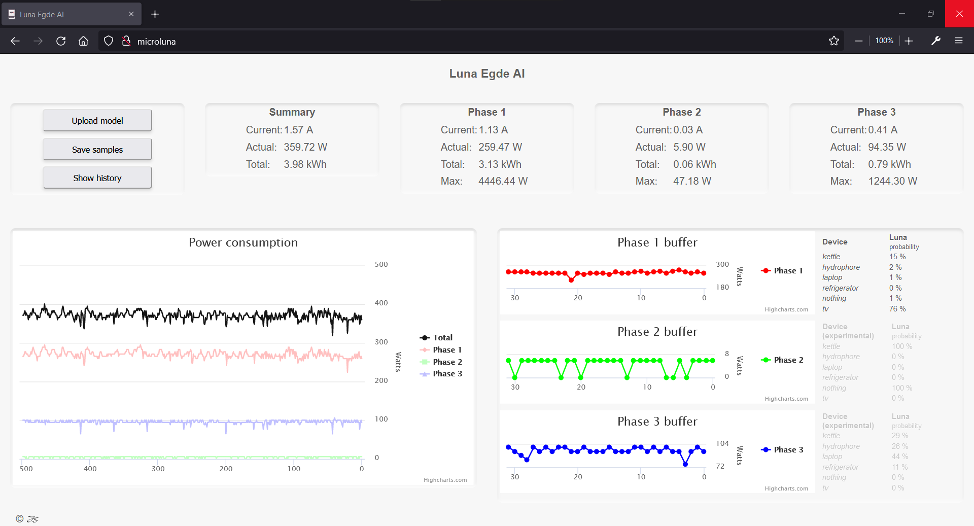

  • microLuna is an ESP32-based electricity meter that runs edge AI locally, detects device waveforms, and shows events in a web dashboard.
  • It uses TensorFlow Lite on the microcontroller, with a rebuilt smaller network model, SD card storage, and ADS wired to different pins because of ESP32cam overlap.
  • The model was cut to 1208 neurons and now analyzes a 32-second window instead of 500 seconds.
  • Training still happens on a PC in Python, while the ESP32 collects 32 samples of 32 values, saves them to SD card, and supports FTP and .bin uploads.
  • The main limitation is ESP32 resource pressure: shorter buffers can miss unusual waveforms, and recursive LSTM tests have not yet matched the current accuracy.

The software is based on the TensorFlow Lite library, which forced me to rebuild the network model (reducing the number of neurons).
The layout has also changed slightly due to the SD card support, some of the ESP32cam pins overlap with those of the card. ADS was connected to the other legs.
The system has a web interface in the form of a dashboard, with the possibility of reporting on events that have occurred.
Refreshing the charts every 5 seconds, so basically a real-time preview.

Instead of the previously analyzed 500 sec range, Luna now only sees 32.
This causes differences in the time of indicating detected devices, sometimes it is simply too short a period to classify an unusual waveform.

I save the data every 120 seconds in the csv file - this window seems optimal at the moment, maybe a bit too long in relation to the 32 seconds of the buffer. I will see after a few days, I want to minimize the logs.
Luna's website currently has a simple reporting system - a chart showing the above collected data.
I am going to add filtering by period, device etc. If there was any sql or pandas on esp ...
