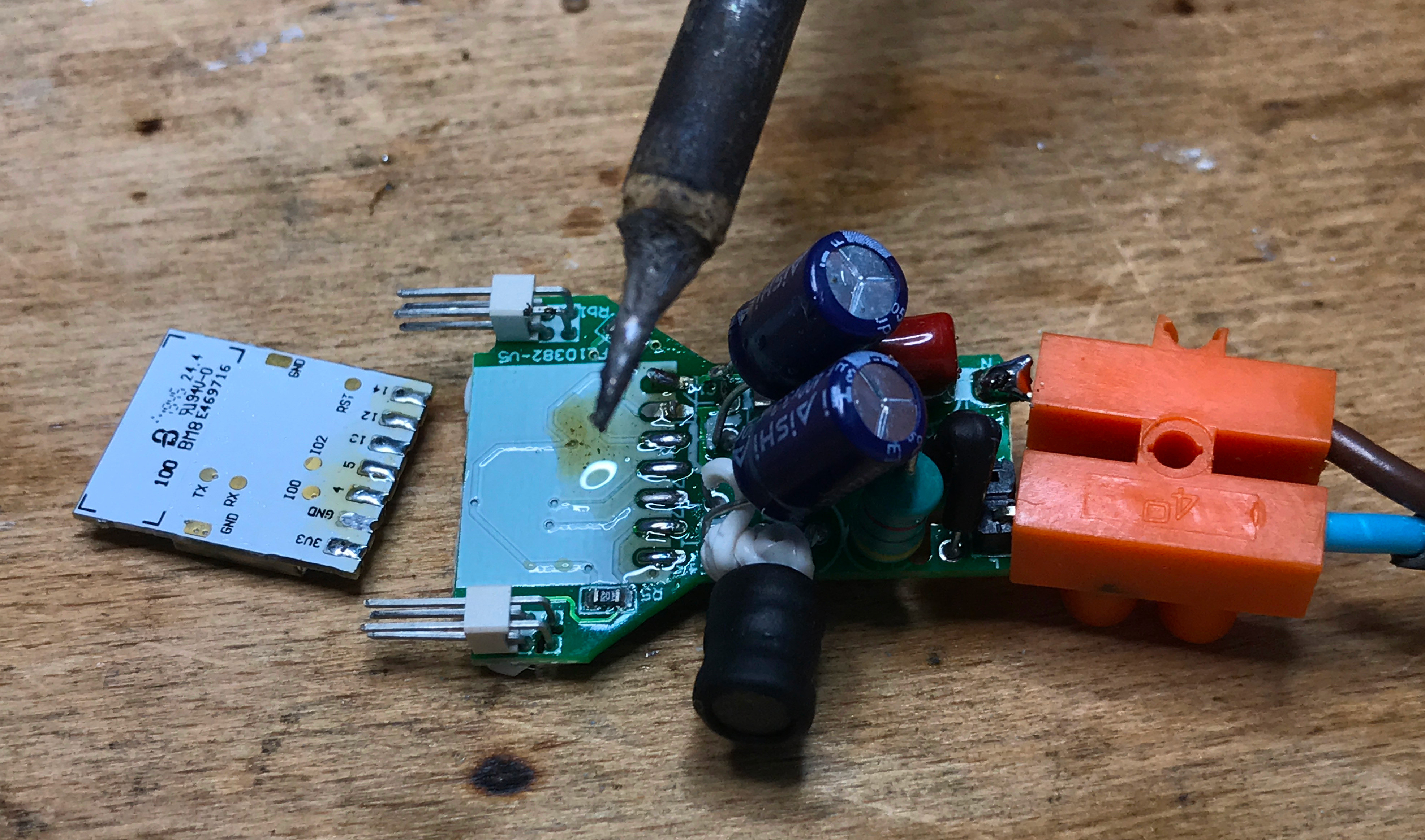

Hello, here I will present the interior of another IoT lamp using ESP chip, RGBCW, GU10, model BKL1262, bought in a Polish mail order store. I will try to program it via tuya-convert, i.e. without opening the case, but will it work? We'll see.

Programming pads (UART, TX and RX interface, here also GPIO0) are unfortunately on the bottom of the module. If it is covered by second PCB, the module will need to be desoldered.

This is quite a known problem, you can read about it on Github tuya-convert. It is impossible to upload the firmware here remotely. You have to solder.
Simple module desoldering and programming
The module must be desoldered, because the RX / TX pads are covered by the second PCB and there is no other way to get to them.
You could use hot air, but why complicate it?
All you need is the cheapest, used soldering iron without power regulation, flux and some lead solder (Pb-free solder has higher melting point which makes everything hard, so I prefer Pb one).
1. apply flux
2. apply additional Pb tin on the pads
3. heat up all pads with extra tin together
4. the module should drop by itself
5. it is worth cleaning with a braid and also IPA pad cleaner
Some photos from the process:
Programming ESP8266 ... it was discussed many times, even by me, here:
SmartLife switch - test, interior and WiFi light switch programming
In general, I soldered only RX, TX, ground, power and IO0 (to ground) and it started, I rebooted by cutting off the power, I powered it from the 3.3V TC1264 LDO. I programmed via esptool.py. I made a backup of the firmware (I will put it at the end of the topic):

Referring to the Blakadder website, I can say that this light comes from the period when the tuya-convert did not work anymore (after changing the PSK), but there was also an ESP8266 inside. I don't know if it changed after that.
In order to program it, I had to desolder the module what turned out to be very simple, the cheapest soldering iron still one with a worn tip.
Programming went smoothly and after a quarter of an hour the lamp was already controlled by Tasmota.
