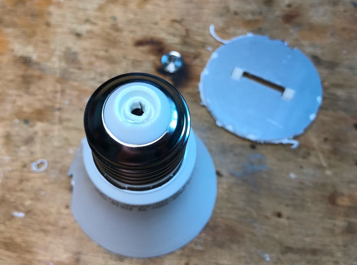

    Interior of the BKL1250
    I have described the Tuya application on the forum many times, so this time I went straight to disassembling the product.
    The plastic dome can be lifted with a flat screwdriver, but in this case I had to "drive" around it and pry it to be able to take it off.
    BKL1250 white LED E26 for 3$ WiFi Tuya [ESP8266] [Tuya-convert]
    BKL1250 white LED E26 for 3$ WiFi Tuya [ESP8266] [Tuya-convert] BKL1250 white LED E26 for 3$ WiFi Tuya [ESP8266] [Tuya-convert]
    Undermining the "pin":
    After removing the thread (I also prized it and started spinning it, it is pressed in):

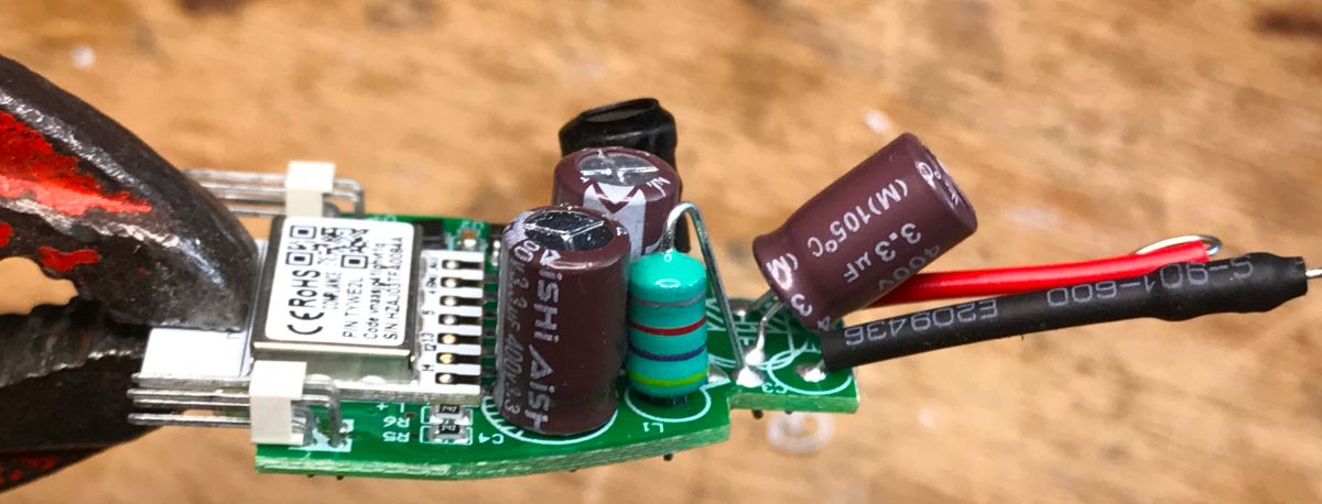

    A few photos of the module from the inside:

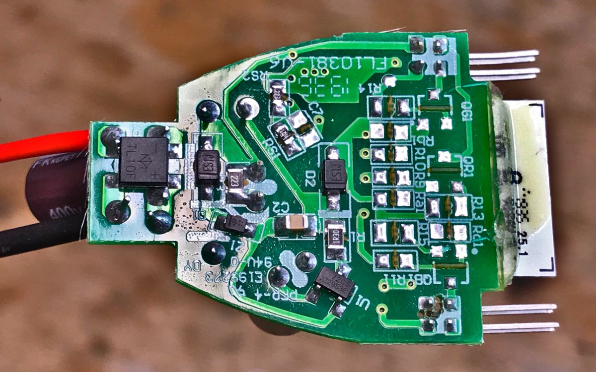

    Everything as standard. The fuse in the line, TL10F rectifier bridge, in the power block is 7205 22953E (housing SOT23-3) and BDCAG (on top of the PCB; SOT23-6). By the presence of the choke, I suspect that it is probably a step down converter, maybe with an LDO regulator. Something has to convert about 325V to 3.3V for ESP and this is not a capacitor-based solution (so-called 'capacitive dropper'), I do not find such in IoT LEDs any more.

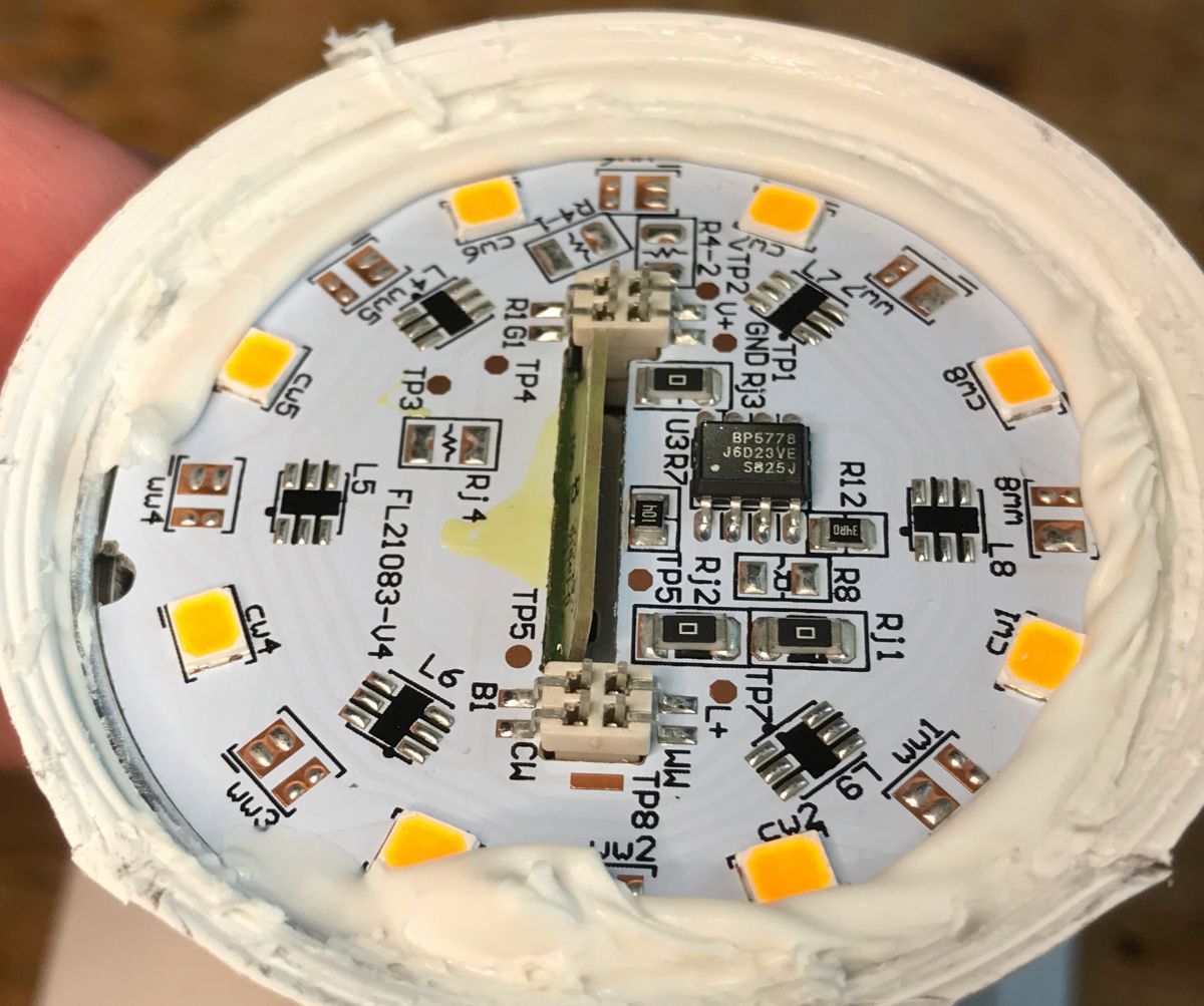

    On the separate PCB shown earlier, the one with LED diodes, there are warm-colored LEDs, and there is a place for cold-colored LEDs and three-color RGB diodes. Quite simply, this board is also used in the RGB and RGBCW versions of this product.
    In addition to the LEDs, there is also their driver - BP5778.
    This LED controller does not require additional voltage reduction. It supports two channels, which is probably usually warm and cold white. The colors (RGB) are reliably controlled by separate transistors, I can see a place for them on the second PCB, but they are not present, as it is not a RGB version. BP5778 requires external resistors for LED current measurement in order to work.

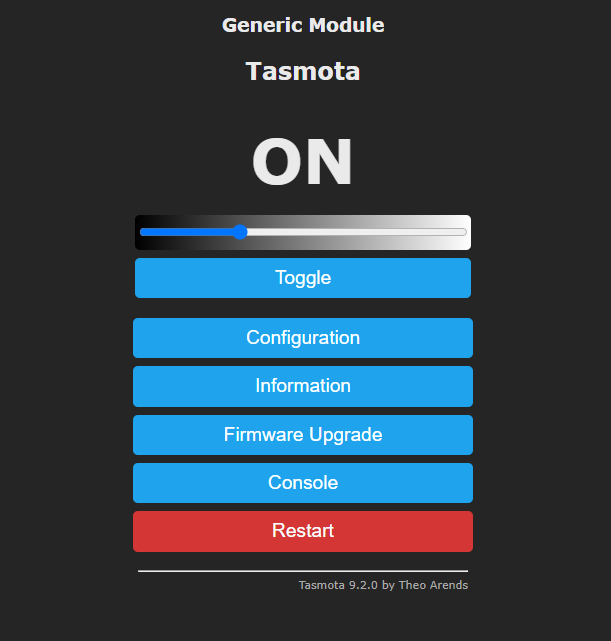

    Tasmota interface ready:
    Hassle-free, everything works.
