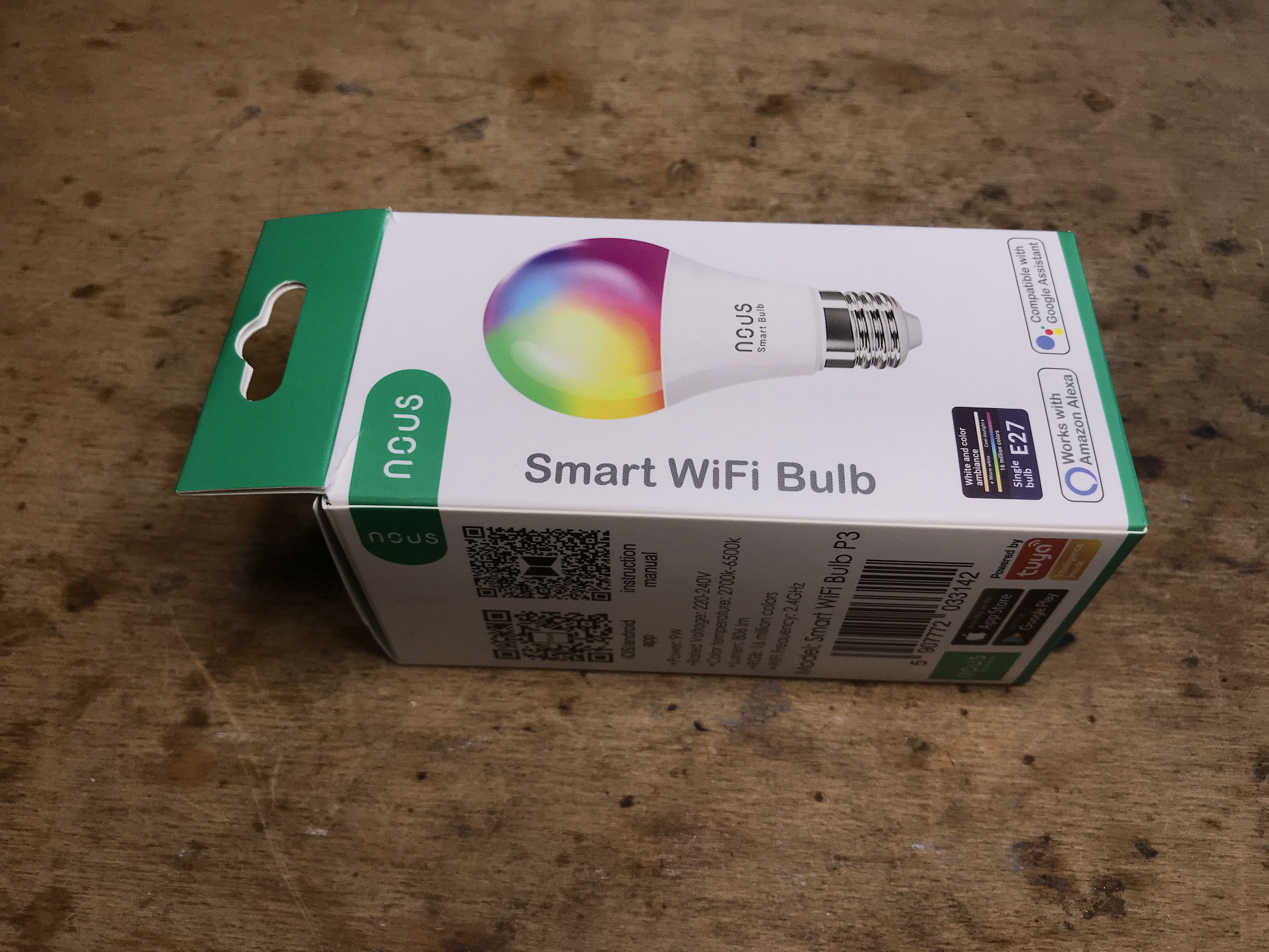

Hello, today another short topic about changing the firmware of an LED light, this time Nous, model P3-A60-RGB-CCT. In this product, I found a CB2L module (BK7231N), which programming pads have on the bottom, and unfortunately I had to solder it all out to get to them. In addition, there is a BP5758 LED driver in this light, which communicates with the WiFi module via their modified version of I2C. I will change the firmware to OpenBeken , which already supports the BP5758.
Below the packaging and instructions for the light:

The QR code from the packaging indicates some sort of Nous app, But I tried the Tuya app - it was able to pair.
