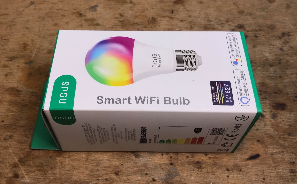

    Hello, today another short topic about changing the firmware of an LED light, this time Nous, model P3-A60-RGB-CCT. In this product, I found a CB2L module (BK7231N), which programming pads have on the bottom, and unfortunately I had to solder it all out to get to them. In addition, there is a BP5758 LED driver in this light, which communicates with the WiFi module via their modified version of I2C. I will change the firmware to OpenBeken , which already supports the BP5758.
    Below the packaging and instructions for the light:
    Nous Smart WiFi Bulb P3 RGBCW - CB2L + BP5758 - firmware change Nous Smart WiFi Bulb P3 RGBCW - CB2L + BP5758 - firmware change
    Nous Smart WiFi Bulb P3 RGBCW - CB2L + BP5758 - firmware change Nous Smart WiFi Bulb P3 RGBCW - CB2L + BP5758 - firmware change Nous Smart WiFi Bulb P3 RGBCW - CB2L + BP5758 - firmware change Nous Smart WiFi Bulb P3 RGBCW - CB2L + BP5758 - firmware change

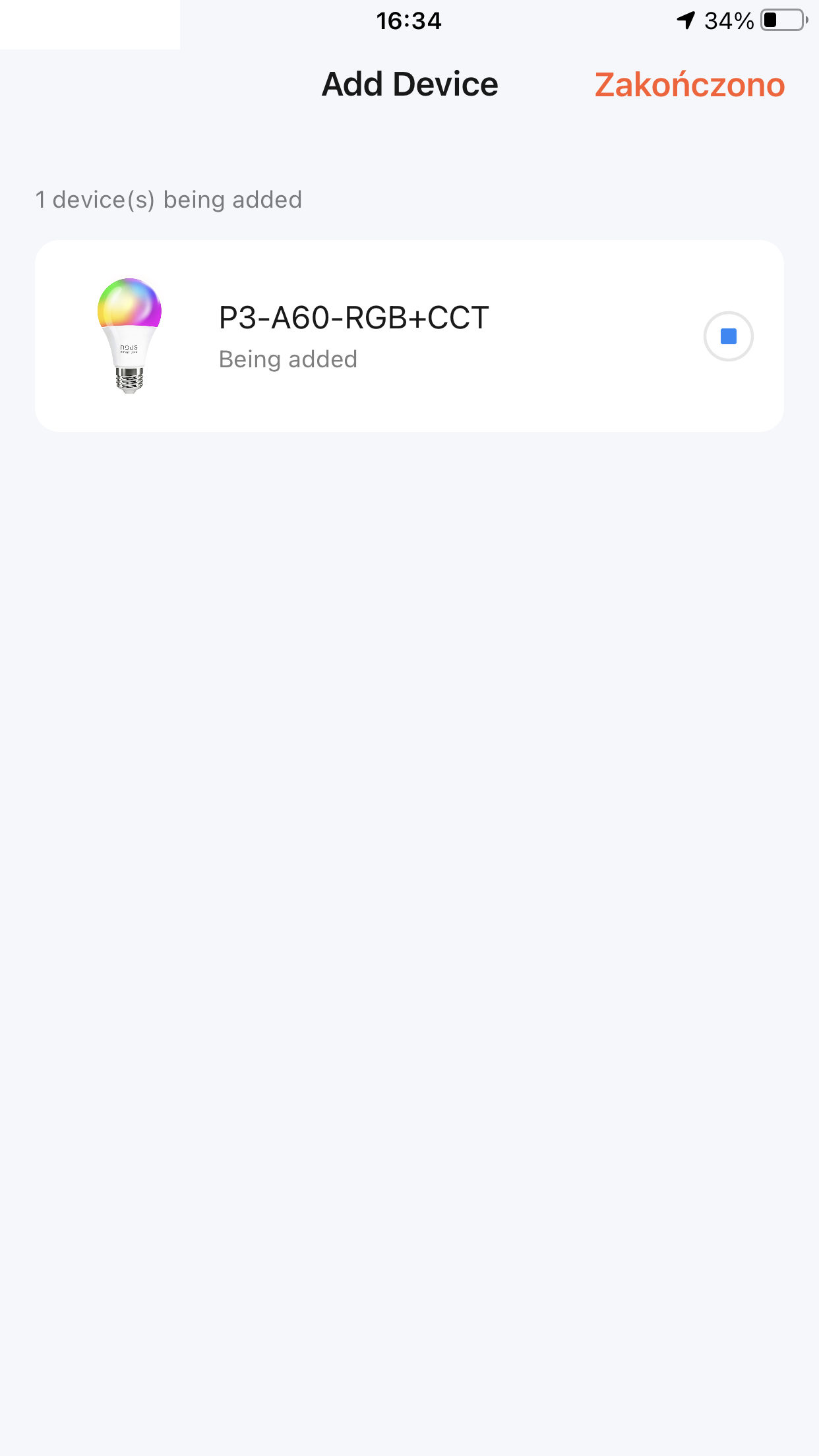

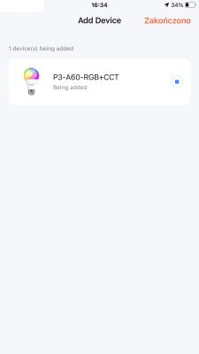

    Pairing with the manufacturer's app
    The QR code from the packaging indicates some sort of Nous app, But I tried the Tuya app - it was able to pair.
    The pairing mode starts in a standard way - turning the power of the light on and off five times. Nous Smart WiFi Bulb P3 RGBCW - CB2L + BP5758 - firmware change Nous Smart WiFi Bulb P3 RGBCW - CB2L + BP5758 - firmware change Nous Smart WiFi Bulb P3 RGBCW - CB2L + BP5758 - firmware change In the Tuya panel:

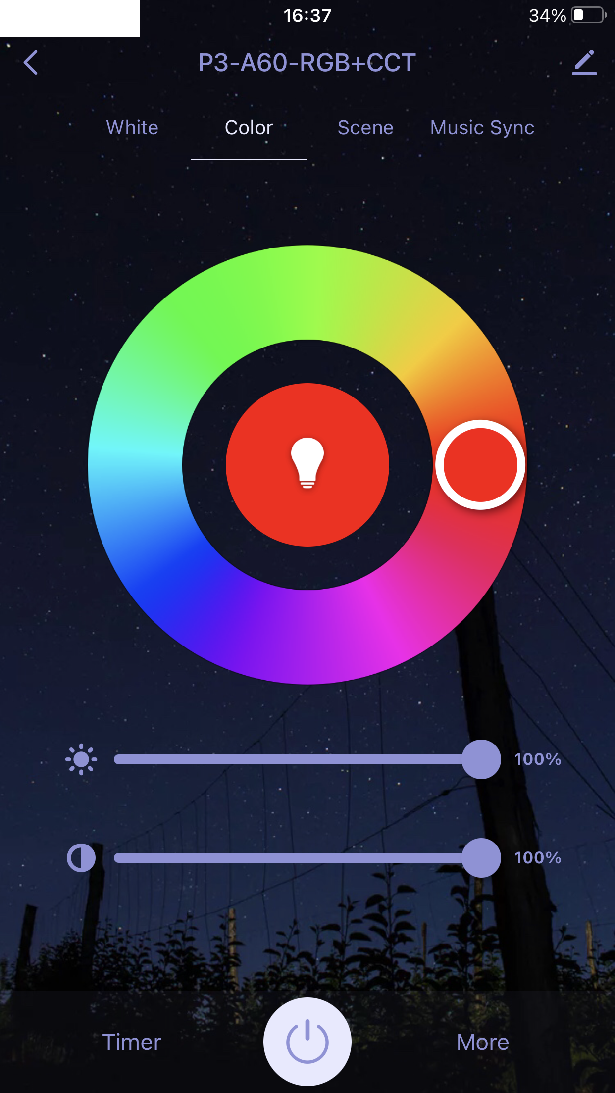

    With the Tuya app, everything works. I do not discuss the Tuya app in detail, as this has been on the forum more than once.

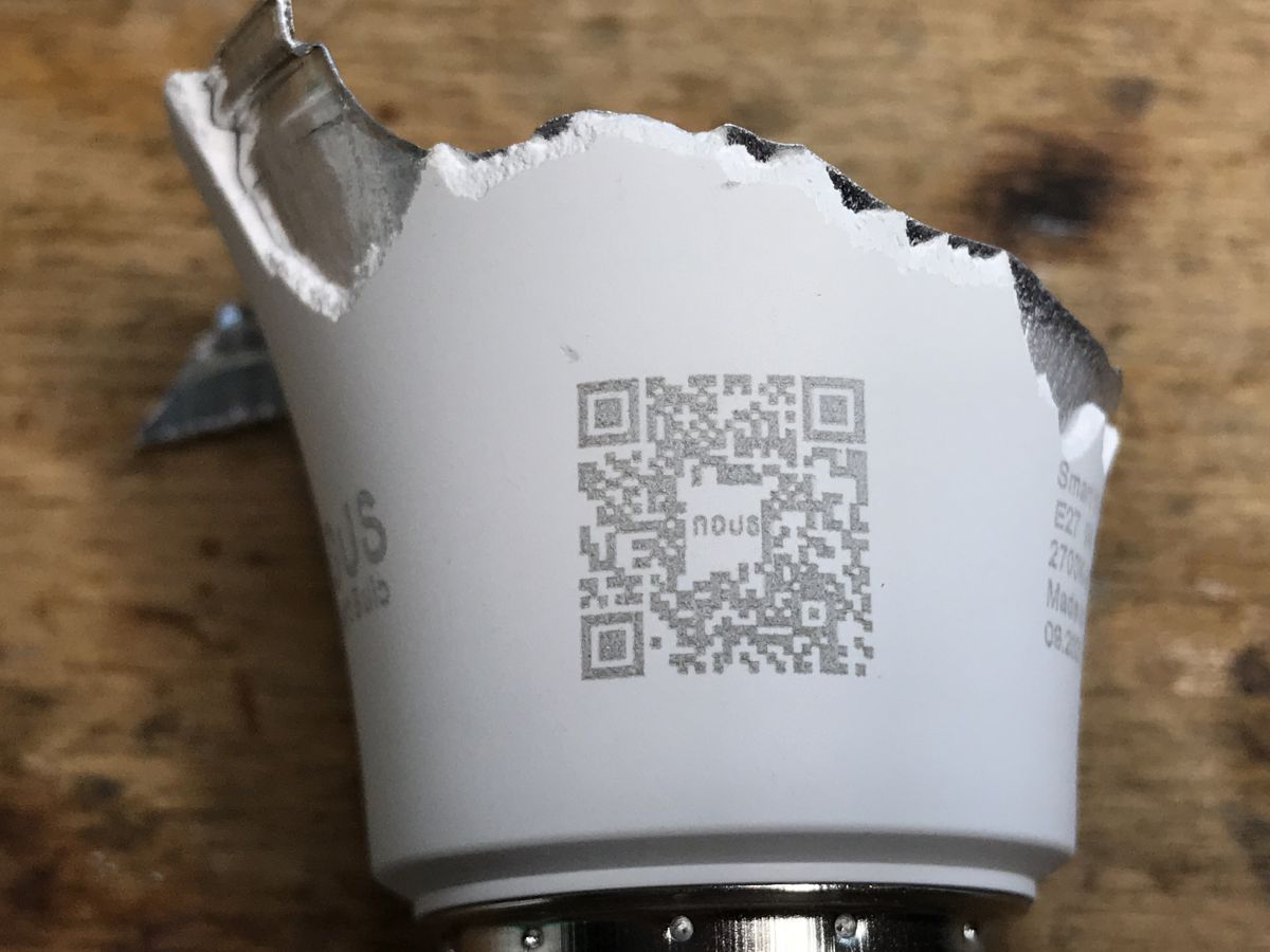

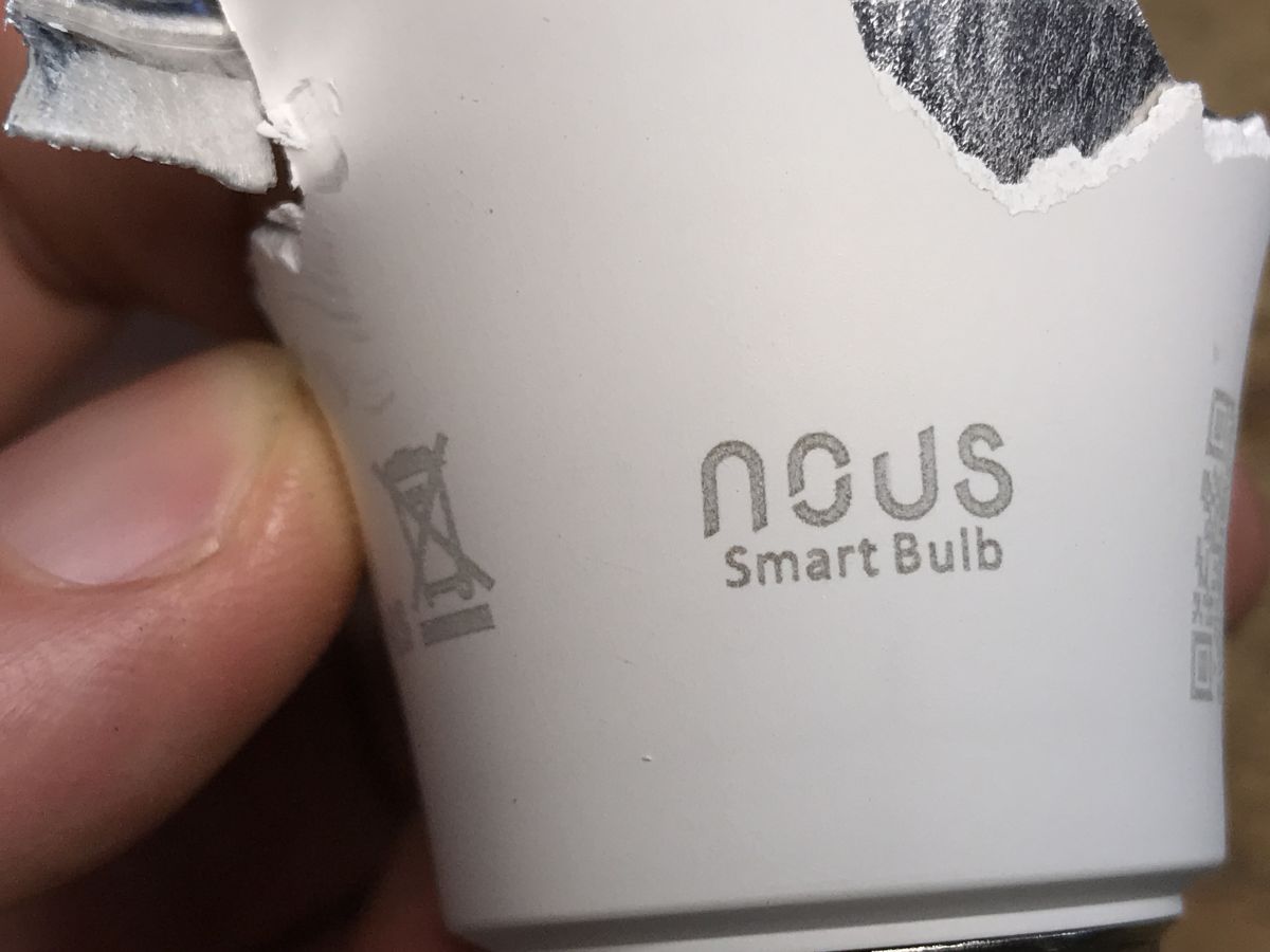

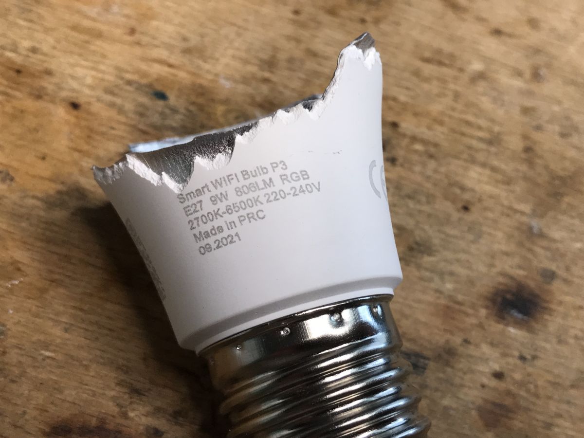

    Interior of Nous P3 RGBCW I got the lamp from a fellow forum member, So it was already open.
    Markings on the plastic:

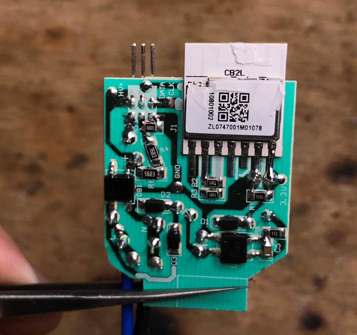

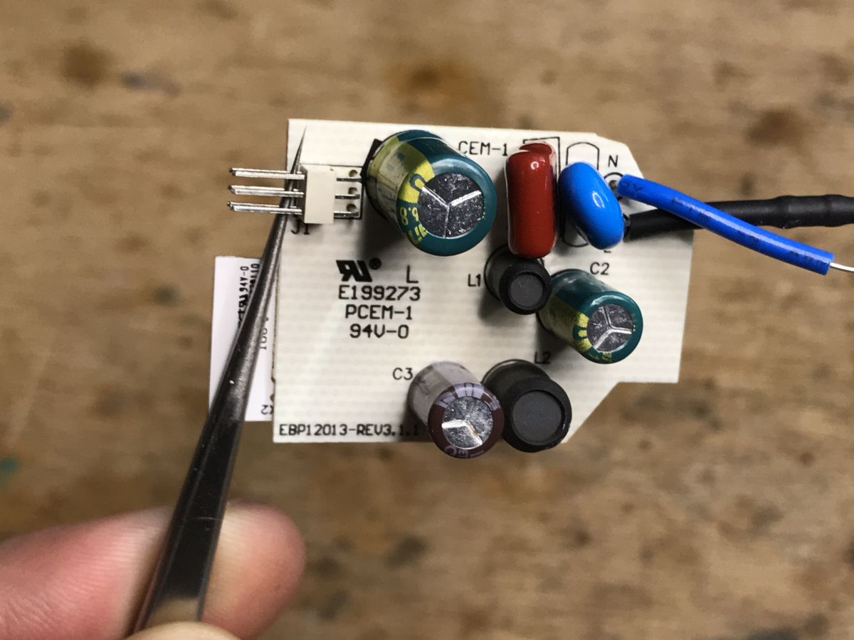

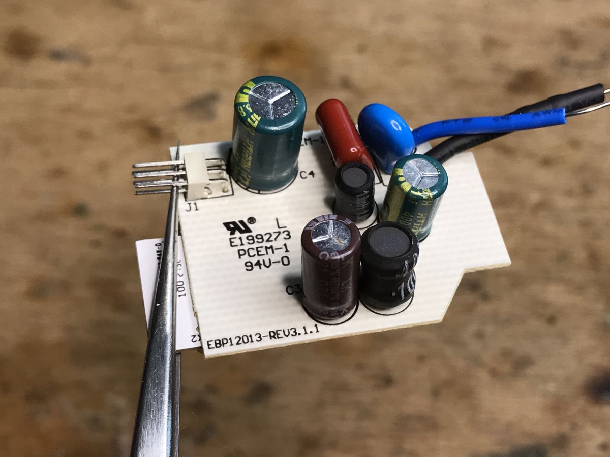

    Board with power supply and WiFi module:

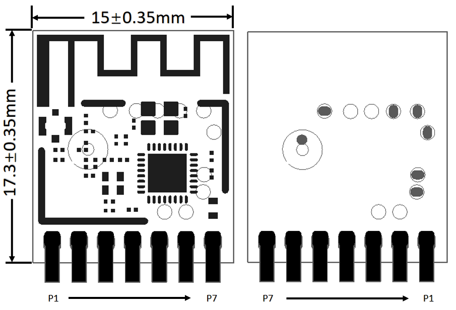

    CB2L module:
    Inputs:
    [table:87782a3016] [tr:87782a3016] [td:87782a3016] [td:87782a3016]. 1[/td:87782a3016] [td:87782a3016] P8[/td:87782a3016] [td:87782a3016] I/O[/td:87782a3016] [td:87782a3016] [td:87782a3016] Support hardware PWM[/td:87782a3016] [/tr:87782a3016] [tr:87782a3016] [td:87782a3016] 2[/td:87782a3016] [td:87782a3016] 2[/td:87782a3016] [td:87782a3016] 2 P7[/td:87782a3016] [td:87782a3016] I/O[/td:87782a3016] [td:87782a3016] Support hardware PWM[/td:87782a3016] [/tr:87782a3016] [tr:87782a3016] [td:87782a3016] 3[td:87782a3016] 3[/td:87782a3016] [td:87782a3016] P6[/td:87782a3016] [td:87782a3016] [td:87782a3016] I/O[/td:87782a3016] [td:87782a3016] Support hardware PWM[/td:87782a3016] [/tr:87782a3016] [tr:87782a3016] [td:87782a3016] 4[/td:87782a3016] [td:87782a3016] P26[/td:87782a3016] [td:87782a3016] I/O[/td:87782a3016] [td:87782a3016] Support hardware PWM[/td:87782a3016] [/tr:87782a3016] [tr:87782a3016]

    As I wrote in the content of the topic - I got the lights from a colleague in the forum, for which I thank him, of course. They just already came to me in the form of such a "tailpiece". But the others from the received set were in better condition:
    But the fact is, as I wrote in the summary - I wonder what I will do with this lamp now? I have to select the body from another damaged one.
    Of course, the authors of tuya-cloudcutter will rise to the occasion, then the next will not have to open to program. The full 2MB of batch I sent in on the repository on github.
