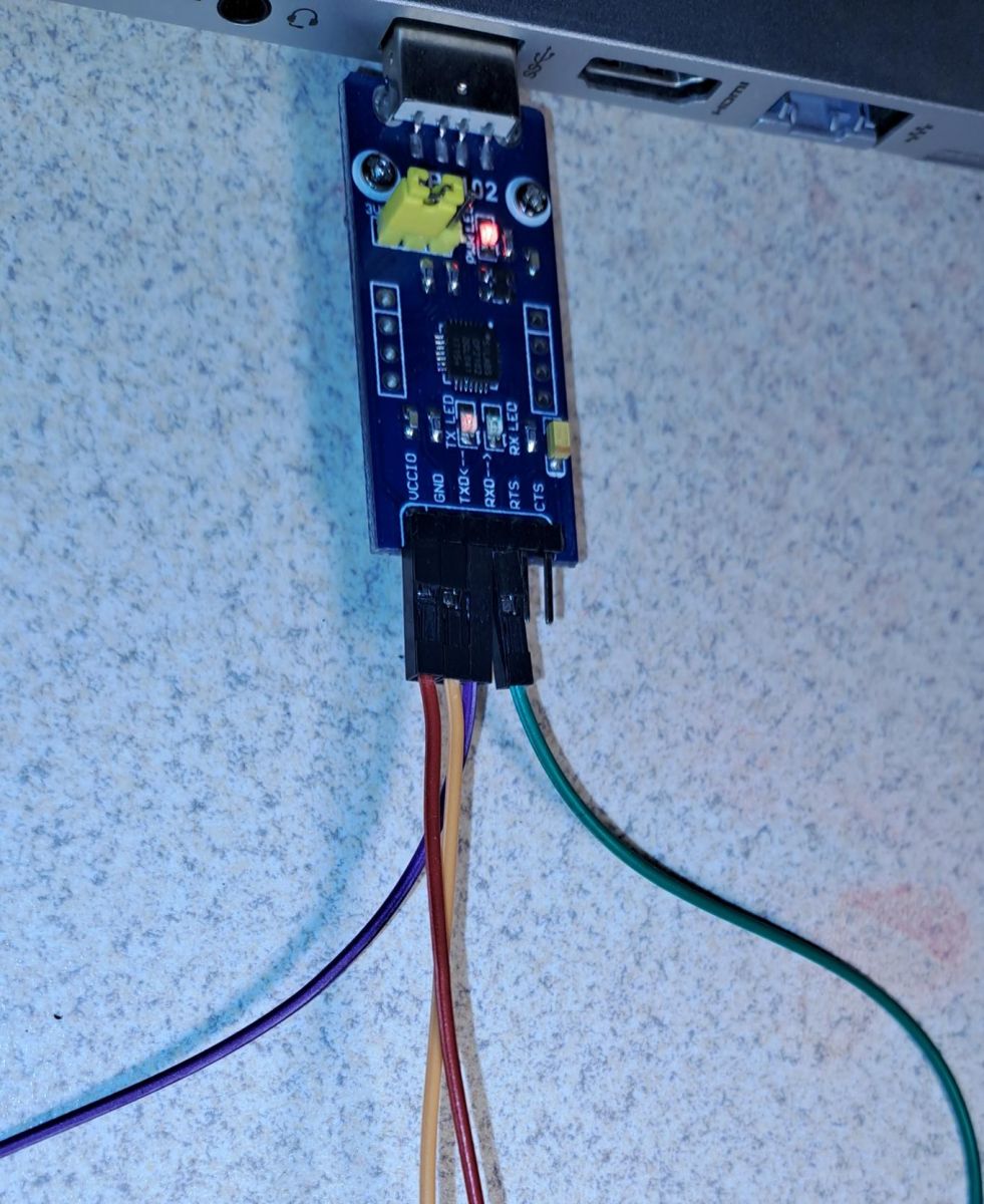

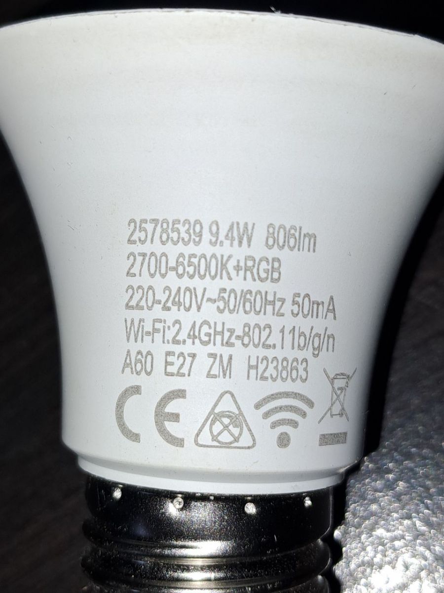

  • An LSC Smart white and color ambiance E27 bulb was opened and reflashed from Tuya firmware to OpenBK7231T despite having an unexpected BK7231N/CB2L and KP18068 combination.

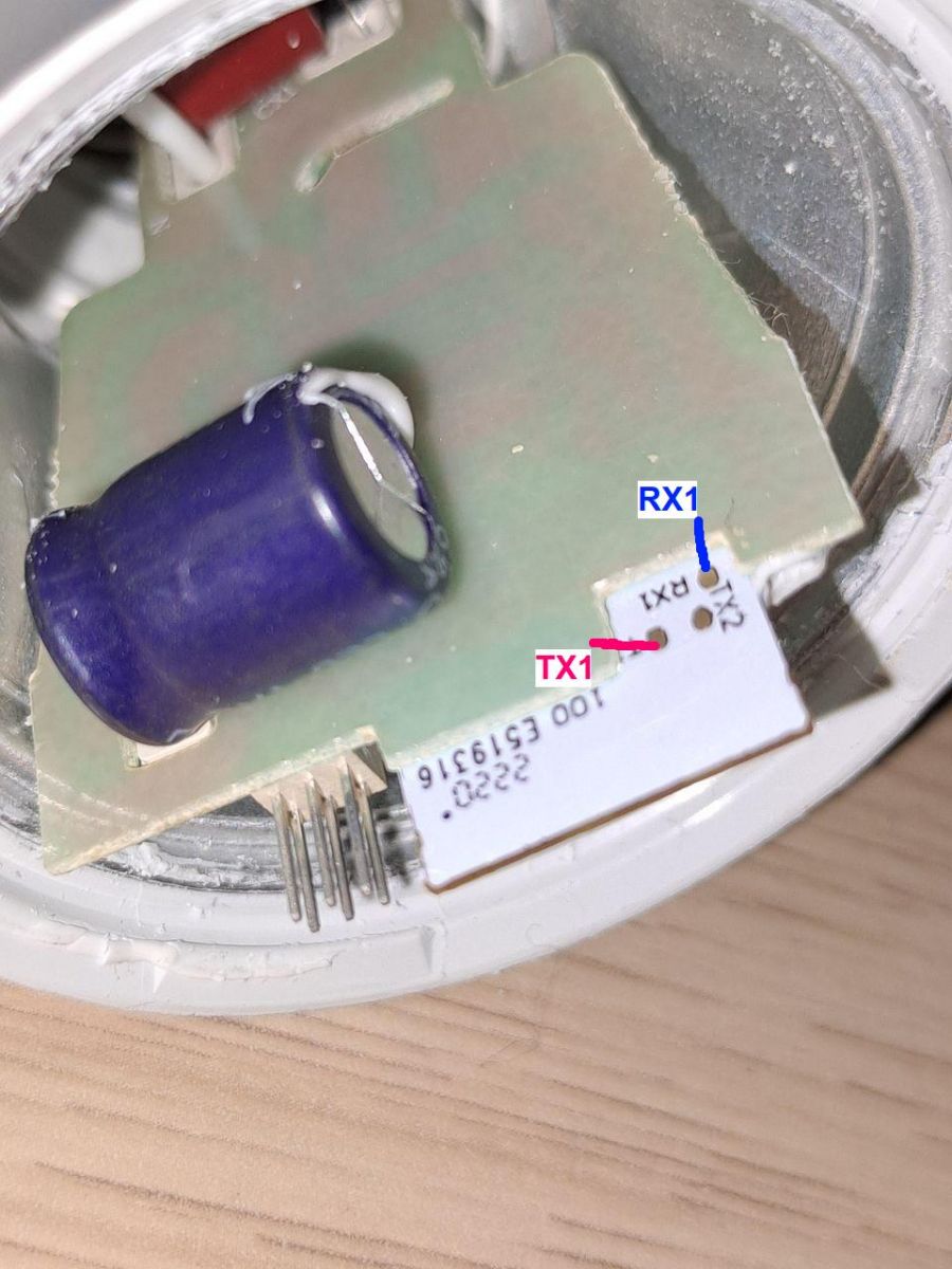

  • Accessible RX1 and TX1 pads allowed UART flashing with a CP2102 adapter after removing the diffuser and LED board, using BK7231GUIFlashTool to back up firmware first.

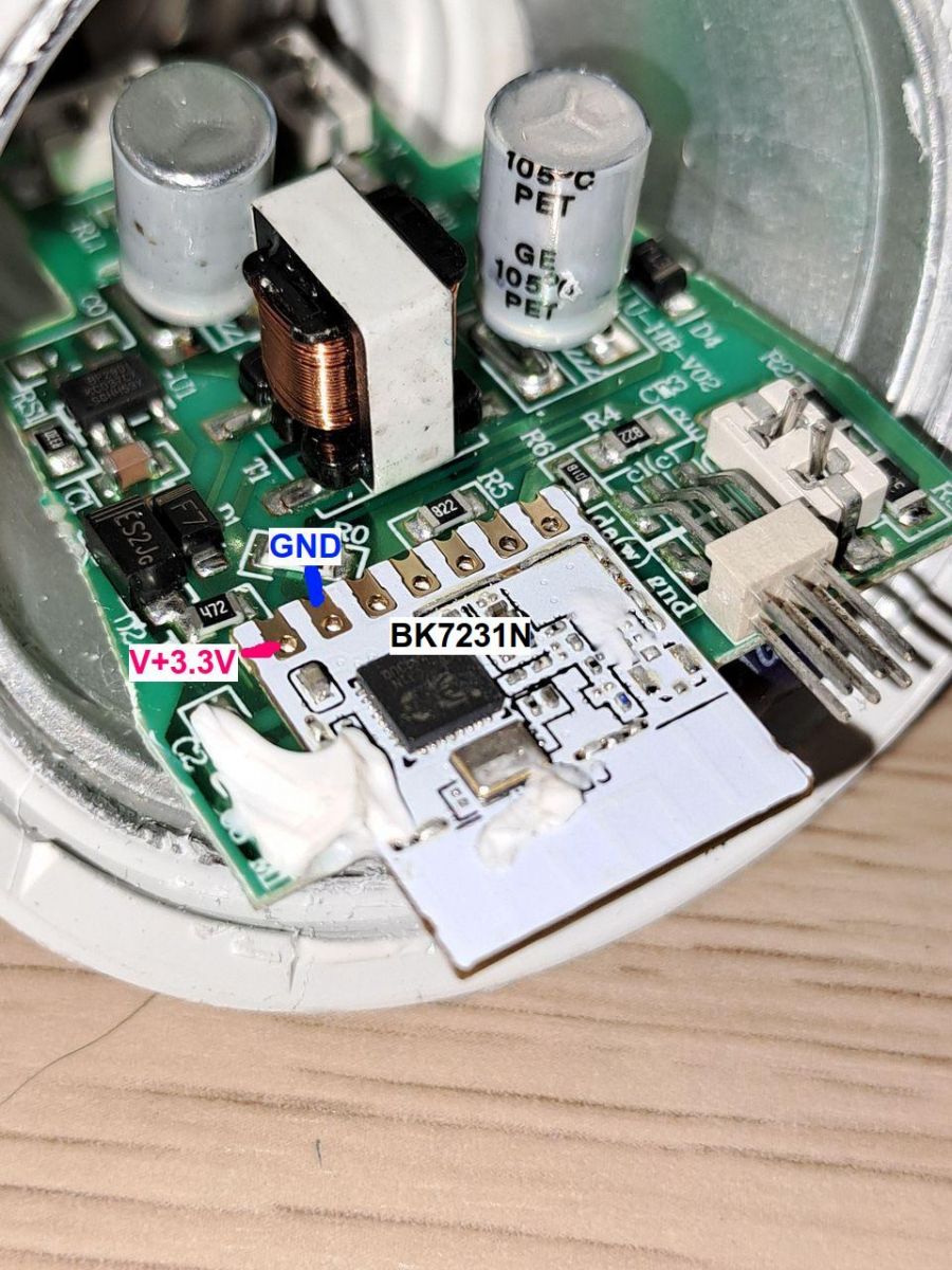

  • The 9.4 W, 806 lm bulb runs a KP18068 LED controller, but the compatible KP18058 driver worked using CLK pin 7 and DAT pin 8.
  • The bulb successfully accepted OpenBK7231T after disconnecting the ground pin when the module-reset message appeared.
  • Color-channel mapping still needs refinement; the current configuration starts KP18058 with mapping 1 2 0 4 3.
  • First time playing with flash. Bulb with action, none of the configurations fit. The bulb has been present in at least 3 revisions. One of the forums had identical packaging but on the BP module. Tuya cloud-cutter does not work due to version 1.5.21.
    I disassemble the bulb, remove the cover with a knife, then glue it around the LED board and take it out. Access to the pins is sufficient without further disassembly as in the photos. Pins RX1, TX1 are available without desoldering the element. We solder and connect, I used cp2102. We download BK7231GUIFlashTool and make a backup, and then flash OpenBK7231T_App. During the module reset message, I disconnected the pin from ground and it went away.
    Experience acquired, always check the controller. It turned out that I had KP18068 and not like other BP revisions... but the KP18058 driver works correctly. The color mapping still needs to be improved and you need to create a startDriver:
    startDriver KP18058
    KP18058_Map 1 2 0 4 3
    Below are the photos and the ready json for import.

    You`re very lucky that RX and TX are available. In the photo I can see that the manufacturer probably cut out a special place in the PCB for them. When I flashed a similar product, I had to desolder the entire module:
