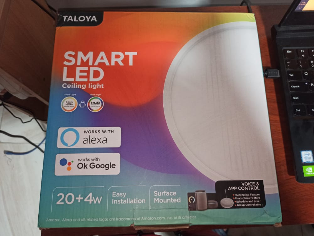

  • Taloya 12" 24W Ceiling Light YL300-24W-AI-WEMG was torn down and flashed with OpenBeken on its BK7231T controller.
  • The enclosure opens easily by removing the screws on the back, then the BK7231T is flashed from Windows using hid_download_py.
  • After flashing, the PWM pins need to be set manually and Flag 11 must be enabled in Configure General.
  • Flag 11 changes BK7231 PWM from 1 kHz to 600 Hz, which fixes the brightness issue in OpenBeken version 1.12.55 and later.
New device teardown and OpenBeken flash.
You can get it on amazon for $34.99 USD Link
Opening it up is easy, just unscrew the screws on the back.
Flashing
Pins:
In my case I did it on windows with the hid_download_py tool
After you flashed the BK7231T. You have to set the PWM pins like this:
To finish you have to enable Flag 11 - [PWM] BK7231 uses 600hz instead of 1khz by default in Configure General
this solves a problem with brightness
this flag is available from version 1.12.55
