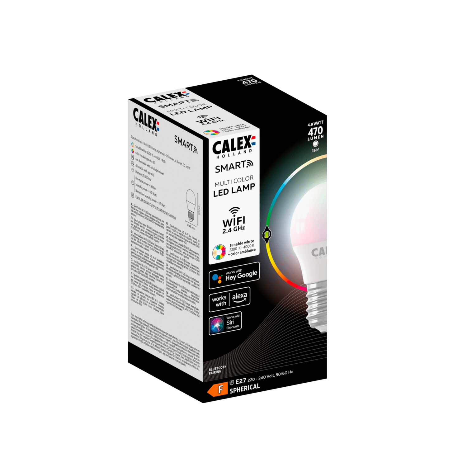

    Calex Smart LED Lamp - E27- P45 - RGB Warm White - 9.4W
    Article Number :429122
    Calex smart LED bulb and a smartphone displaying its control app.
    Packaging of Calex smart LED multicolor bulb.
